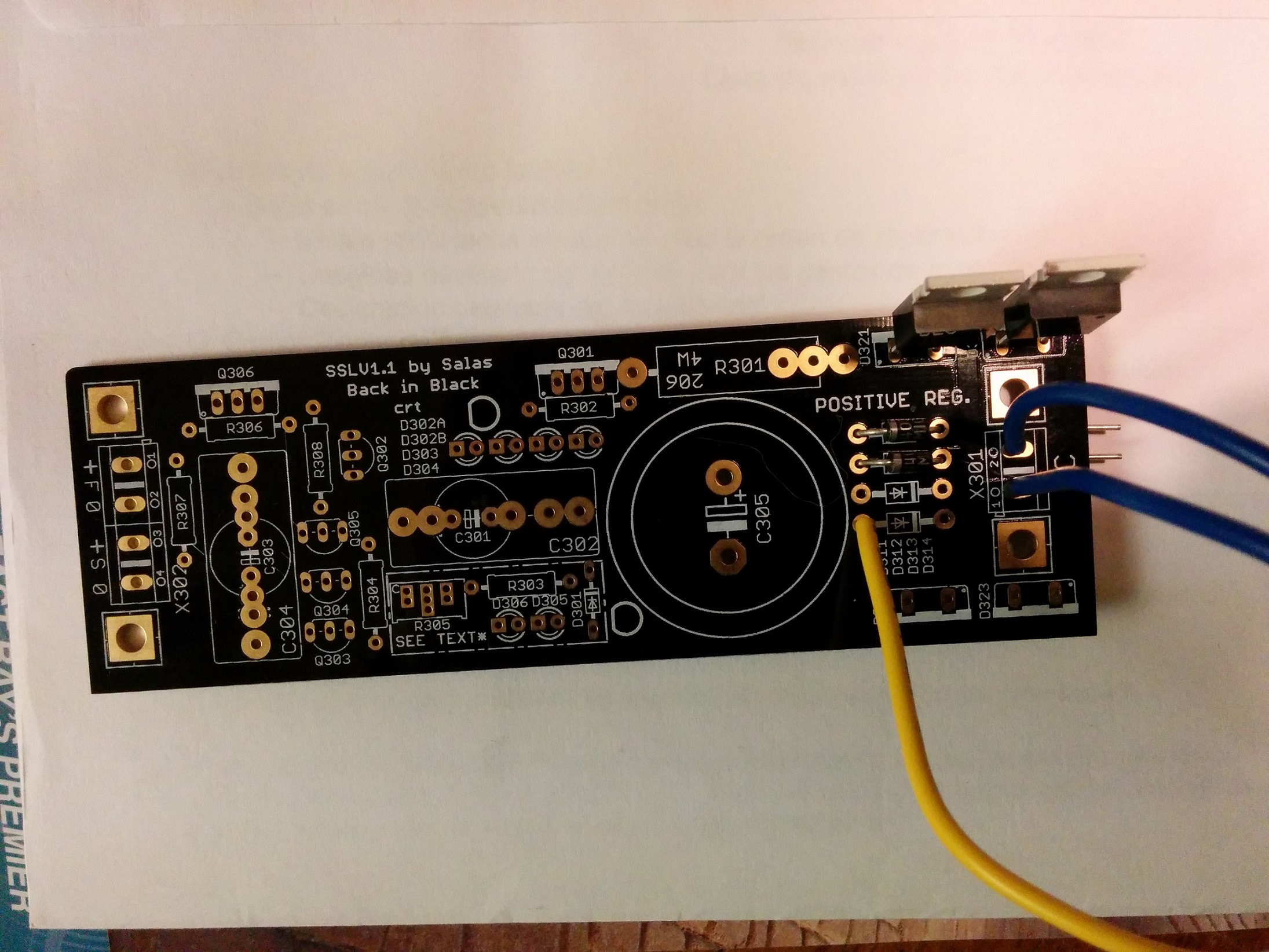

It can be done to set up the BiB board for full wave rectification, but it doesn't look at neat as the full wave bridge. I ended up doing wiring up point-2-point which allowed me to use my existing parts.
I will dig out my notes after work to show you how to do it.
Hi Freeman,
Attached a picture to show how you can wire a 12-0-12 transformer to the BiB board. Notice that I include both types of diodes the board supports, but you only use either type, not both.
My transformer color code:
Blue = 12V
Yellow = 0
Thanks,

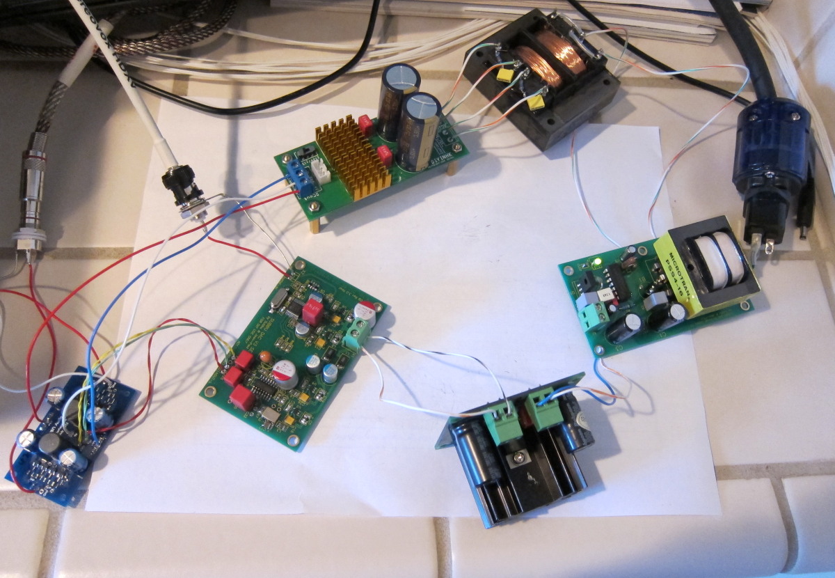

more power supply musings
In an earlier post (see post # 127), I commented on my comparison of the stock Subbu/JP LM723 power supply vs. an LT1764. With the right pre-filtering, I preferred the LT1764, finding that it gave more fleshed out bass and an overall bigger soundstage. One of the questions that I had was whether or not this was due to the greater output current capability of the LT1764. If that was the only difference then hooking up the V3 DAC to an output buffer such as the JG filter/buffer should lessen the difference between the two power supplies.
So I did just that. I connected the V3 DAC to an extra JG filter buffer that I'd built. The JG filter/buffer was powered from a dual 14 vac transformer driving a +-15v supply based on the TPS7A4700 regulator chip. I bought the power supply from the diyinhk webshop. The power supply is switchable for either +-12v or +-15v. The buffer sounded a bit more powerful at +-15v, so that's what I used for the comparison. You can see pictures of the whole thing below. It's obviously not a permanent set up - things are just wired together and lying on the a shelf with no case.
Power supply for the V3 DAC was then switched between the stock LM723 supply or the LT1764. And the results were unchanged from the earlier experiment. Even with the JG filter/buffer, the sound of the LT1764 was fuller and more three dimensional than the stock LM723 supply. The noise of the LT1764 is a bit higher than the LM723, so JP thinks that perhaps I like the sound of noise. But I don't think that's it. There is some dynamic behavior of the LT1764 that is better.
Next up is to try some shunt regulators, which Fred/PCHW kindly lent to me. The shunt regulators are the Salas BIB and the Salas Reflektor. It may take me a while to get these going, but I'll eventually compare these power supplies and see how they do.
---Gary

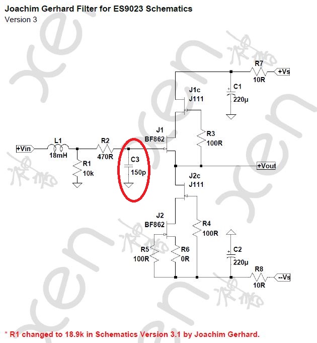

JG filter/buffer cap
By the way, I'd forgotten how much I don't like PPS capacitors. The JG filter/buffer uses a 150pf cap to ground at the gate of the JFETs and in my opinion using a PPS cap there wrecks the sound. I learned this when I built my first JG buffer from the board supplied by EUVL and ended up replacing the BOM 150pf PPS cap with a 150pf Wima FKP polypro cap. And I just relearned it again because I used a PPS cap when I built the buffer in the picture a few posts back and I couldn't figure out why the buffer sounded so bad. Replacing the 150pf PPS cap with a Wima FKP cap again fixed things. This is inconvenient, since the board is made for a small SMD cap and the Wimas are big, so it requires ad hoc placement but it's not too bad. Just a word to the wise.
---Gary
Now i have 150pf caps sold by SWALTER in miniGB, i don't know what dielectric. You used the same parts from Swalter ?
According to the GB spreadsheet on Google Docs, the part used is a 150pf 16v PPS capacitor, Panasonic ECH-U1C151JX5. That is the same part that I used.
I've read of people having good success with PPS capacitors but they are also notorious for being very fragile and easy to damage. So it's quite possible that I've overheated the caps and damaged them. I've not had that problem with other SMD parts but this is the second time I've had trouble with PPS caps. Perhaps your soldering skills are better than mine and you won't have a problem. But in the future, for a size 0603 ceramic cap, I'd use a 150pf NP0 ceramic cap. These should work well for filtering and are a bit more robust.
---Gary

Eldam,
You cover a lot of ground and are planning many, many changes. I think mostly you were just telling us your future plans but I think there was a question or two hidden in there.
1) Regarding the JG buffer - matched JFETs means that the BF862s don't need source resistors. You still need R2 and C3. If you skip R2 then there is an open circuit and you will get no sound.
2) Regarding a PC board for the LT1764, please see post #127 for the details. I bought it on ebay.
3) Regarding snubbers - it doesn't matter if it's 50hz or 60hz. Snubbers are designed to damp much higher frequency noise and do not interact with the power line frequency.
Good luck with your endeavors.
---Gary
