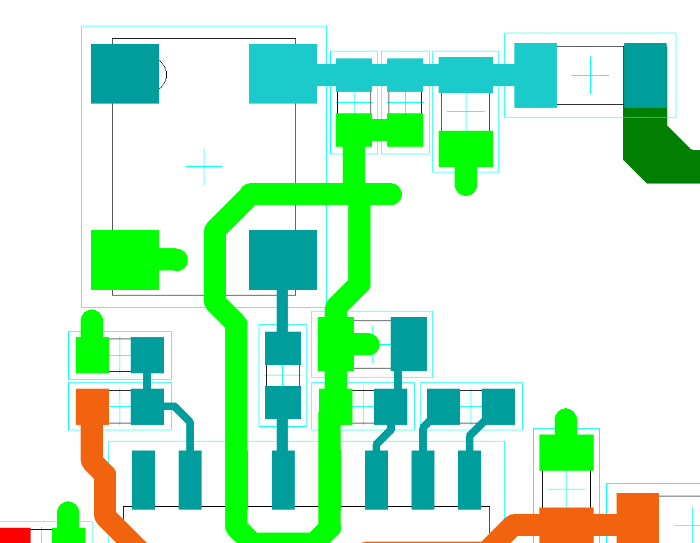

The best capacitors for digital decoupling close to the pins (ie the small value caps 0.1uf etc) are X7Rs. The one exception to this is decoupling an oscillator, here the ultimate clock signal fidelity is achieved buy using a very low value GOG (0.001uf)(and thus small case) next to the pins, with X7R decades (0.001, 0.1uf) further out. The use of X7Rs allows the use of the smallest possible case, this is critical at these frequencies' as it reduces the parasitic inductance, also when used together in decades (2 or 3 at 10X value from lowest to highest) the lossy nature of the X7R dielectric minimises the resonant peaks.
Some info:
http://www.avx.com/docs/techinfo/mlcbypas.pdf
Here is how I would decouple a 50MHz osc, with 3 caps next to power pin, a very low value COG, and two larger X7Rs, the smallest case size is 0603 which in reality is rather large for decoupling, 0402s and 0201s are much better, but far to small for DIY work unfortunately.

That looks excellent, and will be beneficial to the clock integrity IMO.
I spent four years doing some comms. equipment where we needed a very stable and jitter free clock, the engineer in charge of the radios spent a few weeks looking at clock and stability issues and found, as most are aware on this site that; clean power and the correct decoupling were paramount, also the smallest possible trace length from clock to chip input.

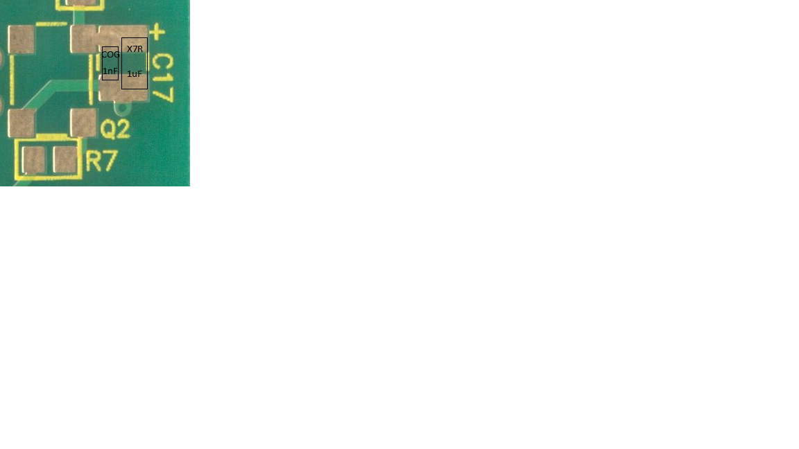

Phil, Marce,
(I use myself a military COG 1 uf, 5 mm between pads which is too big for the value and the size if I follow the discussion.)
I read the doc of Marce, then others about digital decoupling for my own culture (not to critize the DAC itself). i have please a question in relation to the mods with the 1 uf MLCC X7R of this thread then your picture above.
As the crystal has its own powersupply from a tantalum cap filtered by a ferrite bead : would it not be better just to put on C17 a ceramic which self resonance frequency is above the 50 Mhz of the crystal. So 10 nf max (with a 1012 smd size SFR is 53 mhz for X7R and 52 mhz with NPO (COG) ?
About the aging of the value with time (lake of capacitance): only the NPO seems good, here X7R or X8R are bad. But I read elsewhere than the MLCC X7R have no piezo electric effect or less cracking with time ?
What do we have to think ? can we heard the difference or is it just the last outrages to drosophils ?
After reading your doc Marce, it seems clear it could be better put the lower size a man can solder near the crystal. but the temperature is hard to control for the security of the cap : I read no more than 160° for such a little ceramic cap no to destroy its characteristic. too much solder can get off the result of the wanted minimized size of the cap as well.
Is there a compromise for an enthusiast which use solder ? the ratio: low size:high frequency of the X7R 0603 smd size ? Or NPO is still better ?
