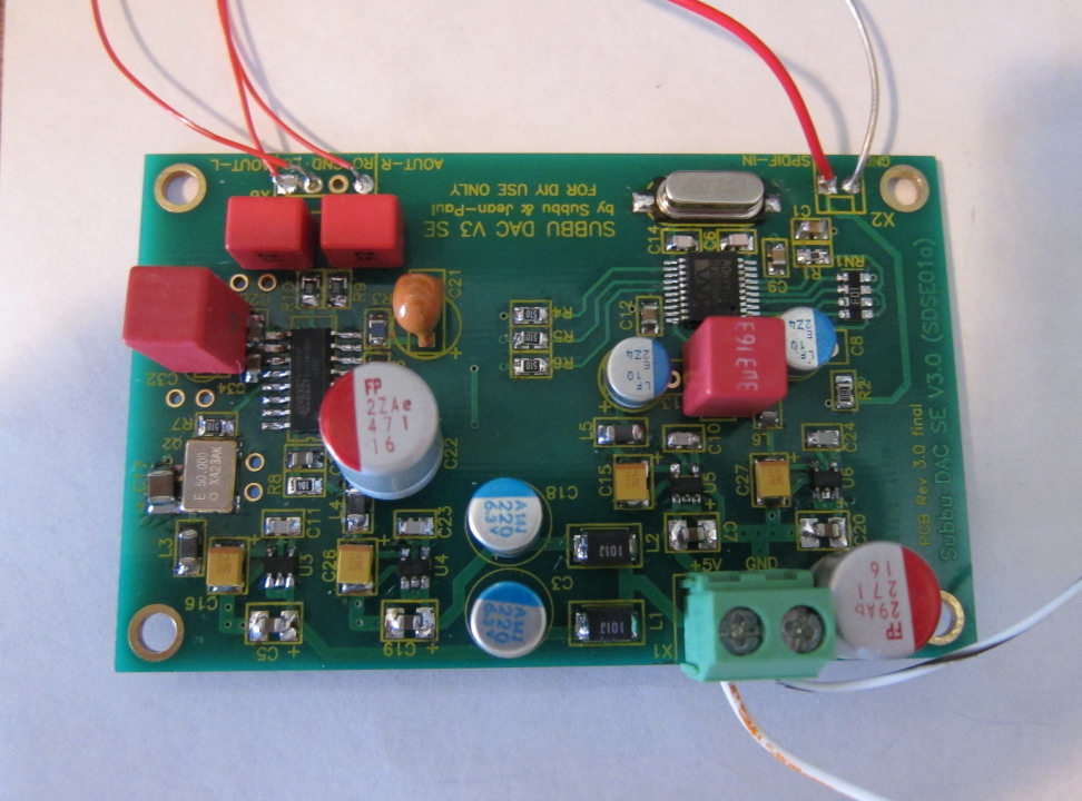

power supply experiments
All the traffic of the last few days inspired me to pull out one of my V3 DACs and do some experiments on the 5V power supply. I normally use the standard 5V power supply that Subbu and JP offered with the V3 DAC based on the LM723 low noise regulator chip. For comparison, I bought an inexpensive regulator board based on the LT1764. It's built by a company called Audiowind and is their model A270. You can find the schematic here http://www.audiowind.com/pdf/A-270.pdf and it's available on ebay for around $15-$20 including shipping from Hong Kong. Search for "VERY LOW NOISE <40μV Adjustable Voltage Regulator" on ebay and you'll find a few vendors selling it. It's not complete like the Subbu power supply. It doesn't have a transformer or bridge rectifier, so for this comparison I tapped power from the Subbu power supply. Initially I got power right after the bridge rectifier at the terminals for C1. Both the Subbu supply and the LT1764 don't have many hours on them, so consider all my comments about sound quality as preliminary.
First comparison - Subbu PS vs. LT1764 tapped off of C1
This was pretty easy. The LT1764 seemed a bit washed out and harsh and not as nice to listen to. It had certain good qualities but overall, I found myself wanting to quickly switch back to the Subbu PS.
After this quick result, I was scratching my head wondering why the LT1764 didn't sound better. It occurred to me that the extra LCL filtering in the Subbu PS (C1-L1-C3) might help filter out some high frequency noise which could cause problems with a feedback regulator like the LT1764. So I rewired things so that I was getting power for the LT1764 at C3, which means after the LC filter.
Second comparison - Subbu PS vs. LT1764 tapped off of C3
With this change, things changed and the LT1764 was preferred. It had much deeper bass and seemed to have a more three dimensional soundstage. In comparison, the Subbu PS sounded very smooth but a bit flat and seemed to miss some of the deepest bass. I was surprised at the difference.
I recall several people saying they got a big difference using a Salas shunt regulator for this 5v power and I now see that they may be onto something. While the Subbu PS is very good, it does appear that there is room for improvement.
Attached are a couple of pictures showing my temporary hookup. V3 DAC is fed from a Squeezebox 2 which of course I've tweaked. I can switch from one power supply to the other in less than a minute, so it's possible to do relatively quick comparison. And for those curious to see what my V3 build looks like, I included a close up of my V3 DAC so you can see what I'm listening to.

Gary. I'm interested in what value for C35. Is that a 4.7uf? Also do you still recommend the 3.3/0.1uf parallel for C4? Thanks. Very interesting.
Freeman,
Yes - C35 is a 4.7uf Wima MKS2 as I have suggested for a long time. At some point I want to try a smaller value such as the 1uf Wima that JP likes.
For C4, I'm still using 3.3 in parallel with 0.1uf. Theoretically, I believe that 1uf should be a big enough capacitor here but I haven't done the comparison. Eldam has tried 1uf and finds it a big step up from 0.1uf alone. I'd be interested in hearing results from others who experiment with values between 1uf and 3.3uf.

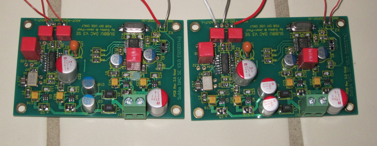

How does the sound change/Improve with this changes?
side by side by C18
We saw themselves important differences exist between two close caps. With my system I can hear it with C18 and just can no hear the FP cap you use yourself for C18. I saw many fellows use these expensive Nichicon FP cap at C18 and wanted just to share how bad it was for me (not just a question of flavor here IHMO !)
The only difference between my two V3 DACs is the cap used for C3, C18. Nichicon FP in one and UCC NPCAP in the other. So I'm set up to do a direct comparison of the difference between these 2 caps. Both DACs have all the other changes that I described in my earlier note. So this morning I swapped DACs and couldn't hear much if any difference. The Nichicon FP version sounds very good as did the UCC NPCAP version.
No capacitor has a sound of its own. I verified this for myself. I can stick both capacitors in my ears and hear nothing! Excuse my little joke.
But the capacitors do interact with the rest of the circuit and depending upon the rest of the parts used then one may or may not hear a difference.

Ryssen,
As I have said a few times, I have already pointed out the changes that I found significant enough for others to follow. The rest of the changes are things that I tried and thought should be better. I added them to one DAC and thought they were better in a small way but not important enough to justify changing the BOM. For consistency of other comparisons, I put these changes in both of my V3 DACs, so that when I did want to make rigorous comparisons I had a consistent comparison. I haven't done a rigorous comparison of the cumulative effect of all these changes. Perhaps I will listen to my beta V3 board, which is missing some of these changes, to see if there is anything from the cumulative set of changes.
---Gary
All the best.
---Gary

With your two photograph I try both with C18/C22 : left picture was better but ultimatly it was far better with the same C18 cap of the left photographs but with SEPC instead FP at C22 as you advised : more fleshy, more softness, no lake of details and not harchness on attack in the mid-high (here I suspect maybe resonances? FP has ESR < 10 mohms -not sure of the scale- maybe the cause of resonance; I 'm asking of the utility of the bypass C36 1uF X7R with the FP ? maybe the problem was here with my listening test... don't know).
But as you said there many interactions : the source, the ears, the speakers, the quality of electricity line. Well after all people are free to do what they want, here the BOM for me was just allright with the OSCON SEPC (470uF/16V). and better than all my better test; Maybe a better tonal with C18 and a 33/16 V BG N but with the price of less resolution than the BOM one. I go back with the one (left photograph) of the BOM at C18 at the end.
I have to said I find strange you don't hear difference between the two photographs... but I suspect you will tell me that photographs don't make sound by themselves 😉
