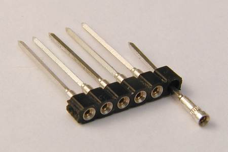

DON'T use large caps in this DAC. It needs small parts with shortest possible wiring. If you want to experiment you can use the pins of the better IC sockets to test various caps. Or these which are more or less the same. The V3 PCB won't survive too many solderings so using a socket seems wise.
