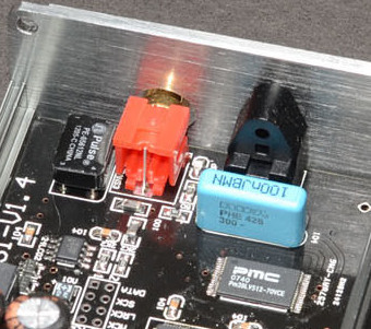

hi,
i was planning on removing the spdif input cap and putting a jumper wire there instead, per jp's suggestion on page 2 of the thread. my source uses a pulse transformer and i recently added some electrical tape to the source to ensure the output ground is completely isolated from the case.
but now garyb says the coupling cap is still necessary due to r2. so which is it?

Matt,
I don't recognize the picture that you included of the SPDIF input / pulse transformer. It certainly doesn't look like a Subbu DAC.
Regarding needing an input capacitor, that was specific to the WM8804 receiver used in the Subbu DAC. If your DAC uses another receiver chips then that could be different.

OK - so your source uses an SPDIF output transformer. It's normal that it would not have an output capacitor.hi garyb,
the pic is of the source, a cm6631 usb interface. it has a pulse at spdif but no cap after that i can see.

You still need the input cap for the Subbu DAC's SPDIF input.
