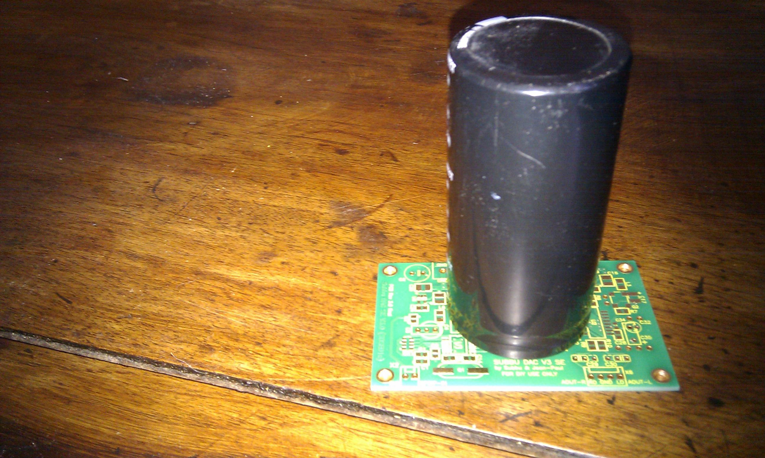

last Subbu revision : a super cap with : 0,00000002 m ohms ESR. Don't believe the picture, spacing between pads are only 2.5 mm and long enough for the others components below !

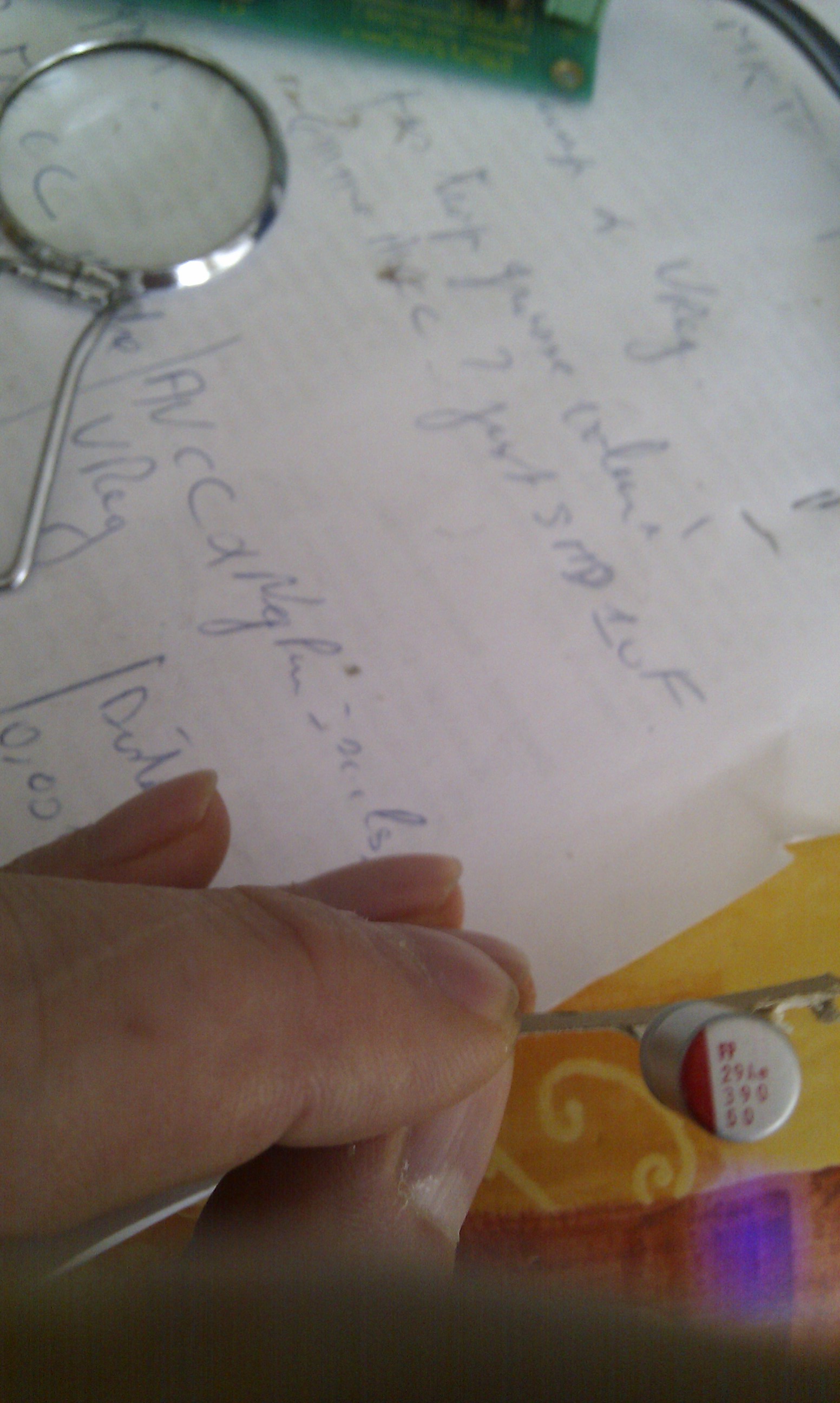

I am very disapointed (LOL) : I just measure all my 390 uf Nichicon FP cap R8 serie bought at Mouser : they all measure around 41 uf !!!!
I have to write here as I gave some advices here after many tests with and without those caps at C22 position and I am an inteluctualy honest guy !
My device to measure caps is not bad : no problem with others caps from Panasonic like OSCON SEPC or SEPF : value is exactly the same as writed on the cans !
Did you have such surprise in your life of diyer with caps from great brands ?
At more than 2 euros the piece (I bought 6) : it's a bad surprise. It seems they printed 390 uF instead 39 uF ! So with the 390 uF i waiting for instead the 470 uF of SEPC Panasonic for C22... I really understand the difference of sound ! 😱
Eldam,
The capacitor you show in the picture has the correct label for a 39uf capacitor. 41uf is within the tolerance since it is only 5% high. The way the label works is that the value is (first 2 numbers x 10 raised to last number).
10 raised to power 0 = 1
10 raised to power 1 = 10
10 raised to power 2 = 100
etc.
So 39uf is labelled "390"; 390uf is labelled 391; 3900uf is labelled 392
It's possible that Mouser sent you the wrong parts but more likely they sent the right parts and you misread the value.
---Gary
