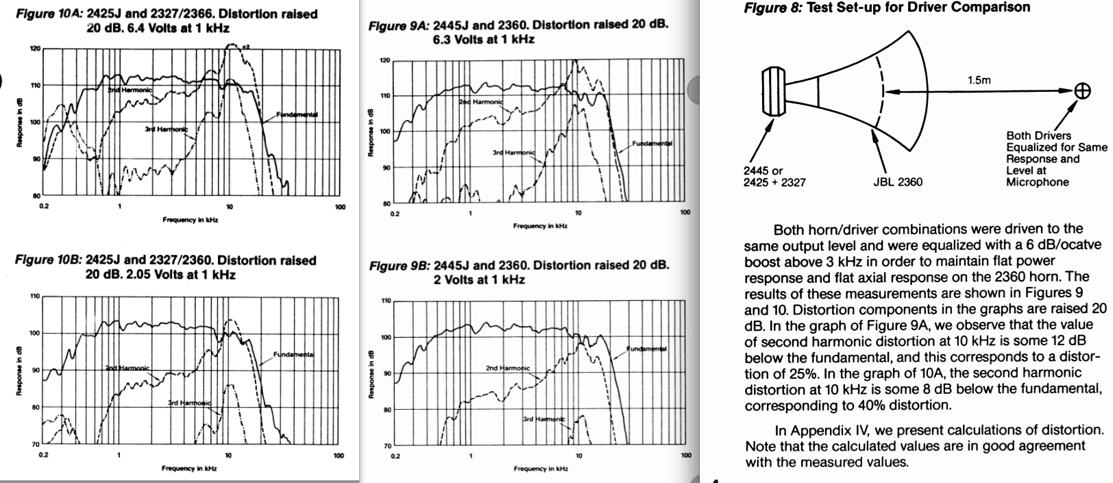

The JBL 2426J is typical of most 1.75 to 2" diaphragm compression drivers, with 2.56 watt input it has rising distortion reaching 40% second harmonic distortion at 10 kHz.
This is why I'm presently so interested in the small "full range" speakers like the 3.5" Tymphony TC9FD, it has only a fraction of the distortion of a compression driver at similar output levels, and is capable of another octave lower than a 3" diaphragm compression driver.
Whether a throat arrangement for the TC9FD that allows uniform HF dispersion without reducing the output is possible is what I'm going to work on next.
The JBL Technical Notes Volume 1, Number 8, though 25 years old, is very informative regarding the reasons why all high frequency compression driver/horns have such awful distortion above fractions of a watt:
JBL Technical Notes Volume 1 Number 8

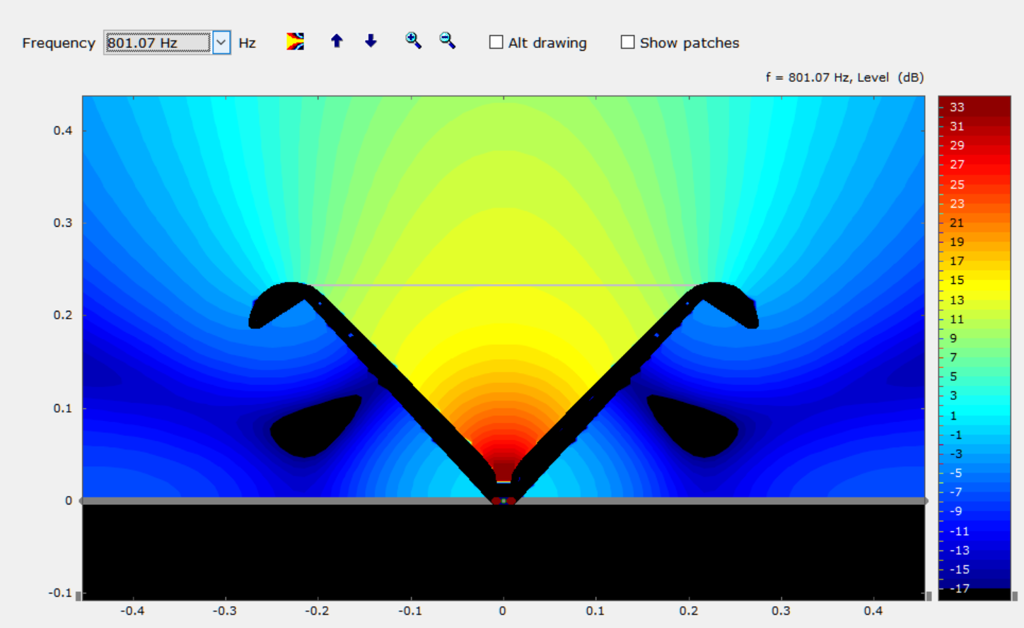

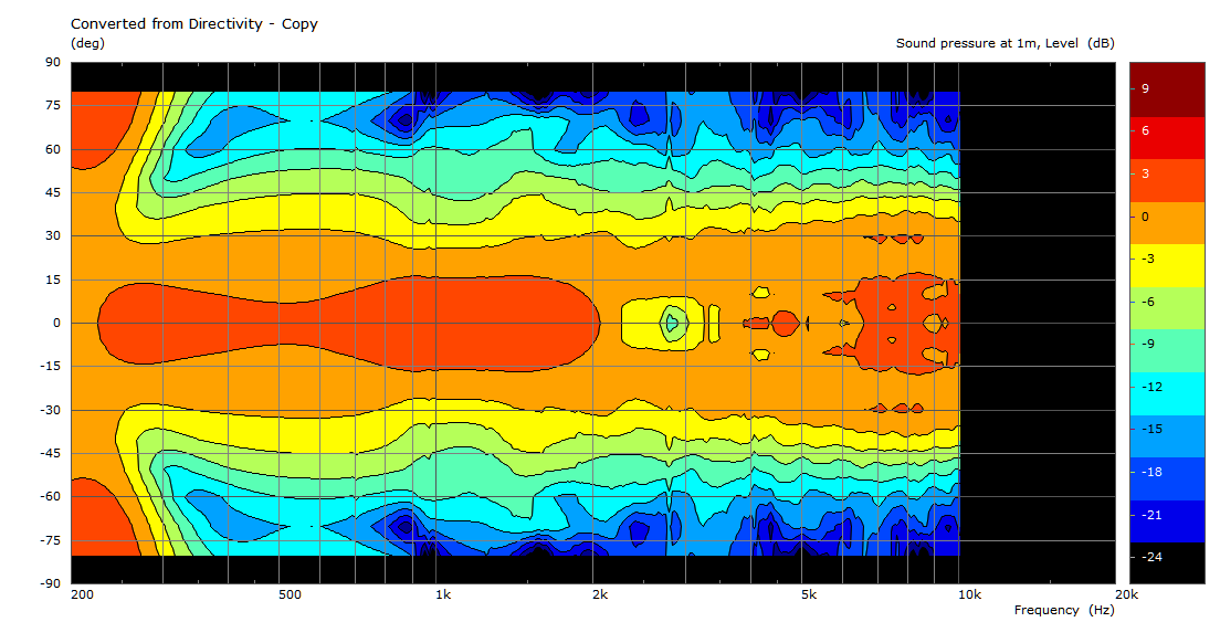

Any AxiDriver experts in the house? I modeled my wg to see if the sim matches reality. This was only done up to 10khz to save time but the result is fairly close I think considering the sim is an axisymmetric device, and I normalized to 20deg to match how the wg is eq'd. AD can't do the mids so I tweaked the motor parameters on the hf to get output down low. The pattern shown is narrower but that could just be the way VACS establishes 0dB. The main issue i see is the response below 1khz in the sim. Oviously the pattern on my 18" wide wg does not maintain control down to 300hz. I've talked to another member who said he sees the same thing in AD sims. Can anybody else verify this, or maybe I'm doing something wrong?
Hi Nate,
I am a bit, What you see in the Sim at the lower range is the reflection on the surface behind the waveguide.
This has little effect at high frequencies because of the directivity of the waveguide, but starts to come in where the waves bend around.
What you can do is;
a - extent the model with a straight part of ca 10 meter at the throat (diameter of the compression driver output). So that the waveguide starts at 10 meter from the driver. This way the reflection is 20dB down if you render the directivity plot at a 10m distance from the waveguide apex (you must enter 20m in Axidrver because it ' thinks' from the zero-wall.
b-use ABEC, here you can also do axisymmetric and in real farfield condition. It also calculates faster than AxiDriver because it is multicore, also in the analysis part.
You have to also model the outside of the waveguide (can be a bit more rough) or the results will be invalid
