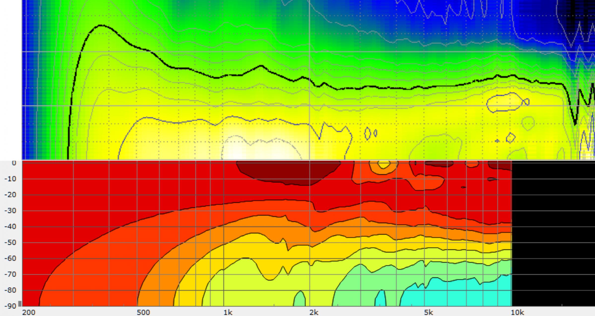

Back to the regularly scheduled programming..........here's an IB sim of my wg. This looks much better on the low end though the IB shows it wider which is to be expected. The second plot is a comparison of Geddes' PolarMap and the VACS contour - PolarMap on top.
Nate - it seems curious to me that there is no pressure gradient normal to the 90 degree mark (the contours are all normal at 90.) This does not happen in reality. Any idea why?
Could it be due to the infinite baffle, which in the case of the sim truly is infinite? It's also possible that I don't have the sim setup correctly, but the options are pretty limited.
Thinking about it some more I'm not sure I understand what you're saying there........could you explain it in a different way?

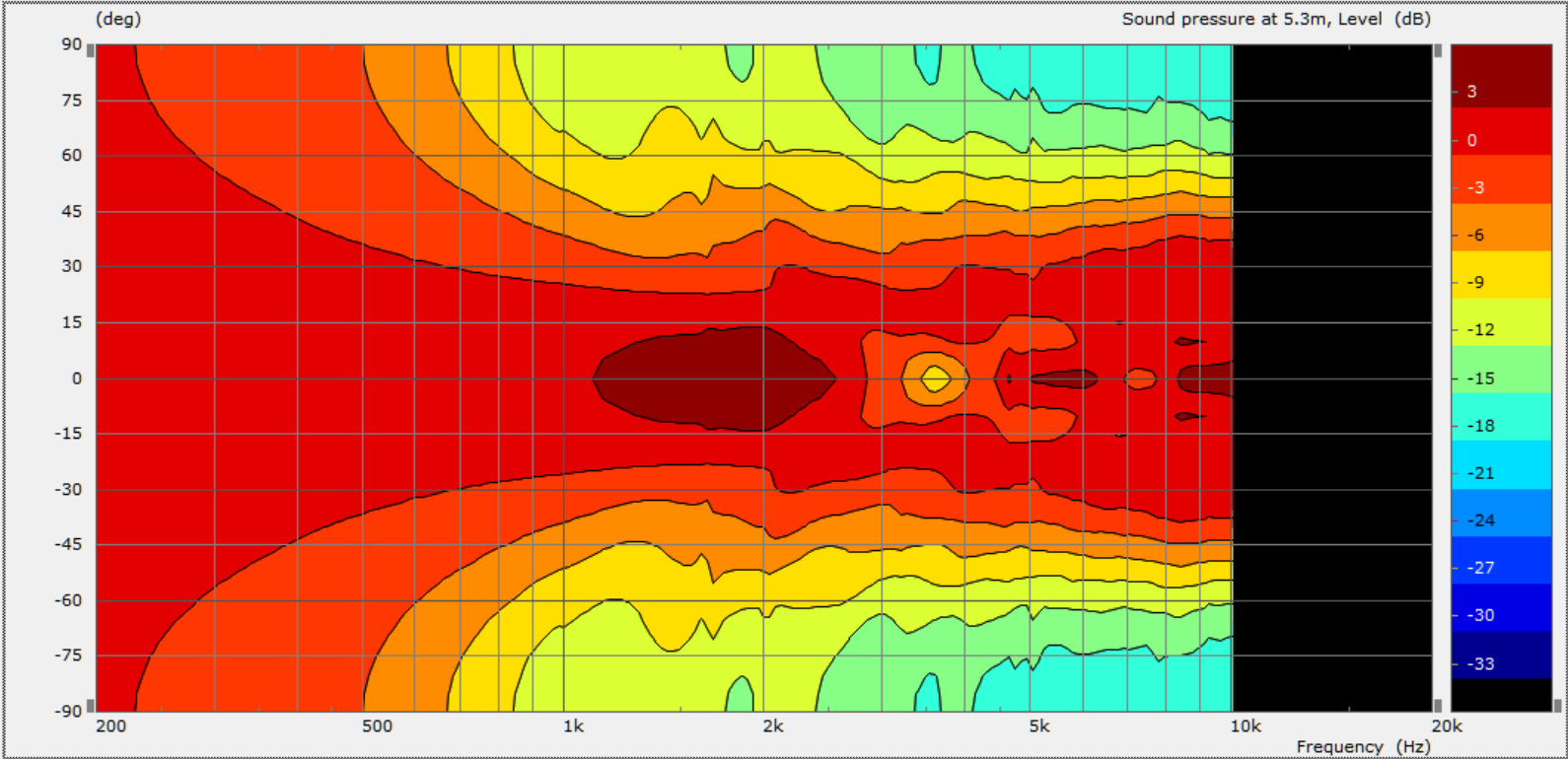

A quick question to Dr Geddes and Nate,
A small question on the contour map in post 202
I see that the usual -6dB line (and lower) is very much close to constant directivity
But the 0 dB line isn't. It has narrowing between 500Hz to 4000Hz.
Similarly -3dB line is somewhere in between.
My question is what changes in waveguide (not EQ etc) will be needed such that all lines (higher than -6dB) will be flat and hence constant directivity.
This can be seen in many polars, the above one I took just as an example...
If the sim is infinite baffle then that is the answer, but I thought that you had to change the model to make it work right. Is it still infinite baffle, just that the baffle has moved back?
The larger the waveguide and the more rounded the mouth edge is, the smoother the response will be in the center. Its all about the mouth edge diffraction - hard to eliminate completely.

Ahh ok then I do get it.If the sim is infinite baffle then that is the answer, but I thought that you had to change the model to make it work right. Is it still infinite baffle, just that the baffle has moved back?
That sim was infinite baffle with the mouth roundover tangent to the IB so not freestanding at all.
Got it - not what was shown with a free standing waveguide.

Any means of diminishing the mouth edge effects is good. In sharp edge square devices the diffraction is spread so wide that it does not have a strong far field effect, but it does still reflect the wave back down the horn creating a series of standing waves which can be seen in the plots.
A highly coherent waveguide like the OS or Nate's will have a pronounce effect from the mouth, but minimal standing waves and hence and overall smoother power response.
Oh wow, thanks for the offer! For coordinates do you want what I input into AD for the baffle (wg)? It would be interesting to compare and might get me started on the right foot. That said, if I can get AD to reasonably match my measured result then I may just stick with AD. I'll probably build a large elliptical Synergy but I can do a little "eye interpolation" for that as far as the axisymmetric sim goes. Mostly I want to investigate different mouth treatments.
I tried your workaround for extending the wg, but AD kept saying "Solver Aborted" right after I start it. Let me make sure I understand.........you're saying to have a straight duct extension between the diaphragm and the actual wg? Rather than go 10m I went 10' and then added another 10' for the VACS pressure contour setting. I tried several times and it keeps saying aborted. To get a baseline I'm now running the sim with the mouth roundover tangent to the IB. That's running just fine.
Hi Nate,
I'm sorry, I didn't explain it well enough.
Enter this in your axidriver coordinates ("baffles" tab) with nothing else added, and a dome of 1 inch to see what I mean;
.2 .2
.4 .1
.025 -10
This will create a very basic waveguide in "semi free-field" conditions.
This sets the infinite baffle layer 10m behind the diaphragm so there still is the reflection only it is of less disturbance. You could of course make it more accurate where the outside of the waveguide is, but I kept it simple.
Of course this is sub-optimal and true free field would be more accurate.
In AxiDriver, you can't go further than +-90deg for directivity plots but of course you want this data to.
Besides this, I just tested this example in AxiDriver, which I havent touched in a long time. It was shocking to notice how sloooow it is compared to ABEC. (basically because of the lack of multithreading)
These are the same sort of coordinates I would need to setup an ABEC project for you.
If you have or can make this data, I would like to have the contour in 100 steps.
If this is too fine for you to create, 10 steps will also do, but 100 is better, especially for future progress.
