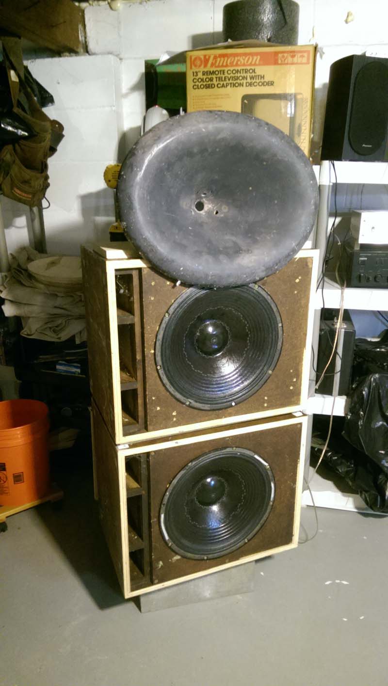

I've been interested in building a Synergy horn for 3, maybe 4 years now. The SH is what got me interested in high eff speakers, horns/wgs, etc. The more that I build and learn about audio the less I think a Synergy is ideal for home use......the ports near the comp driver exit being my main beef. Thinking and knowing are two different things and so before I write it off completely I figured I might as well build the dang thing. It's not like I haven't had a case of Synergy mids (Celestion TF0410MR) laying around for 3 years or anything . I've seen some data comparison of ports/vs no mid ports but not quite at the level of detail I'd like to see to make any kind of determination. Some of the best data I've seen is of Paul Spencer's big elliptical job. Looks to be high q resonances in the normalized fr polar, so to my way of thinking what look like off axis resonances are actually mostly present in the 0° curve.

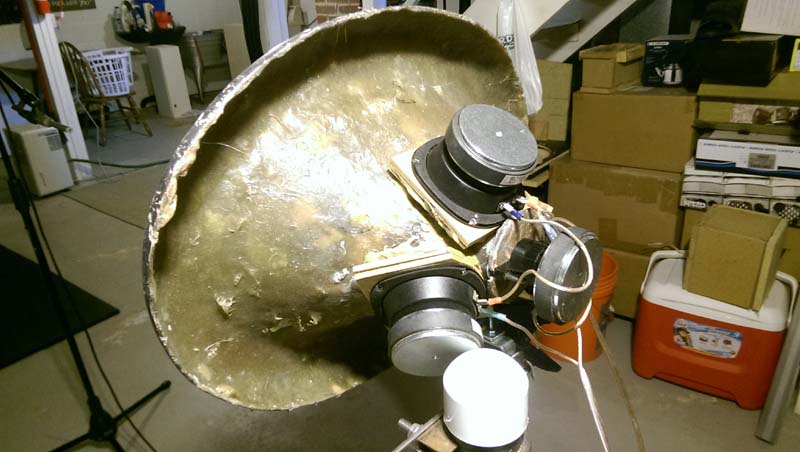

OK........on to the experiment. First I want to say that yes, I do understand that the Synergy horn "should" be a rectangular section and I understand why. My reasoning to go elliptical is 1) I don't see a square section horn as being the ideal shape for the wave, and 2) I have an eoswg just laying around, but no square horns. Elliptical it is. The wg is an EOS job that I built a little over a year ago. 18" wide with a roughly 90x60 pattern, and a 1.5" radius roundover: http://www.diyaudio.com/forums/multi-way/258674-diy-18-elliptical-waveguide.html. The drivers are the aforementioned 4" Celestions and a BMS 4524. I don’t have any pics of the mid chambers at the moment, but they consist of a 2” counterbore frustum that’s .4” deep and a .5” port that’s .35” long. I didn’t intend to make the port that long but my wg was thicker than I remember.The port is offset to the edge of the frustum, and the driver is mounted such that the port is at the edge of the driver over part of the surround. The center of the port is 1.5” from the cd exit which is as close as it can get. My thinking was that 1.5” plus my estimated distance to the phase plug/back plate on the BMS would put the cancellation notch where it would be workable for the xo. I’ve done enough Horn Resp models over the years to know that this would get me close. I’m using 3 mids for this, with the ports spaced equally, wired in series.
Sorry for the lousy smartphone pics. Data is coming next.

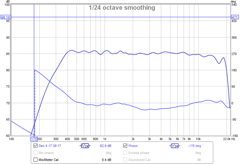

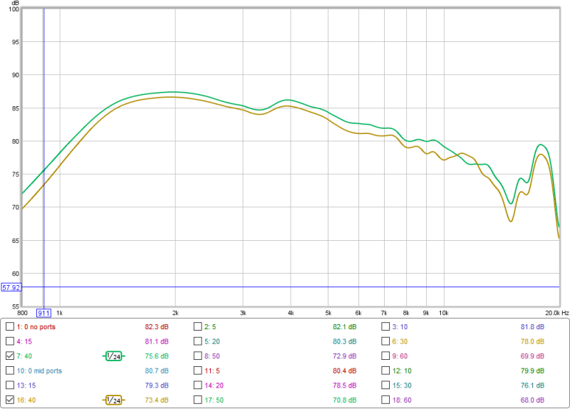

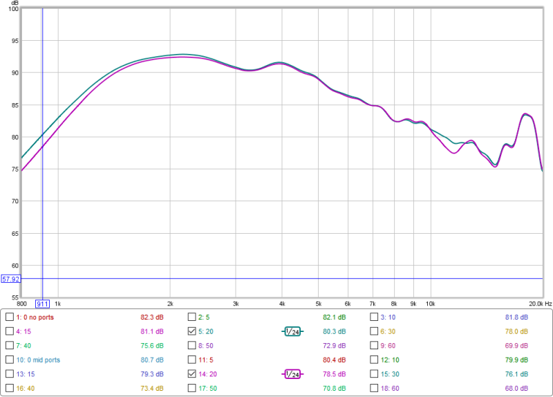

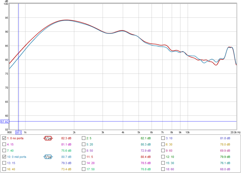

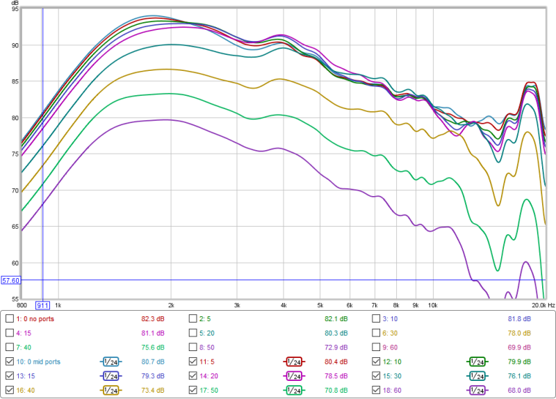

My measurement environment in the basement isn’t ideal and a 2.5ms gate is the best I can do with a measurement distance of about 3’. NO eq. First, I measured the wg/hf driver without the ports. Then I added the ports and mid drivers and remeasured with the horn in the same location. I need to do some more measurements and check the vertical and oblique, but this is much better than I expected. The worst of the fr anomalies is at 20° over 10khz, and at 30° and beyond the level seems to fall by 1-1.5dB over the full bandwidth. I don’t know how to explain that, other than maybe the wg itself was shifted a bit to the side from the no port measurement, causing it to be farther from the mic as I went off axis. Need to tighten up my measurements next session.
The first set is the wg/hf driver with no ports, and the second set is with ports and the mid drivers are hooked up to the amp and muted. I've also included sets with angles picked out that show the difference between ports and no ports.

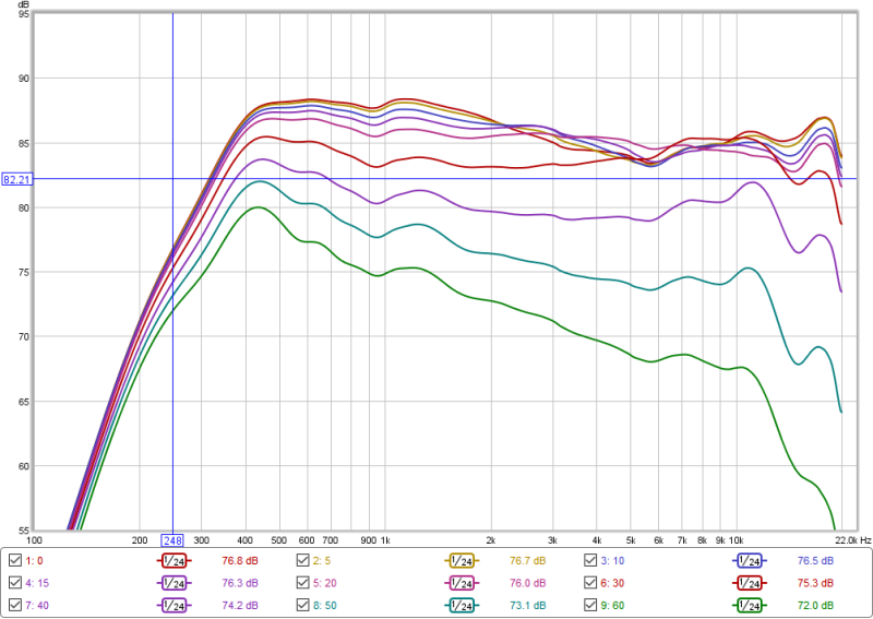

Here's the polars for the hf/mid combo. The xo is acoustically about 6th order at 1.2khz.......I didn't spend a lot of time optimizing it. I took the liberty of extending the gate out to 5ms and adding a 5 cycle freq dependent window to get a little better idea of the low end response. A 300hz hp looks like no problem, even for this small horn. When the hf driver is eq'd flat the levels are nearly matched. I put the horn on a stack of a couple sealed 15's and knocked up a quick xo. I've been in the basement listening in mono all afternoon and it actually sounds quite good as it is. There's something about this speaker that my main rig (which I've been optimizing for a year now) can't quite do.....and this is just a rough prototype! I was worried that pushing this little cd that low would be pretty bad but it's actually holding up quite well even at higher spl.

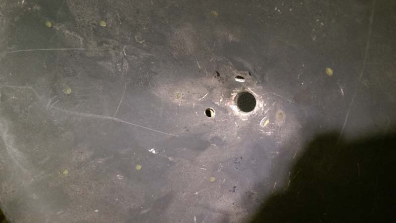

The whole point of this experiment was to see the effect on the hf response of the mid ports to see if it's worth building a larger set for my main system. Going in I was quite skeptical and I've built enough junk to not have any pride in saying it didn't work out. That said things are looking good so far.....

Is the idea to improve the waveguides ability to go lower in frequency to a lower crossover point? But then how do you match the woofer directivity to that of the waveguide? And won't even a waveguide that size loose control below say 700 Hz.?
The ports made far less effect than I would expect as well, but then they are very small. You probably can't do good polars for the mids in your situation right? I would be very interested in seeing those.

I have some ideas about making the effect of the ports even less, and some tests of this new configuration on a flat baffle have shown to have the effect of extending the mid response a bit. I'm going to try that at some point to see how it works out. I've also got some foam throat plugs cut for this wg that I'll try and see if that lessens the effect.

xrk - Seems Paul and I are on a similar path.........he just made one first! I've been thinking about an EOS Synergy for a long time but now I have the ability to make it happen. FWIW my main rig is a high eff job with about a 120° pattern down to 300hz so it's no slouch.
Using three mid drivers is a bit odd as far as wiring goes. I've got them wired in series now because I doubt the test amp I'm using is stable under 2ohms. My main amps are Hypex uCd180 and I'm told by an engineer there that it will be stable under 2ohms. We'll see when I get there!

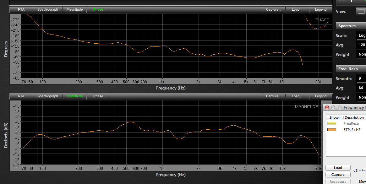

The band pass mids are acoustically delayed from the HF, and may not require any delay, the opposite may be true.Neat!
Here's some things to try to take it to "the next level."
2) Measure the distance from the throat to the midrange taps. Now set the lowpass on the midranges to achieve an acoustic lowpass that's about 3rd or 4th order. The idea is to introduce a delay that's enough to keep the midranges from radiating until the tweeter "catches up"
The HF is physically further from mic but measures .62 millesecond closer in my SynTripP.
The screen shot below shows the combined raw response of the (ported, Fb 81 Hz) cone drivers and the HF driver, note how smooth the phase response is with no delay applied.
That's pretty good considering it just happened that way.
