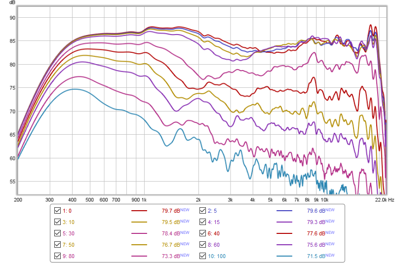

Looks good. Very consistent out to about 45 degs? Then the highs drop.

I got the horizontal contour plot put together last night as well as the vertical. The vertical response ain't pretty......hopefully I'll have time to get those up tonight.

Here I'll show the vertical response, measured on the "top" half of the wg where one of the mid ports is on the same plane as the cd exit and the mic. A little background here: http://www.diyaudio.com/forums/multi-way/258674-diy-18-elliptical-waveguide.html#post4085114. In that post I show the horiz and vert response of this wg without the mid taps. Earl points out there that the ripples seen in the vertical response are edge diffraction, which makes sense to me. I believe what I'm seeing here is the edge diffraction from the mouth with diffraction off the port falling into the same 1-4khz region. Not good, but not terrible either. I think a larger wg with a more suitable mouth roundover would help take care of the edge diffraction then maybe the port diffraction wouldn't look so drastic. Sound reasonable?
Note that there's no 20° curve.........I don't normally work with Holm and I must have saved over it with my next curve and kept going. Doh! Due to that I won't post a contour plot as I don't think it will be as accurate with the missing curve. Idk......maybe close enough?
I should have measured the other "side" of the wg in the vertical but I was getting cold and had other stuff to do. I'll do it indoors though, and I'm curious if the foam will have any effect here.

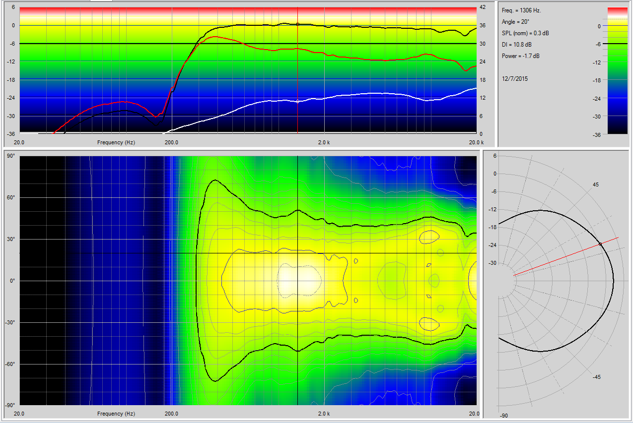

@ Earl, is your plot recommending a listening angle and target response or have you just shown the data as is?

Wow, look how low the pattern control goes. Congrats Nate.

Thanks Earl and thanks for the comments guys it does look quite good. Looks like Earl's data and ARTA's interpretation are fairly close. Earl's PolarMap shows the pattern a bit wider than ARTA but I suppose that's due to the way the interpolation is handled as well as the avg 0dB used? Let's not get too excited though........any comments other than Allen on the vertical response?
