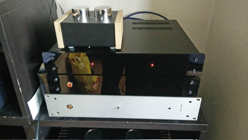

Playing music at last, and insulating sleeves fitted for safety. It's still in its 1st hour and lovely wide and deep soundstage, still settling in of course. I'll let it settle down for say 50 hours to see how I feel and then move it to a case. Any suggestions on something available in Europe that looks nice - have to be 45mm clear height inside minimum, and advice on how close the trafo should be while avoiding hum? What have people used succesfully here?
This one.... with 8mm black, blank plexiglass/acrylic front looks really gorgeous, and the price doesn´t scare anyone 🙂
DIY AUDIO Chassis Toroidy DT5 - Shop Toroidy.pl
I used these in full size (width) for my X-Ono phonostage and PSU. Looks really good (at least I think so) 🙂
My DIY DAC at the bottom, PSU and X-ONO and on top is my DIY Silk Audio SUT.
Maybe you should just use 2 enclosures, 1 for riaa and 1 for PSU 🙂
To avoid contact humm place transformer in seperate housing.
Know, this was for Koifarm, just my input....
Depends on, what you mean by "similar material". Alu isn´t very good for screening transformers. That´s why I chose Toroydi´s cases. They´re made of steel, and do a much better screening. Guess you could get away with transformer in same enclosure, if you use a full width enclosure, mount the transformer as far away form the Mini-Me and encapsulate it in some kind of steel screening case, but it´s just a guess.... haven´t tried 🙂

The tubes are microphonic and everything what is vibrating(50/60hz transformer) without mechanical decoupling to the tubes will insert humm thrue the tubes in to the audio signal. Best decoupling is to use separate housing for powersupply(housing) So this is no magnetic or electrical induced humm but mechanical induced humm.
Good point Koifarm.... although our experiences might vary on the subject 🙂
My own DIY dac in 2modul/43 cm enclosure uses one 6N16B-V pr. channel in SRPP mode as final gain stage. It suffers from 3 toroids in the enclosure, and it´s absolutely free from any hum or other bad influences.
But of course I agree with your point.... Different enclosures are the optimal solution 🙂
Boydk,
the 6n16 tube is very less microphonic that is why i choosed to use it for a phono preamp. But using mV and not 1 a 2 Volt signals make the chance to induce humm much bigger.
But using transformator in same housing as tube preamp can also work great.
