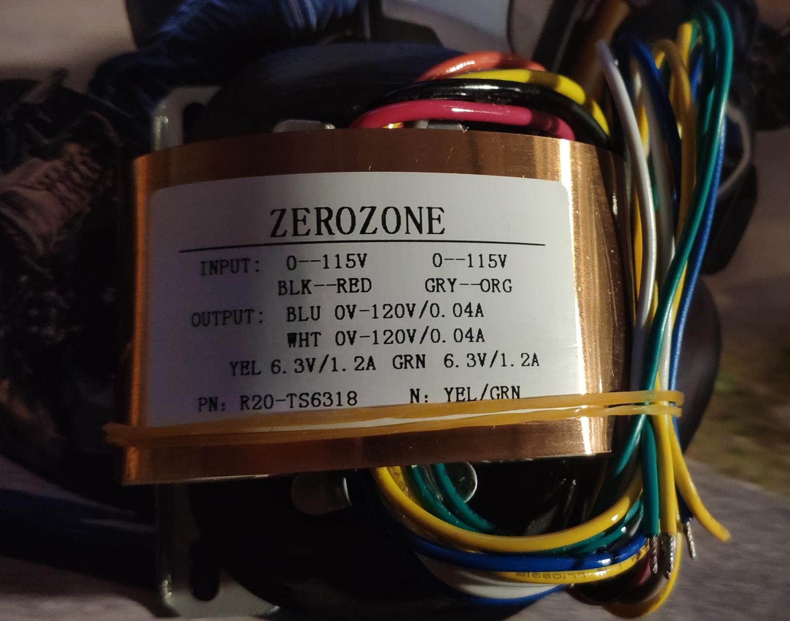

Got my trafo´s today, excellent.
As promised, 7 workdays to finish, sent from Malaysia 6.02 PM on may 22., delivered to me in Denmark 3.00 PM on may 24. 25$ a piece for 5 pieces and 36$ for shipping. This service is pretty hard to beat 🙂

My build is running, no time to test but it runs at 160V with 11mA per side. Heaters seem to only consume 760mA for all four, spec suggests 400mA? They look just fine and run at 200mA if at 12.6V. Onto the scope tomorrow!
Please don't pay attention to the wiring, its just for checking basic function, insulating sleeves etc still in the post.
All measurements are oke. 2 x 2 heaters are good for 2 x 380ma = 760ma at 12v. So is 11ma a side.
