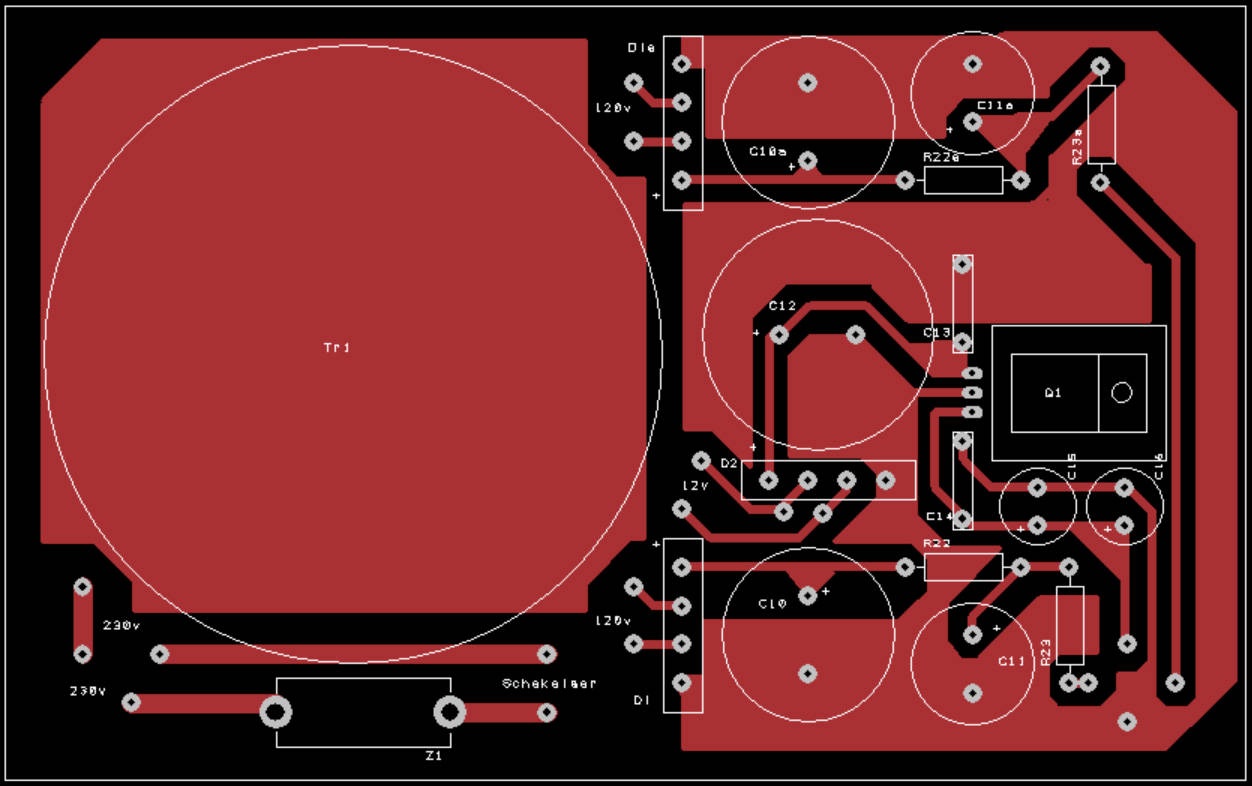

Hi, what is the size of the PCB' s and what instructions do I need to send to a PCB maker to acquire the right PCB?

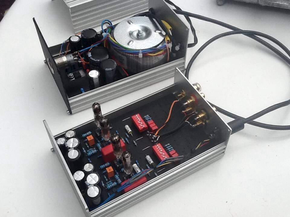

Today i build one MC stage for testing purpose.
I discovered a fault in the PCB at the MC pre input, i shall correct that a.s.a.p.
I did not use the Zener in the MC pre because there was no humm at all. I shall modify the schematic a.s.a.p.. For the heatersupply i used an extra LM7806.
I am very pleased🙂

Hello Sebuschi,
i am still supporting this thread and use this preamp in my phono setup.
The 7806 is not needed. V5 en V6 of the mc pre have the heaters in serie on the 12v supply with is stabelized with the 7812.
I used the 7806 only to test one channel of the mc pre. I neede just 6v for one heater.
Ronny

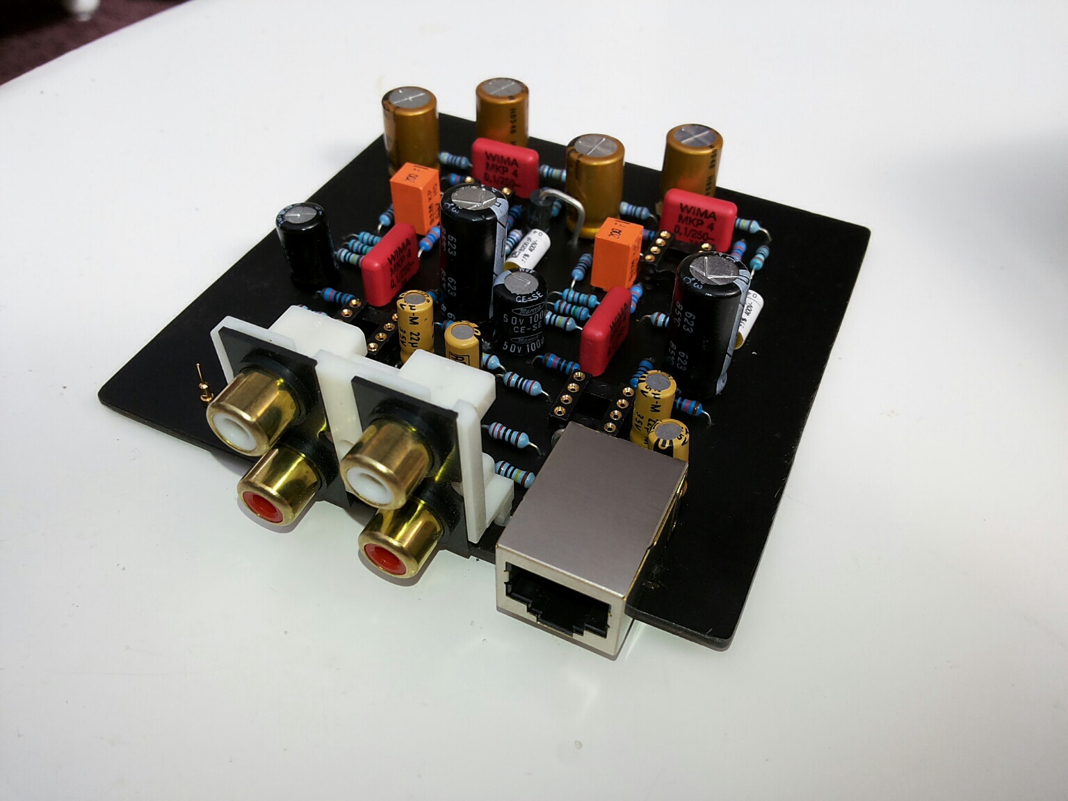

hello im looking for the capacitor c5 and c 8 what kind of capacitor ist it
im only find mica but only 5%

I used nos film/ foil cap. But you can also used the ones in your link or link below.
2pcs-PHILIPS (BC) KP 200P (0.2nF) 630V 1% Axial Polypropylene Capacitor - KP464 | eBay

Measurements with 100 Ohm at the input.
Amplication = 3000x
SNR = -77db
At what output level? Guessing at 1Vrms, that is 333uV at the input, implying an EIN of 47nV, which is impossible! Something is not right here. Under realistic conditions the MC input SNR is not likely to be better than 50dB.
It is possible that i interprate the measurements wrong. In reply 11 and 12 i ask how to read the graph. No one anwser.
What was your output signal voltage level?It is possible that i interprate the measurements wrong. In reply 11 and 12 i ask how to read the graph. No one anwser.
Your software probably uses averaging to reduce the noise floor, which will make the results seem quieter than they really are.
Incidentally, your choice of MC input stage is quite noisy. You can improve the SNR by perhaps 4dB by connecting the two triodes in parallel and using a simple anode load resistor, instead of stacking the two triodes.
are this the capacitor c8 in your preamp
10x 200pF 63V 0.2NF 63V 1% EMZ KP HI_END FILM/FOIL CAPS FOR AUDIO ! | eBay
and c5 like this one
50x NEW ERO MKP1839 (axial mkp1837) 8.2nF 400V CAPS 1% HI_END TUBE AUDIO ! | eBay
