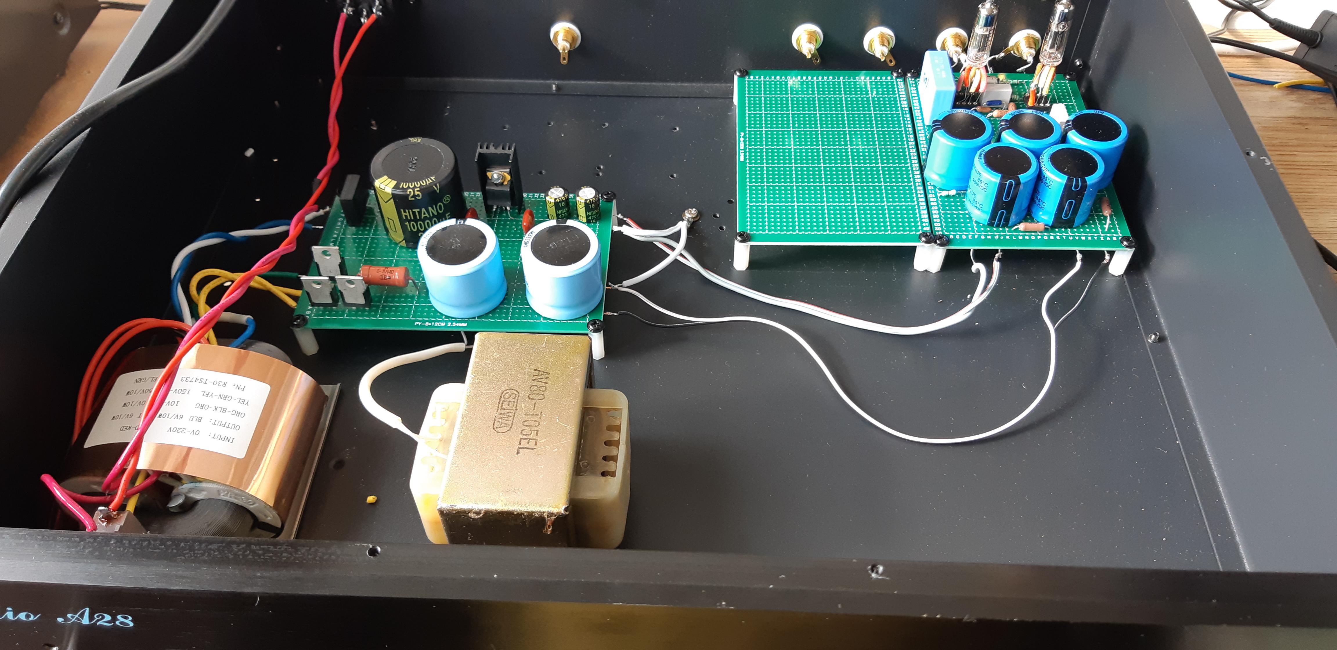

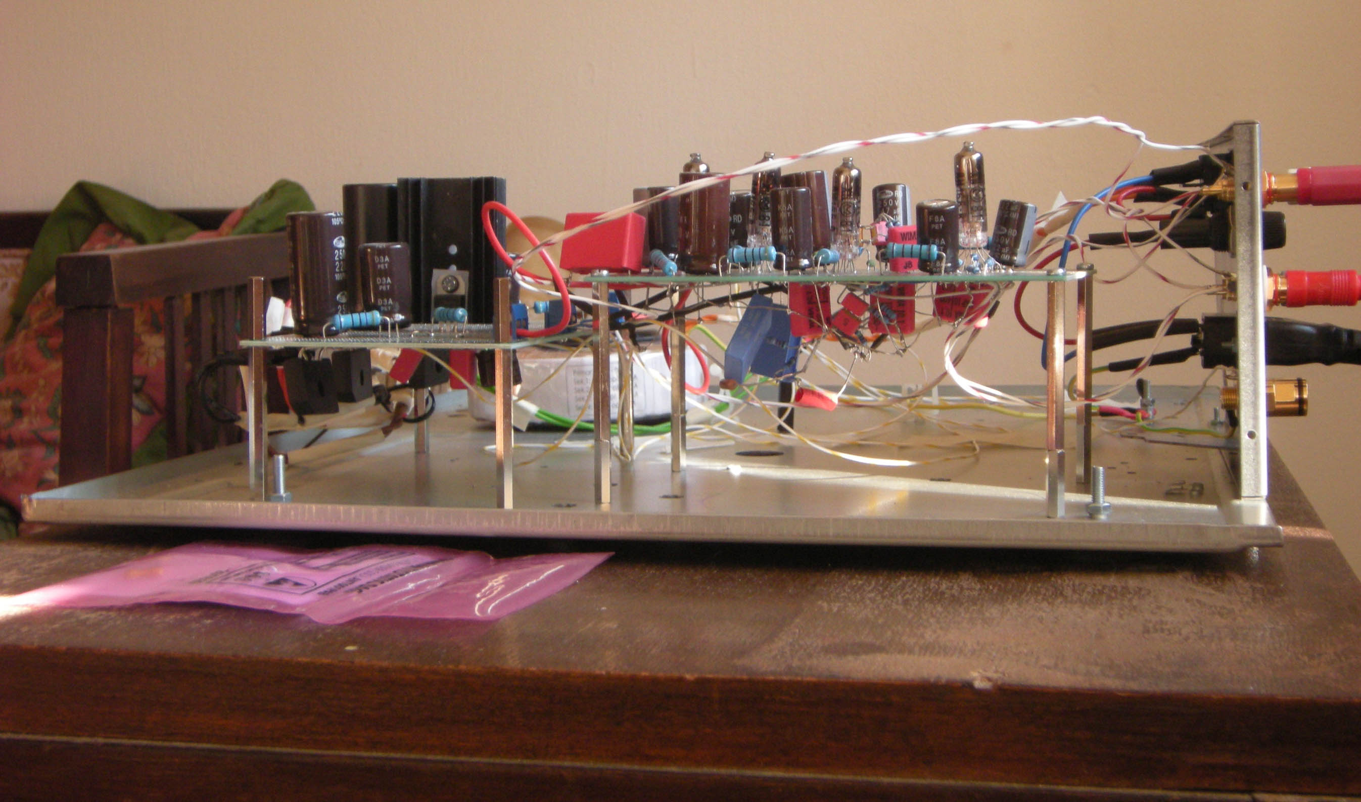

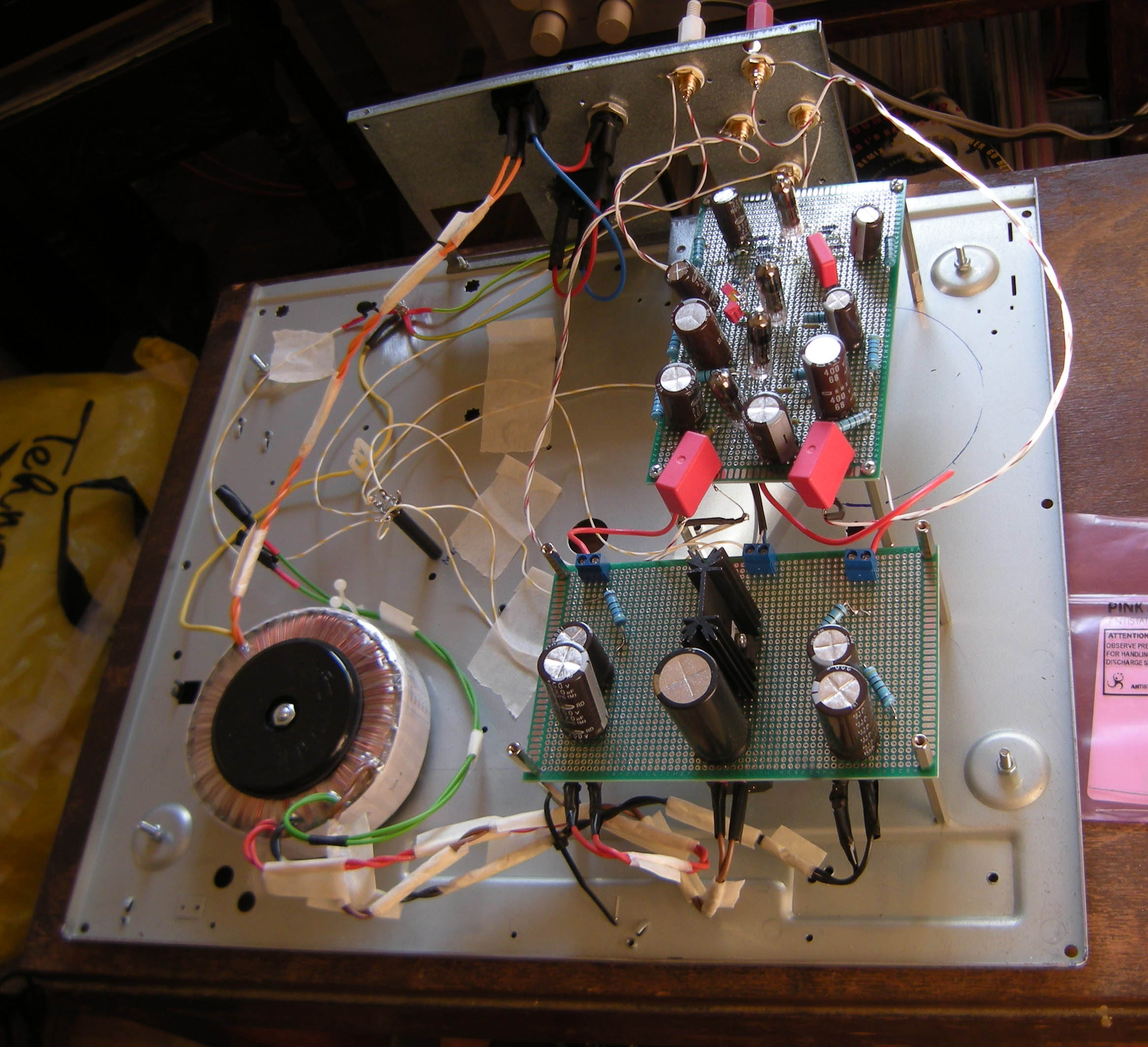

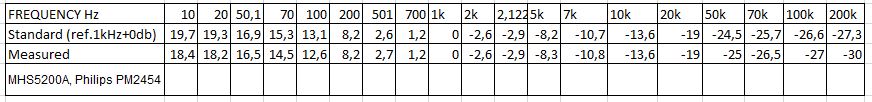

Hello!
I assembled this scheme and got the following result by RIAA.
Spreadsheet/Table
I was comparing the sound with the EAR 834 and Leben rs-28cx.
I was very pleased with the results.
But there is one problem!
With a short-circuited input there is a pulsating signal from 1 to 30 mV on the output.
I think that this is because of assembly, since I was assembling several prototyping boards in different combinations.
Clamping resistors didn't make any effect.
I concluded that it is necessary to make an assembly on a printed circuit board.
I'm asking for help with the purchasing of the GERBER file for this scheme.
Sorry for my English.
Best regards, Leonid.

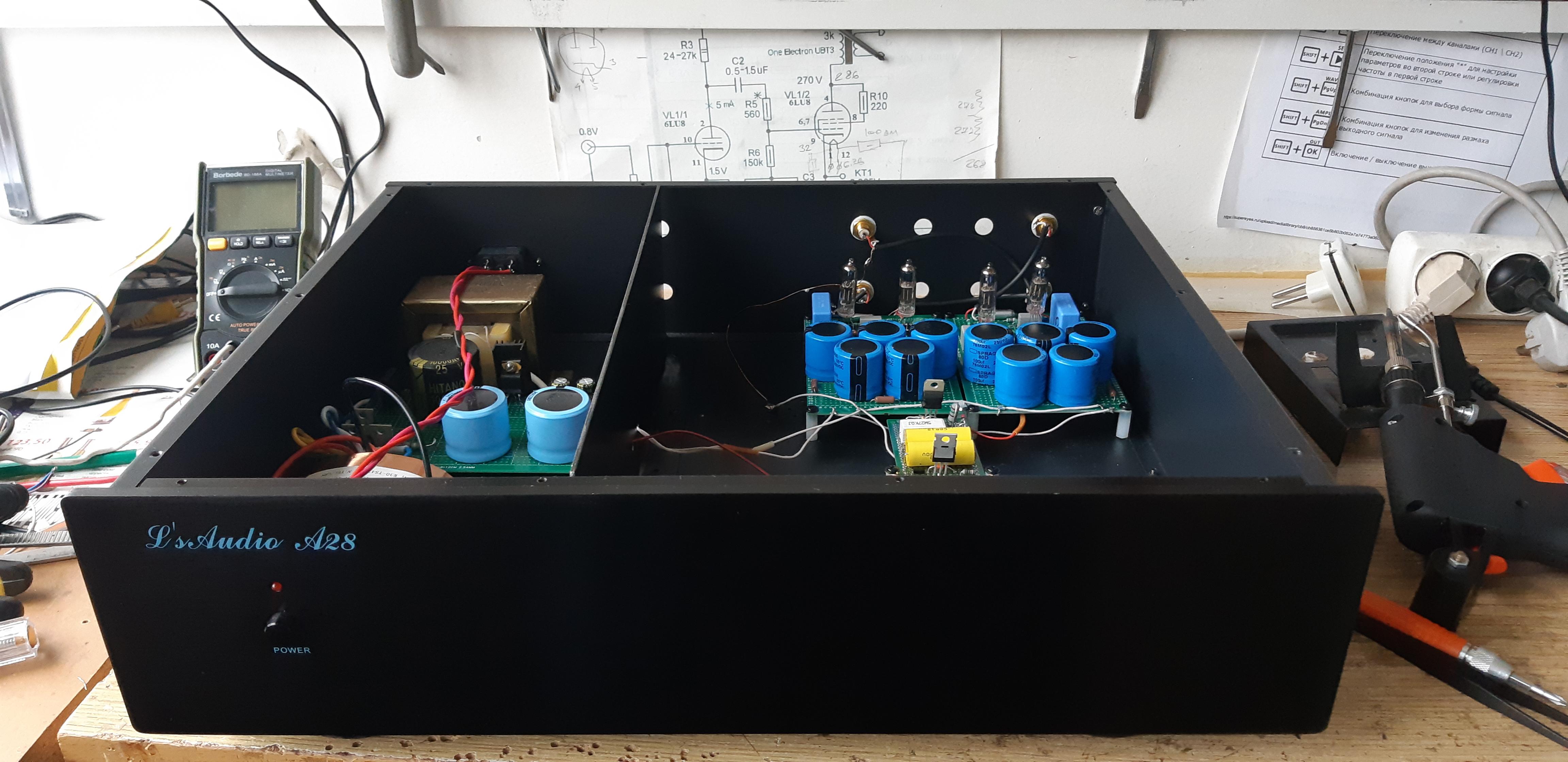

Hi!
Unfortunately, not quite, only up to 5mV
The next option I will make in different cases power supply and the actual corrector
I really like the sound
Many thanks to the author of the scheme and to all participants.

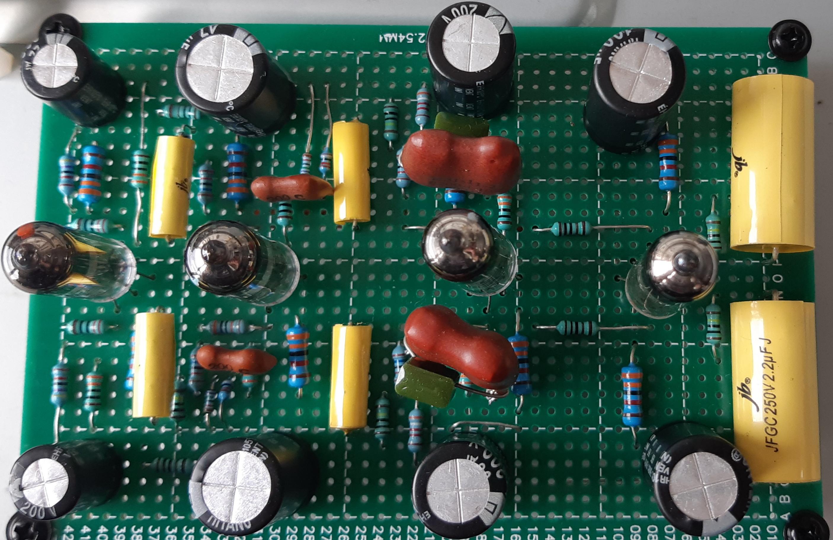

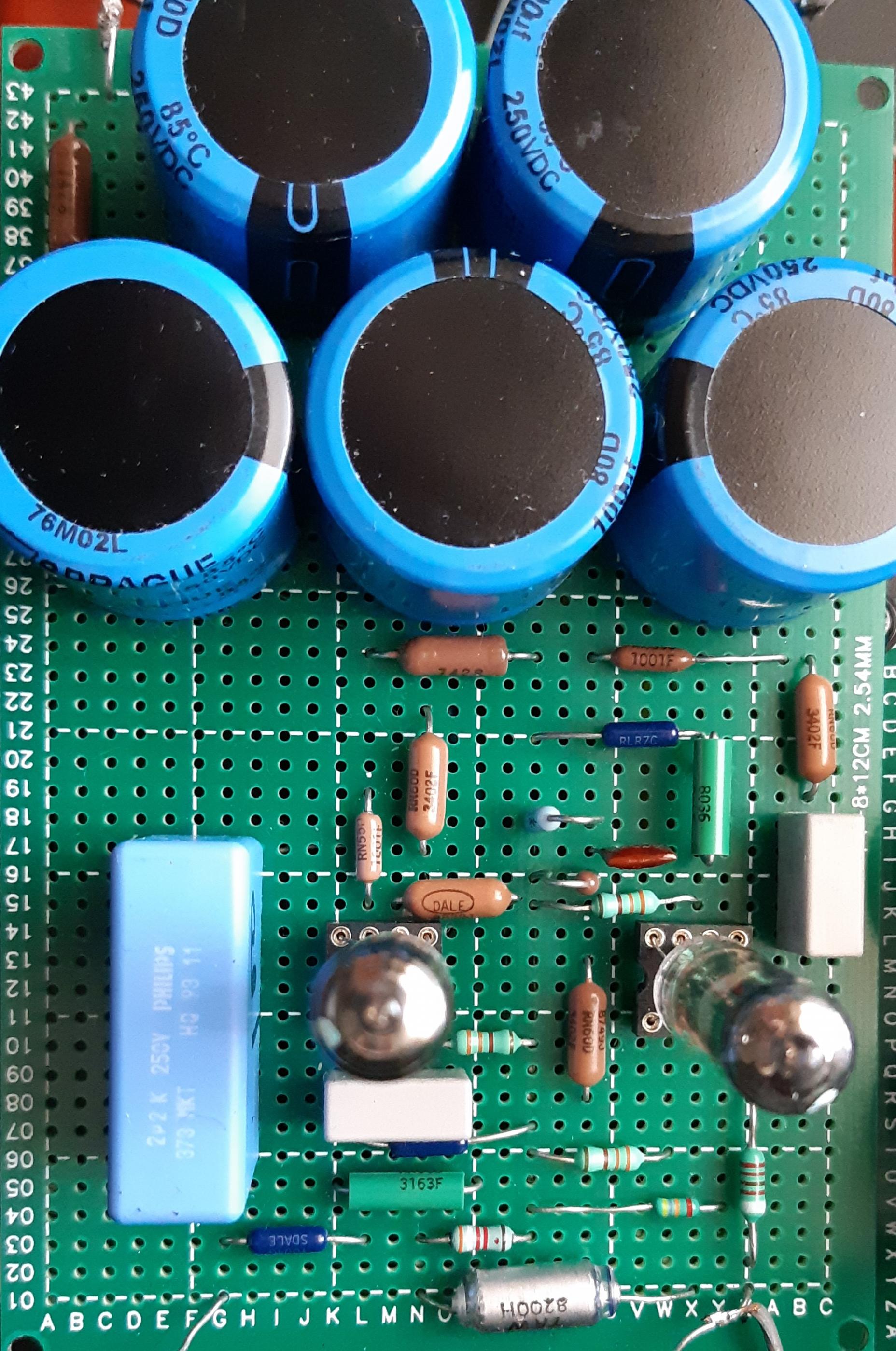

Hello
This is my first build, "junkyard" style, done for educational purposes mainly.
Before making it on the proper pcb ( thanks Flancfluster ! ) i have a question :
Generally speaking and without measuring equipment, the sound is very nice but the bass is very thinn.
My guess is that fr range below 300Hz has something like negative tilt.
So how to proceed and resolve the issue ?

Normally there must be enough bass.
Did you use the right load for your cartridge?
What is the inputimpedance of your next stage?
How big is the output capacitor?
And did you use 100nf couplingcaps between the stages, i can not see the values on your pictures.
They look only 10nf. Then there is also no bass.
And measure heater voltage on the tube.
Shure V15/3 on Lenco L75 in stock form ( cca. 230pF ? ) + 47pF at the input connectors - not on pictures.
All elements as per schematic - 100nF coupling caps, 2u2 output coupling cap, 200pF in first RIAA filter ( parallel ), 8n2 in second RIAA filter ( parallel ), 316K precision measured resistors.
Heaters on 12,26VDC
Will check the values, they should be 100n.
Everything star grounded and from there goes one wire with 10R NTC to Earth.
