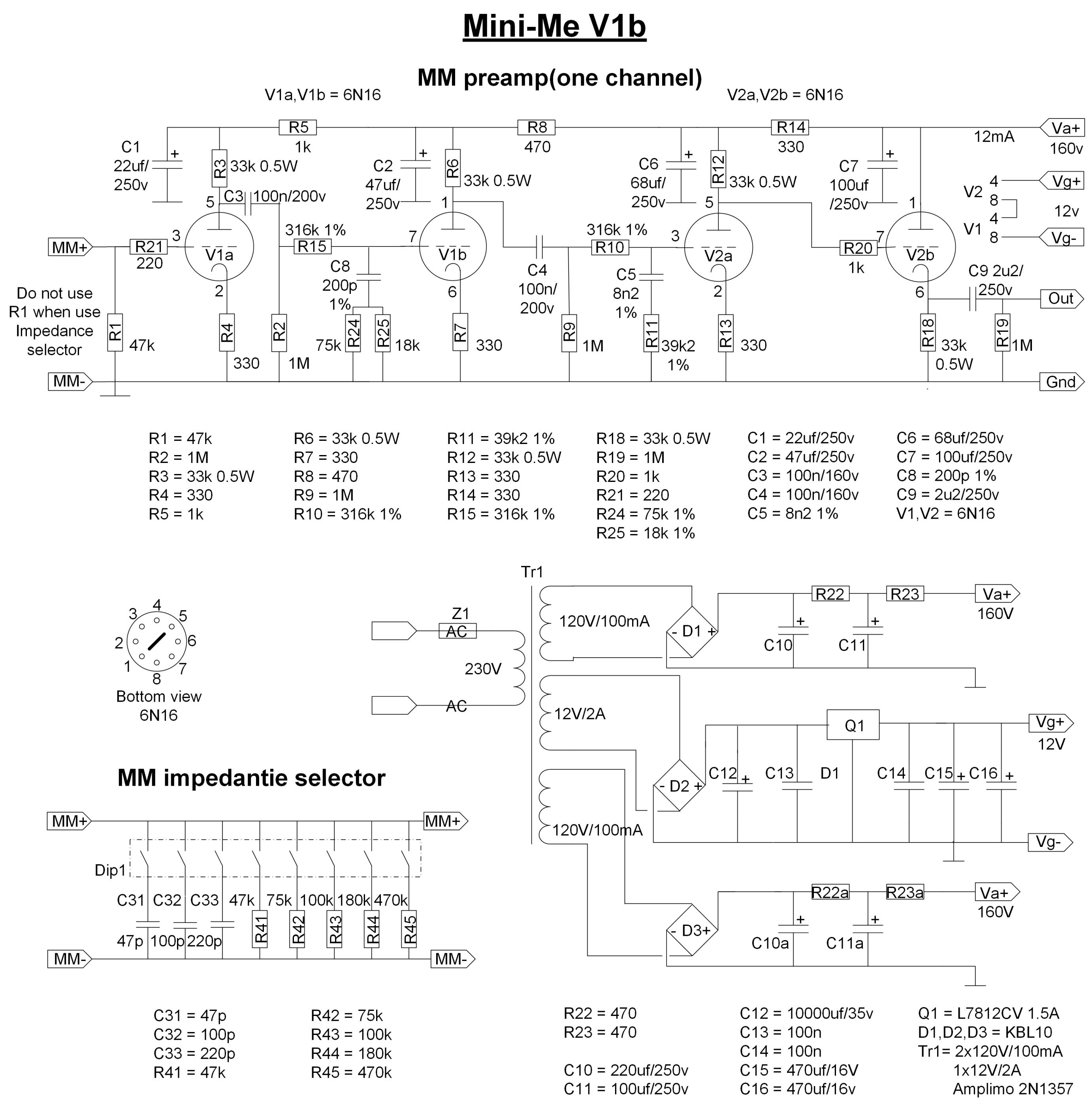

Mini-Me phono preamp

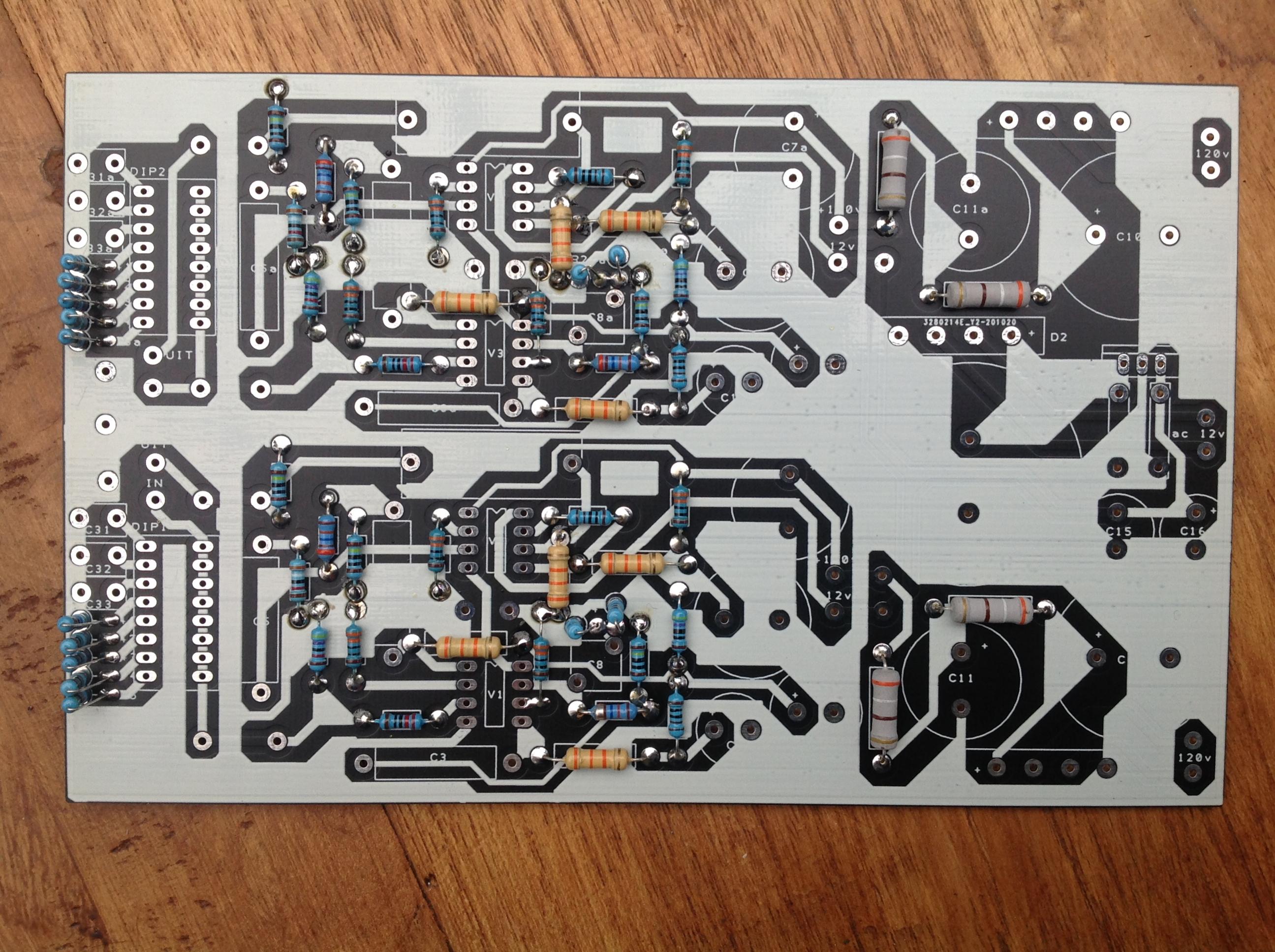

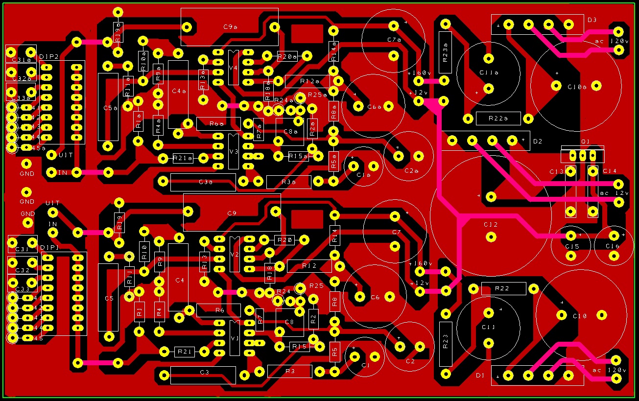

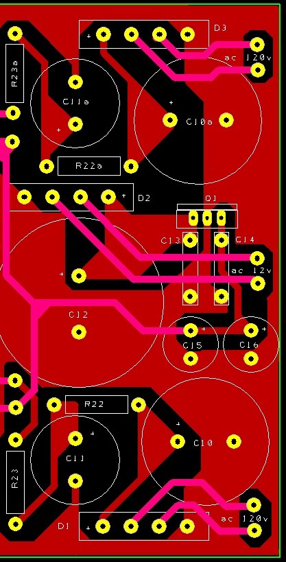

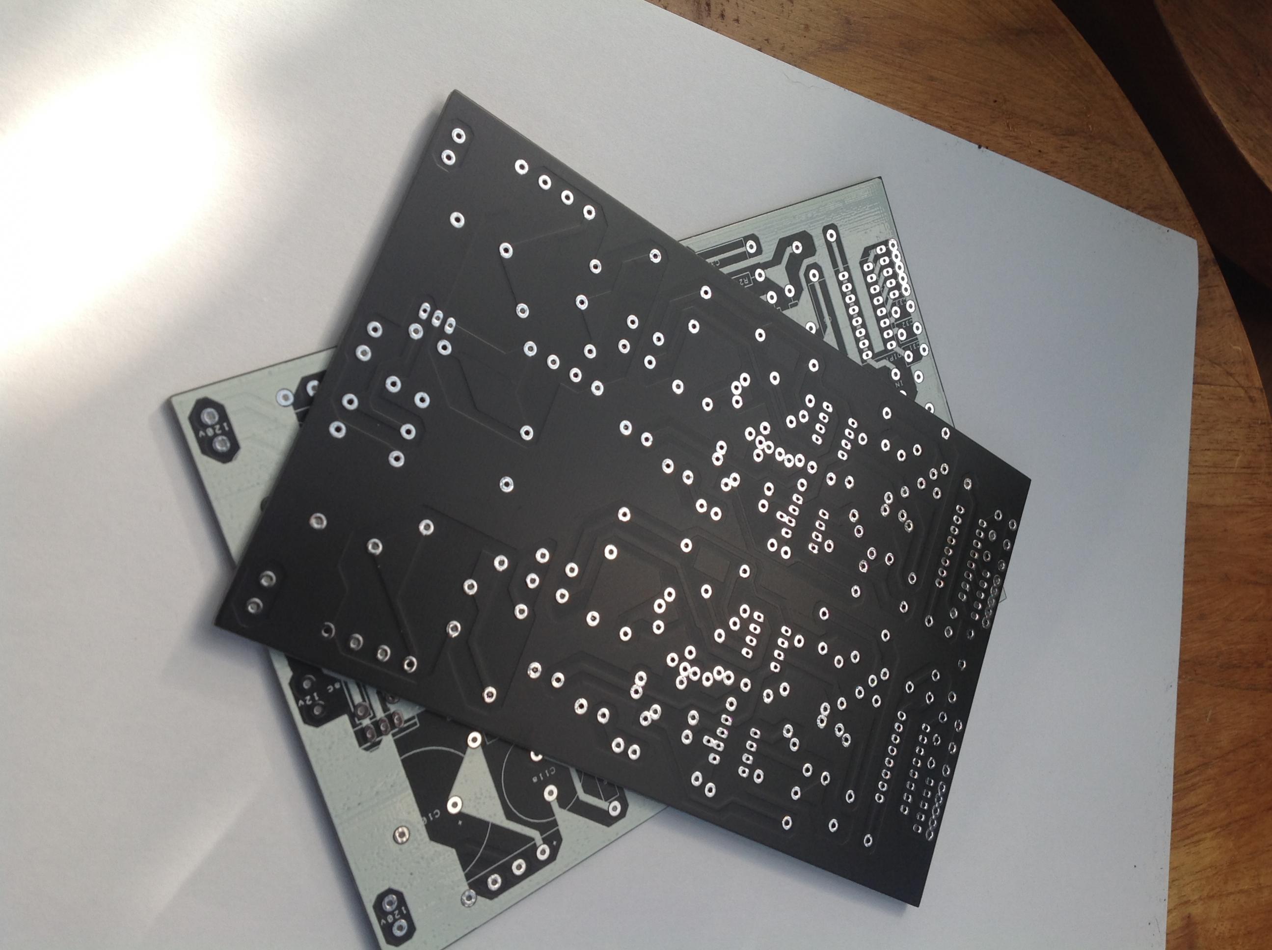

I have made a new Mini-me PCB.
Just ordered 10 pieces.
This PCB you can(not needed) mount tubes and dip switch on solder side.
Then dip switch can changed at upper side of casing and the tubes stick out of the casing.
PCB has all the parts for a MM Mini-me except the transformer.
After PCB is tested, rest is available.

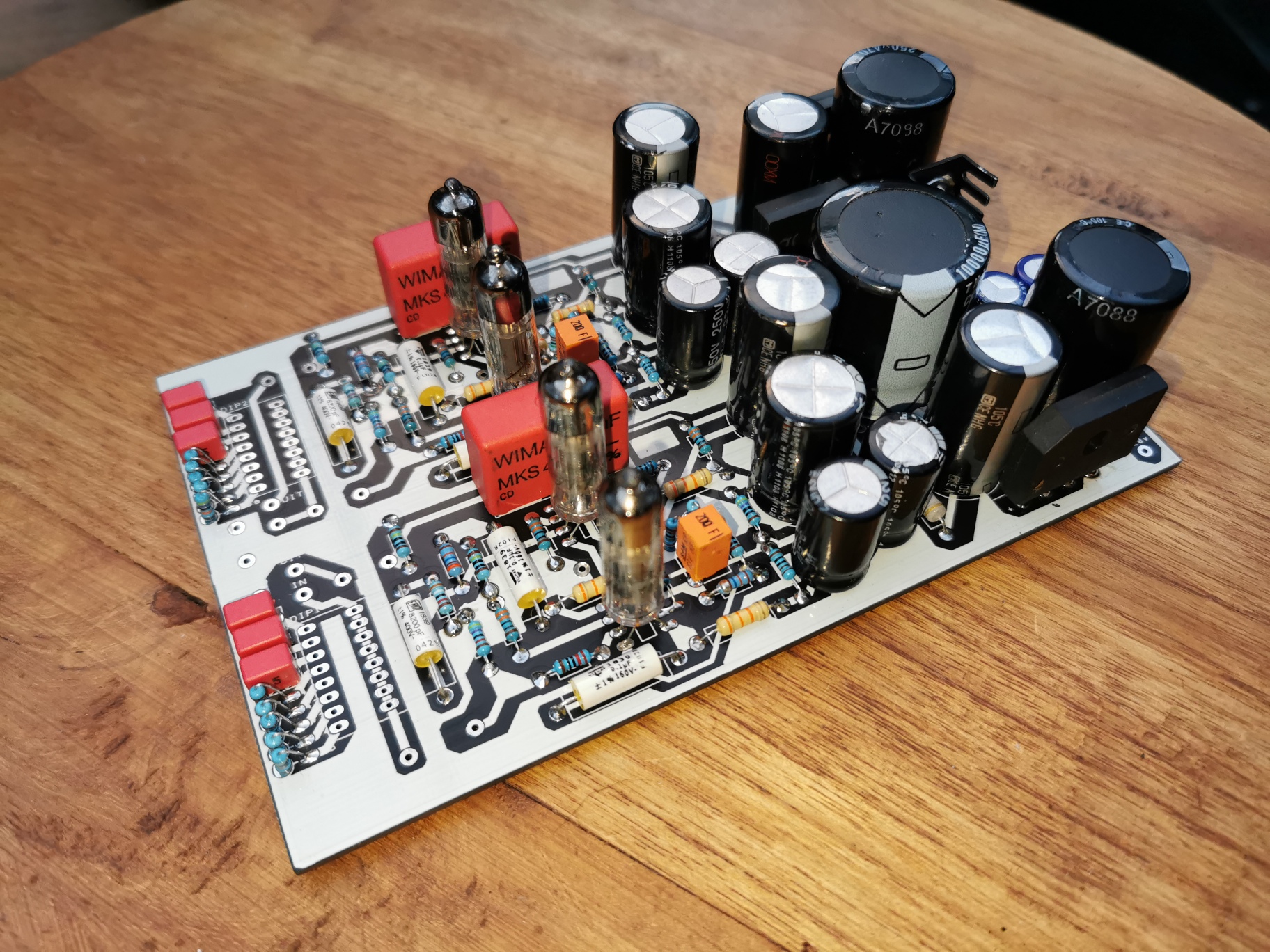

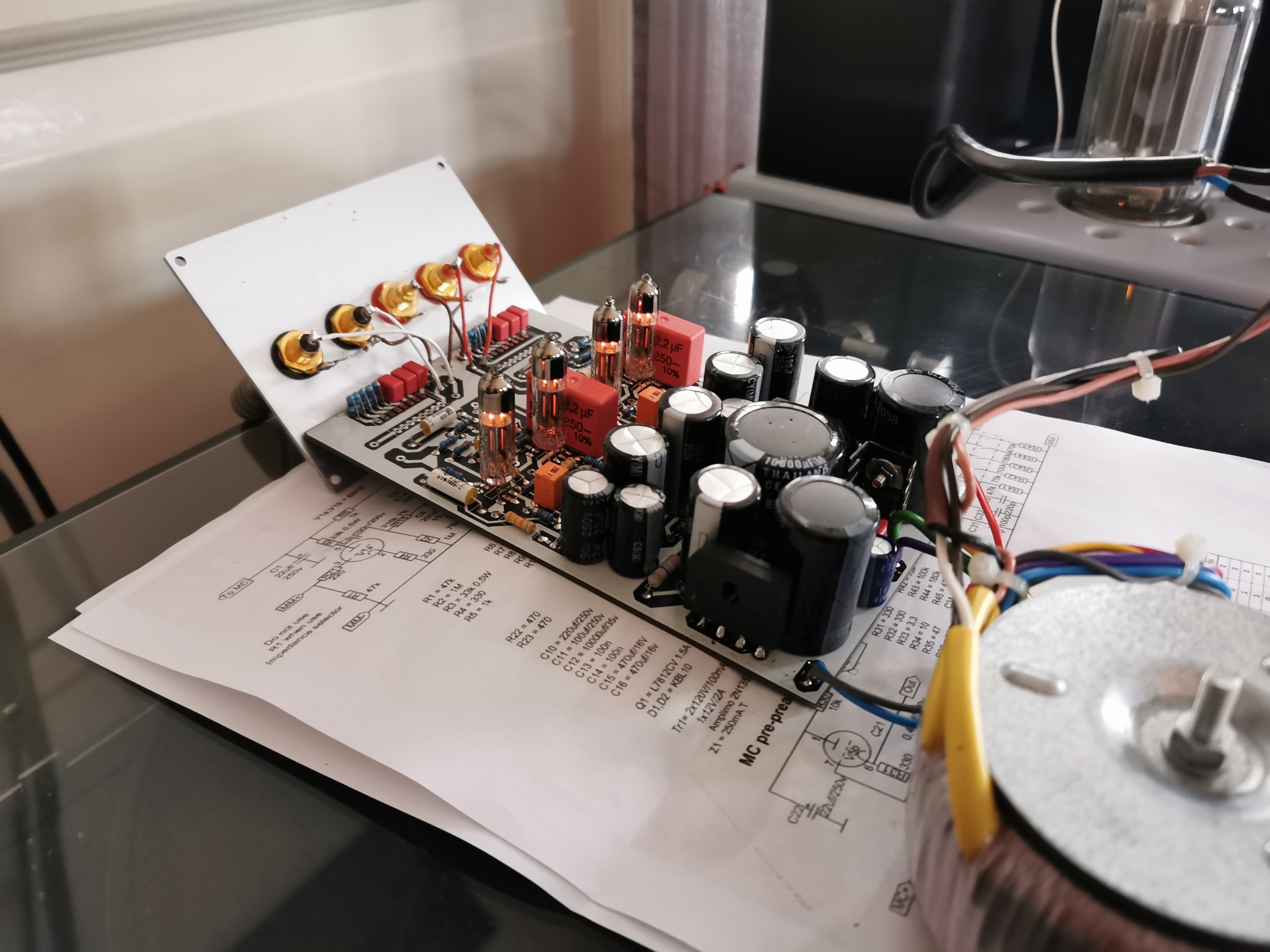

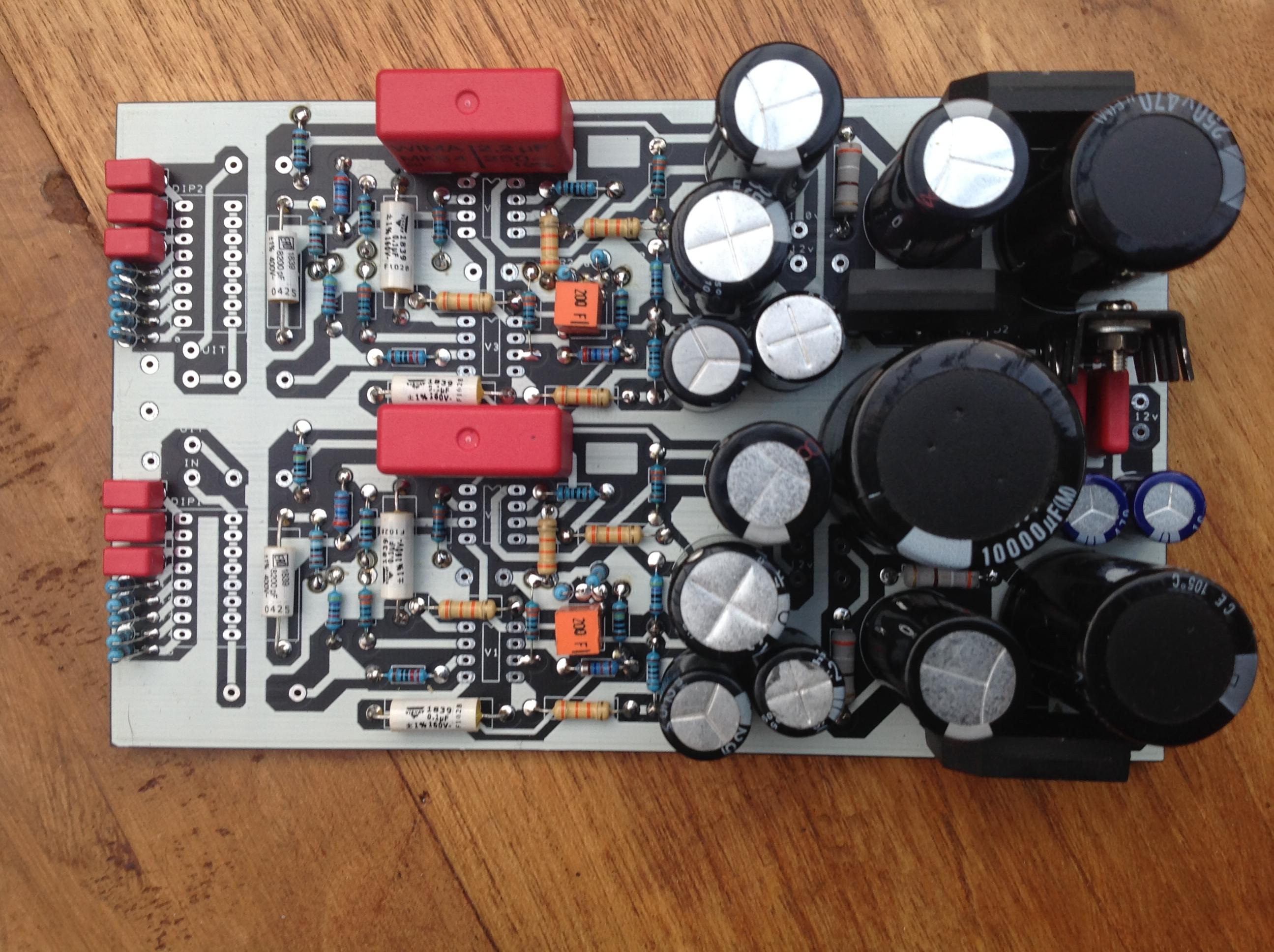

Did some soldering today. Test it tomorrow.
Had to drill 2mm holes for 3 biggest capacitors.

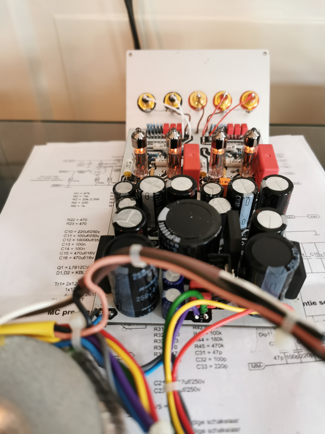

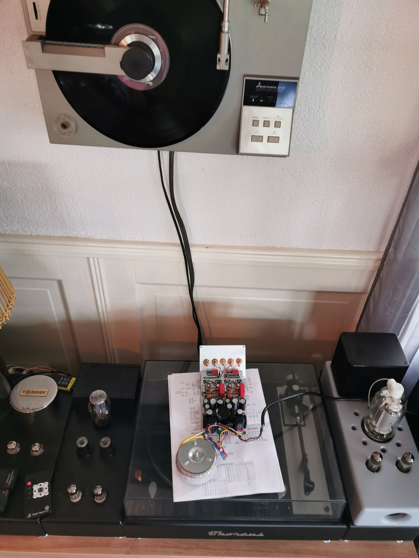

Further simple build.
