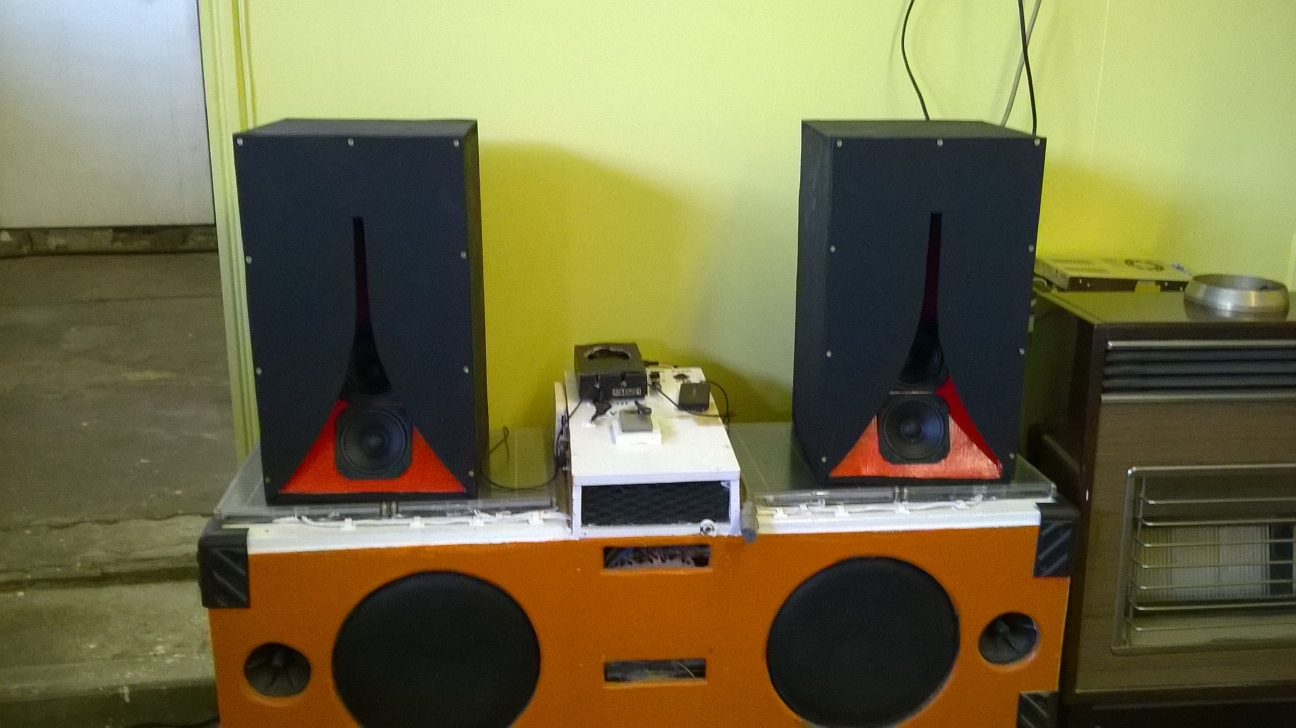

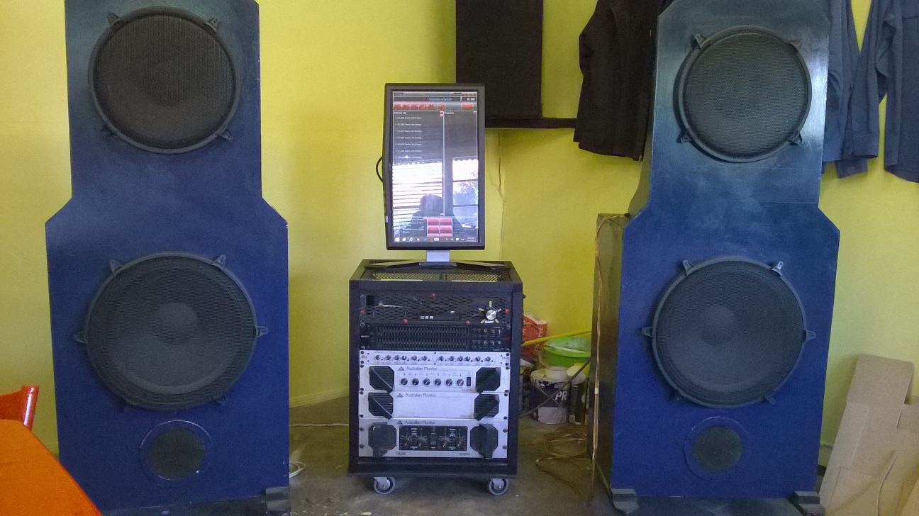

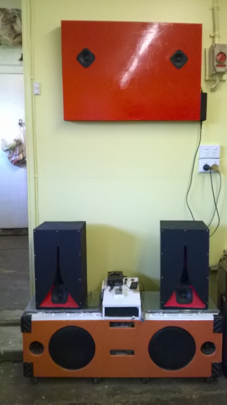

The Karlsonators sound great.Here's a picture alongside one of your MLTL's and a Boominator variation. Also a picture of my main system.
I love these cheap,easy to make,great sounding designs.

Is that a FAST type boominator using a full range of is that a real tweeter?

Thanks, I don't know what FAST stands for.
It is a copy of Saturnus's original with piezos.
It's getting recycled into a new version with PHT-407N's for which I have finally found a source in Australia.(with a mini DSP).
Maybe the most interesting thing there is on the main system which has a box with 6 output transformers for the lateral mosfet amp- don't have to worry about DC in the compression drivers.

The 0.53x dual Vifa K'nators have always been one of my favorite speakers. They still sound great and hold their own against many of the more complicated and more expensive speakers I have heard.
Glad you are enjoying them. Did you make yours out of FC or wood? Can't tell since they are painted.
The body and baffle are 12mm MDF.
The rest of the internals,braces,and Karlson aperture panel are 6mm MDF.
All panels sealed with silastic and glued with construction adhesive.
It's airtight and solid with no extraneous noises.:)
I wish I had of ordered two boxes of drivers (45 to a box),as I will have to get more to build the line arrays.
The MLTL's are great presents as they're so easy to build.I'm going to make a slightly altered version with two centre dividers covered with extruded mesh,between which are the amp and power supply.Connectors on bottom panel.
