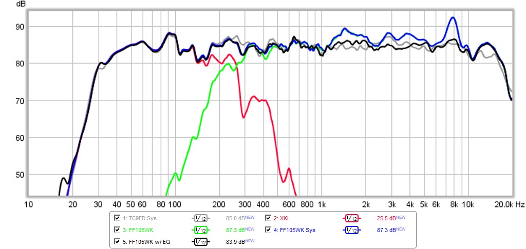

I am just testing my new FF105WK's and there are a couple of serious peaks and a small plateau even. It's all there in manufacturer's spec sheet - just did not realize how much it bothers me until I listen to it. It can be easily EQ'd out, but then why not just get a paper cone driver like the RS100P-4 that is smoother, or the Bery smooth fiberglass TG9FD, etc ? Or of you have more money, get the 10F/8424. The aluminum cone RS100-4 can be tamed with strips of tape, but I think rubber cement may work well and be reversible.

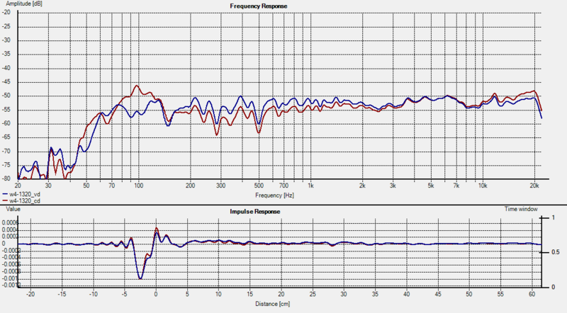

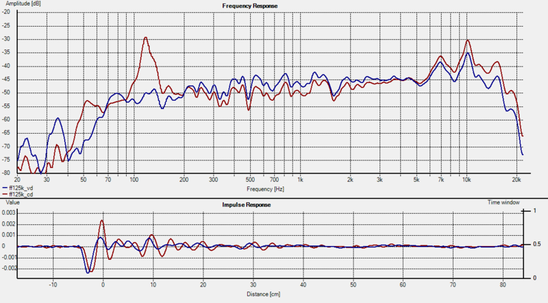

Here is the result of a current-drive chip amp on TB W4-1320SIF in DCR and FF125K (no W, the old series) in 8L reflex:
It sounded as terrible as it looks in the mid/upper bass region. 🙂 The W4-1320SIF did fare better because of its relatively lower Qm versus the Fostex's high value. The added high-frequencies above ~10kHz due to voice-coil inductance was also not necessary in both cases IMO.

Where does one get a current drive chip amp? I thought the Pass F1 was one of the few current drive amps out there for DIY. I am really surprised that the current driver produces the huge mid bass peak at 100Hz and 120Hz. What causes that? You are getting the some serious 7kHz and 10kHz peaks on the FF125K that are reminiscent of the peaks on the FF105WK that I had to EQ out to make it listenable for more than 5 minutes. At first it sounds interesting and full of "detail" but it wears on me fast.
Wow, I'm surprised by your results with the little Fostex (I have no experience with Tang Band).
I don't have any measurements but my fe108es and ff165k, both in BIB cabs, sound MUCH better in all regards with my f2 amp. More bass, better highs, more natural sounding in general. It's not even close.

Here is my FF105WK in a FAST with XO at 225Hz. There is a -3dB baffle step compensation high-shelf Q=0.5 EQ applied at 750Hz. The blue is the non-EQ'd for peaks and the black curve is after EQ applied to tame the peaks. That is a 10dB peak at 7.8kHz - and the 5dB bump at 1.5kHz is very fatiguing with female vocals. Grey is TC9FD without EQ.

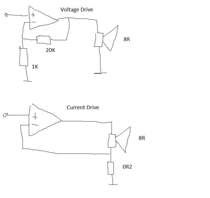

Here's a very advanced CAD rendering: 🙂
I just did that on an LMxxxx I have, I forget the exact part #. Not ideal as it picks up more noise, but works enough for the testing purpose. Mixed mode feedback would be better to produce a given output impedance value. Setting it at ~80ohm might be enough to simulate current drive at ~10X load impedance.
As voltage will track impedance at a constant current, impedance peaks will produce the most power. In the case of the Fostex, the Z peaks may be around 75-100ohm IIRC, so it figures there would be a huge rise in output.
