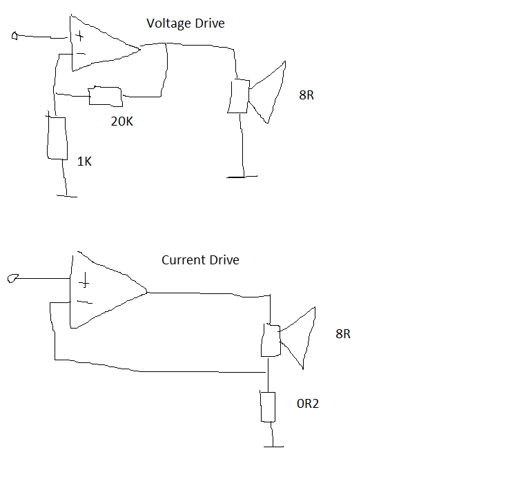

Here's a very advanced CAD rendering: 🙂
I just did that on an LMxxxx I have, I forget the exact part #. Not ideal as it picks up more noise, but works enough for the testing purpose. Mixed mode feedback would be better to produce a given output impedance value. Setting it at ~80ohm might be enough to simulate current drive at ~10X load impedance.
As voltage will track impedance at a constant current, impedance peaks will produce the most power. In the case of the Fostex, the Z peaks may be around 75-100ohm IIRC, so it figures there would be a huge rise in output.
Variable Amplifier Impedance
Ok, so you modified the standard LM8xxx schematic to bypass feedback resistors then.

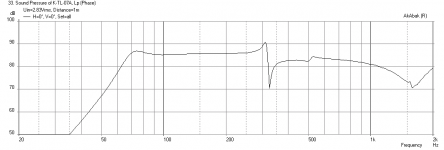

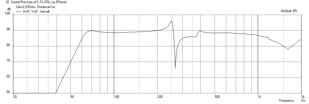

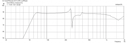

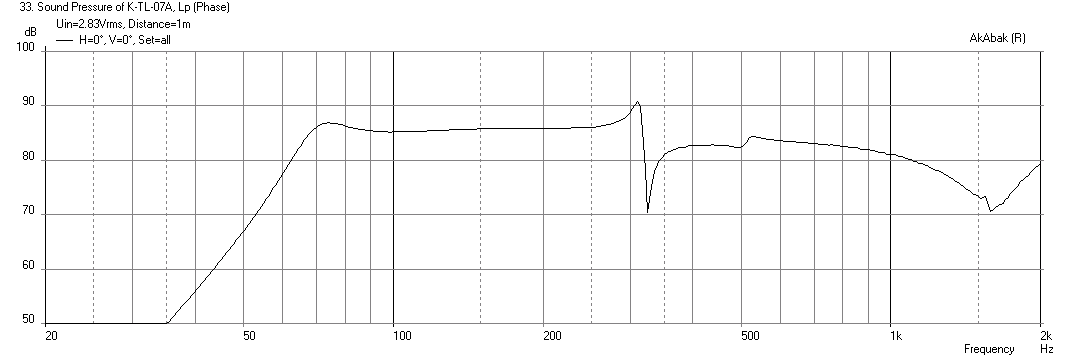

I just ran some sims of the PA130-8 in a 0.53x Karlsonator (single driver) and the PS95-8 in a 0.40x Karlsonator and they both model very well. Should provide a very good full bass output that will negate having the need for baffle step correction.
Spec for drivers here:
PA130-8 ($18ea.):
http://www.parts-express.com/pedocs/specs/295-010-dayton-audio-pa130-8-specifications-46131.pdf
PS95-8 ($23EA):
http://www.parts-express.com/pedocs/specs/295-349--dayton-audio-ps95-8-spec-sheet.pdf
PA130-8 in 0.53x (with 50Hz HPF):
PS95-8 in 0.40x (full range):
If anyone wants a budget driver that sounds great - these should be on their short list.
