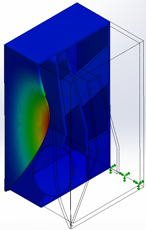

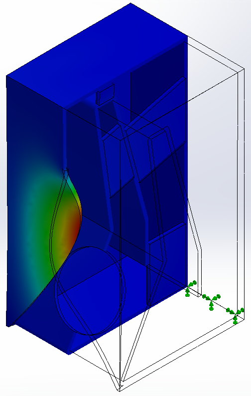

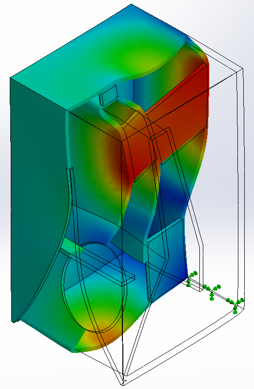

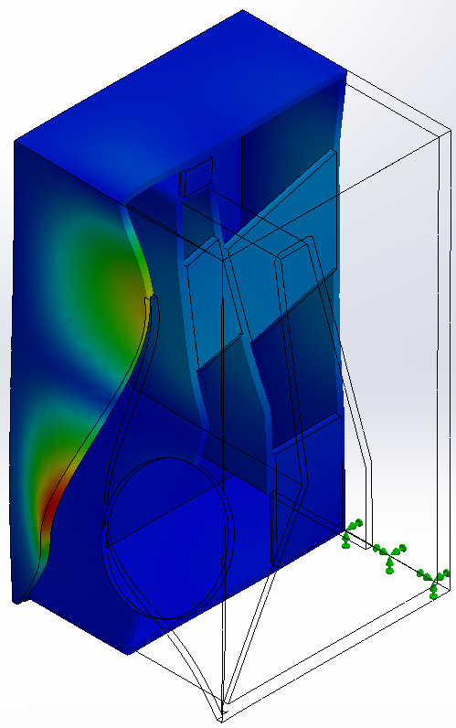

Hey guys, I feel like I'm kinda late to the party, but I wanted to share some of my work with the 0.4X Karlsonator design. I was creating documentation for my build and I figured it couldn't hurt to do a modal analysis on my enclosure model. I started by estimating the material properties by taking a scrap of foam board (the dollar store stuff) and measuring deflection with a known weight in a simply supported beam setup. Then I estimated density by weighing 6 full sheets. I suspect my frequencies could be off by up to 20% given the accuracy of my measurements. Please keep in mind when looking at the results that amplitude in these is meaningless, so it can't be compared between results plots. All the plots are in an iso view and show the half of the box facing the screen in outline only so the inside features can be seen clearly. In all cases shown the enclosure movement is symmetrical (although in one case it's in anti-phase, but you can see it), so you're not missing anything by not being able to see the plot of the transparent part. I also did not model in the driver. This seemed like a lot of unneeded work since the biggest problem for the enclosure is the front baffle.
I started with the standard enclosure without the aperture brace to see what the brace does. The first three modes were all the front baffle flapping around. Modes at 145, 170, and 245 Hz.

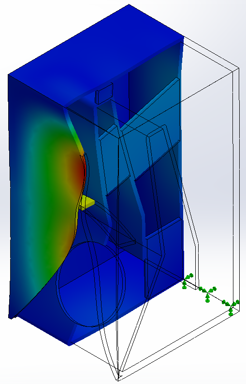

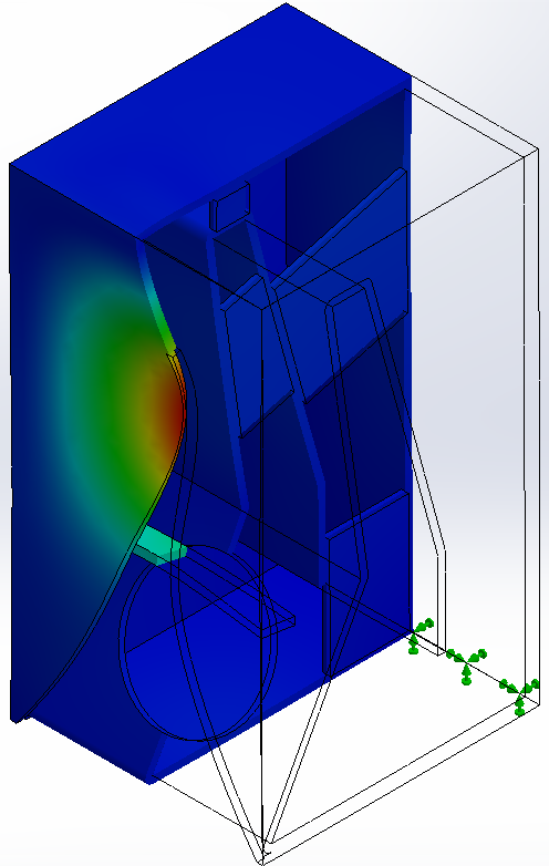

Next, I added the brace as described, 0.75 inches wide, at the deepest part of the front chamber (about 4.75 inches up from the bottom). The first mode is still the front baffle, but now it's at 183 Hz, and the next couple modes are the enclosure. The first enclosure mode is at 247 Hz, shown for reference. That's a great improvement.
From these plots, I thought there could be some further improvement from moving the brace up. Not sure if this impacts acoustics much, but the brace was most effective at 6.4 inches up from the bottom. This increased the first mode from 183 Hz to 226 Hz.

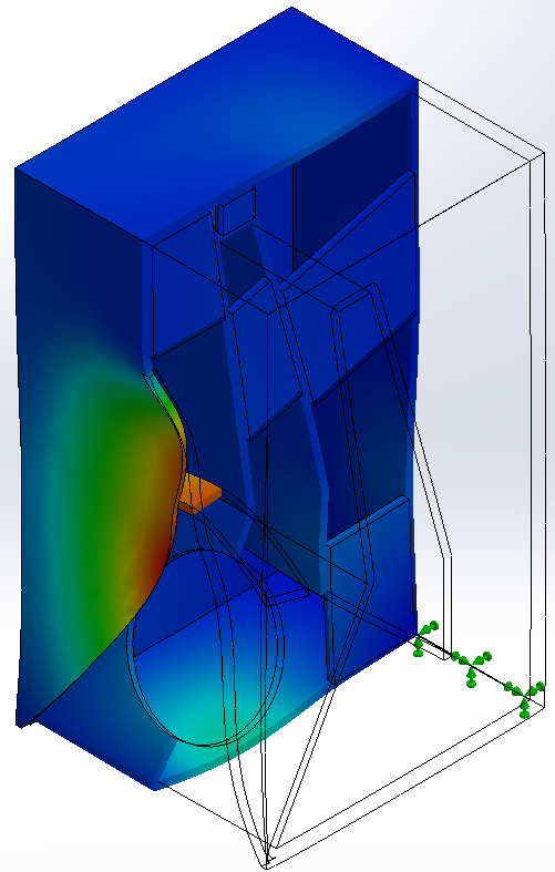

Finally, it looked like the aperture could be further improved by adding a stiffener at the upper edge. Might be complicated to add this if you wanted a removable front, but it seemed like it might be worth trying. I also re-optimized the position of the aperture brace (this time at 5.5 inches up) and the result was a first mode of 255 Hz, an improvement of 29 Hz.
Doubling the thickness of the front baffle did not change things very much and did not seem like a good option. However, this type of analysis only indicates frequency, so including a damping layer (as XRK has suggested) may still be very effective.
I hope all that is at least interesting, if not possibly useful for bracing improvements. I'll share my version of the documentation when it's ready. May take some time since I tend to only get half an hour here or there to work on it.

Yes very nice work. Thank you ! What software are you using?
Thanks guys. That was done with SolidWorks Simulation. Makes it easy to use the same model for simulation and drawings.
Oh great. I use SW and never thought to use it for modal analysis. Does modal analysis come with the standard install (not the highest)? Looks like a great tool for DML design and analysis.
No, the standard version doesn't come with stimulation. I think it may come with a "light" version of stress, but I haven't used it. Modal analysis comes with the second upgrade of simulation. I use it for work all the time since we have to design to tolerate high vibration environments.

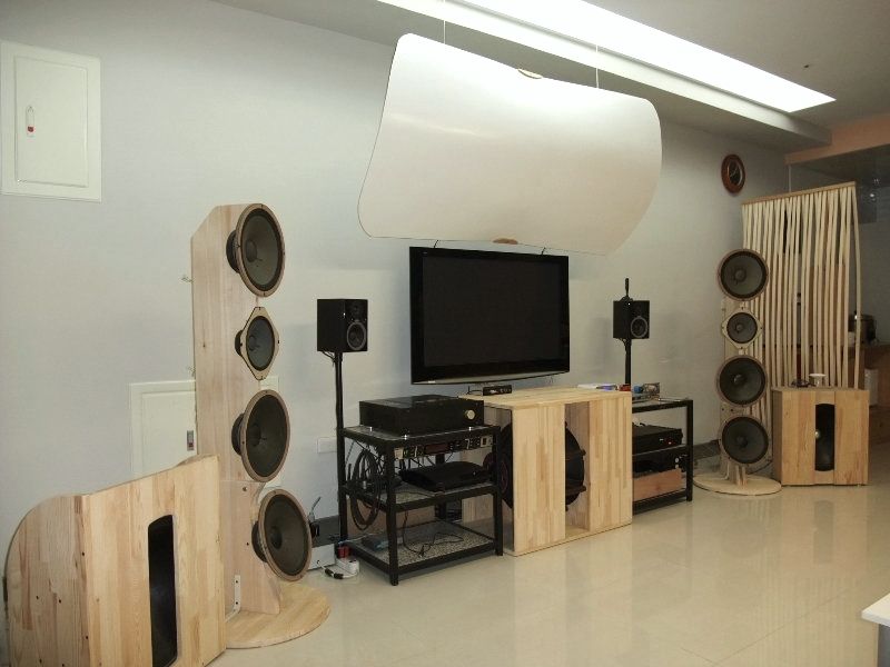

I think CLS has posted this image of his slot loaded open baffle dominated listening room before - the huge thing up front and center is a DML.
That audiocircle thread is huge but if you have time - there is good stuff in there. I haven't had more time than to quickly glance at it.
that's pretty big - - hoping CLS' upcoming KaZba will be a worthy contender to his SLOB - I need a bigger room - a warehouse would be a start😀 - I don't see any K-tubes - maybe a little K topped with K-tube & compression driver would make a nice project for CLS
