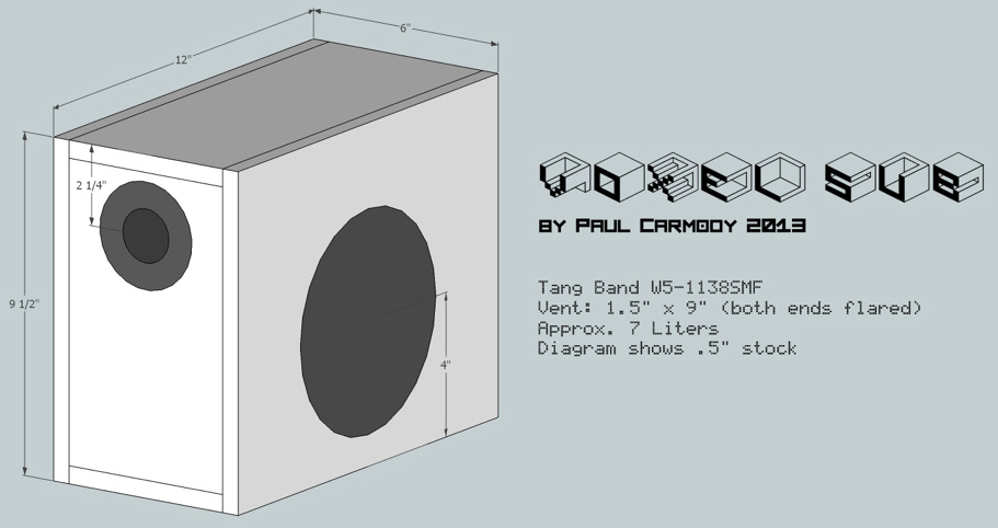

Voxel - a mini-sub+
Let me see if I can come up with a 6th order band pass using this Tang Band driver. I have one I am testing now with the no longer available W5-876SE and it sounds quite nice. Very compact at 5 liters to reach 50Hz.
Thanks again for your help. Is there a drawing of xrk's transflex? I couldn't find one.
The Voxel mini sub looks interesting and the driver isn't very expensive 😀.

I never drew up a sketch. Only described in words and mine isn't a transflex - just posted in the transflex thread. Basically two chambers separated by driver and a vent connecting front and back chamber with a large short vent (an aperture) on the front chamber connected to the outside. It is very much like an RJ vent box that is shown above in Freddi's posts. The front chamber is very small compared to back chamber.
Here is a schematic of a 6th order at its core:
