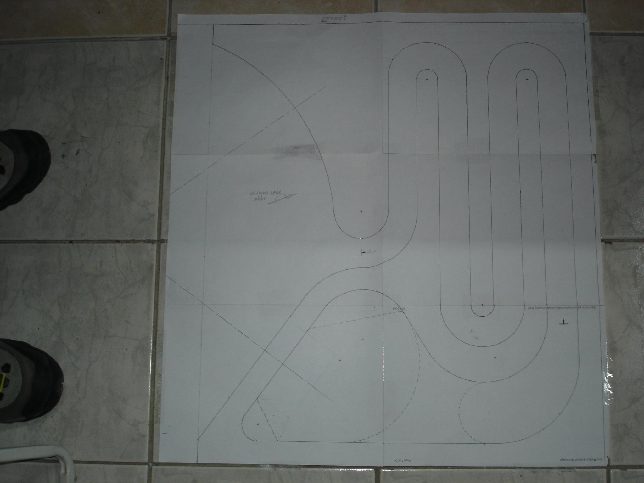

What is the length of the horn defined by? What looks like a tractrix horn ends at the back with a hard wall and the bottom edge is open. I can't figure out if it's anymore than an aperiodic box. Does the half open "horn" really provide any horn loading? Have you heard one of these Freddi or have any measurements?
This is a BLH or TL with K aperture. It is a bit different than Karlsonator
Yes indeed xrk971.
Apart from the K-slit, it is a totally a different enclosure (*) compared to a Karlsonator.
I posted on this only because the impedance measurement show the isolated effect of the K-aperture, giving a weak answer to sabaspeed’s question.
Acoustic wise, that K-slit provided very good effect (better dispersion? Minimum standing waves? Both?) at mid and high frequences

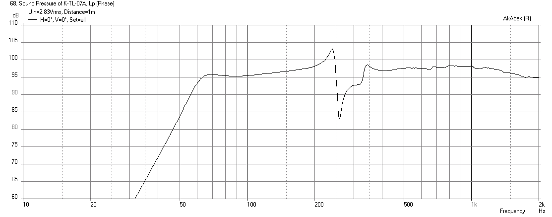

hi X - here's a 2002 note I posted: "-for comparison in AES preprint 1255 (1977), Bob Reams used a JBL 4560 loaded with 1-2220 and compared this enclosure outdoors to his 3'x3'x2' Karlson-Hypex loaded with 2-D140 - the figures adjusted for one watt/4 feet at 200Hz were 106.76dB for 2220/4560 combo and 108.56dB for the Karlson-Hypex. The 1/3 octave RTA show a 3dB window from 80 to past 500hz on axis , to nearly 500 30 degrees off axis, and ~315Hz 45 degrees off axis. Reams stated 40hz to be ~9dB down - that's impressive performance (wish he were available for comments - I suspect Bob had more understanding of Karlson techniques than anyone after Mr. Karlson's passing) "
the JBL 4560 was a reflex/midbass horn hybrid like Altec's VOT http://www.jblpro.com/pub/obsolete/Low_Frequency_Enclosures2.pdf
don't know if I have a copy of the AES paper anymore - its interesting that the Hypex worked - IIRC it had ~3 cubic foot rear chamber per 15"
I like K's - best for dynamics with minimal cone movement in a reasonable package

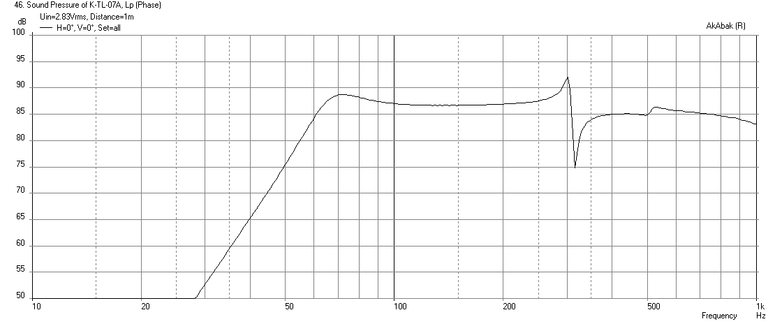

Dayton RS100-4 looks like a good driver for 0.4x
The Dayton RS100-4 appears to be a very nice driver with the good combination of correct Qts, large xmax of 4mm, and a very smooth response according to the factory specs. Dayton Audio RS100-4 4" Reference Full-Range Driver 4 Ohm

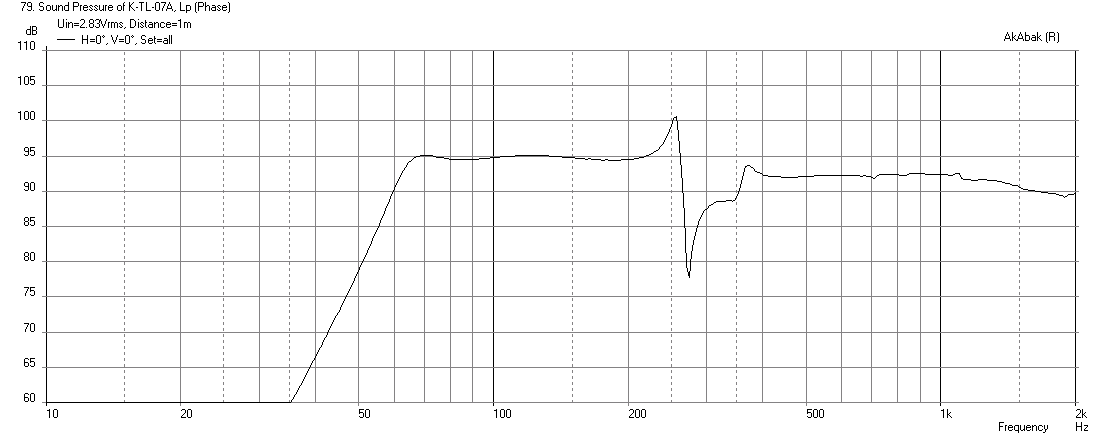

It also sim's very well in a 0.4x mini Karlsonator with nice flat bass extension to about 60Hz and decent sensitivity.

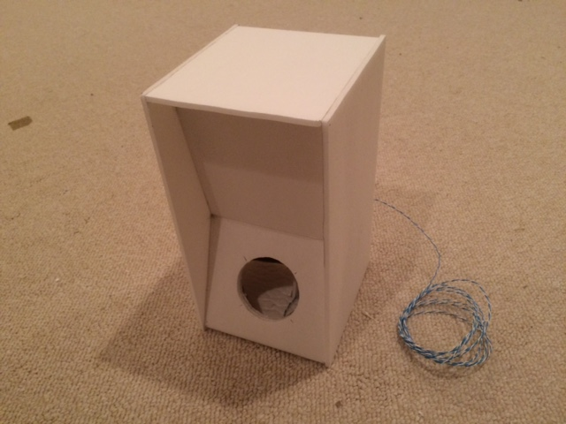

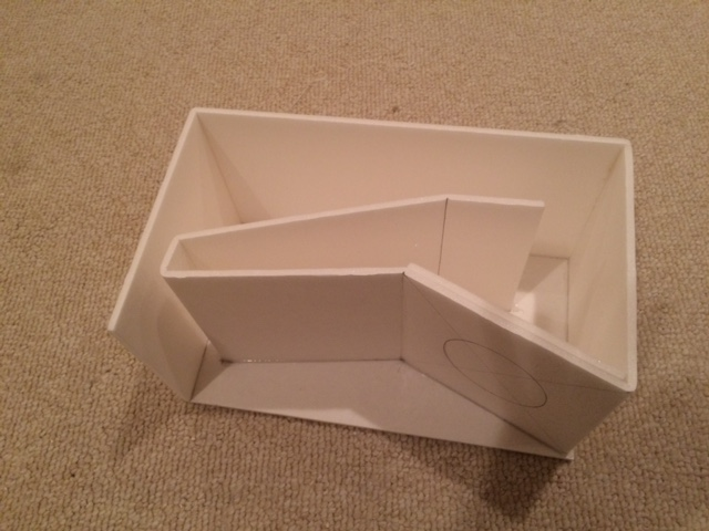

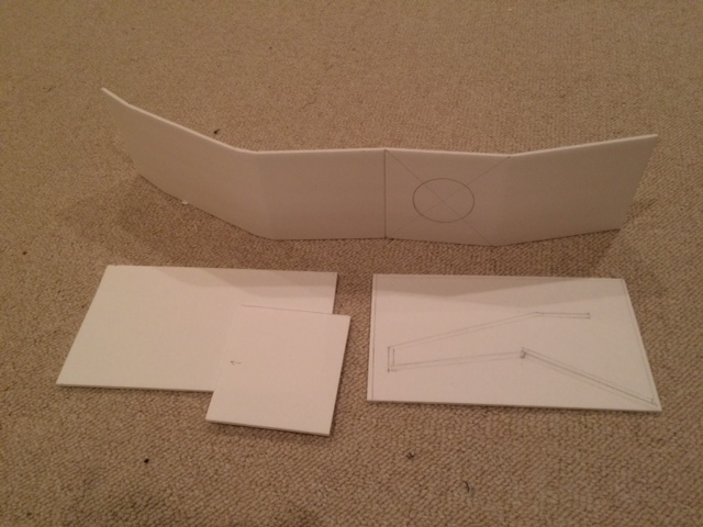

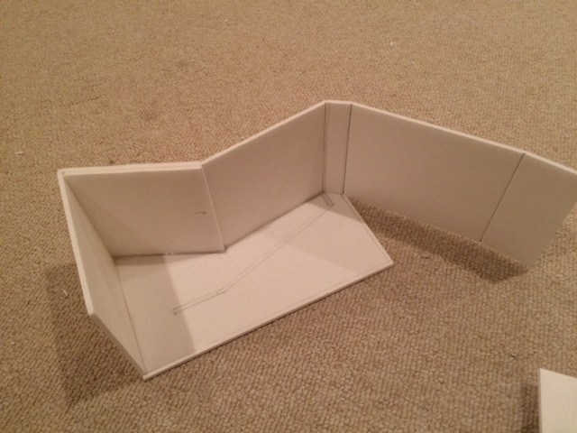

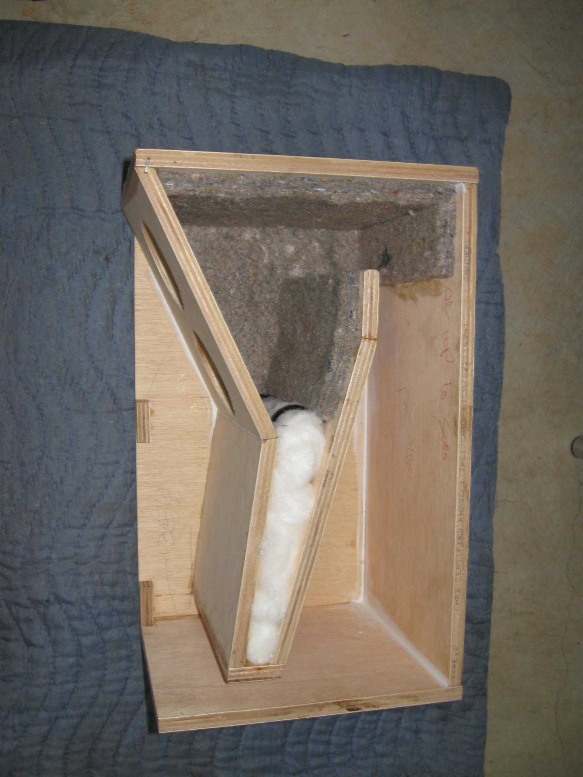

0.4x Build using Score & Fold Technique
I am detailing how to build the 0.4x using the score and fold method where the front, top, bottom, back, and insides are all made using a long strip that is scored with a blunt tip and folded. It goes really fast as you only have to cut a long uniform width strip (6.0 in this case). The top and back require a second strip as it is not long enough. The speaker takes about 2 hrs to make from cutting gluing. It was made completely using hot melt glue so the gluing goes pretty fast.
Pieces ready and scored:
Start gluing bottom first, then front:
Glue on back:

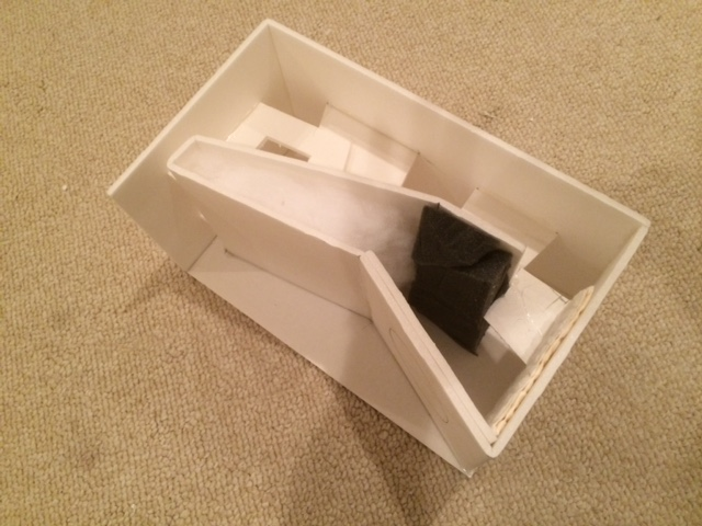

Add braces and damping material (foam behind driver and stuffing above driver):

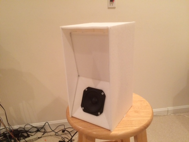

Completed speaker without driver (Cat 5 single strands used for wiring):
Installed TC9FD and ready for measurement (without K-aperture):

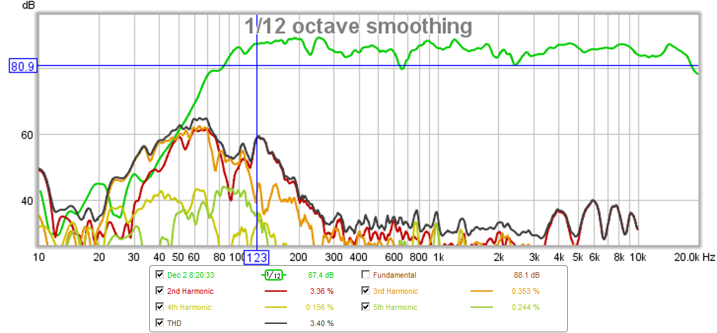

Measurement of freq response and HD without wing at 0.5m:
I can hear some cabinet vibrations which gives the higher than normal HD below 300Hz. Could use some CLD...
Glue on back:

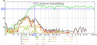

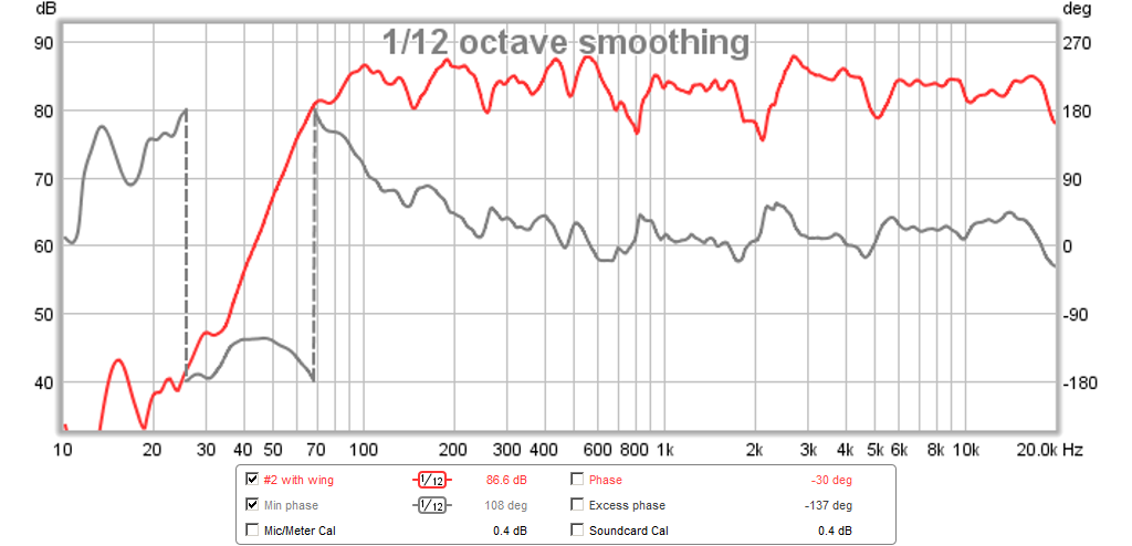

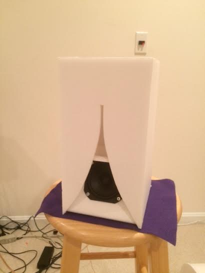

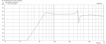

0.4x Build using Score & Fold Technique Finished

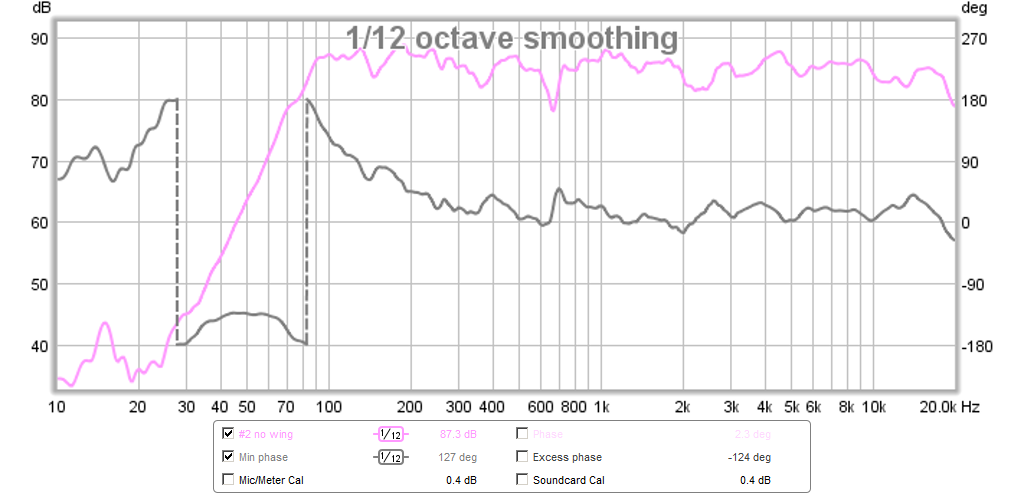

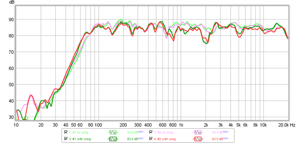

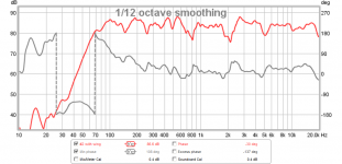

Added wings and made measurements with and without. There are a couple of dips that the K-aperture wings introduce, but it does extend the bass somewhat. Note that the design has a fairly flat response with respect to baffle step losses. No BSC is needed for a balanced sound. The price of the dips is in my opinion, worth it for the improved dispersion and deeper bass extension. It sounds very nice and you don't notice the dips upon listening.
Completed speaker with wings:
Measurement of unit #1 and #2 with and without wings:
Minimum phase without wings:
Minimum phase with wings:

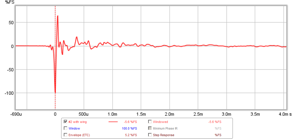

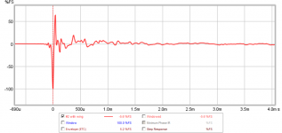

Impulse response with wings:

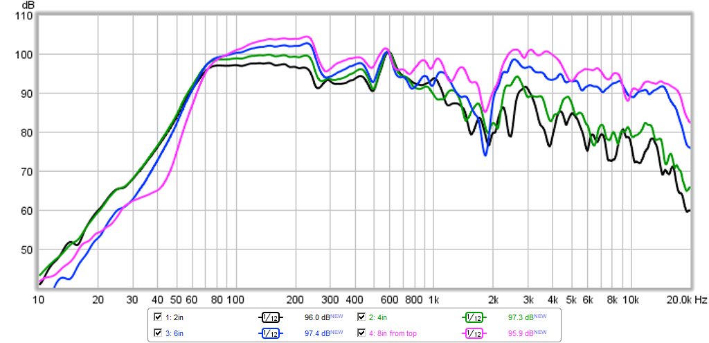

Never seen before: Measurement along slot axis
I wanted to see what the variation of output was as a function of the position along the Karlson aperture axis. I made nearfield measurements 1 in away from the plane of the aperture or K-wing at 2in, 4in, 6in, and 8in below the top edge of the slot. It is not surprising that the output frequency content is different at different positions. The classic Karlson "W" is very apparent and matches the sims with the first notch at 250hz to 500Hz. It is interesting how in the far-field, all this integrates out and you get something much smoother as presented in the posts above. The knee of the bass shelf is very clearly 75Hz in this measurement and that agrees with the sims also.
I don't think I have ever seen this type of measurement anywhere - maybe Freddi has?

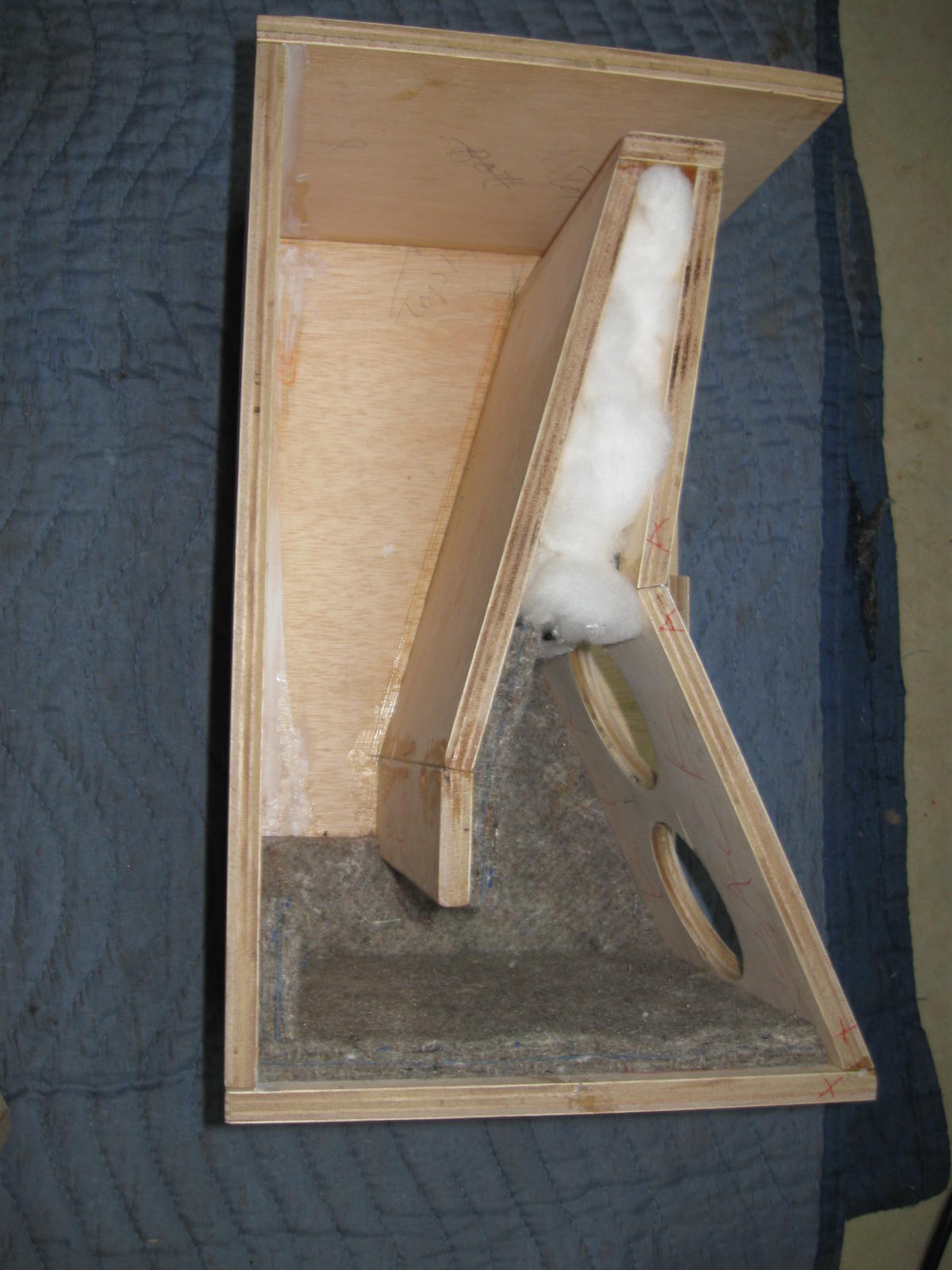

I have a question on my dampening set up, but first would like to thank everyone for their enthusiasm and time . X for sure, Greg B great drawings, it got me fired up
.???? Is there anything I should change? Materials , two layers of carpet felt padding and acoustistuff in 1/2 ply enclosure.
I have a question on my dampening set up, but first would like to thank everyone for their enthusiasm and time . X for sure, Greg B great drawings, it got me fired up.???? Is there anything I should change? Materials , two layers of carpet felt padding and acoustistuff in 1/2 ply enclosure.![]()
Looks great! I wouldn't change anything. 🙂
