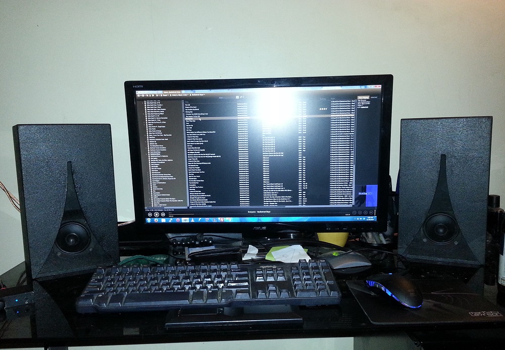

Those do look very nice in black Duratex. White Duratex looks great too if you want to try that. Indoors, the white just disappears.
3 more pairs!? Making gifts for friends are we?

Here you go, gives a little size perspective 🙂.
Is that black refrigerator a sub? That is sick for a little room. Amazing that you like the sound quality from the modest little Vifa over your line arrays. 😀
Thanks for sharing the photos.

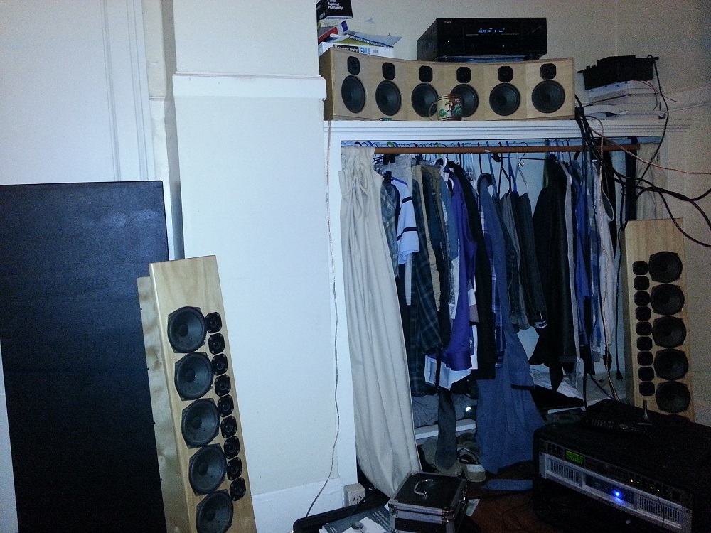

Subwoofer, cable router, stage, work of art - whatever it needs to be at the time. It's my T60 @ 20 inches wide (20x30x60''). My dual 12 is next to my new "surrounds" at 50 inches tall 15.5 wide and 19 deep it's comparatively puny. Subs split to fix room issues.
Rant:
The sound quality on my line arrays is solid for movies after Audyssey in that they have insane dynamics and output but before EQ the frequency response is very uneven due to my cheaping out on the drivers and buying closeouts combined with not being nearfield, combined with my not knowing a whole lot about crossover/level matching at the time. They also don't sound good until you are back about 8 feet so the drivers can merge their sound (expected). Loud as a PA they are but impress a trained listener they won't.
/endrant
The karlsons on the other hand are beautiful sounding, much better on vocal positioning and clarity. They are better at the "disappearing" act than any other speakers I have.

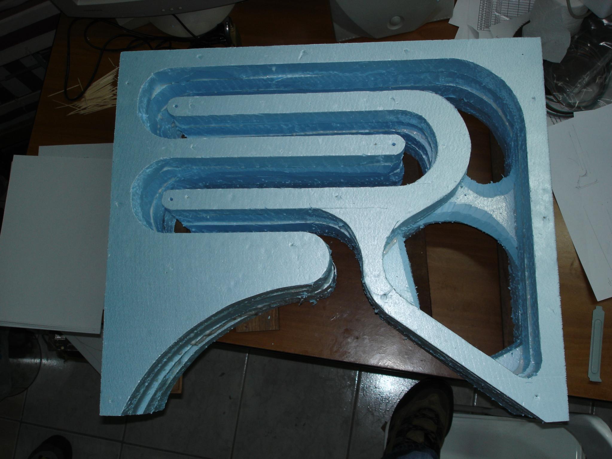

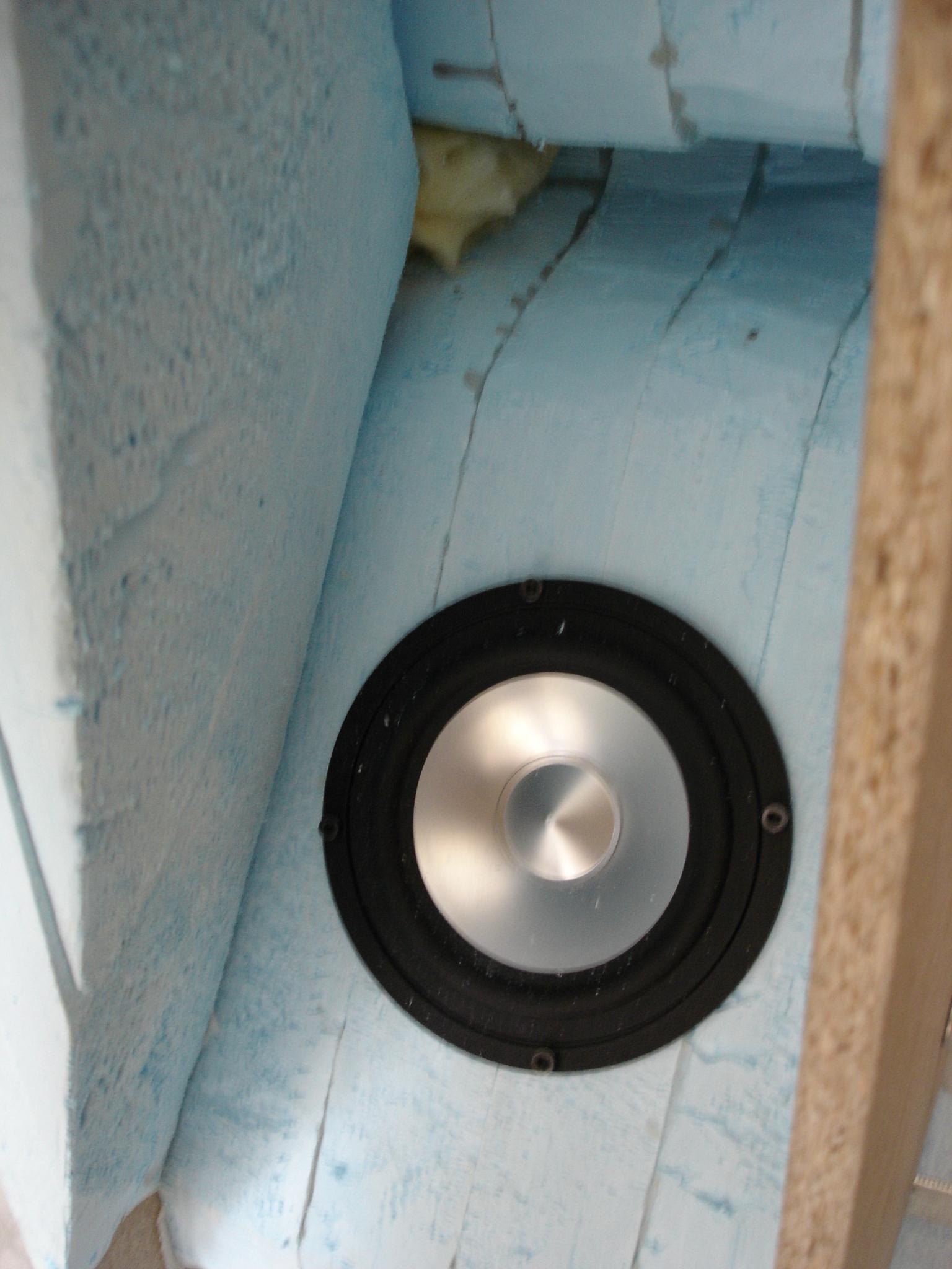

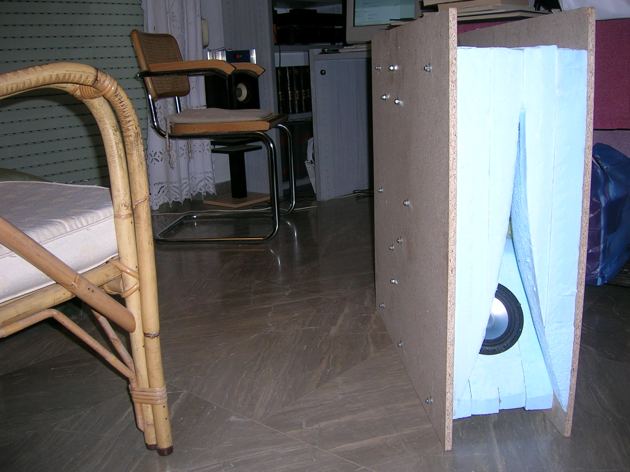

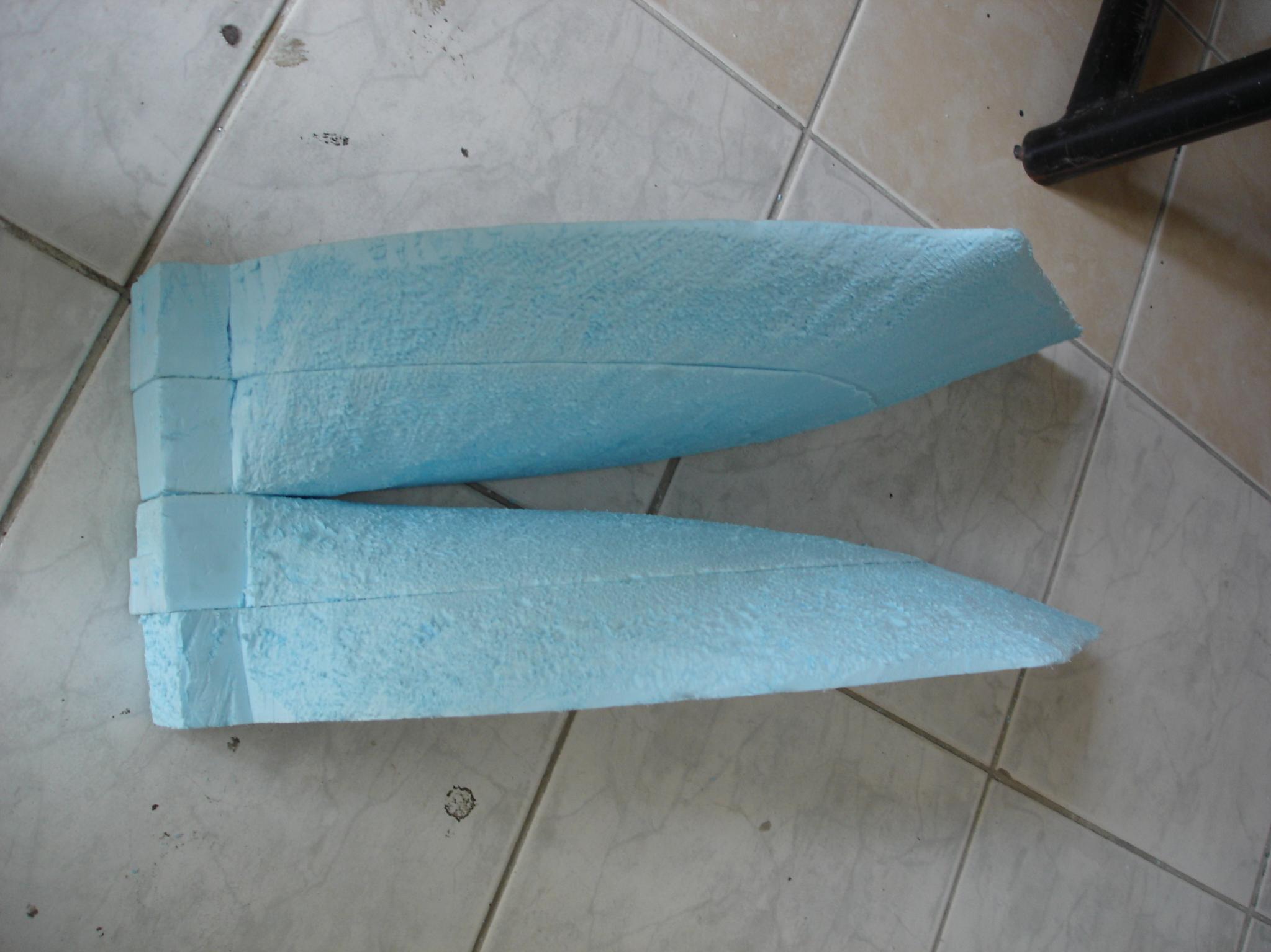

Impedance wise, the K-slot seems not to do many things on that experimental enclosure of mine with a FR driver.
With that construction, the slit’s lip curving allow for almost no front chamber volume, therefore no appreciable LP effect.
George
George

Way cool foam design - dig the 3d sculpting on the wings! This is a BLH or TL with K aperture. It is a bit different than Karlsonator which has the vent from back TL at the top so the aperture does in effect extend the length a bit. There is a several Hz lower tuning freq drop with and without it. The bigger effect is the horizontal dispersion due to lens effect. I just got a new DATS woofer tester as a gift so will run some impedance sweeps on a new 0.4x that I am building with and without the front wings.
