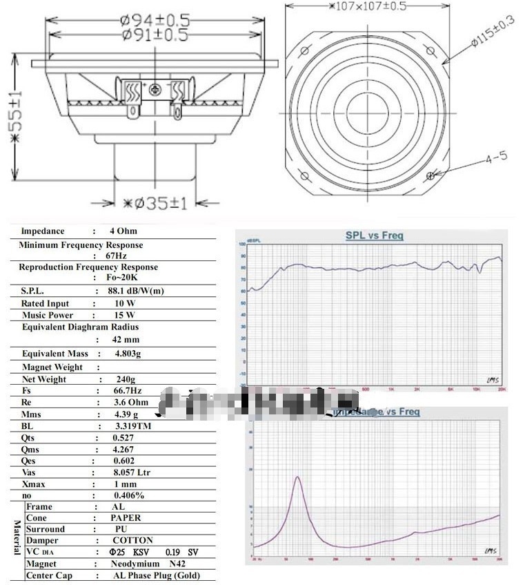

Hi XKR,
in the '60's I built a number of Carlsons, without much success. Reading this thread and your work, I now understand why. But I have always liked their looks.
I now have the need for a small unit, and are thinking of this driver, single.. Needs are a "technical look", small size, good mid-range, but power handling not important.
Any suggestions for sizing etc?
Regards, Ross

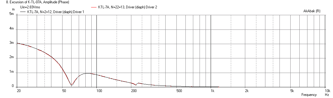

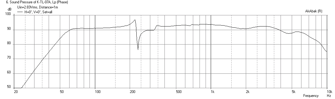

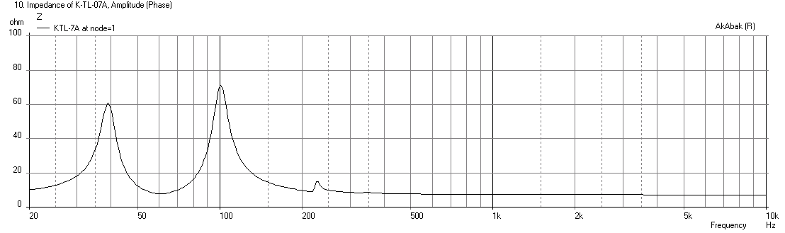

This driver works well doubled-up and wired in series for 8 ohms nominal load in a 0.60x scale Karlsonator. You have to watch out for exceeding xmax though but the response is pretty flat down to 60Hz. Use a K-aperture that goes to a sharp cusp rather than a slot for the deepest bass extension. Use a slot to get more bass amplitude but less extension.
SPL vs Freq at 1m and 2.83v:
Impedance:
Cone displacement:

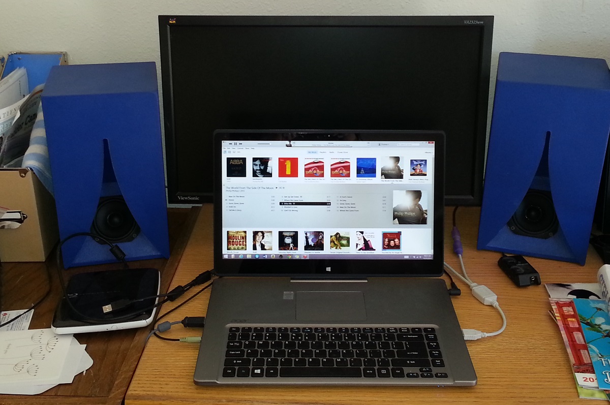

So here are the blue mini-karlsonators I made my mom for christmas!
She picked the color, and it looks pretty nice. One thing I will mention is: white primer is for the birds if you are painting a dark finish. It took approximately 5 coats of primer and no less than 4 coats of finish (some sections more) to get a smooth covering.
Oh and I have a sweet jig for cranking out those baffles repeatedly, now I just need to build the 15.25 inch radius arm for my router!
For the record I connected them to my mom's existing creative audio set (sub built into amp) because that meant she didn't need to buy an amp and she has the same volume control is before (simplicity is important for those of us with less audio expertise). The cables in the original creative set are rca to hard wire so I took a pair of RCA cables stripped one end and collected the shell into a wire and connected that to the speakers. Doesn't sound too bad! I also finished my present for my brother a couple days back (sealed 10 inch alpine swe10s4 with full mitered corners and oil/lacquer finish) that also looks nice.
They look great- like the blue but I'm not sure your using the right paint 😀
The paint was semi-matte from the paint store down the street (kelly more) the owner of the store knows a heck of a lot more about paint than I do. It was 6 bucks for the quart of blue (which I still have 80% left) and like 7 for the primer. It is not duratex due to the recipients preference (my preferred speaker coating is far and away duratex) and the lightness of the undercoat meant it took a lot of blue to be blue.
Next time I go with blue I'll use a darker primer.
