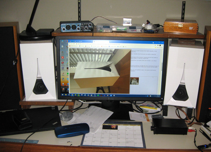

The Karlsonators' imaging is absolutely excellent. It is so good, I think I'm spoiled for life. I'm afraid that IF (not when) I ever "upgrade" to bigger speakers, I'll lose the fantastic imaging of my 0.53x dual 3FE25-16 Karlsonators. I have yet to listen to speakers that come even close in that department! But I imagine it also has to do with the amp you power them with. I'm using an ACA with B1 buffer/pre and H2 V1. Not the most powerful setup, but boy, is the imaging good!
Edit: Nearly forgot... To get good imaging, I use "toe in" or whatever it's called. The certrelines of the speakers have to cross about two feet in front of your face for best results..

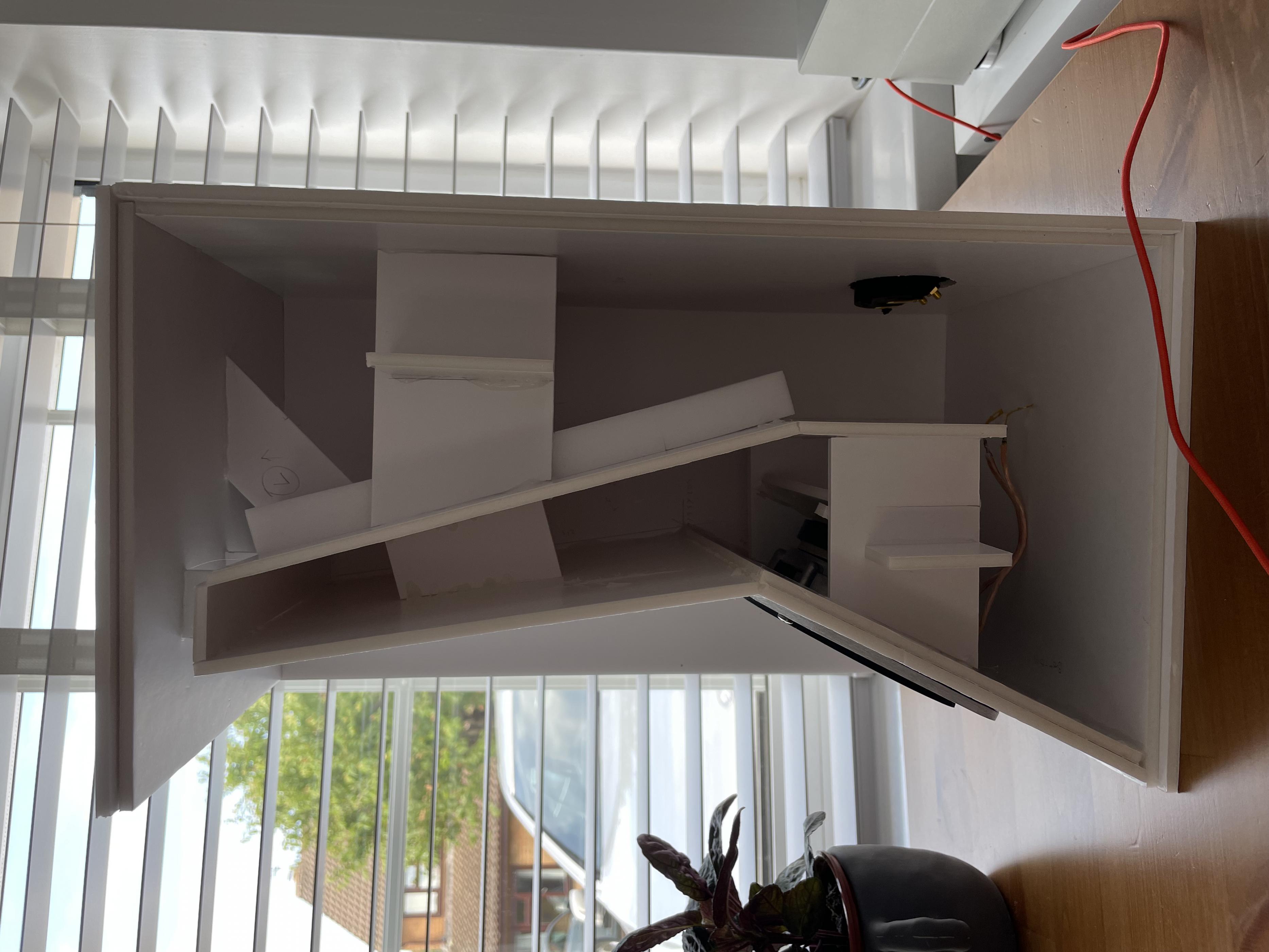

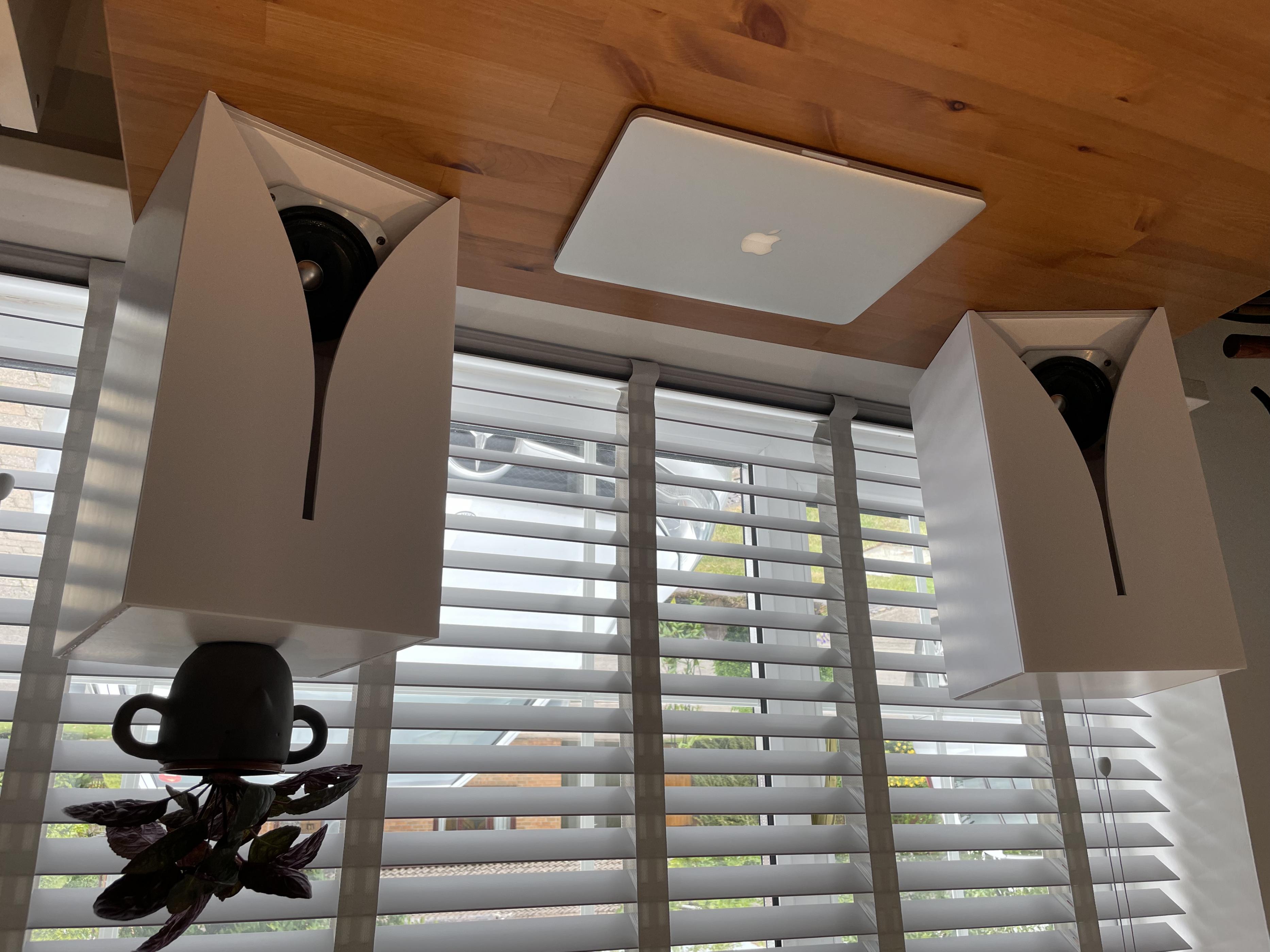

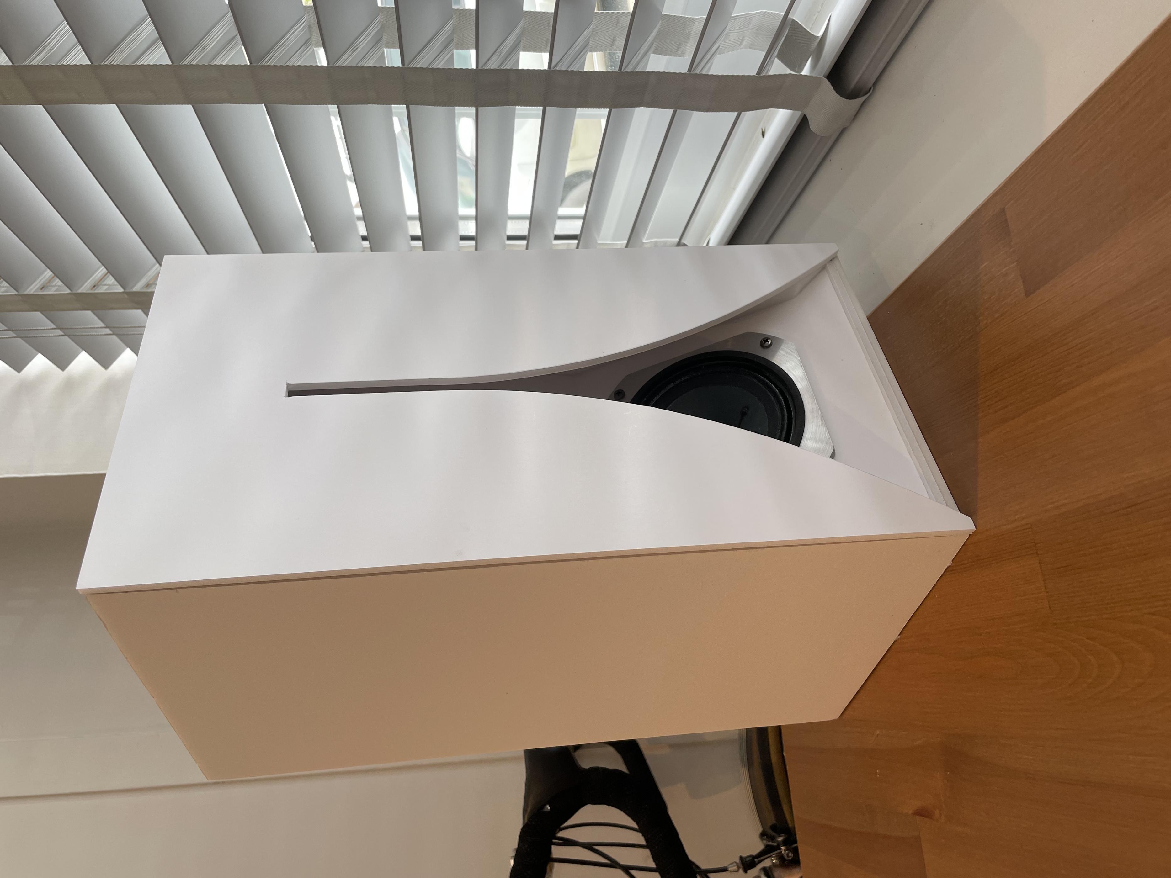

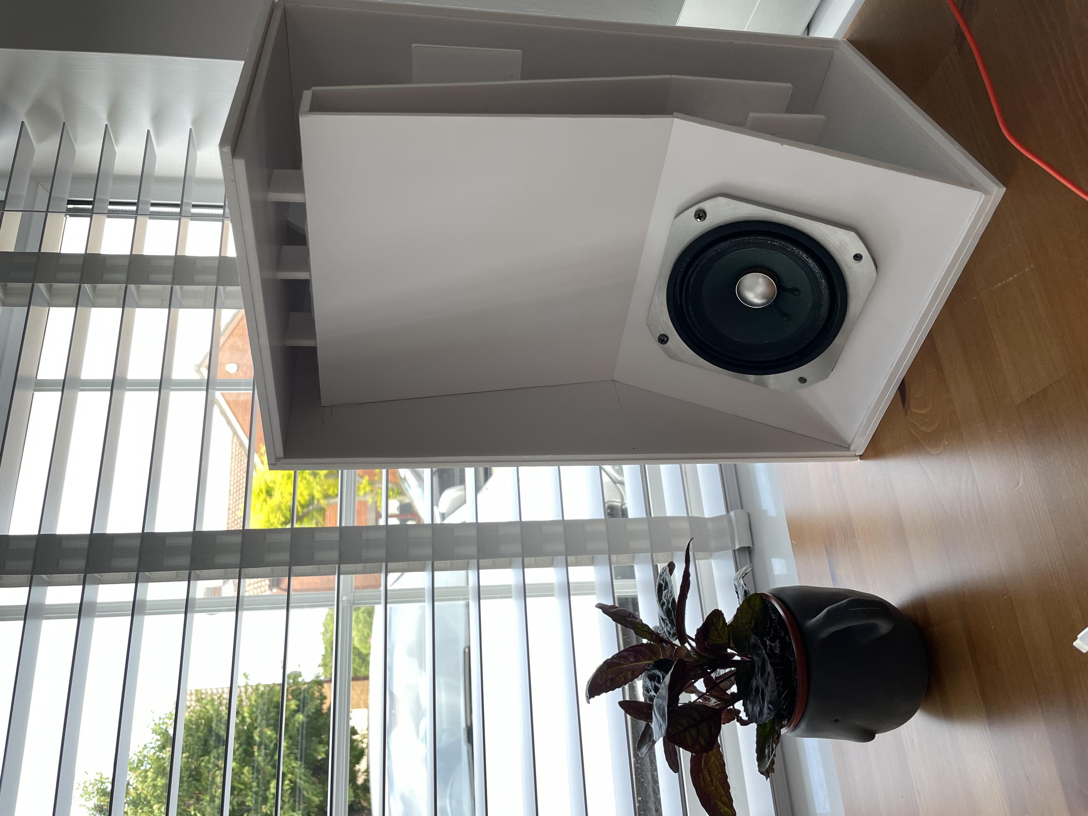

I made the foamcore K's!
I had great fun building them, based on the brilliant and almost idiot-proof Muddjester plans.
Notes from an idiot:
I didn't "buy" (steal from work) enough foamcore. Ran out, and had to actually BUY some.
I riffed off the measurements a bit, and rounding errors add up. Also my decision to step the edge joins (a very basic rebate joint) lead to a lot of head-scratching, and a few mis-cuts.

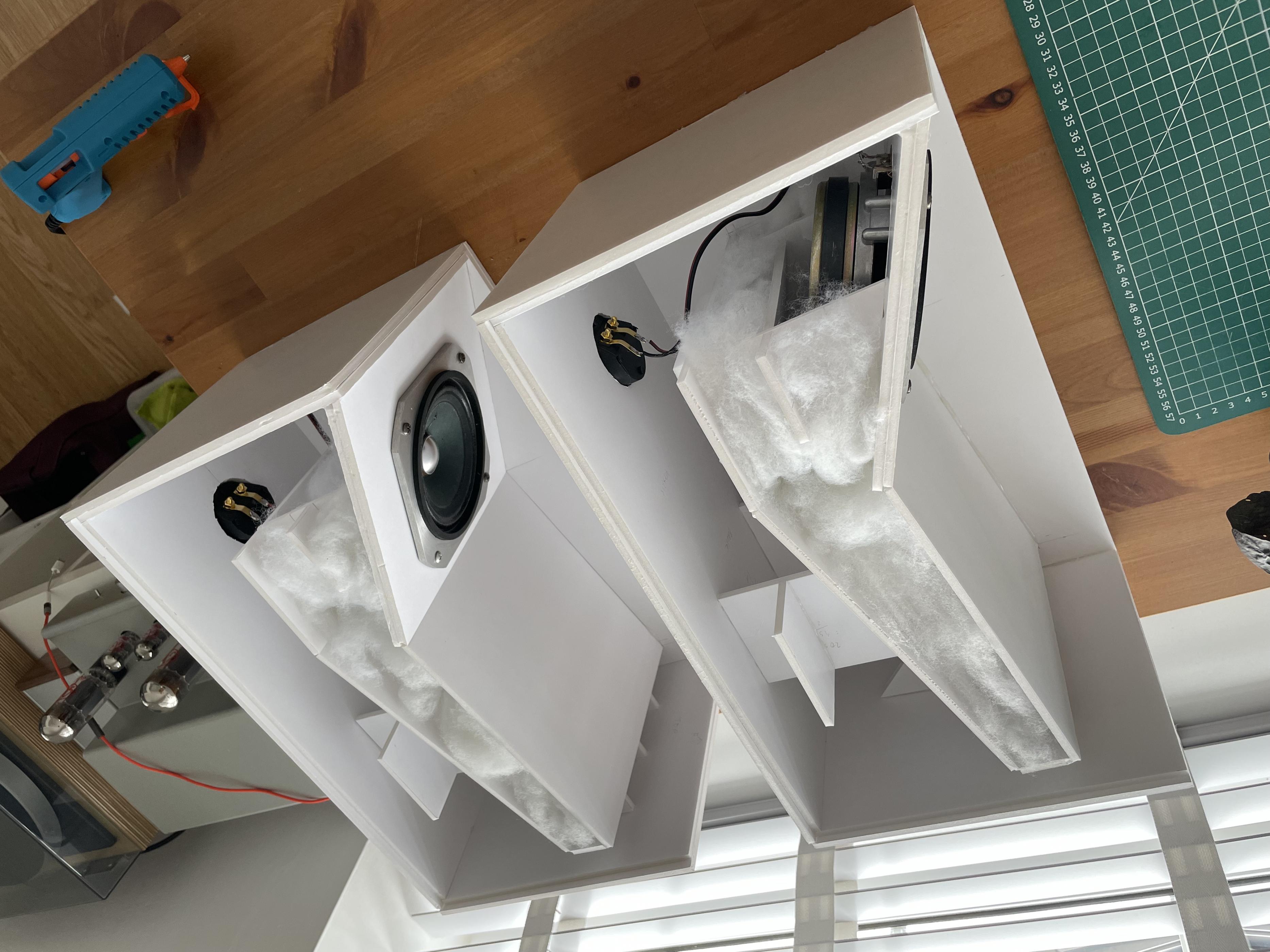

Hot glue cools fast. It was a fight to get all the beads laid in time. The first few side laminates I did in hot glue, but couldn't squeeze them tightly together. (I bet there's all sorts of resonant hell going on with those). The rest I did with spray contact adhesive which worked fine.

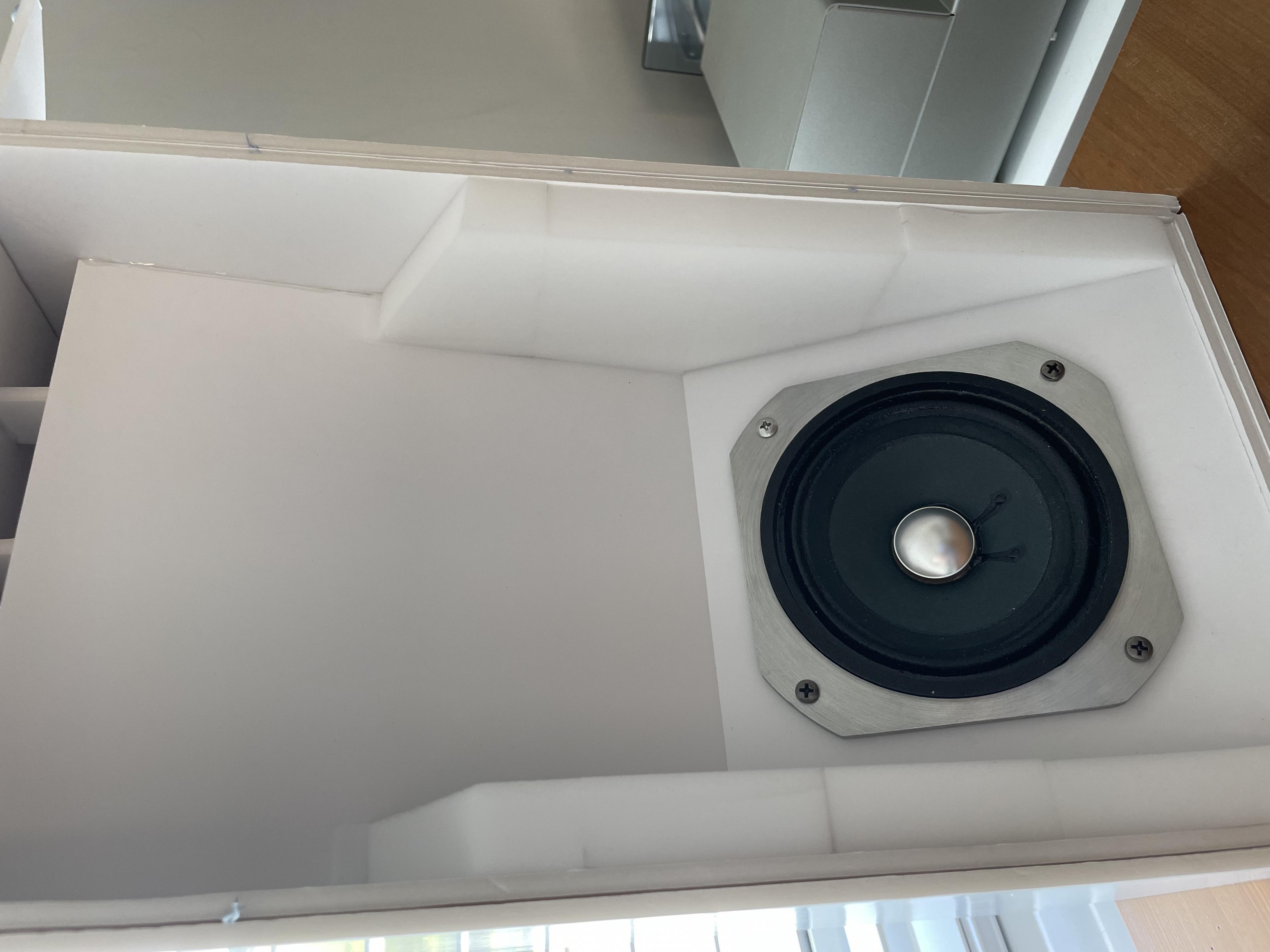

I squidged wadding into the speakers as directed by one or other of the threads here, but ran out of that too. Probably should have got more before I glued the speakers up.
I used a big pack of eBay magic sponges I found at home, and somewhat haphazardly popped them in up the back of the enclosure, leaving some for the cheeks on the front as suggested by Lord xrk. Ran out of these also. Speakers use a lot of stuff! I've never built speakers before, in case you couldn't tell.
I pondered how to access the nearly built speakers in order to finesse the amount of dampening but then glued them up anyway. Wine was involved. I can always make more.
They're really solid! What a great structural design, thanks xrk.
I'm loving how they sound. Actually proper bass, and real depth at low volumes. They sound like they'll go loud as well from my little SET amp. I only have one layer of foam on the grille at the moment (oh HI, work stationery cupboard!!), which probably accounts for a bit more resonance than I'd like at the moment. And the grilles are blu-tac'd on.
I'll continue fiddling with them for a few weeks, then think about making some permanent versions for home. I'm not wedded to wood- Has anyone tried foamex? We've been CNC-ing things out of it at work and it's an impressive material, I can imagine interesting for speakers.
Thanks again to xrk for enticing me onto this bandwagon..!
(yes I know the pictures are sideways. No I can't remember how to fix it)

Hi Jodyone,
Very nice work! They look great. I wouldn’t have known they were your first foam core speakers as you made it look clean and neat. The second final side wall has to be glued with a slow drying glue. Hot melt hardens too fast. If they made one that took 2 minutes to harden we would have something.
I did not catch what drivers you are using? Or you asked at one point and I forgot. They look nice.
Thanks xrk. I managed to just outrace the hot glue on the final side wall, so I'm confident it's sealed internally, but could have been neater.
Drivers are Realistic 40-1311, NOS from the 70's. Nice chunky cast ali baskets. They're apparently a version of Fostex FX120's, according to the internet. I really enjoyed them in some quick open baffles I made, and I like them more now they have bass.
