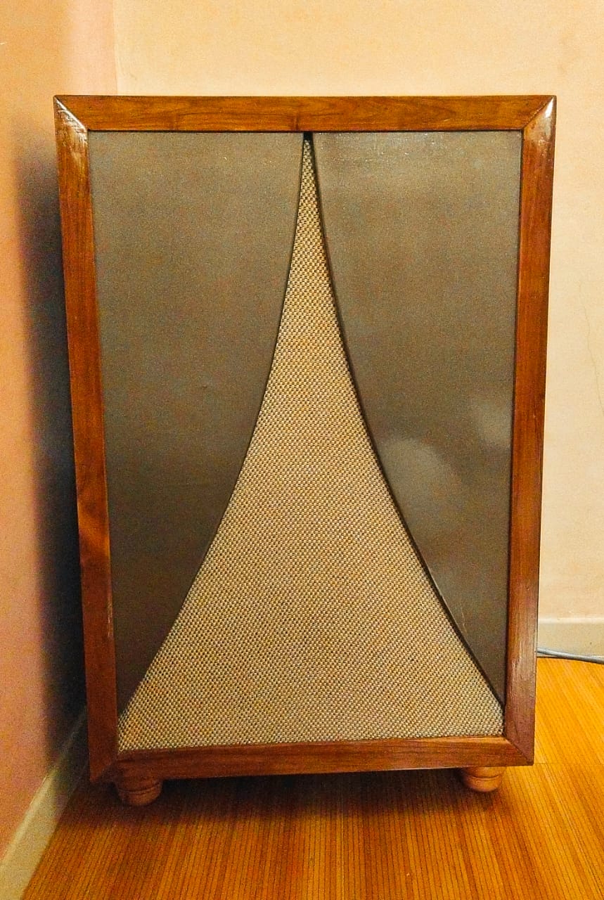

Thanks Freddy and XRK, my Karlson 15 is ready for initial testing. The driver is P Audio BM 15CXA and I went with 3.3uf cap for the CD.
Finally I could finish the Karlson, big thanks to Freddy and xrk for the guidance.
I am not uploading the build log here but below are the details,
3/4 water resistant plywood
Surface finished with metal paste, NC putty, automotive metallic paint topped with gloss clear
Internal damping using 1inch recron sheet
2inch dia wooden spikes, almost 3inch high
Soft curtain material as grill cloth to give that vintage look as well as to take out some of the HF shout.
Wooden frame and spikes are teak wood with gloss wood polish.
Very nice work, Pvsumith! How does it sound? This is a K15 proper and not a Karlsonator, right?
Yes that's the original K15 made as per the 1950s drawings, i also have a Karlsonator 6 using Lii audio full range.
The sound is amazing, spot on imaging and life-like midrange.
K15 is certainly appropriate. XRK971 might look into other possibilities using Akabak and your driver's spec. K15 should pretty much maximize "punch". A 1.2X scaled Acoustic Control 115BK would be about the same bulk as K15 and tune a few Hertz lower. A 15 inch Karlsonator simply scaled might tune too low so should be adjusted so Fb no lower than 40Hz.
You were spot on with the LF punch of K15, it's really tight and fills the room. I have used only 3.3uf cap for the CD
absolutely beautiful! - the grill cloth even looks correct great to hear of a Karlsonator 6 build too. A Karsonator 6 is perfect for Fostex 5.
Does the single cap crossover sound pretty well balanced ? Beside that being common with vintage budget coax, the late Stan Ricker did that with Altec Duplex and recommended using motor run caps in series for large plate area.

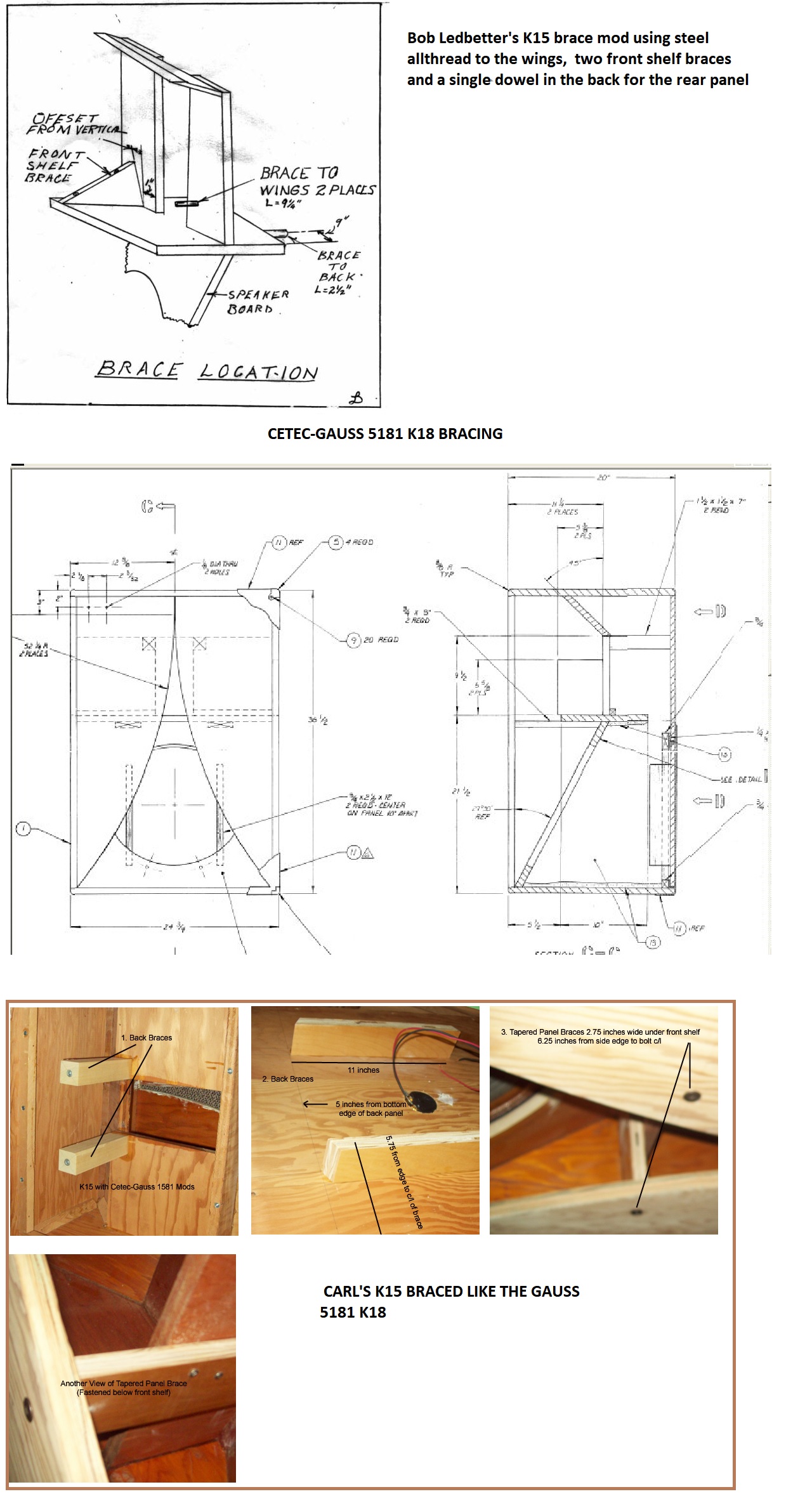

Did you brace the back panel and wings? That can make it more neutral sounding with high input transients.

Thanks Freddi, yes the single cap is really balanced and he HF sparkles really shines. One of veteran designer also suggested motor caps over Mundrof, i am going to give it a try soon.
I have provided bracing only on the sides for attaching T nuts where both back panel and wings are attached. It's 18mm plywood, do we need additional bracing, i cna give it a try if you guys recommends .

The easiest way to brace the wings would be to cut two lengts of dowel rod slightly longer than the distance between the front shelf edge and back side of the wings, then insert them snug against the wings, carefully through the port (don't drop them). perhaps a disc of rubber could be cemented to each end of those struts.
The back panel should benefit from even a "sound post" style brace with a short piece of dowel attached to the center of the rear shelf then provision to tighten that from the outside oh the back panel. Two on-edge 1.5" high strips of plywood help the back panel if not using a central strut.
