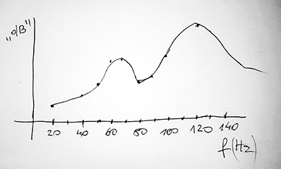

When I built my Karlsonators with 2x 3FE25 - I need to admit - I haven't tuned them.
I don't have a proper mic yet, so instead, when I played 20, 40 ...160Hz I realized that there are quite huge differences in loudness.
For example, 50 and 80Hz are at a similar level, but between 60 and 70Hz is louder. After 80Hz it starts rising again and reaches a maximum at 125Hz (pretty loud) and then goes down again. Is it something that you encounter before guys?
Is it caused by not putting enough poly?
unless the graph was done outdoors and away from large objects, it may not reflect what's happening. Its important to have stuffing in the "pointed stub" above the driver - it that's not sufficiently damped, then funky resonances will occur.
Thanks, freddi, but that's not the case.

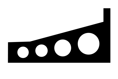

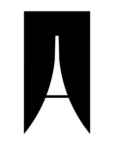

I'm going to build another pair with 12mm plywood, but this time I'd like to add bracing, not thicker than 8mm I think.
Does anyone have an idea how to properly stiffen the aperture? Also, I'd like to add a 206mm brace between speakers, on the back.
Also the internal brace in the middle
and maybe something like that:
