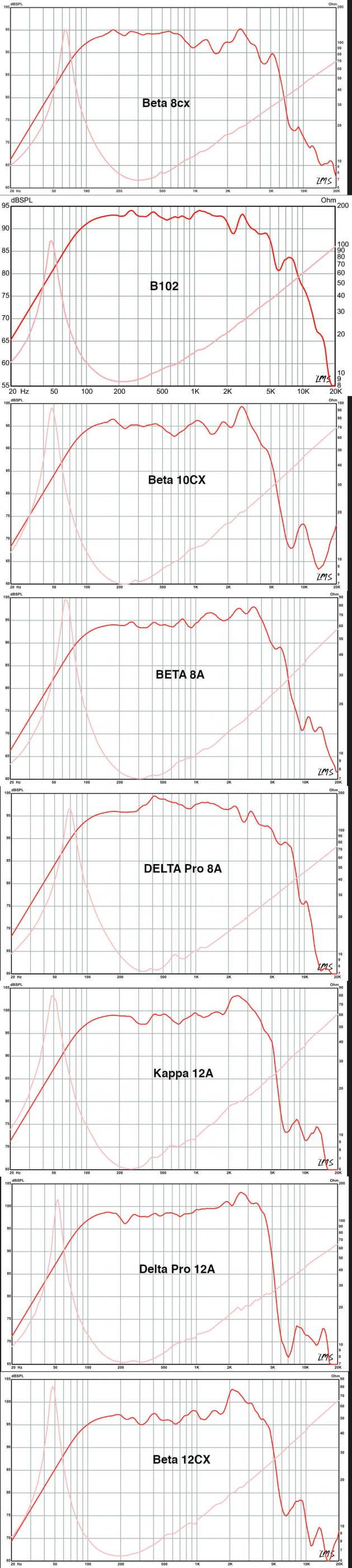

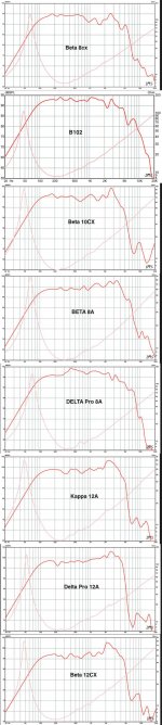

one or two Beta 8A might make a punchy K-nator or XKi along with a K-tube.
Since Beta 8 seems only available in 8 ohm, a parallel Beta8A K could present a load near 3 ohms. In its favor is an evenly rising on axis response. which negates having a lowpass filter pull more current for "boost" via a drop in impedance.
I don't think a Beta8A or Beta 8CX Karlaonator should be tuned as low as GregB's "Karlsonator8" which has Fb~41Hz. 50Hz would be better.
Although Karlson's X15 system appeared to be named after that airplane, It;s ok these days to think of X12 and X8 as being basically K12 and K9 with an internal K-tube for two way systems.
btw, Kappa 12A whose curve is shown, is one of my favorites for a Karlson 12 plus K-tube. That combo is jaw dropping on a synth recording and more impressive on the little K12 than my K-horns - - don't think of Karlson's originals as "obsolete".

A Karlsonator 12 could be a nice option. A K-tube mounted either on top, or internally with the compression driver mounted in the "stub" above the woofer.
Re:FW305 - the dreaded foam surround. If direct radiator midrange presence is sufficient for your situation, then Beyma's old 12CX whose woofer extends pretty high could make a nice Karlsonator 12 setup. It sells for $199 these days in the US.
Beyma Coaxial Speakers - Beyma 12CXX coaxial speaker - Beyma 12CX 200 watt 12" coaxial speakers for all 2-way applications. Beyma 12CX coxial speaker and other Beyma 12" coaxial speakers here.
In Karlson's K12, I like Eminence's Kappa12a woofer.
Perhaps a CD waveguide or simply "horn" 😀
Eminence Delta 15A speaker. The Eminence Delta 15A is a 15" 8 ohm speaker. Delta-15A is a 400 watt RMS 12" woofer.
Thanks X and Freddi!
I did not have a coax in mind, even though I did plan a 70l "Onken", with a fullrange 8 inch Sonido SWR, before I got cold feet over 2mm xmax (SPL etc.) and efficiency with my limited power, as it would probably be similar to the markaudio TL I have now. Would feel better to have more of a step up, especially as I will not build every year. Having a fullrange/coax as close to the ground as in a Karlson feels strange (without hearing one of course, I am probably way off), and I don't mind the extra horn on top, if that can bring great music.
So therefore the main idea as of now is a Karlson cabinet with the high frequences above, probably as CD&Horn ( I have a friend with a CNC and we are toying with the idea to build Yuichi a-290 wood horns that allow 300-500 Hz cross), but could be a full range, if that would be "better".
Thanks Freddi for the statements of the K15, and I think I understand it to work with most old school 15" with low mms and strong motor. Not sure if a newer Beyma "monster" 15p80 or 20 year old JBL 2220 or similar would work "best", but I guess both would in slightly different ways. I have seen discussions about some kind of "dip" around 300Hz in K15, is this a problem that makes the Karlsonator a better choice? (I cannot cross lower than that using CD, otherwise it sounds like it would work fine for the bass side of a 2 way, crossing somewhere 500-1000Hz)
For the Karlsonator, I am not as sure what would be a wise choice, I understand it would go deeper, even with a 12", and act more like a TL. Not sure how linear it would be up to 1000 Hz, but as you use it for full range, then it should be fine.? Maybe you have looked at it before, but it would be excellent to hear how a Beyma 12P80ND would behave in such a cabinet (or if not a similar low mms&strong engine 12") - as that would allow it to cross higher if needed, and as they are considered as great midbass drivers, but kind of hard to hard to use as woofers. Or even to put the larger 15p80 or Faital Pro FR400 or ? in a scaled up (wider only?) karlsonator. The eminence I had not considered before, but maybe I should with the low mms..
And you probably figured, I have never heard either Karlson, so your guidance is king, obviously, especially as I cannot use some kind of calculator for these..
