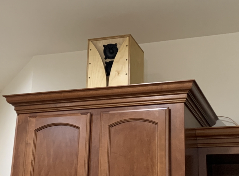

Not on their side, but I have a pair upside down sitting on top of my kitchen cabinets so the drivers are angled down into the room. That works well for me. Mini Karlsonator (0.53X) with Dual TC9FDs
I imagine the listening area might get narrow horizontally if they’re on their side.
Brilliant idea! That opens up so much possibility. Now I'm thinking the [explative deleted] Sonos in the kitchen really has to go 🙂
I have recently done that myself - placing the Karlsonators upside down up high above the kitchen cabinets to free up room from the counter tops. Still sounds pretty good.
I have used them in the side before and did not like the dispersion pattern as much. The K aperture needs to be vertical.
