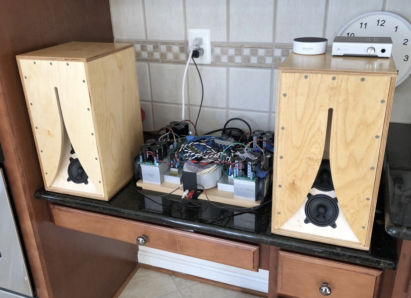

Jhofland built me a pair in BB plywood. I think it’s 12mm back in December 2018. Plans in Sketchup are here:
