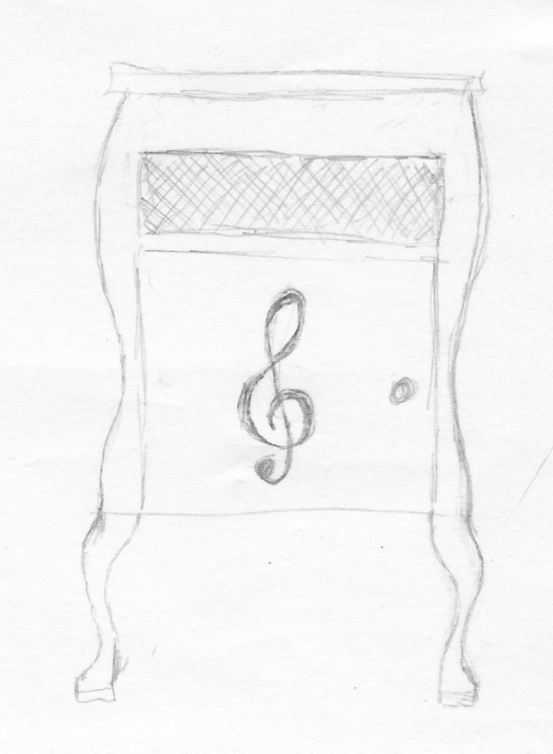

I laid the 0.53x on its side. It could work with 0.4x too. Just try it out.
So you want to lay two of them end to end inside that cloth grill?
The wide polar dispersion is best if oriented vertically though. What about dual 3FE25-2. Open face sealed Daggers behind the grill. Mono racetrack woofer in middle for a FAST. Mono below 300Hz.
how might it do if the two Karsonator (or XKi) to have the drivers "butted" so to have the high frequencies angled away from each other left to right rather than converging ? - -guess would depend upon the room's effects and distance from listener. As long as the speakers fit, it could be tried both ways.
(That console looks a lot like my 1917 Victrola)
...What about dual 3FE25-2. Open face sealed Daggers behind the grill. Mono racetrack woofer in middle for a FAST. Mono below 300Hz.
Thanks, something to think about. Are you suggesting run the 2 3FE25 in stereo or mono?
... drivers "butted" so to have the high frequencies angled away from each other left to right rather than converging ? ...
That's what I was thinking to try with the speakers. As for the design, exactly what I was aiming for 🙂
There is not that much separation to make it stereo unless you made a speaker like the SSS (single speaker stereo) type design. Two 16ohm in parallel mono gives great sensitivity at 8ohms and more power handling. Works well with a single 8in or even 12in woofer aimed down. Maybe XO closer to 150Hz.
