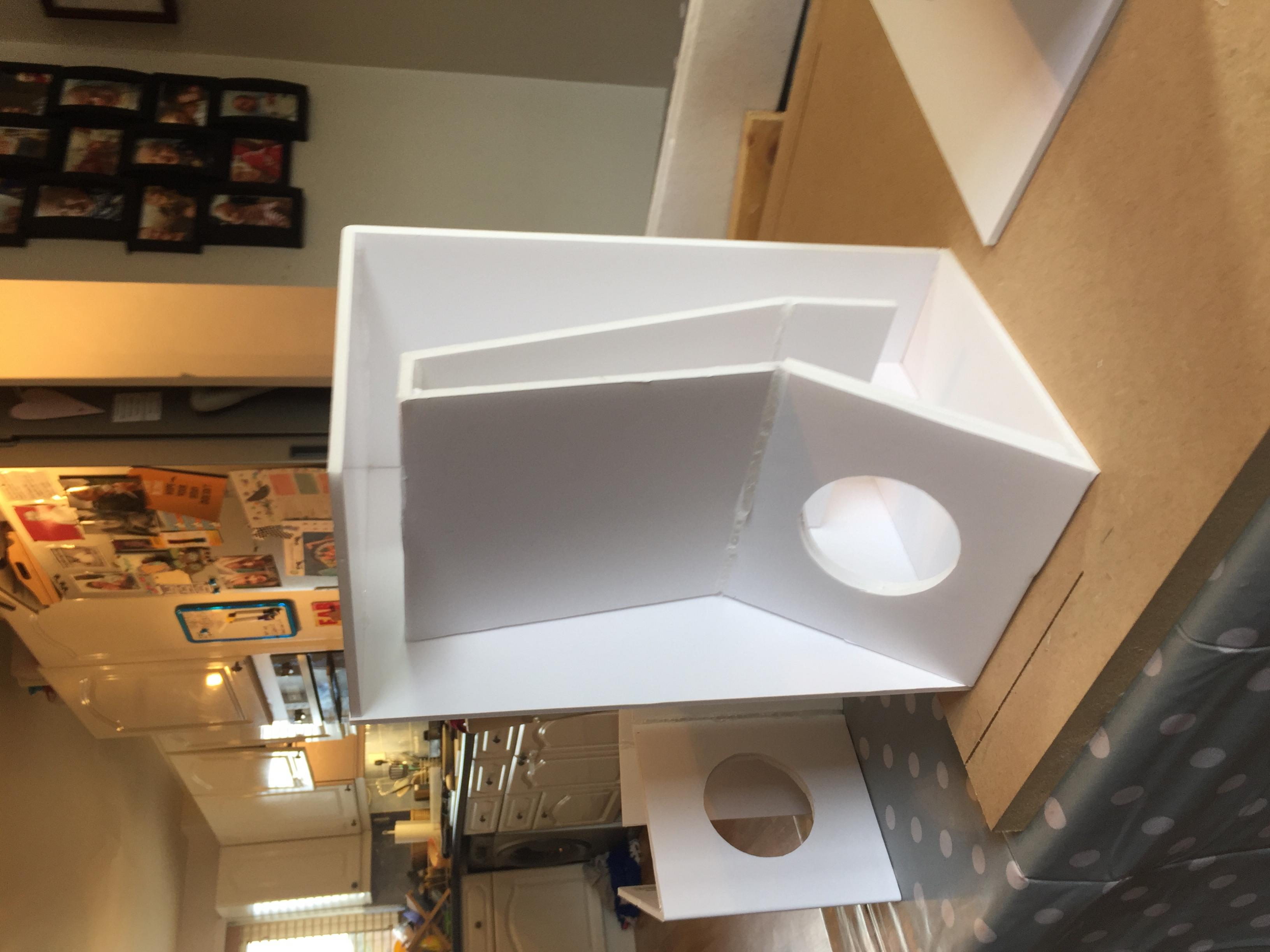

Hello gents,
I'm building my first pair of speakers and decided to start with these, in foam core and hot glue. Enjoying it so far!
I'm ordering some foam, felt and stuffing today from QTA Systems, but was wondering how far to go with it. Stuffing in the wedge-type cavity thing, foam on the back, top and bottom panels, and thin felt on the back of the front K aperture, according to Muddjester's nice drawing I'm following.
I also have some Silent Coat adhesive bitumen kicking around.
I'm wondering though, should I put foam on the sides as well? And should I use bitumen matting anywhere? I know from car audio that foam would normally go on top of any matting used. Don't really want to get her all glued up then find I've missed something I shouldn't have.
Grateful for any advice!

Bearforce One. Don't overdo the stuffing and damping. The link X shared is great, but applies to wooden enclosures. You are using foam core and it does not require a lot. You mention foam, felt and stuffing 😱
Have a look at these examples:
Mini Karlsonator (0.53X) with Dual TC9FD's
Hope it helps.

Thanks for the clarification, Twocents. Yes, foamcore does not require all the extra pads in the front chamber.

Thanks, that's helpful. Reason I asked was I've been following this drawing:
View attachment Karlson Stuffing.doc

I was also going to ask, how do you fix the speaker to the foamcore? One of those little clips behind and a screw? I’m guessing you don’t just screw into the foamcore..

Yes, you can use screws into the foam core, but glue some foam core pieces (or even soft wood pieces) to the back of the baffle for the screws to bite into and more grip. I like to use what is called "drywall screws" - they have a course grain and are black. See X's example:I was also going to ask, how do you fix the speaker to the foamcore? One of those little clips behind and a screw? I’m guessing you don’t just screw into the foamcore..
Mini Karlsonator (0.53X) with Dual TC9FDs
Add some small squares of foam core and stack them a few layers thick. Screw right into to and use drywall screws with lots of thread. Don’t overtighten.
Wood with proper damping sounds as good or better. Bass quality is deeper and more powerful with wood. Less rattling from vibration at higher SPL. But foam properly braced and damped doesn’t rattle either.

I have some drywall screws kicking around, so I will use this method, thank you.
I've noticed the TC9 comes with a gasket on the front. I'll see if I can trace an outline of this to replicate it for the back when my gasket tape turns up. The driver fits in nice and snug to the 3" hole. Might chamfer her down a bit from the back before fixing in.
