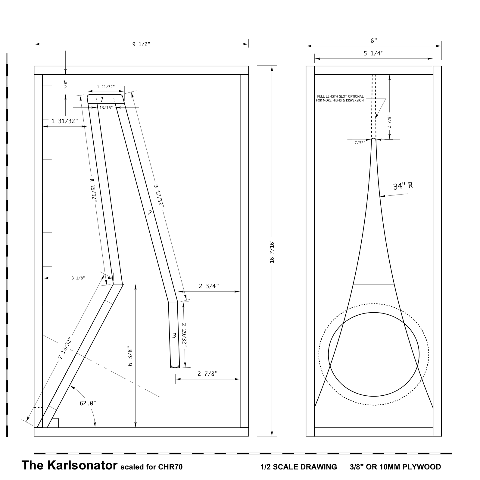

Can someone direct me to explanation how does the karlsonator is different from BP6 series enclosure (or BP6 series enclosure is just an approach to a karlsonator because it is the closest to theoritical explanation)? And what is the reason for the shape of the front chamber?
It is a mass loaded transmission line alignment with some partial feedback like a tapped horn provided by the Karlson aperture which directs some of the bass across the front of the driver (although not much of a BP6 effect). The tuning of the frequency is dependent on both the box volume and length of the folded TL, and the constriction of the vent.

Surprisingly, I have not simulated a Karlsonator for it if I recall. The Qts is a bit low - more suited to an XKi or a BLH, or FLH, or plain open faced reflex. My guess is that it won't simulate well in Karlsonator - Qts is too low and you won't get much bass as Karlsonator likes moderate to highish Qts in order to get the bass to go lower than the Fs.

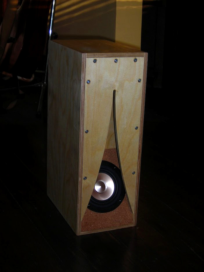

I also would recommend W5-2143 in 0.53 Karlsinator. Great driver, great enclosure, easy to build from 1cm foamcore. I did it so literally anyone can, promise.

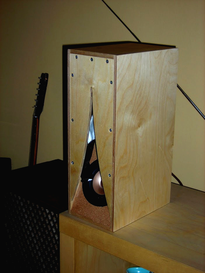

I remember that unique aspect ratio - tall and skinny but deep. I bet that combo sounds really good for GregB to make 3 more.
X has me intrigued by all the experimentation with this design. my TABAQ CHR70 is not that great, so this would be an interesting design to try..dB
Use foam core to make one first before committing to wood. Make sure you like it. If you make it in wood you need to line the inside chamber with melamine foam and the front chamber with melamine foam and back of K aperture with foam core and felt. That’s been my experience making Karlsonators out of wood.
