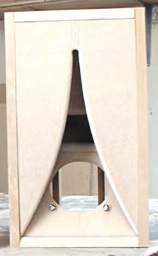

I think that this Louisson slot works pretty much as well as the spacer system I had before in terms of airiness but the woofers are much less vulnerable.
I cant be sure yet, as I've only been listening to a rubbish Sky signal thus far, but in the weekend will have a good listen. Im fairly confident that this will be as good.
Then I will set about modifying the Karlson slot. I have a new template for that; and intend doing largely what you've done Moray. The entire woofer will be visible and the slot will be much wider. I'm not really fussed how the speaker looks, but prefer the Karlson slot to a couple of slabs of foamboard.

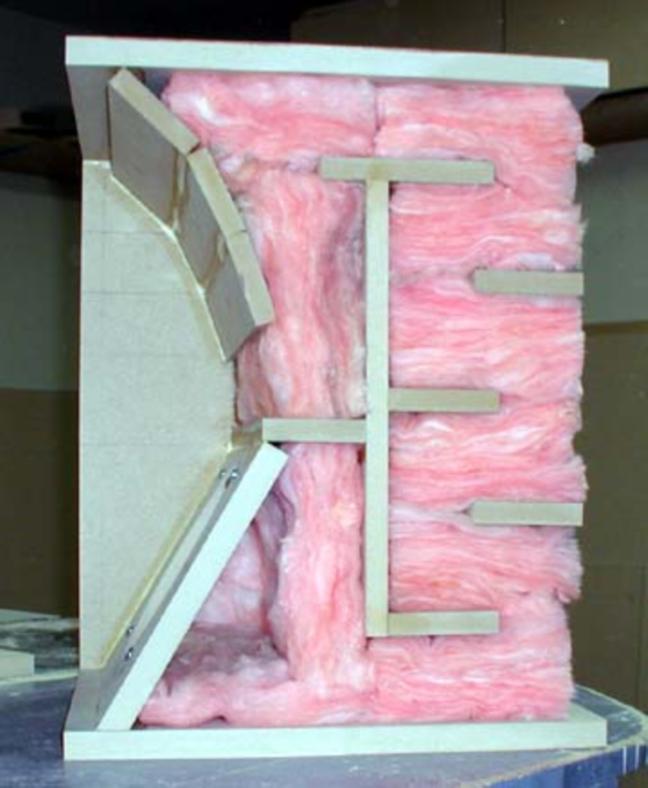

to save material...
If you make a pair of new tapers which will roll off to the side walls of the cabinet just above the woofer but leave the gap at the top of the cabinet the same as your existing pair (and if you keep notes) you can progressively cut open the gap at the top by increments of say an eighth at a go and see what you think at each set then compare you notes an cut open you original tapers to what ever to gap you liked best. My Karlson T Line were done that way and once I got the stuffing right they presented some of the finest most realistic stage and image I have heard to date (provided the recording had captured that).

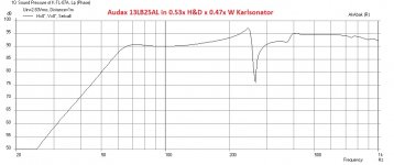

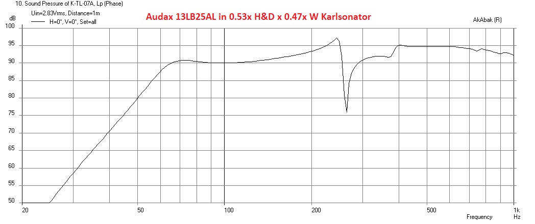

hi von Ah,
Here is the sim for the Audax 13LB25AL in a Karlsonator. That driver has some impressive specs. It works well in a 0.53x height and depth and reduce the width a bit to 0.47x. Here is the predicted frequency response (below 500hz is good). Looks like you can get a solid 91dB sensitivity even after baffle step loss.
Excellent, thank you!
That looks pretty darn good for a driver expected to have minimal bass output.
And I was hoping for the K aperture to help out with high frequency dispersion.
The Karlsonator is such a versatile enclosure and hard to beat.
