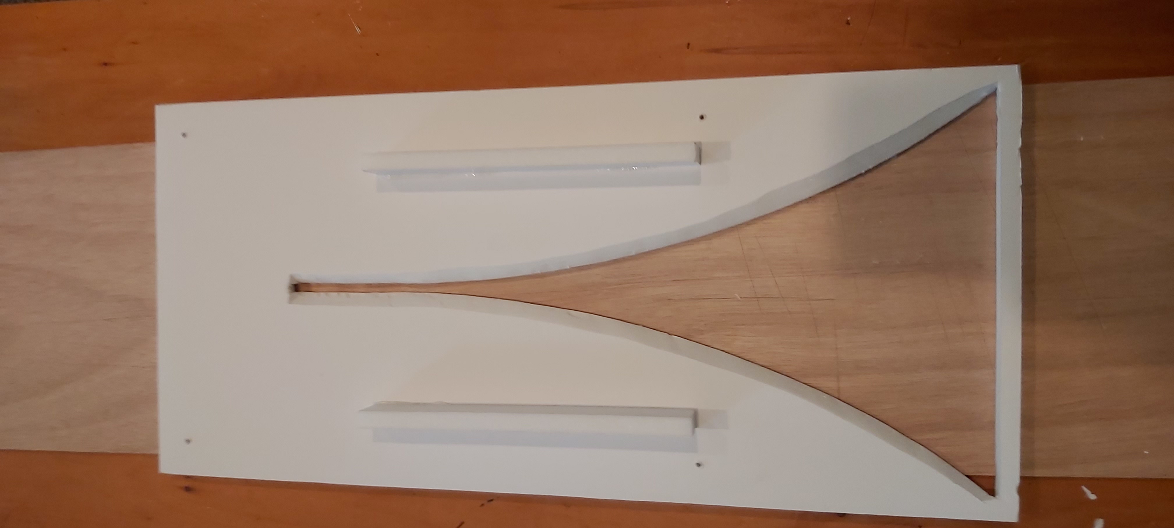

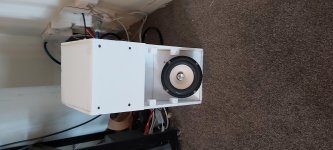

So I had a half hour spare this arvo and did this to the inside of the Karlson slot. I simply ran the scalpel knife on a shallower angle from the outside of the slot, making the opening smoother. Turning it from a 90 degree angle to a 45 degree angle. Might not do much, but might also be an easy fix to that somewhat closed in sound?
Nope, that didn't do it.
So next step is to open up the lower aspect of the slot slightly, as X advises.
I dont really have any problem with this issue because I like the speakers without the slot anyway; they image nicely like that, just not as wide.
And it's just there's even more bass with the slot in place. I will make up a new template, print it out in A3 size and then make the wider cut out on the foamboard I have left over.
Although thinking about it, Im probably better off just modding what I already have here, given it's a subtraction exercise.
the upper portion of a K-aperture "can" have a lot of subjective impact. If too tight then mids can seem dull. In a dedicated design the aperture usually ~ subtends a driver's surround like my 1960's K8
Art Welter's dad's "K8" interpretation from the distributed slot K12 is a bit larger than a factory K8 more open aperture and very good sound
If you like the bass with the aperture then try just a square plate from top extending down maybe 5in to 7in. Make it 7in and trim away slowly if it still changes the treble too much. That will give the vent a little more bass and open the front of the aperture to the no aperture case. Easy enough to try with a rectangular piece of foam.
Thx for the suggestions. Clearly my aperture is too tight as it is; I need to go to the other extreme and then find a happy medium. I like what the slot does for imaging (over a wider area) and for bass so I'm keen to optimise both. Will try
1) a wider slot at the top
2) a wider slot at the bottom - the wings seem a bit wide to me and the driver too hooded
3) a rectangle with no slot that extends down 5" from the top
widen it a bit in the blue area - start a little lower than my botched attempt try to keep the change so the curve still looks nice,
When the aperture is too tight with wood construction, there's bounced components in that upper part trapped leaving the sound congested - dunno about 10mm foam. Also with wood K's if one snaps their fingers in the upper half of the front chamber, a ricochet/ treble slap echo (for lack of a better term) can be heard. With Fane's 250, I heard no artifacts with a K12 and hard surfaces. In an X15 copy and AN10, there were some making me wonder that in some cases, a straight panel as with K12 and the Karlsonator family is a better choice for small cabinets

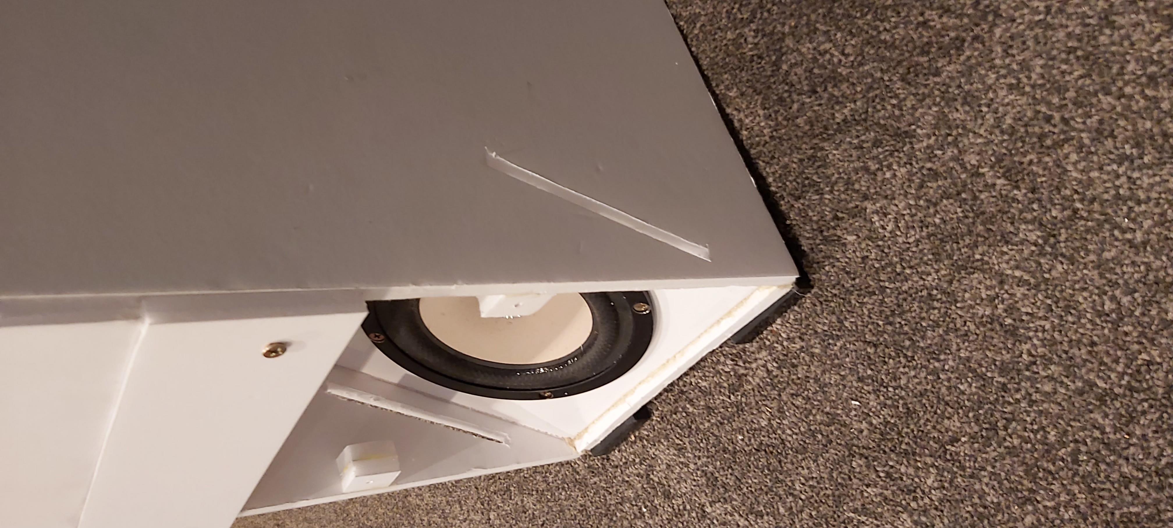

I took the K slot off today and just quickly installed a 7-inch rectangular section and it sounds much more open, so will play around with widening the slot from top to bottom a wee bit, until we get the right mix. Certainly with the rectangular shape at the top, it is back to being how it was without the slot, open and forthcoming, only with more bass. With the K slot in place, as it is, I need much more volume to get the right degree of loudness. So it is closed in in more ways than just voice and mids.

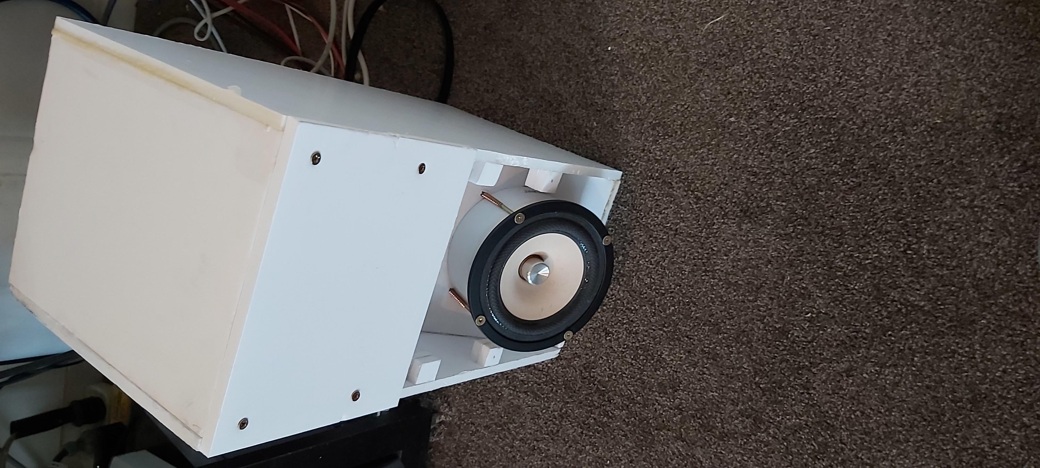

The Karlson purists will giggle and tsk tsk over this mod but in my opinion this really OPENS UP (please excuse the Trump-ism) the sound emerging from these quite incredible little cheapie foamcore giant killers.
The driver sits in a plastic storm water expansion joint. They cost knicks from our local hardware store. It makes the driver physically vulnerable (so the dogs cannot go near them and they know that).
Also you cannot use a Karlson slot on these; just a piece of rectangular foamboard, though I'm going to play around with different sizes as well.
So Im back to where i used to be when using the cylinders, only these do soooo much better bass.
Even from the next room these sound way more open and revealing. That little W5 driver is absolutely wizard, providing you don't feel the need to listen to party level music all the time.

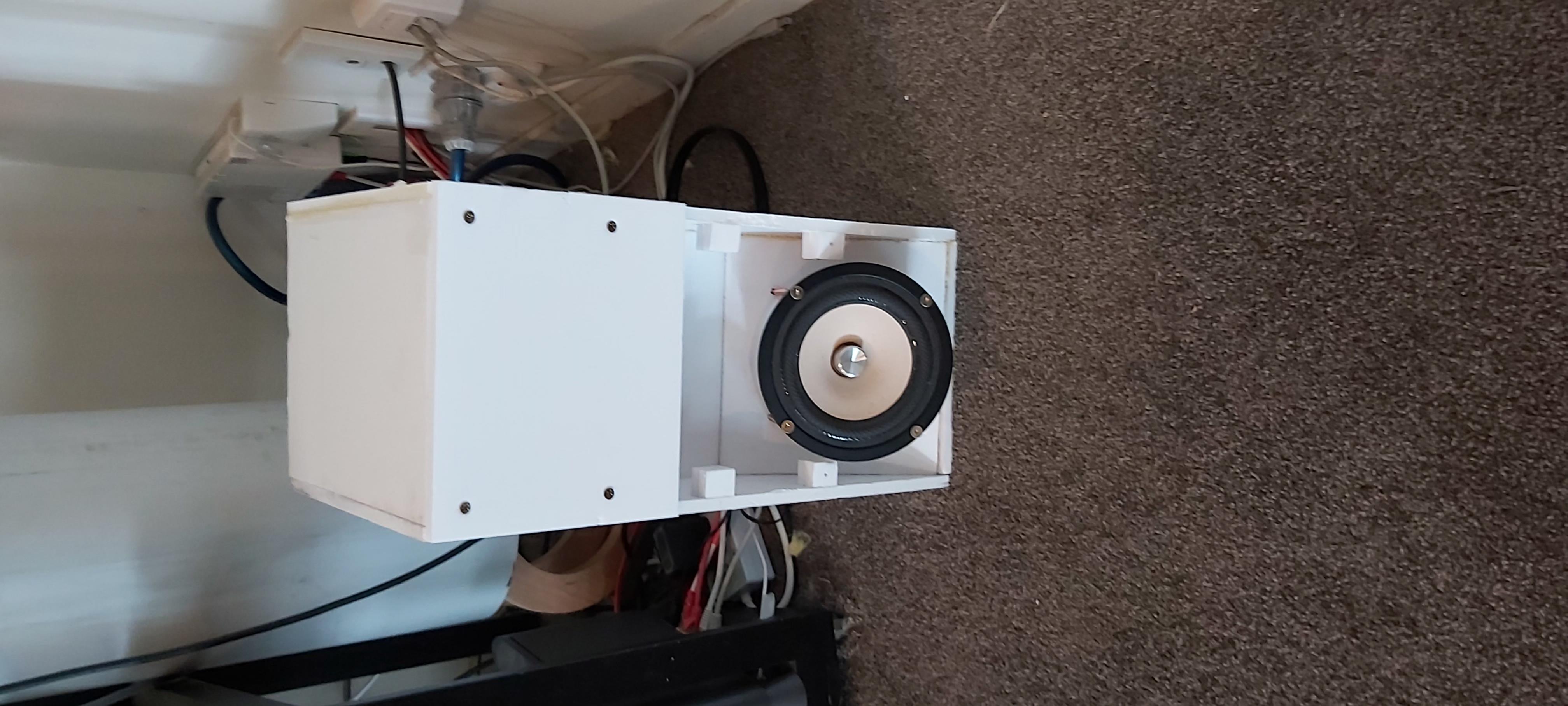

And another image.

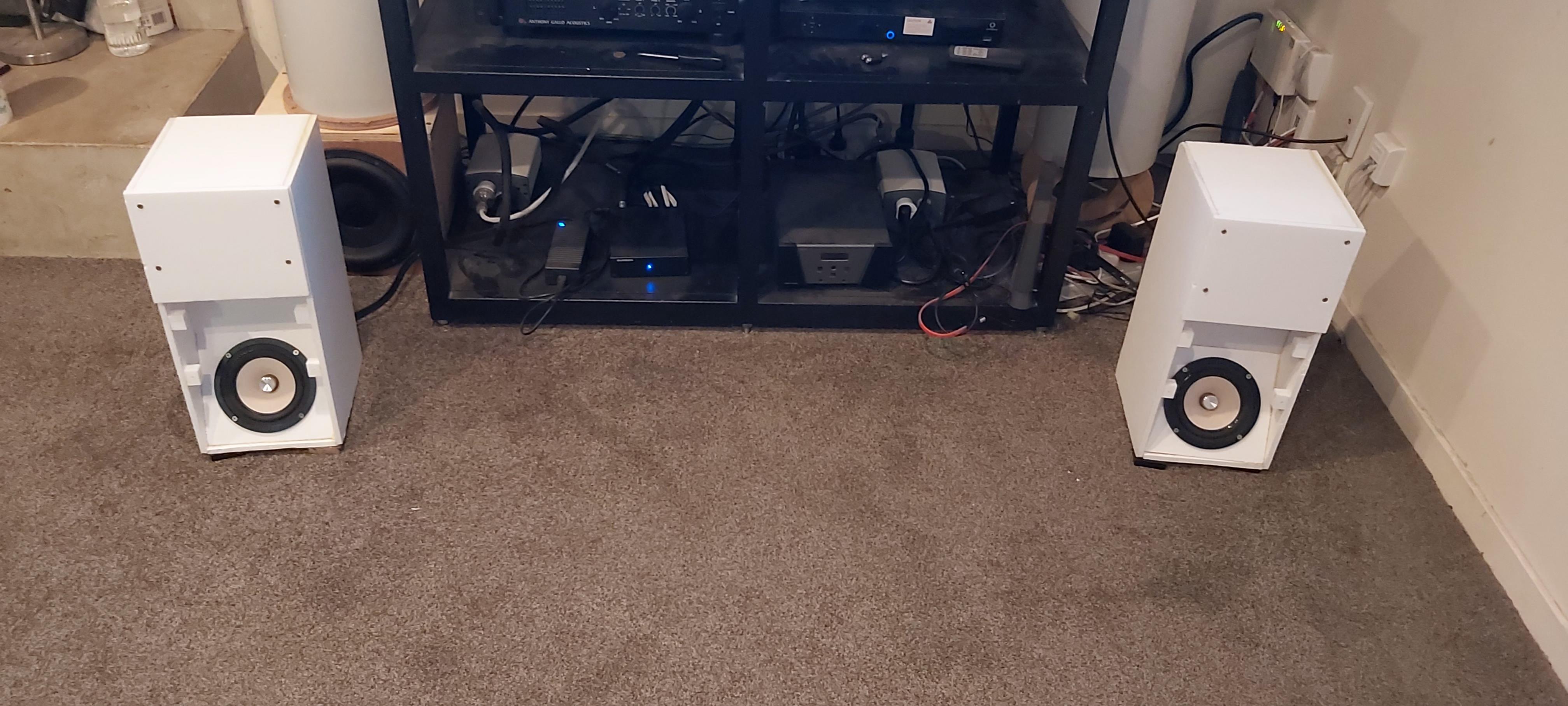

One other thing that continues to impress is the width of imaging, even without the Karlson slot.
Is this because the rear wave and front wave are emerging as one? No idea, but there's no head-in-a-vice
imaging here. It's impressive and as good in this regard as the waveguides that I have the FE32-8s in.

Neat trick. Perhaps you just need to make a mod and have the driver on a flush baffle but with the rear side same as the usual Karlsonator.
Right, only the driver would still be poking out and vulnerable, yes?
Actually, I think I get what you mean now; create a kind of rhomboid shape for the driver so it sits proud of where it normally is, but keep the rest the same. Would the increase in rear chamber size have any adverse effect though? As it is the extra space in the plastic chamber makes no discernible change to bass output.

I was thinking something along the lines of removing the side walls in the front chamber and leaving rear chamber the the same. You could try it by simply slicing the sides off with a razor. It would look a bit strange.

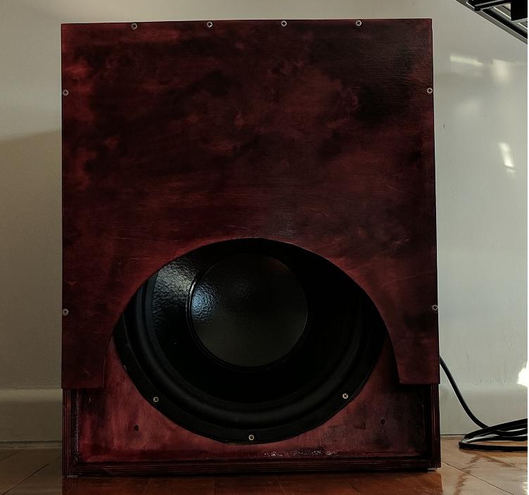

when Matthew Morgan J. did his Karlflex aperture investigation, the slot disappeared. PA310 can sound muddy in a K. With a passive lowpass, that could be offset by making the driver/filter pull more current.
Here's a 15 inch Karlflex built that way:
https://i.postimg.cc/HscnRWkN/Karlflex-15-K-Aperture-E-Lab15-subwoofer-Mattcalf.jpg
I had no trouble with K12 with Fane 12-250TC, Beyma 12cx, Kappa12, and 12LTA , C12CX - other than 12LTA lacking jump factpr. It needs another pound of magnet slug - maybe more. PA310 in K12 sounds like its under water.

And X, I had another idea which won't require cutting and gutting the side panels; I'll just put a little slot in there either side (to replace the one I don't have in front!)
And I can always cut back on the space I have so the driver isn't so vulnerable.
