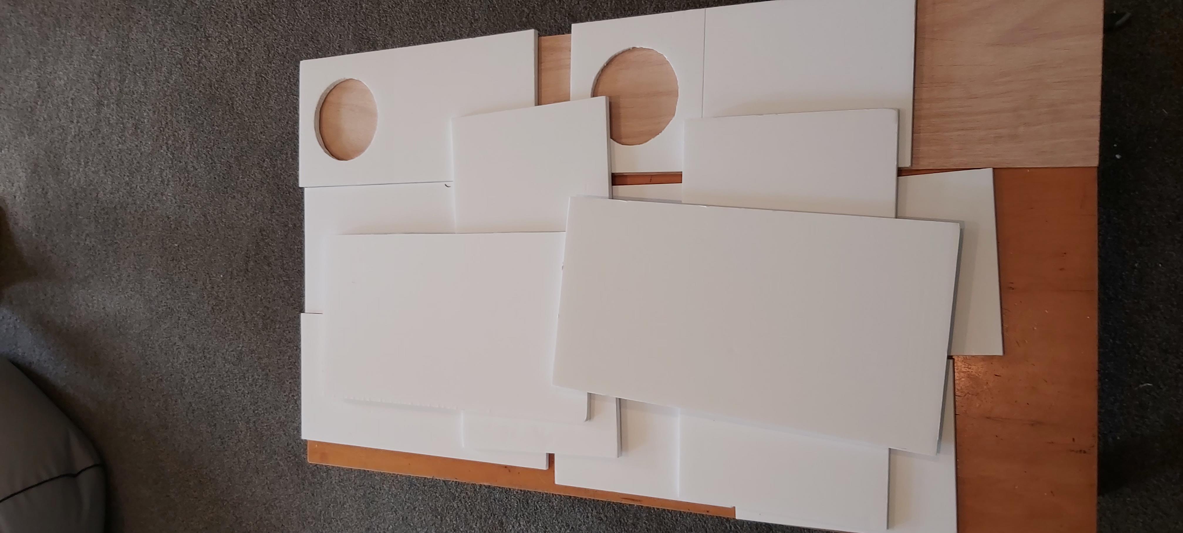

So Im underway with my build of the 0.53x Karlsonator using TB W5-2143 driver.
My first foamboard build. I began with EVA but felt it might not be quite rigid enough. Will reutilise the material with a smaller driver, probably Faital Pro four inch 8ohm, the 4FE32.
Meantime I've spent a Sunday cutting out all the bits and pieces, using 10mm foamboard. Seems hard-ish to cut but solid enough seemingly to hold the TB. Not a lightweight driver. So rather than double up I fashioned a wooden baffle out of 5mm hardboard and will glue that to the foamboard baffle for added rigidity and so I can screw the driver home properly.
Next part is gluing then.
On the plan there is a small 31mm section a bit over an inch long, at the end of the internal baffle at a slightly different angle to the 259mm section it attaches to, just in behind where the driver sits. Does it matter if it is not at a slight angle to the longer piece? Can I just continue it on as one straight line (to make it a 290mm straight line)?

It's not hard to score it and bend the foam for that shallow angle. If you must keep it one length, adjust the position so that the throat of it is the same 7cm gap.
