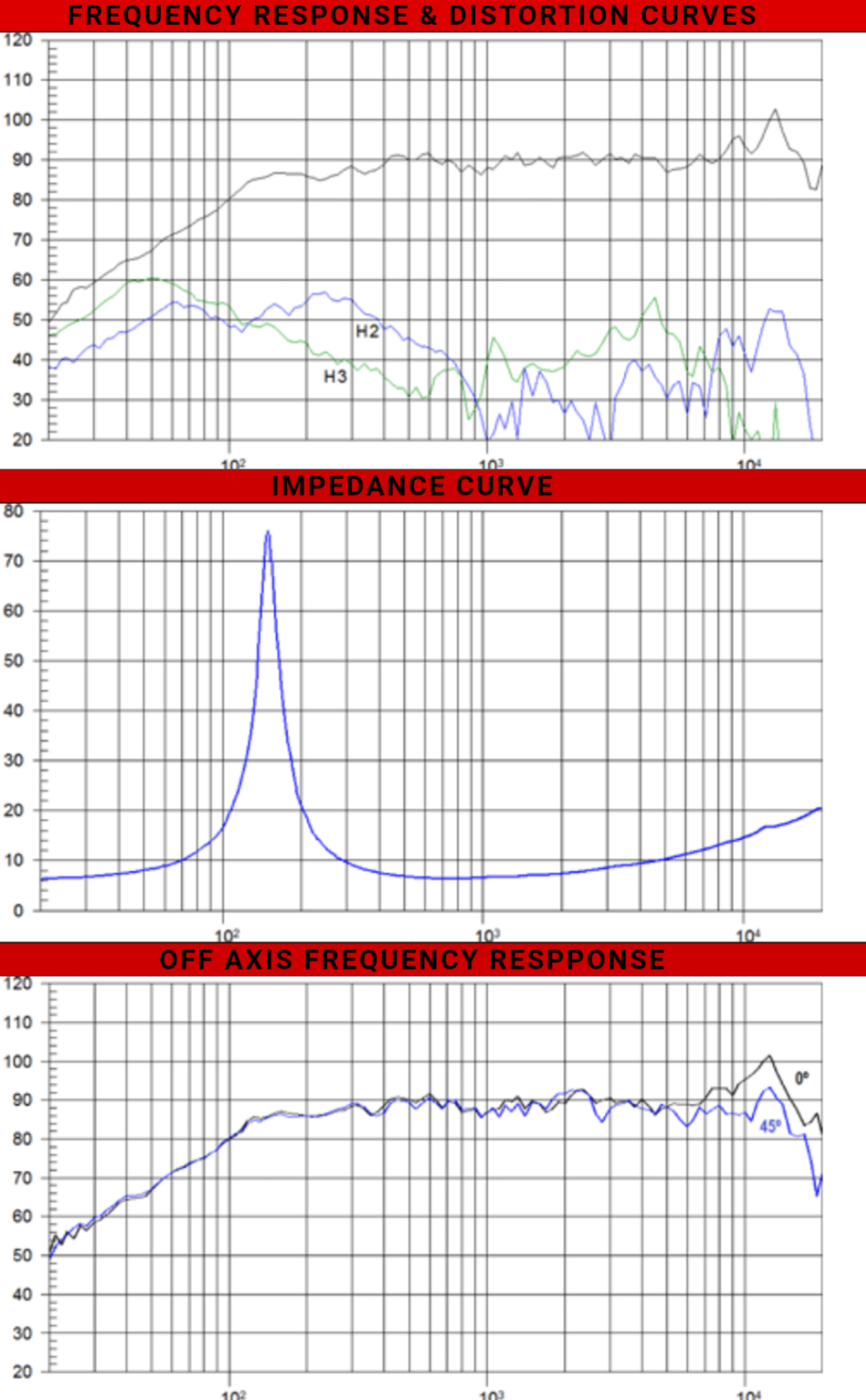

Yeah, I wasn't sure about the Beyma 3FR30, was hoping it might be like the 3FE22/25 and be able to hit lower notes with the Karlsonator magic (I still don't fully understand how it works).
I think the Beyma may be a bit more full range, this is what I found on it:

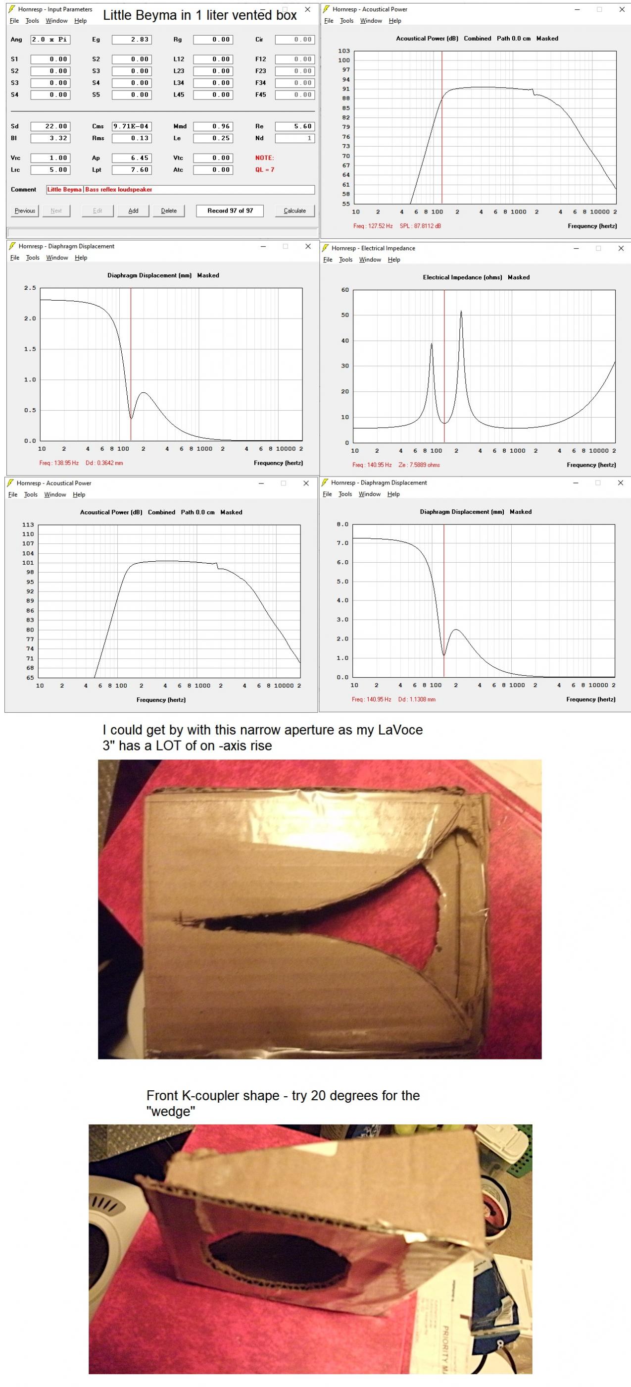

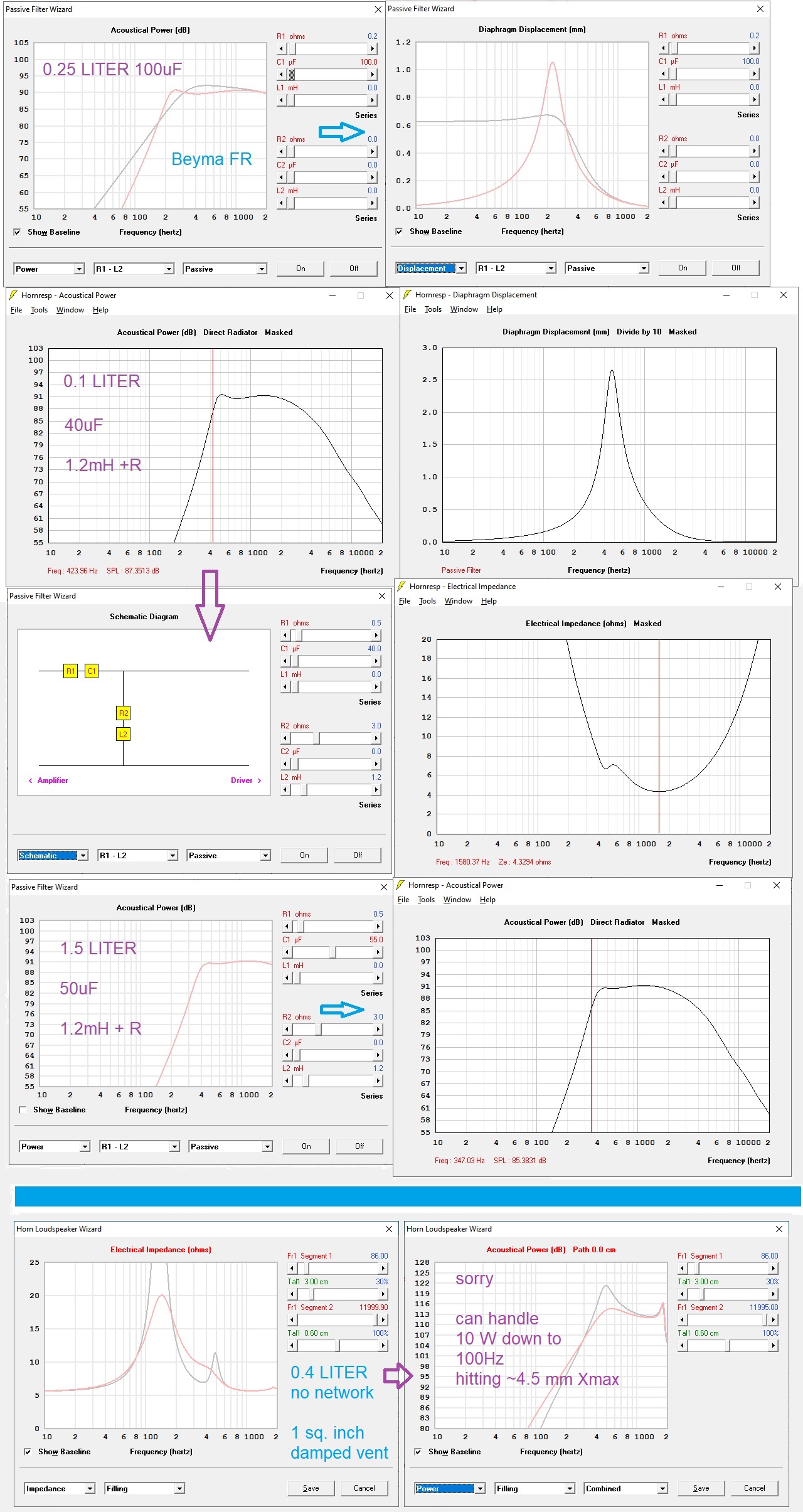

even with the generous Xmax, the little Beyma may run out of excursion unless bi-amping.
FWIW look at ways to reach the little tapped horn. Midrange would be pretty easy.
Also - experiment with very small Karlson front chambers using cardboard. Make the "wedge" angle 20 degrees, coupler width maybe an inch wider than the speaker frame. Maybe a bit more if needed for the wings curve. Coupler height perhaps 6 inches.
That's a typo in the image below "1.5 LITER"
it should be 0.15 LITER
A simple idea - make a one liter bass reflex back chamber and small volume K-coupler front chamber. Vent the back chamber out the rear.
I was able to use a narrow aperture with my 3" LaVoce as it has a lot of on-axis response rise. It really sounded holographic with some sounds.
For your Beyma, probably just make the aperture like a regular K. Alternately you could try a scaled JBL Ion slot in front of the cone - or if fancy, a mini -R-J.
The bottom reflex sim is at 10 watts nominal input (8.94v/8R)

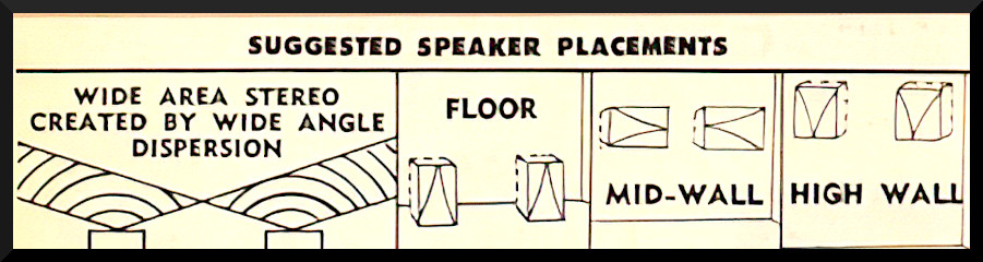

I'm planning to make a soundbar to put under my TV.
drivers that comes to mind :
Dayton Audio PS95-8 3-1/2"
or
Tang Band W3-315E 3"
partnered with a Tang Band W5-1138SMF 5-1/4"
to make a 2.1 system.
Is it possible to use the Karlsonator 0.4x design on it's side for this purpose?
Or are there better alternatives?
Plan is to put left and right channel with the sub in the middle.
Total length should be below 1 meter.
High below 22 cm

Yes, Thats what I'm looking for. The 3th one from the picture with a woofer cabinet in between them make 1 big horizontal speakercabinet.maybe - Normal placement for a stereo pair of Karlson enclosures turned sideways has them as in the chart below with the high frequency lobes pointing "in".
Maybe X will comment.
I have tried it horizontal and did not like the dispersion. It’s axis of symmetry is along the length of the aperture. Sideways you will be compromised on the polar pattern.

I've made several soundbars. A pair of folded Tabaq or Lance in a single enclosure work very well.
You can't change Karlsonator shape easily. Form follows function.

I was thinking about the folded TABAQ aswell.
But speaker is 44cm long. 2 of them make 88cm which leave only 12cm for the woofer box if I want to stay below 1m.
Also full range drivers will be only 66 cm (2X27cm +12cm) apart in that design. I want to push the full range driver as far apart as possible.
Or should I just save me all the hastle and build a closed box for the full range drivers and a BR for the woofer?
I just want to design some kind of TL system because I like to experience how it sounds like....

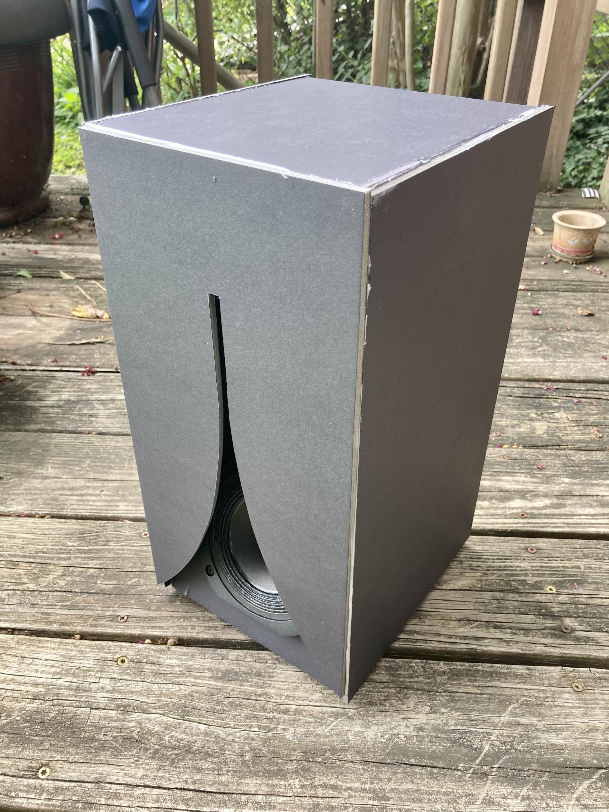

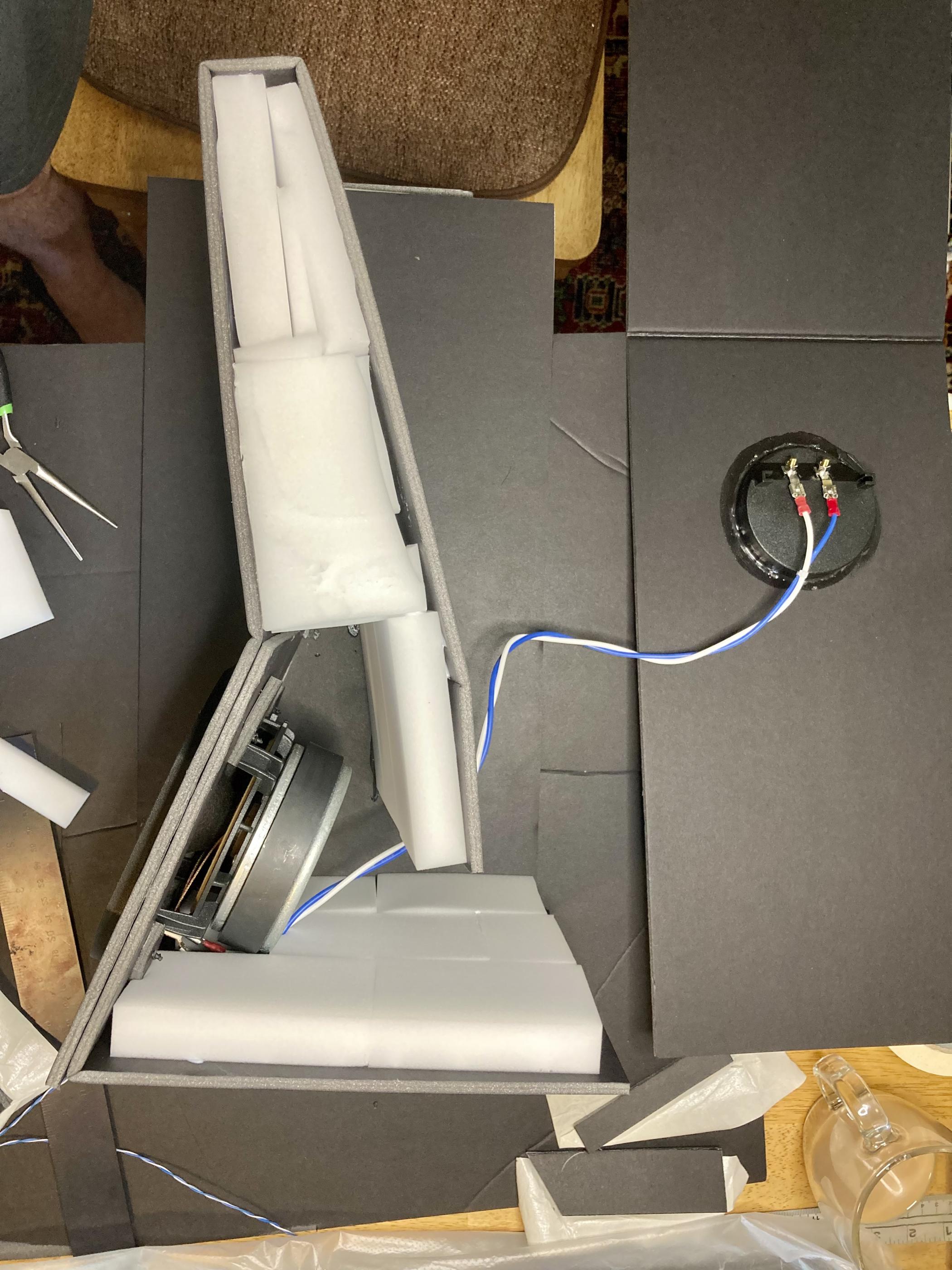

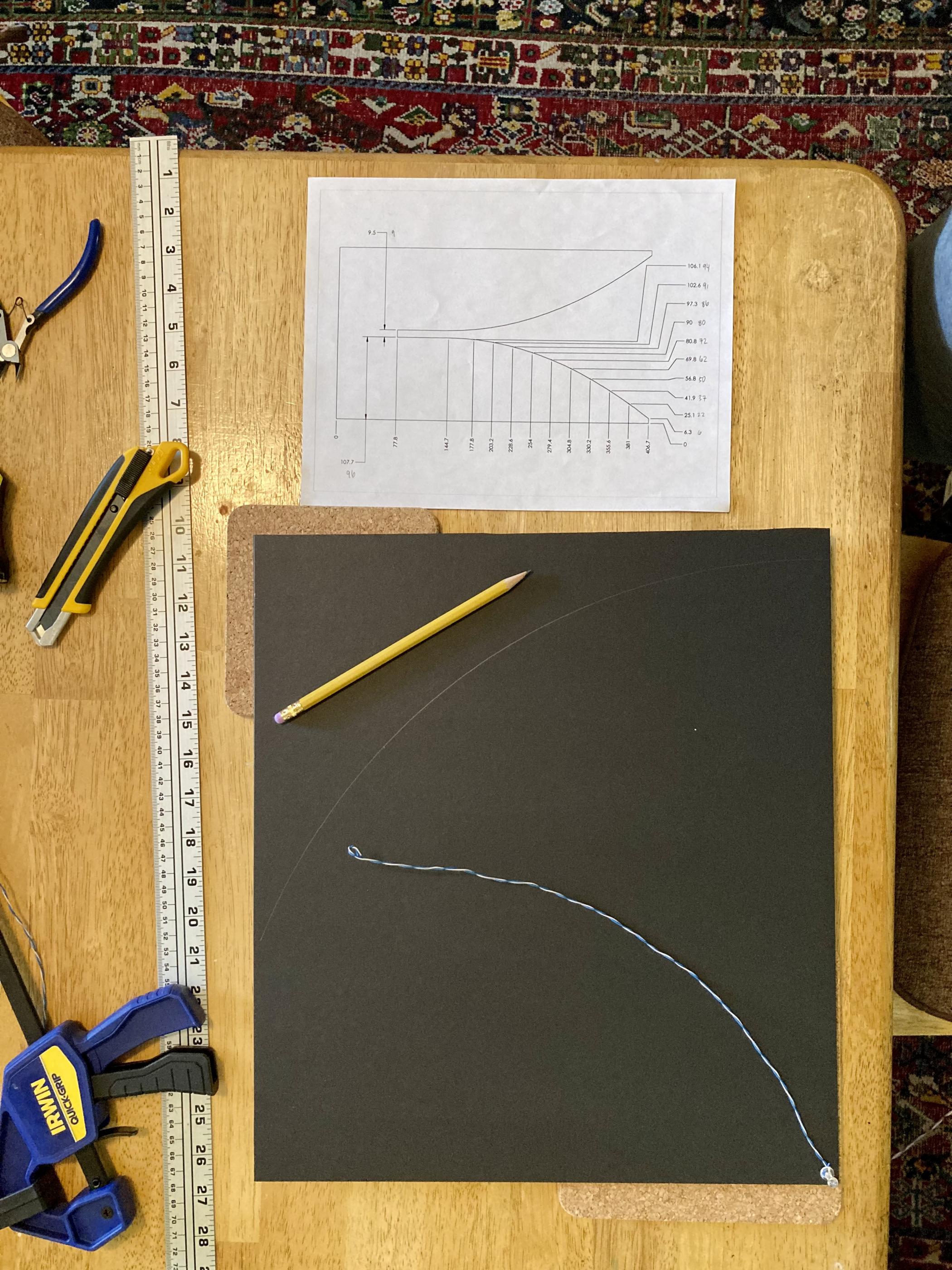

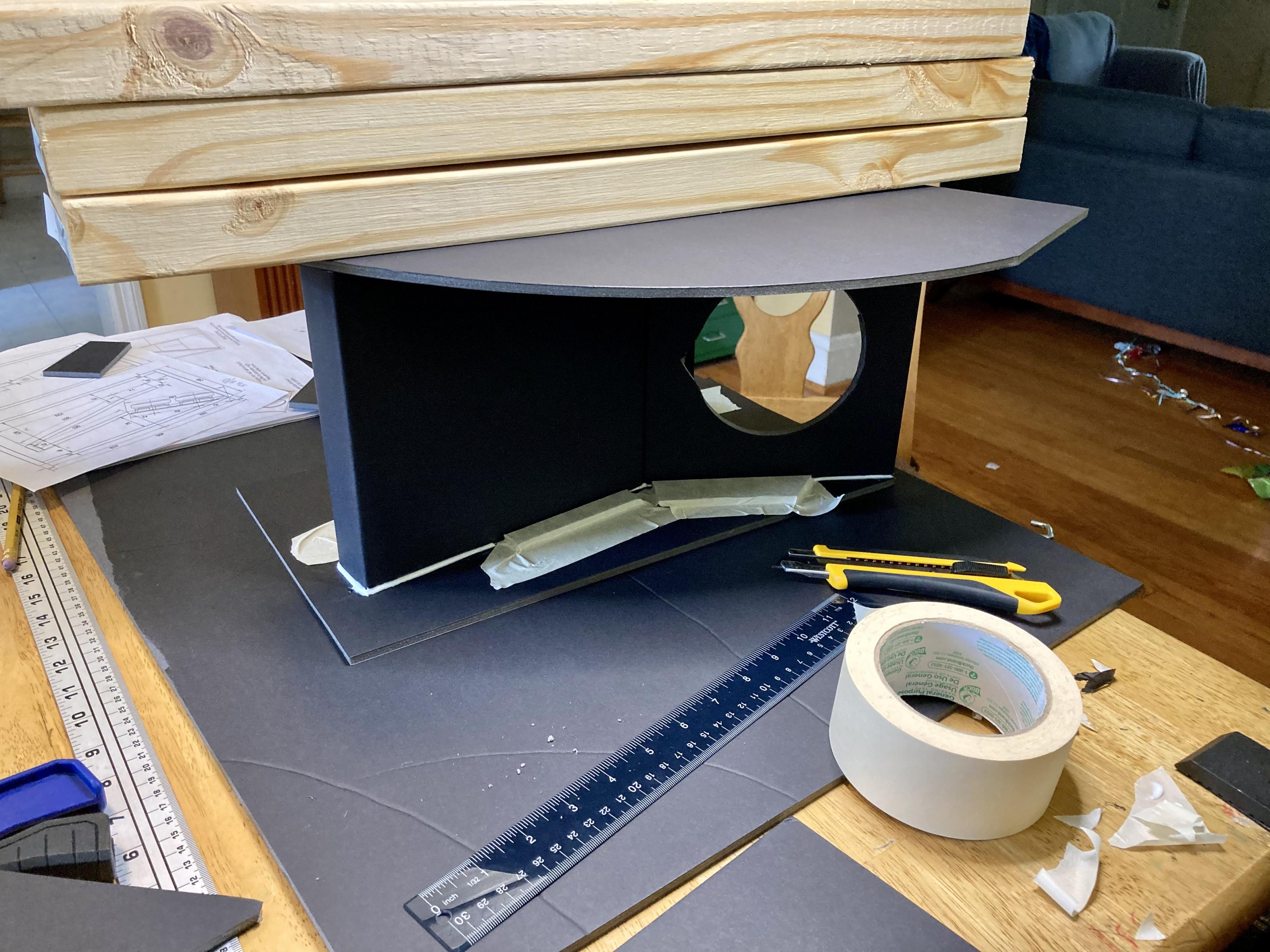

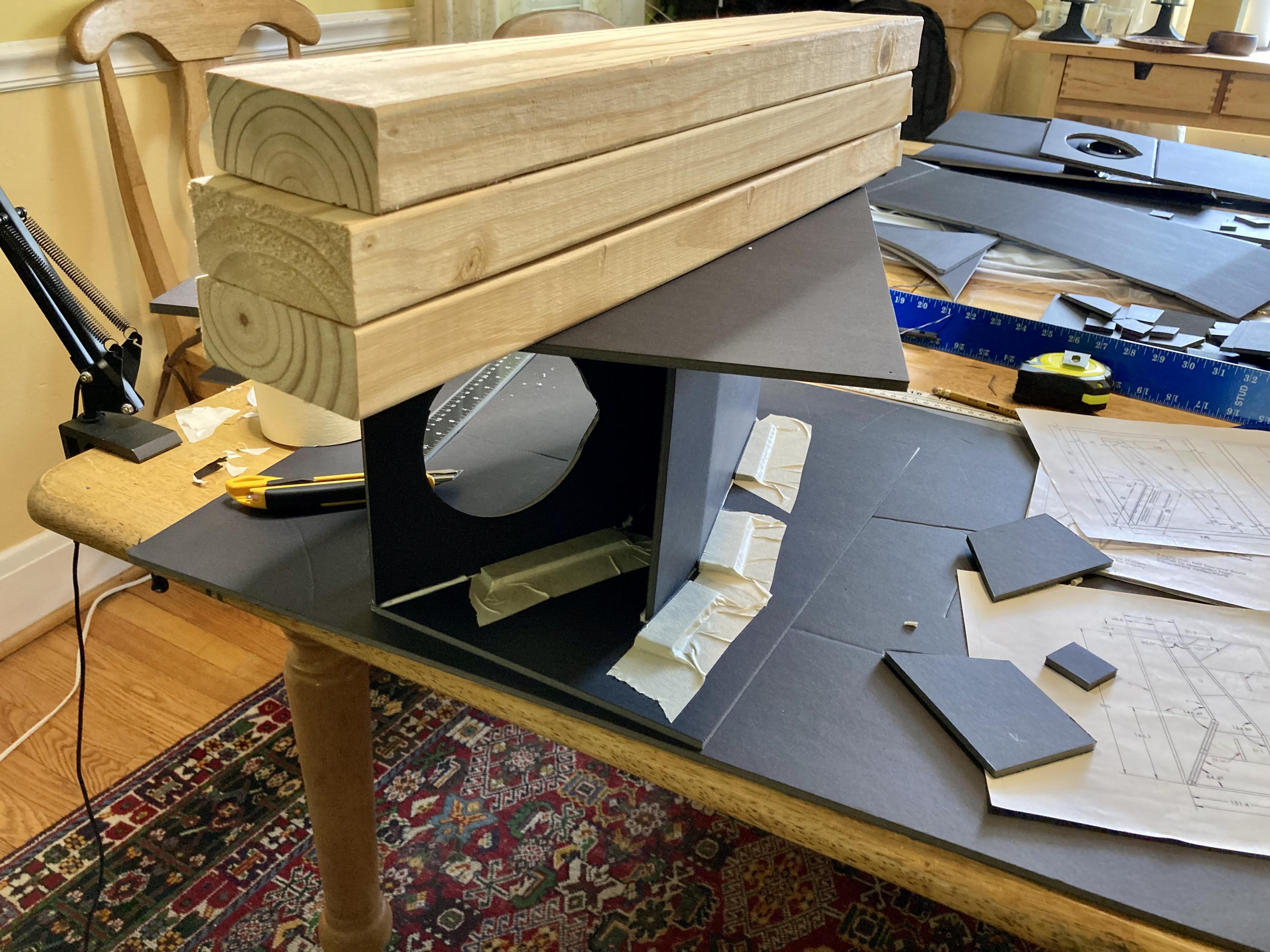

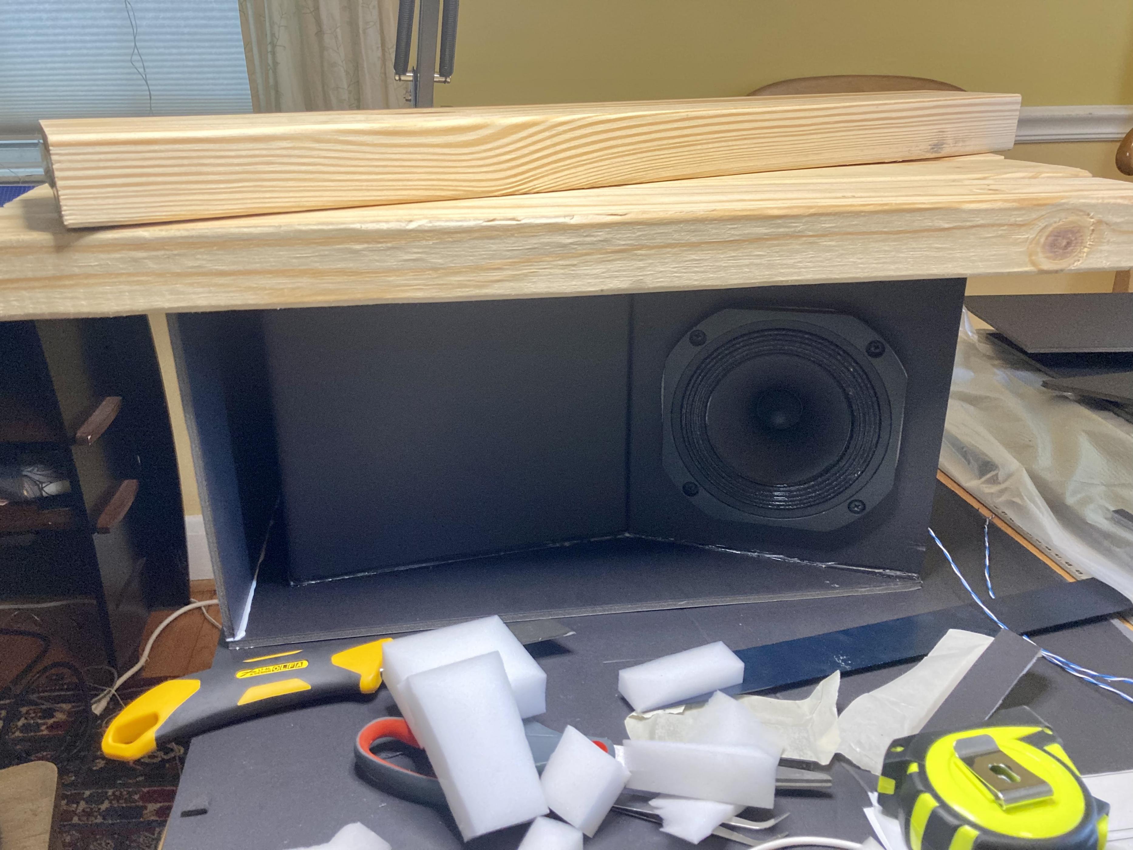

I finally committed to gluing up the Karlsonators (only one complete so far) for which I had cut all the foamcore (except the k aperture) many months ago.
The drivers are Audax 13LB25AL. xrk kindly ran the simulation for me and ended up with 0.53X height and depth by 0.47X wide.
Mini Karlsonator (0.53X) with Dual TC9FDs

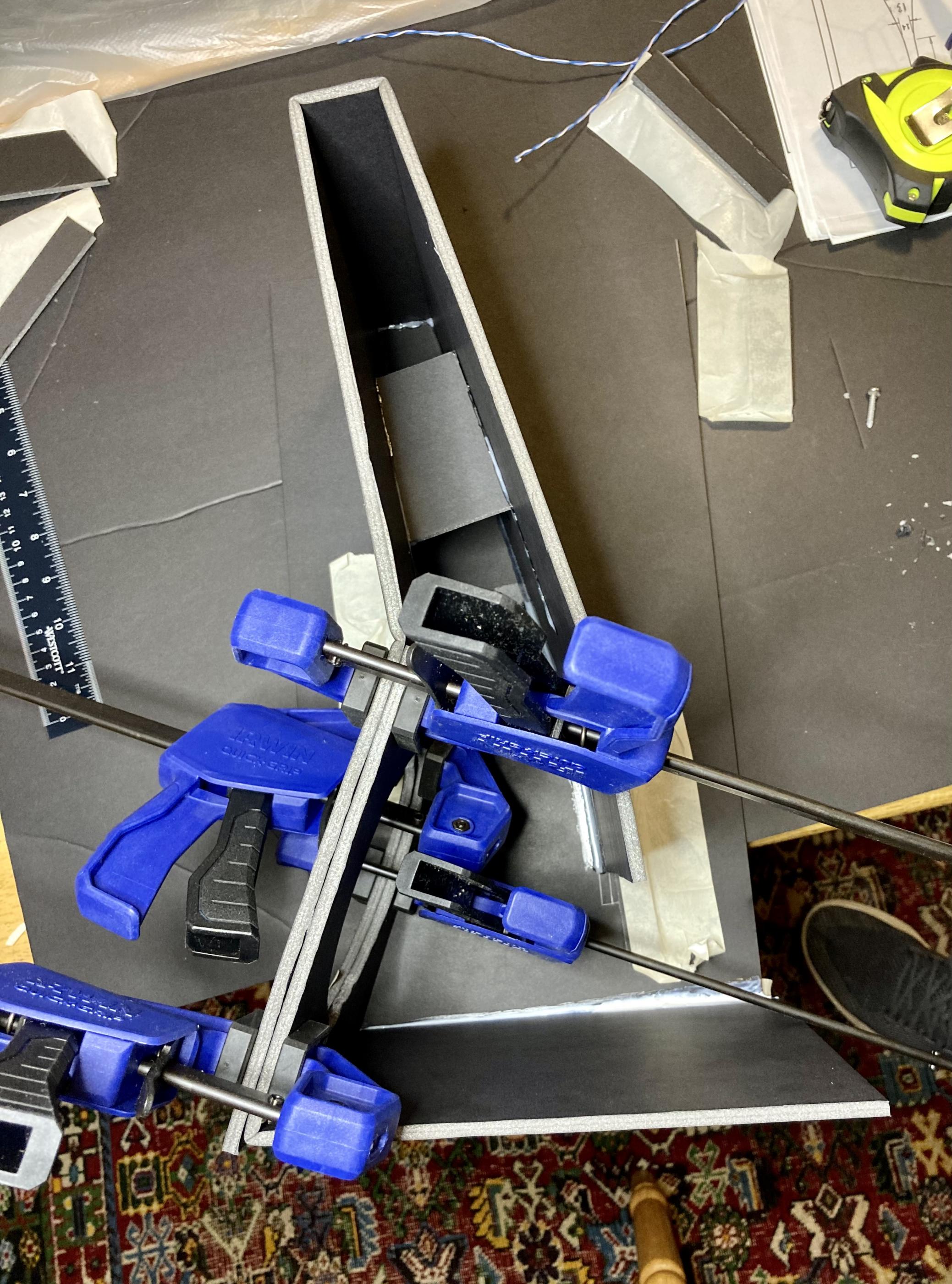

The foamcore is from a pack of black panels I ordered from Amazon last year. I used the score-and-fold method and plans (linked on page1 of this thread)
I wanted to try something slower than hot glue, so I used some clear low-VOC exterior caulk. This was a little TOO slow. 😛 I had to tape down some rail guides for the big interior fold and tape panels on exterior corners to hold the tension long enough for the caulk to cure. The big fold cured overnight.
First listening tests have been very interesting. Listening in mono in my main rig, at first it sounded harsh, shrieky, and all mids. I fooled around with bass and treble tone controls for a bit, which helped on some songs. Placed on top of my desk it sounded disappointing, honestly. However, once I placed it on the floor and stood back, everything came into place. It amazingly blends with the room exceptionally well if I am standing up. It’s quite a difference. So there is definitely a sweet spot in my room with at least one of these. In that spot, the disappearing trick happens and the sense of space is opened up. It’s fascinating. 🙂
Now I just need another 2 days to finish the second one! 🙄 I have some faster curing caulk that should be a little easier.
Process pictures attached. The final white beads will cure clear in several hours.
Thanks again to xrk for continuing his generosity with foamcore and Karlsonator designs.
