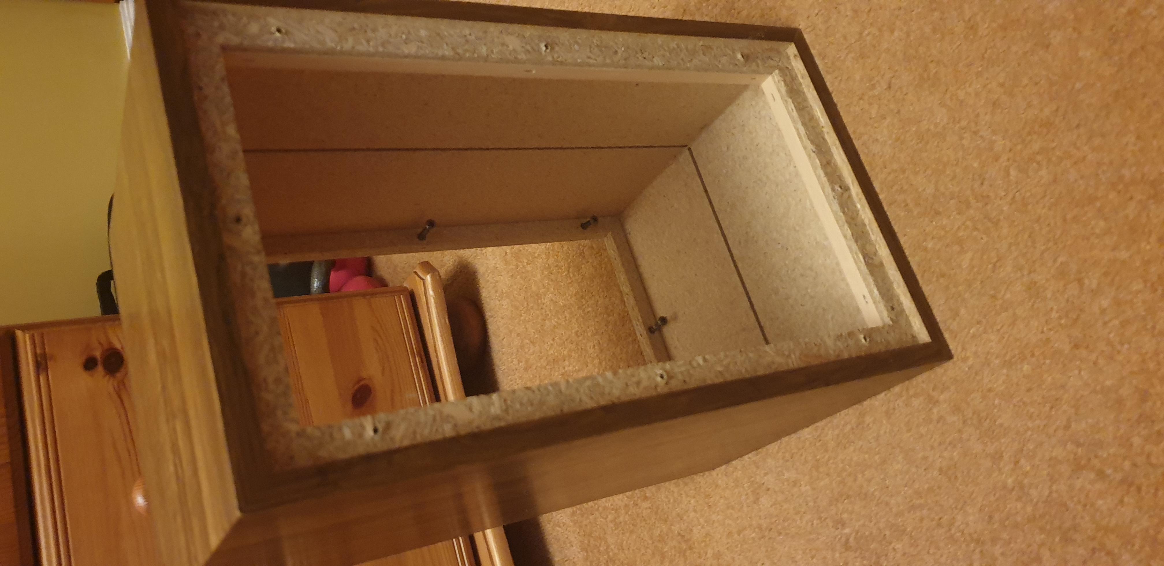

What are the critical aspects of the design.? I have some nice Wharfedale boxes i would like to repurpose. The rear panel and baffle are removable so I can access the inside. They are 350x195x235 internal if I ignore the lips to fix the baffle and rear cover.
I assume the 'vent' from the rear chamber is key and is related to the driver sd? I saw a comment about aiming for VAS to be similar to box volume and also Qts to be 0.5 to 0.8 or so and with an fs 50Hz or so. And the length of the line (TL ?) i assume is important too.

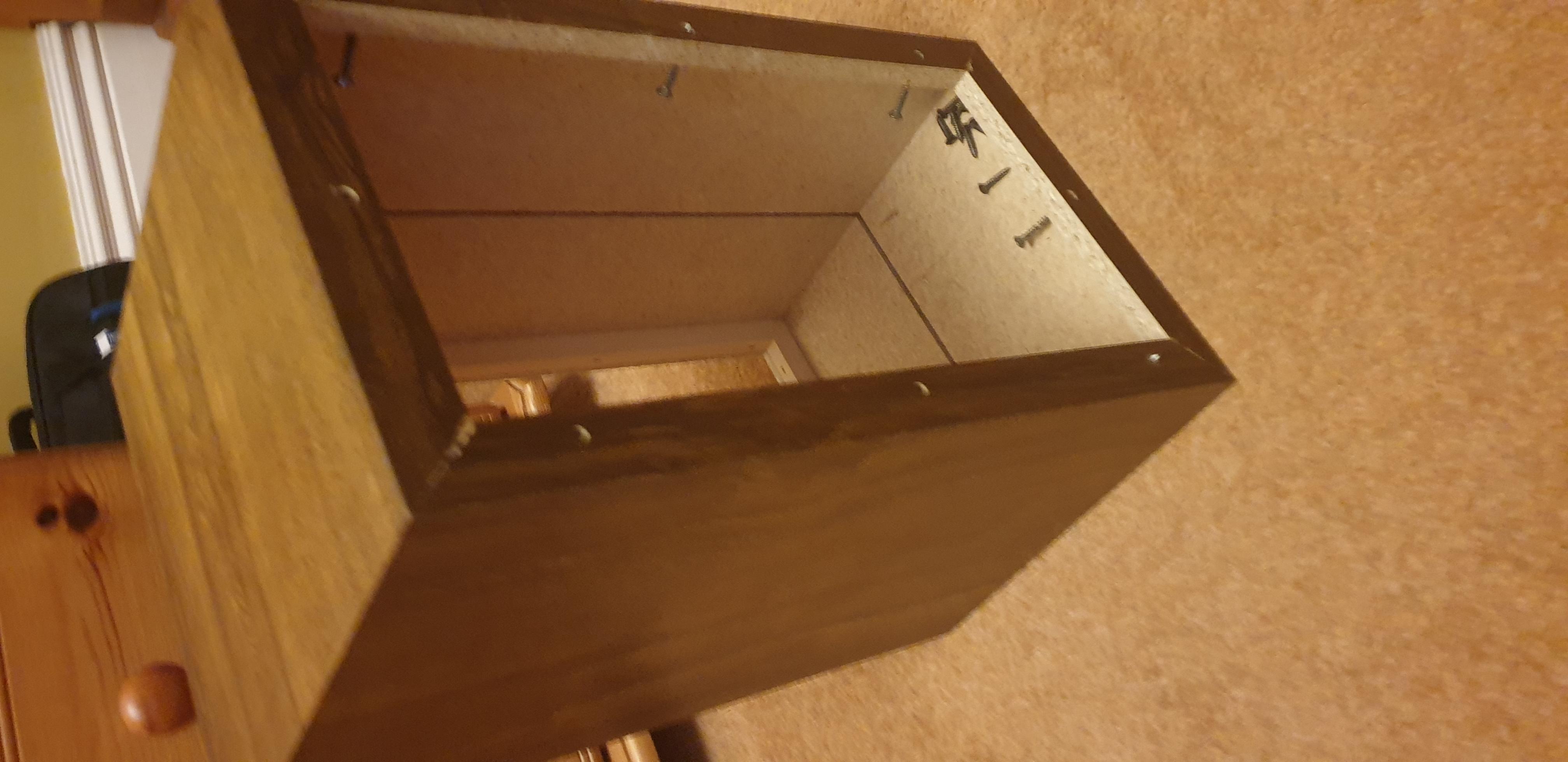

It needs to be simulated. Will need TS parameters from your drivers. I have been doing sims for various drivers for people since this thread started. I am a lot busier nowadays so takes me a few days or a week to get to it. I don’t know how you can repurpose an existing box because you need the sides to come apart in order to glue the new channels. It’s a folded mass loaded TL with the output feedback onto the driver via a K aperture.
If you want to repurpose a box, the XKi is easier. Just take 2/3rds total volume for rear chamber and 1/3rd for front. Calculate the bass reflex box vent size using rear volume and make a slot vent on the top equal to area and length calculated. Add K aperture.

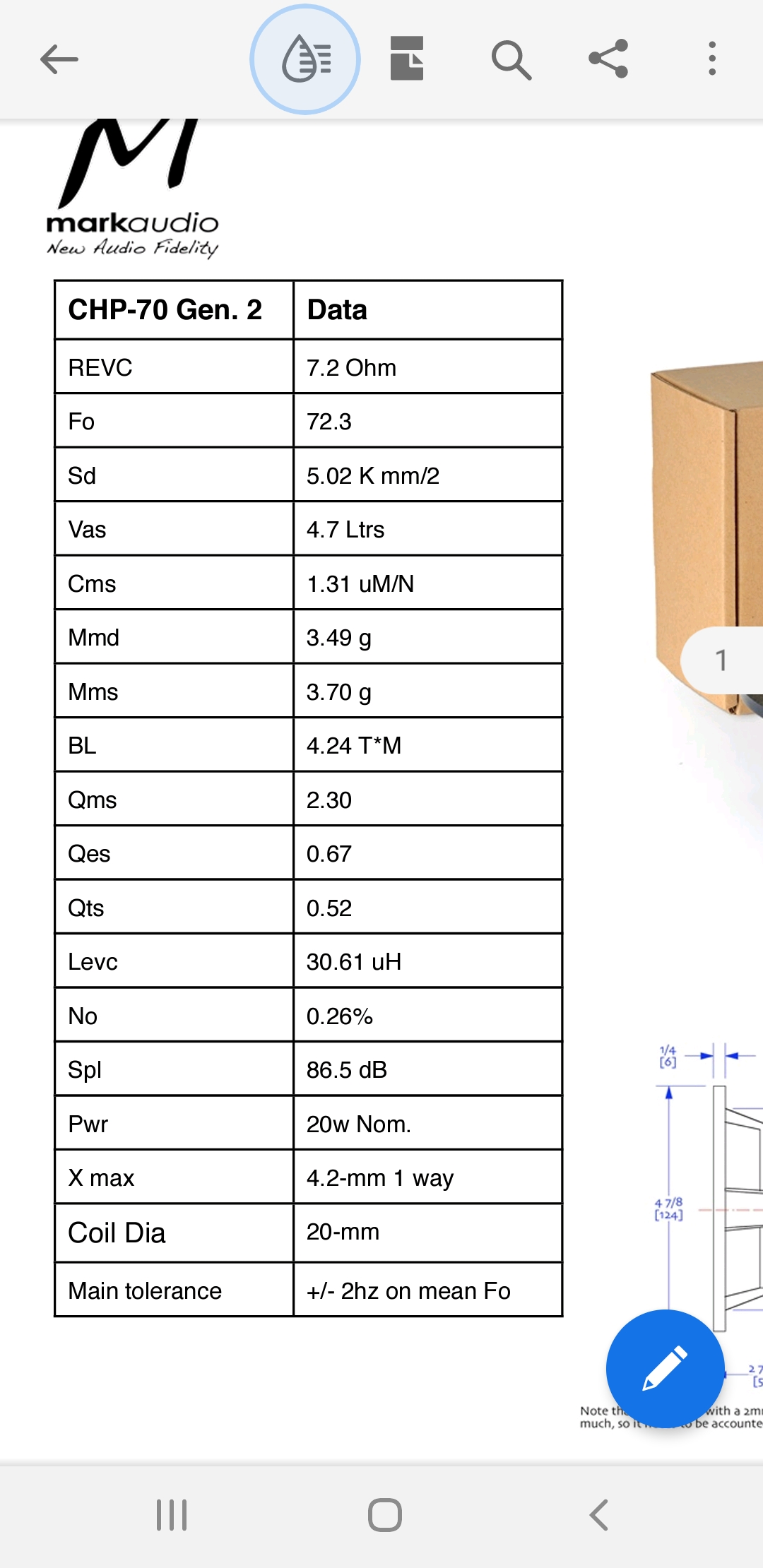

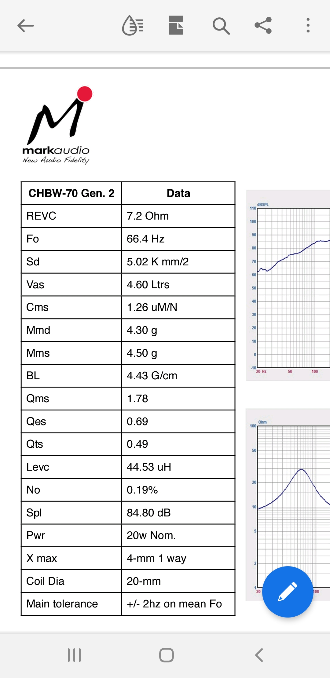

I have a couple different pairs of Mark Audio drivers dat doing nothing and didn't know if one may be suitable. (Thinking of just using one pair)
Please don't expend any time unless you do have to fire up the software.
The boxes look like this at the moment and so its possible to create the folded channel.

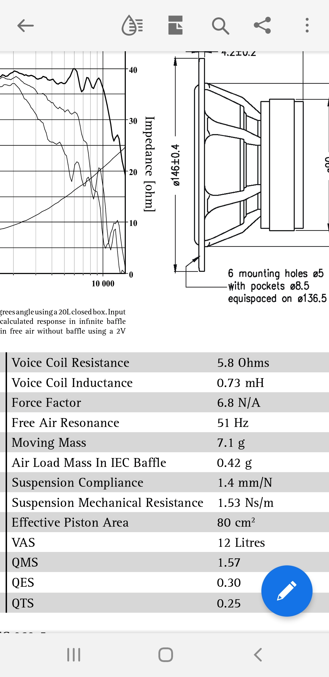

Or i have these Seas MCA15. I dont expect you to sim all 3 X but if casting your eyes over the TS parameters tells you one is better than the other please just go for that one. And again only when you have the software open, don't make a special effort. Thanks

I made a nice design for CHN-70 that probably would work well for any MA CCX-70. Also works for Radio Shack 40-1197.
