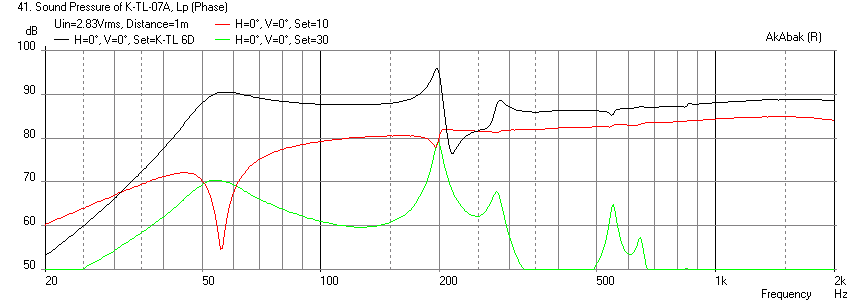

Any chance you could suggest dims for 2x chr70 per cab? I have 2 pairs of the german version, the omnes bb4.al, looking for a home. Would doubling up the drivers have noticeable benefits?
Thanks for all the great work!
btw, followed your (and wushiliu's) advice and picked up a little tpa3116 amp from ebay and it sounds great!
Hi xrk971,Make it 0.53x scale (15 in tall) by 5 inch wide.
Karlsonator with dual CHR70 Omnes
Giantstairs,
Glad you like the TPA3116D2 amp! It is the perfect amp for full range drivers as we hardly ever see the need for more than 40 or 50 watts/ch.
The dual CHR70 Omnes is an interesting pairing with the Karlsonator. The bezel on MA drivers is huge - if that was my one complaint, they should be smaller in the future (probably large size needed for strength since made of plastic?). The bezel is nearly 5 in in diameter which necessitates a scale on the Karlsonator to be at least 0.75x in order to accommodate the two driver bezels. This is not exactly a mini anymore at 22 in tall - but hey, the bass performance will amaze you in this box at that size. The optimized design ended up at 0.75x for length and depth (13.2 in deep) and 0.47x in width (7 in wide). It will be a tall aspect ratio cabinet. The drivers are connected in series as the Re is 3.6 ohms for a total 8 ohm nominal load.
The SPL vs Freq looks very good with an average SPL in the bass region of about 90dB at 2.83V and 1m. The -3dB point for bass extension is about 45 Hz which is very good.

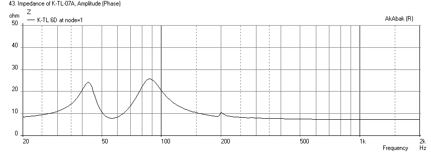

The impedance looks very good for most amps and is flat in the HF region:

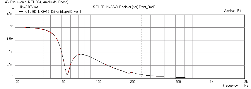

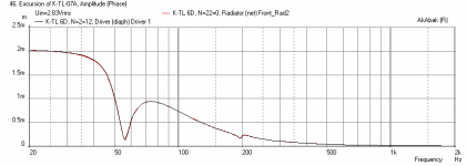

The cone excursion is manageable, if you have lof freq content, a high pass filter before the amp might be needed to stay below 4.5mm.

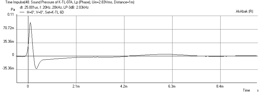

Finally, the impulse response is about as good as you can get - very clean tight dynamics. Drums, guitar, pianos should sound very crisp and lifelike.
I hope you build it - please post pics!

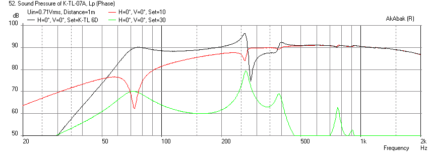

If you had a Bose 901 driver and an amp capable of driving a 1 ohm load, here is how it would look at 0.71 volts drive (1 watt at 1 meter). Not too bad! Very flat response with great efficiency.

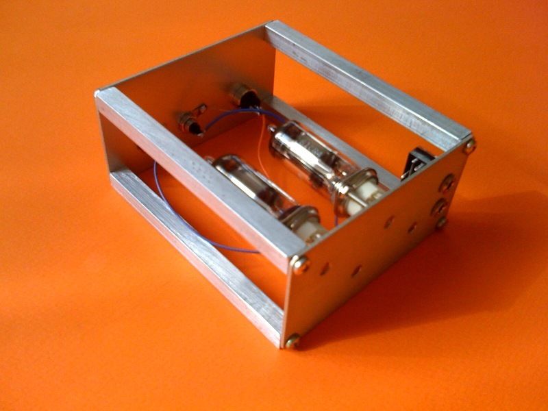

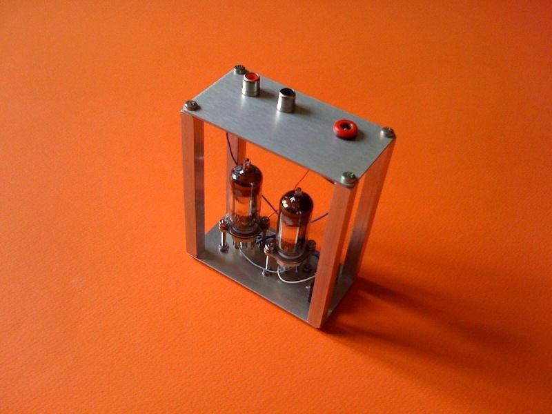

Battery-Tube-Only-Headphones-Amplifier-for-Sennheiser-HD-580-600-650-Beyer-DT880 for a mere USD 70,000.- on eBay.
From the description:
Pleiades Electra, possibly the most transparent amplifier on earth. No other components except 2 tubes for both (stereo) channels. For the schematic Only please visit my other items.
An electron tube on its own has a flat frequency response from 0Hz to many MHz. Surrounding components restrict this and limit the magic of music in other ways too. This is possibly the first amplifier on earth using electron tubes and only.
Since the signal passes through an electron tube and nothing else, the amplifier is possibly the closest there is to a wire with power gain!
Gain being fixed it must be connected to a passive preamplifier or a source that has variable output. Volume control may be added on your request.
Item may not look exactly the same, reserving the right to make revision changes. Handling time approximately 30 days. This amplifier is only suitable for high impedance stereo headphones such as the Sennheiser HD-580, Beyer DT880 or equivalent..
Specifications:
Bandwidth <<0.000001Hz to >>MHz (DC to RF)
12V extremely low noise battery operation
Power consumption < 7W
Input impedance >>MOhm
No resistors, potentiometers
No capacitors
No transformers, inductors
No solid state, diodes, transistors, FETs, ICs
The signal is amplified by only 2 electron tubes in class A.
Only suitable for headphones with impedance >150, <600 Ohms
Caution: Headphones can damage hearing at high levels. Please make shure you attenuate your source signal adequately before sending to this headphone amplifier.
