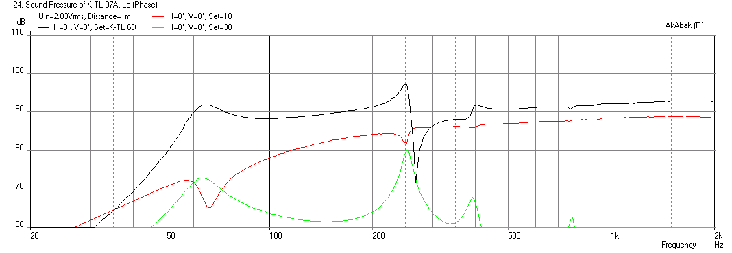

Thanks for bringing up efficiency. I may have sim'd a single vs dual driver. Dual should be circa 92 dB at 2.83v.

Here is the sim with dual drivers - the box should be 0.53x or 15 in tall and 5 in wide. Efficiency is up as expected and bass extension is better now with bigger cabinet.

You got it right, There is little or no body to the 20 and 30 samples. I just wanted to show the cone activity at the bottom freqs. 25 drivers would probably have some heft.
