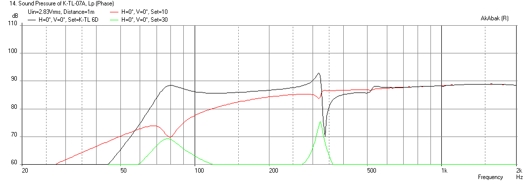

40 Hz from a 3.5" driver? Crazy! I recently bought a 3" Fountek driver (fe85 Fountek FE85 3" Full Range Driver | 296-717) to play around with, but so far no real joy. I have a plan to try a folded FC TQWT with it. Do you think there's a Karlsonator out there for this driver? Similar parameters (including Fs of 125Hz for this and the Vifa) except Xmax is a bit lower. That's all according to manufacturer's specs... Hmmmm.
Carlp,
I will run a sim for you to see optimal size scaling for a Karlsonator with the Fountek. Looks like a neat driver but with a lower Qts my guess is that the box will be smaller and fb will be a bit higher. Get some of those Vifa's if you get a chance as they are at a great price and nice to have around. I have used them in about 7 different alignments and many with success.

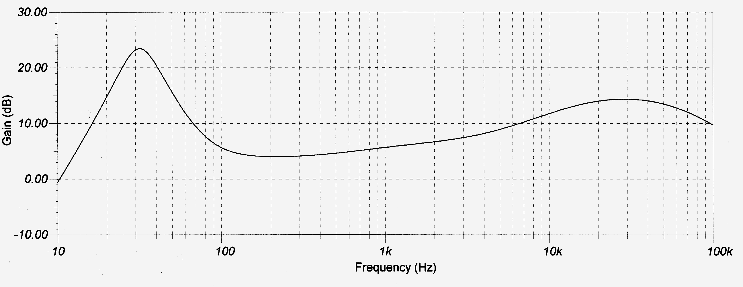

Yes, the Vifa makes a superb 25 driver line array with appropriate EQ'ing. There is a thread called Cloning IDS-25. I have worked on the active EQ circuit design with Bob Richards on that thread (http://www.diyaudio.com/forums/full-range/203356-cloning-ids-25s-22.html) The driver when driven as a parallel/series 25 array acts as if it has the displacement of a 15 inch woofer but with the speed of a 3.5 in driver. In a sealed enclosure with enough power and equalization, it has a flat response from 30 Hz to 18 kHz with perfect impulse response. This would be the ultimate speaker for me to build if I ever got around to having a work shop. Sadly, I don't think FC will work for such as large enclosure. Wesayso is building his variant of this speaker in the "Two Towers" thread. Here is my sim of a 25-Vifa array without EQ. You can see that there is plenty of xmax that can be boosted with EQ to produce a flat profile down to 30 Hz.
http://www.diyaudio.com/forums/full-range/203356-cloning-ids-25s-20.html#post3631354
Here is the EQ profile needed:
Given that Vifa's are $10 ea, now may be the time for buying qnty 50 for this project in the future before they sell out.
Carlp,
The FE85 can work in a 12 in tall Karlsonator that is 5 in wide. So scale the plans by 0.4x but when you cut the pieces make them 5 in wide (internally). Use a dual driver setup - you will find that the front panel where the drivers are mounted is too short to fit 2 drivers - extend it an inch or so as needed to fit the drivers - it won't affect the design too much - part of the liberties one takes in modifying a design way off plan. You may need a high pass filter above 40 Hz to limit excursion if you have content below that. It should work though.
