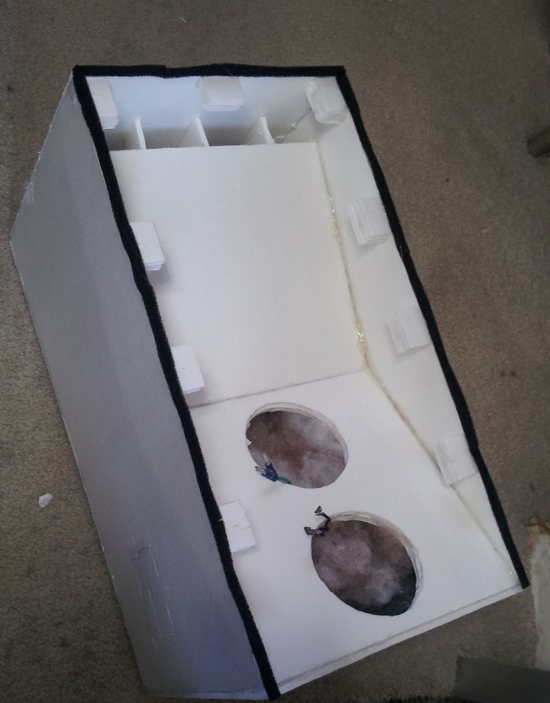

If /when I do another FC project I am going to throw out all that stuff about a quick build. The accuracy of the cuts is very easy to mess up and it can't be checked till the gluing starts. Errors seem to be in the 1/16' to 1/8" area and can result from simply a variance in the blade angle. Easily fixed but "I ain't doin' no more quick builds." 😀

How are you cutting the foam core? My accuracy is about +/- 1mm using a long piece of masonite panel as a straight edge and an X-acto. I use a pencil to mark of the cut points at each end of the foam using a ruler to set the width (6.0 in or 8.0 inches or whatever the general main panel widths are). The use the Xacto pressed against the straight edge and with light pressure the first time - score through the paper. Use subsequent cuts with more pressure to go through the foam while keeping the blade vertical. It takes generally 3 to 4 strokes but I get very neat edges that are consistent. The key to keeping a uniform width is to cut the sections from the same long strip. When making the next strip, make sure it is the same width. I actually use a strip of foam core as a ruler I can write on. The measurements don't have to be exact, but they are reproducable which is important. I know it seems long but how much time would you have spent to make this out of wood? 🙂 I average 3 to 4 hours on a new build. Once I am smarter then next one takes 2 to 3 hrs of the same speaker. You are doing two at a time so double that for what you are doing.
While I've had the same problems with cutting FC it still has been quite a bit faster for me (panels can flex a little to fudge bad cuts if they aren't too bad - but that's in part b/c I see it mostly as a testing approach. But even more important is that if you fleck up a cut, it isn't very expensive to just cut a new piece. Old scrogged pieces can often be used for other projects or for bracing.
If ya'll remember, way back at the beginning I built a little Styrofoam rig and fence to hold the blade at 90 degrees. It works great but I didn't use it this time. That's what I was referring to when I said no more quick builds. It doesn't take that much more time to be more exact in the cutting phase and surely pays off later.

Speaking of the hard way. After all that conversation, I didn't put the open foam in, but caught it before the first side panel had set. Might be morning before the music flows. 🙁

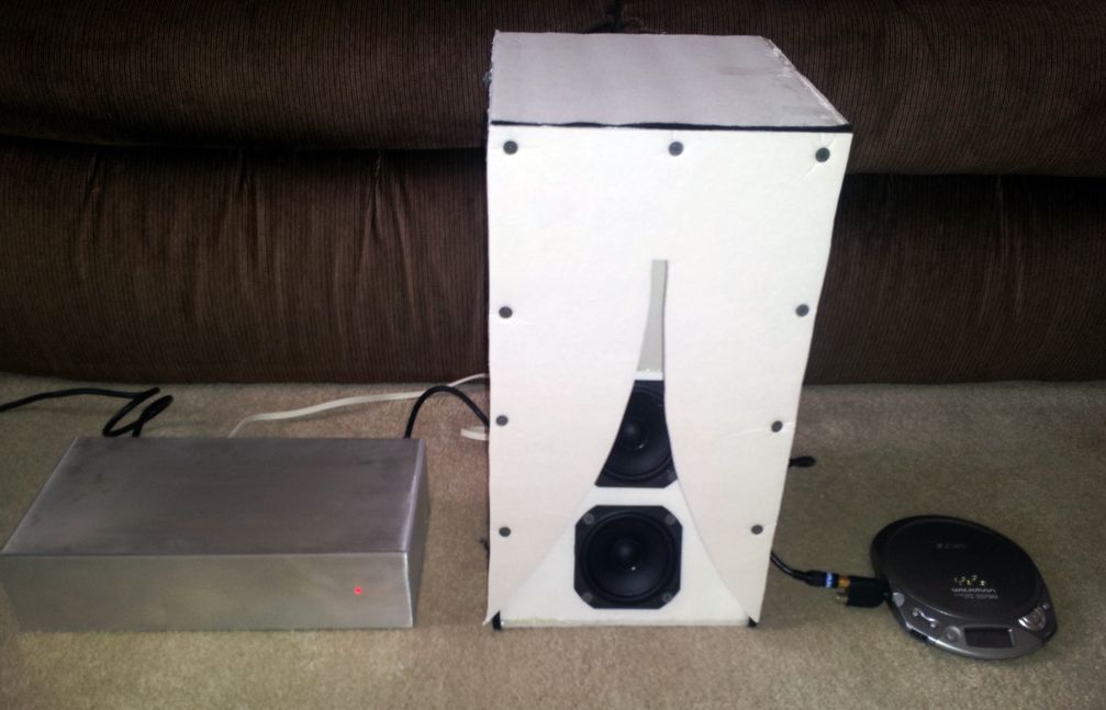

It lives. Got one working and the other about an hour or so away. Very nice. Everything is there short the outside extremes. Hard to tell with just one, but a small sub could help the very very bottom in a big room with big music, but isn't necessary for 95% of what one would play. Placement will be important as tipping the speaker backwards from an arms distance creates a wide variety of high/low mix. Getting the second channel up and both speakers on stands near the room corners is going to be quite impressive. No doubt the single Vifa version would be an excellent build for a desktop system. The mid dynamics are clean with the top end of the kick drum punching through with authority. I do think the Vifas - particularly the upper registers - sound better in this design than in the other two FCs I built.

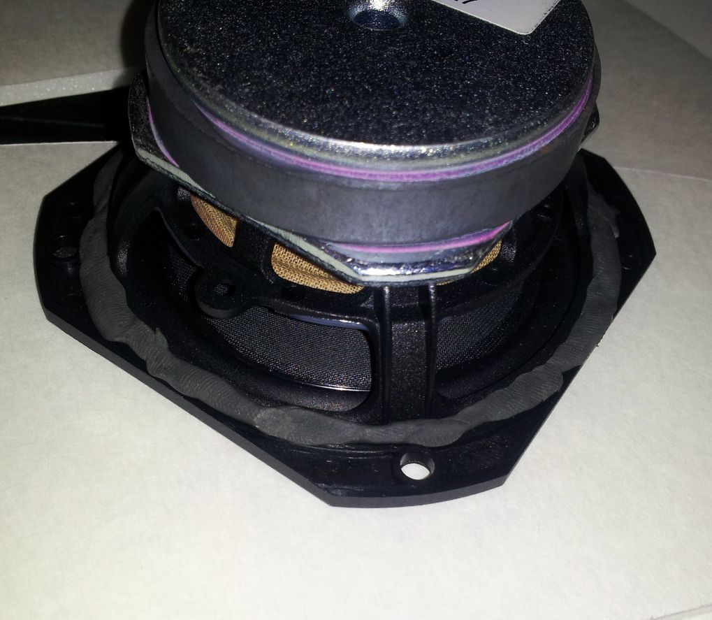

I found some thin foam rubber and cut strips for the wing seals. Since I have it I applied a small bead of electricians putty (not plumber's) on the driver basket.
Just a few minutes listening but the results are well worth the effort. I'll either build another set or go for one somewhat larger - paying better attention to detail at the cutting phase. Very impressed Mr. X

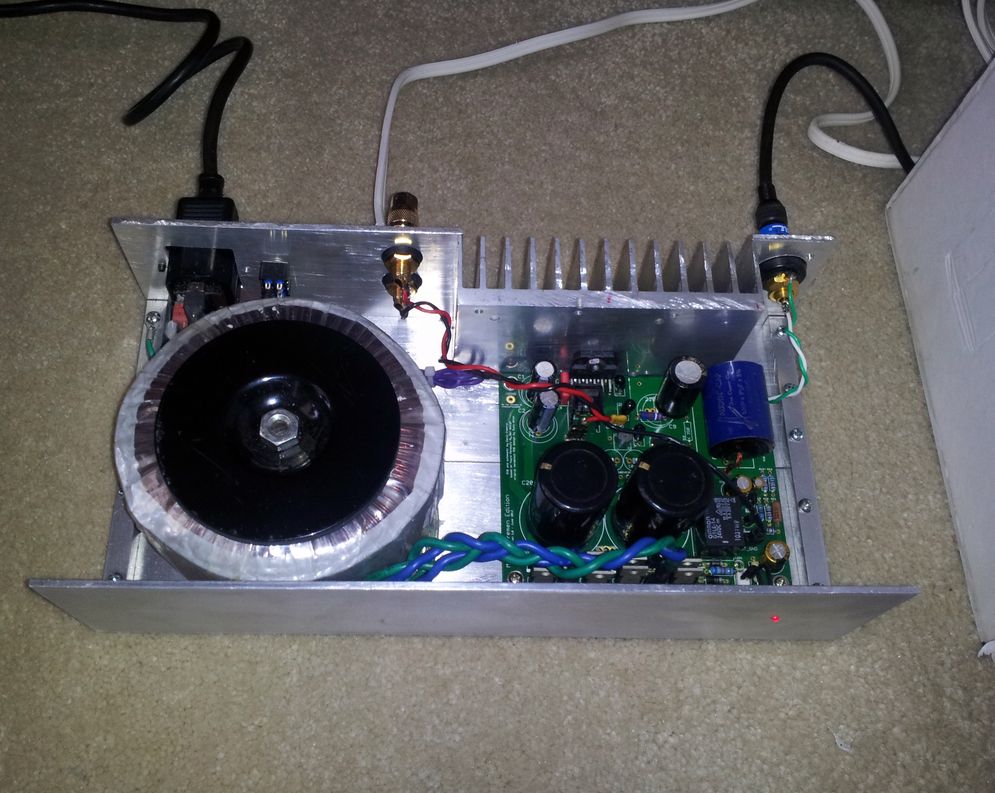

P.S. The amp is a new monoblock version of the MyRef Fremen Edition. Cant wait to get the other side running.

OOPS, I spoke too soon. I used one old speaker that hadn't been powered for months. and one new pieces for balance. After ~ 45 minutes the surrounds are relaxing and the bass is taking over the house. 😀 😀 😀
Well, maybe not exactly, but it is really filling in and getting deeper.

I am glad you like the sound - it is a very nice speaker and one I use all the time to listen to many different types of music. I never considered that the Vifa's have to break in - but glad that you noticed it.
Thanks for giving this design a try. 😀
