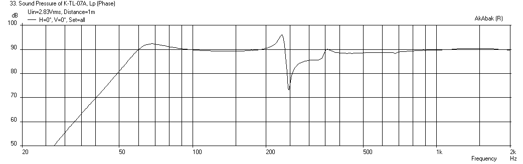

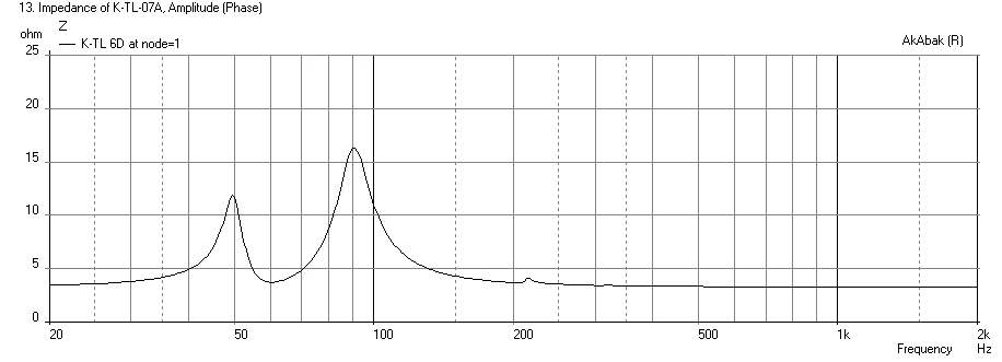

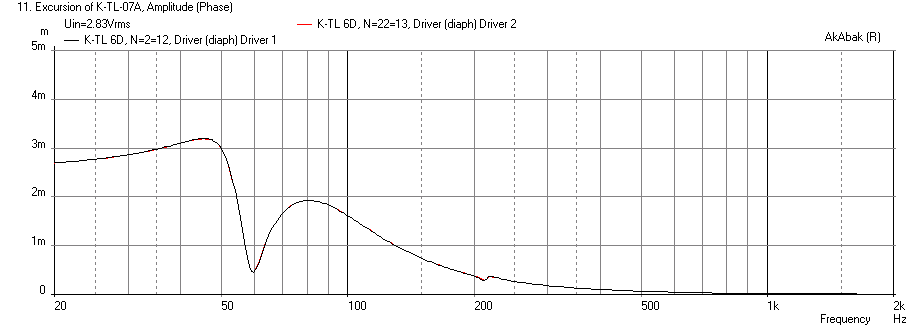

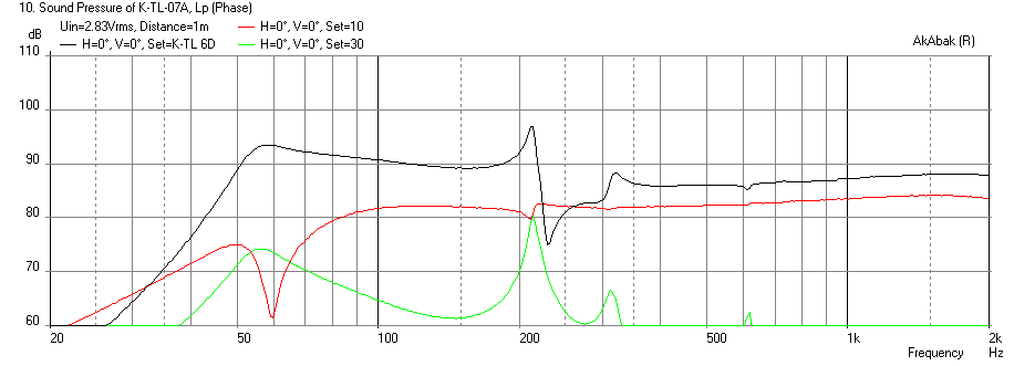

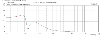

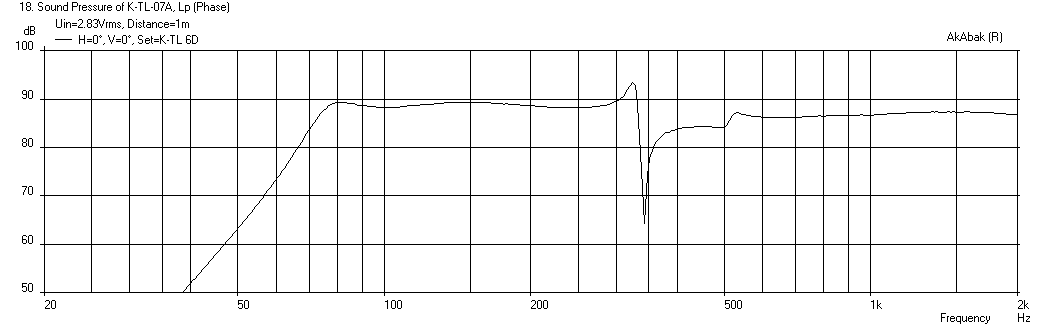

Mini Karlsonator with Dual HiVi B3N's
This design is for Grandcalmar who was looking for a way to make his qnty 4 HiVi B3N's not sound so underwhelming.
Scale the Karlsonator plans by 0.67x in the length and depth, and by 0.4x in width. This will be a box that is about 20 in tall x 6 in wide x ~10 in deep. Mount the two drivers in parallel for a 4 ohm load. It should make a pretty nice 87 dB efficient speaker (2.83v at 1 meter) with built in BSC (bass is 93 dB+).
Plots: SPL vs Freq, Cone Excursion, Impedance.
Be careful with playing music with too much low freq content at loud volumes - the xmax will come up quickly below 55 Hz.

Clarification question: for the width, I'm assuming the scaling does not apply to the resonator initial gap i.e. it remains at 1/4 inch. Please confirm.
The initial gap is in the depth direction and that is scaled same as length, much bigger than 0.25 in. Not sure what you mean.
I'm referring to the dimension called out as "1/4" INITIAL GAP" in the top right of this plan:
Oh, the Karlson aperture. The initial gap controls how deep the bass goes. I would just leave it solid ( no gap) for top 3 or 4 inches then start with 3/16 gap and go from there.
Gotcha - thanks.

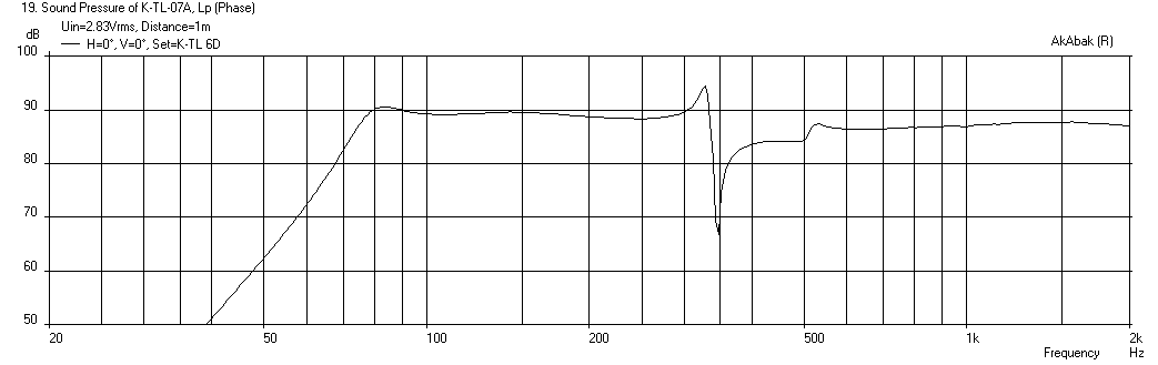

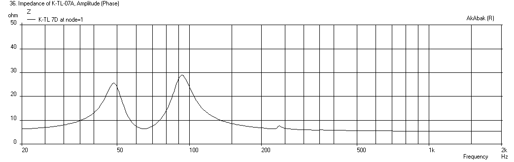

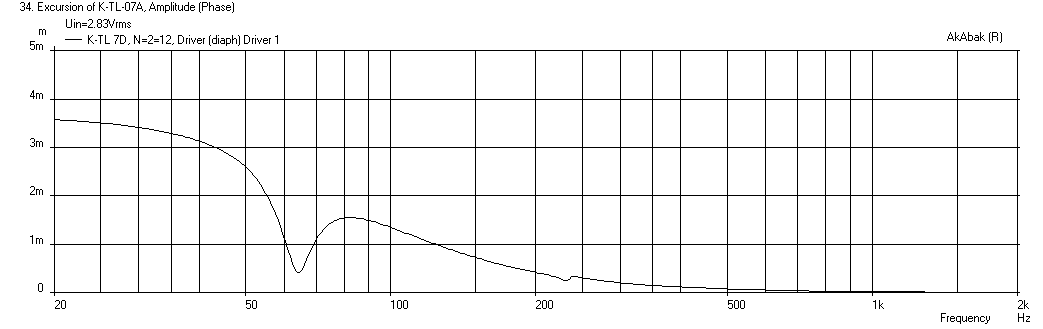

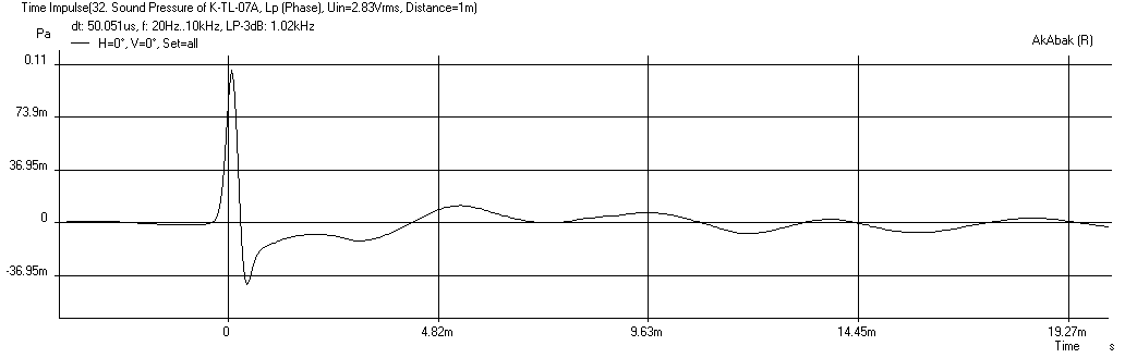

Karlsonator with Alpair 7.3
I received a request to see how an A7.3 will work in a Karlsonator. I arrived at 0.6x scale for height and depth and 0.4x for the width with a single A7.3.
Seems like it can work well with good bass gain in the 90dB range down to 55 Hz or so.
Plots: SPL vs Freq, Impedance, Cone Displacement, Impulse Response

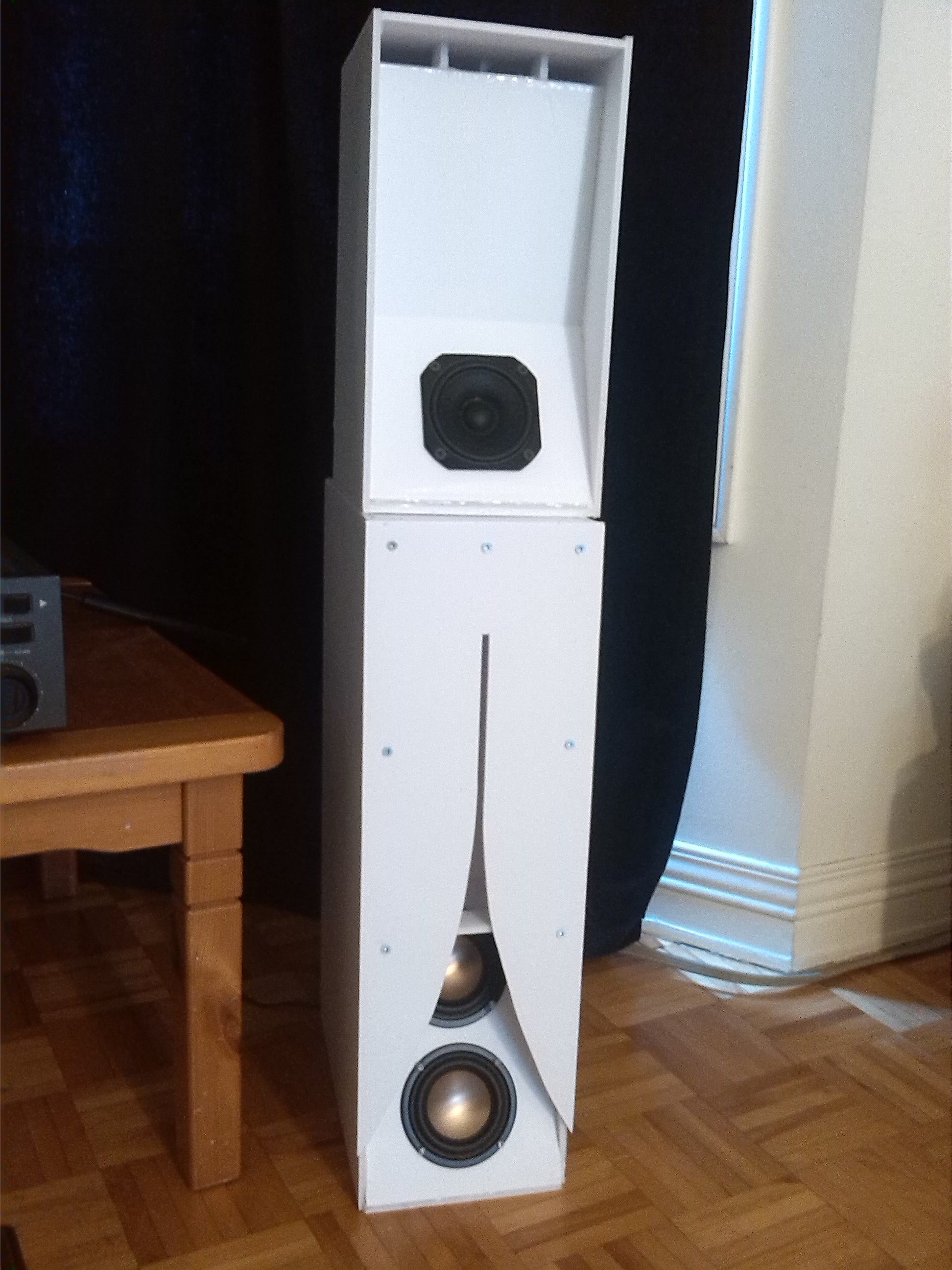

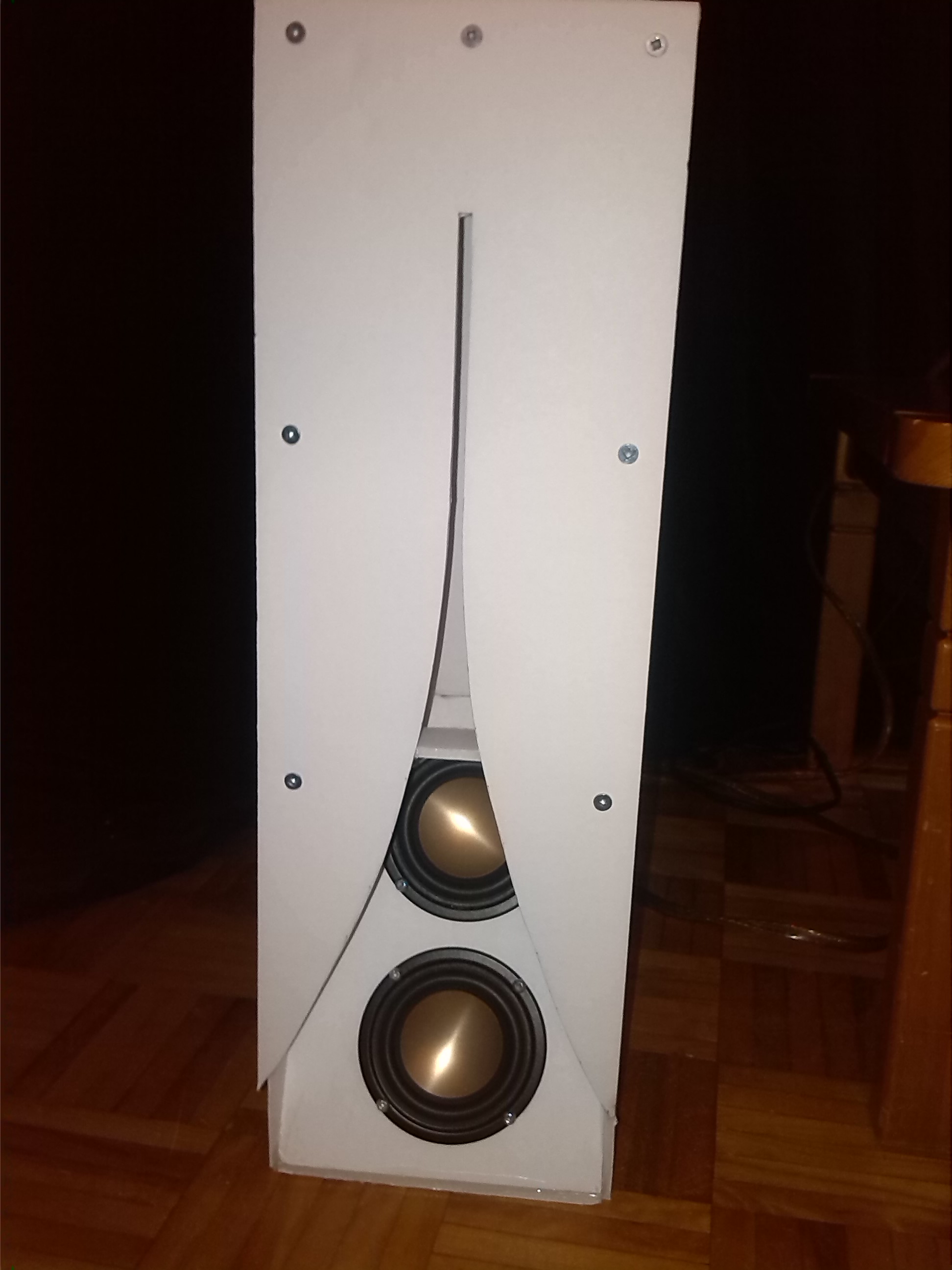

Mini Karlsonator with dual B3N's
X,
I finished the dual B3N mini-Karlsonator as per your recommendation of 0.67X length and depth and 0.4X width. A fun build and made fairly straight-forward by your excellent instructions and build photos - thanks!
I'm very very happy with the sound. Doubling up the drivers really helped with the sound level. I'm still playing around with speaker location, but my first impression is that there is going to be more than adequate bass - so no need for a sub for the type of listening I do. The only down-side is that they show up my input source - time to put the phone aside and drag out the CD player!
I liked them so much, I decided to build the 0.4X single TC9FDs as well. Ran out of foam😡 so haven't put on the front yet.
Definitely a winner - the wife has asked my repeatedly to make her a set for her office.
