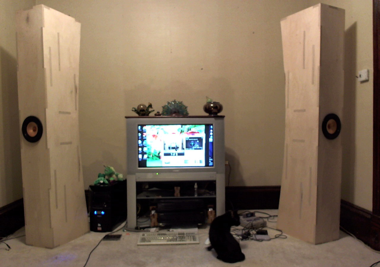

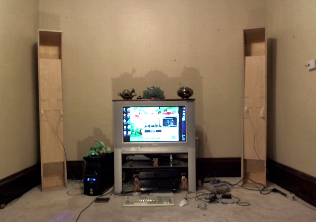

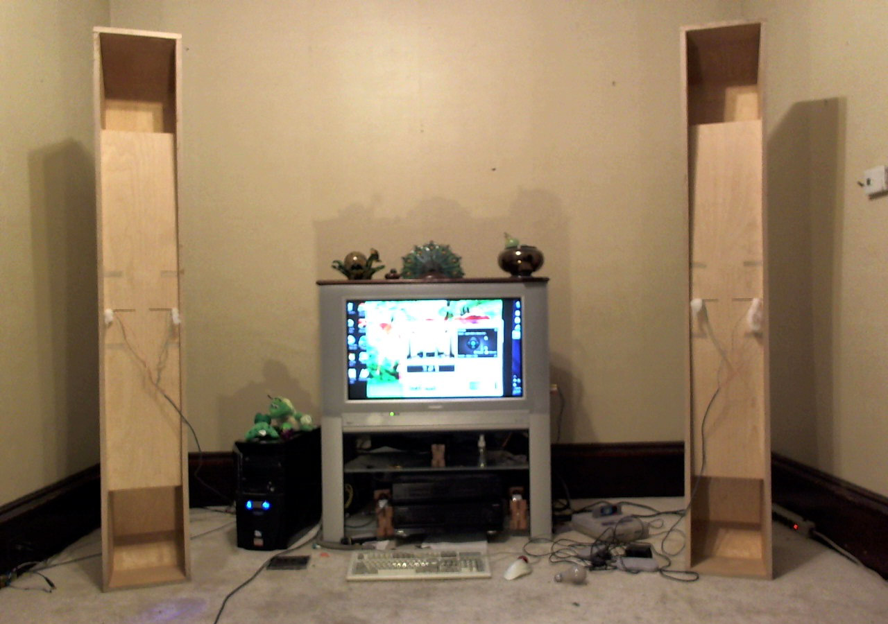

Okay, got some test tones out and started playing with some new positions:
As I am prefering the imaging and soundstage of wider cabinet separtion (about 6 feet), I was curious to see if pointing the horns away from a corners and into the middle would yeild better bass on the listening couch. See photo #1. I am surprised to report that this made no diference at all!
Ao just for the fun of it, I decided to try the horns facing forward, like a Chang or Mikasa. See Photo #2. At 200 Hz, this appeared to work. I thought, oh no, I did build the wrong cabinet! But at 100 Hz, this front horn acted worse then Avebury at 100 Hz. I was disappointed and relieved at the same time!
For fun I tried this front horn pushed right in the corners! Photo #3. That was the worst of them all! So dispite the directional nature of front horns, it does not solve the bass problem on the listening couch. What this tells me is even if I go with a subwoofer system instead, I will have the same bass issues in these positions. This is not an Avebury acoustical problem, but possibly a couch area acoustical problem. We are narrowing things down atleast. So time to try some room treatments in the back of the room.
Have you tried toed in such that the axis cross in front of you. This might also allow you to try pulling them out so that the rear is clear of the cavity (a couple big windows in the side walls of the cavity (or a whole bunch of little ones) might do something similar basswize). I have something similar designed into my room.

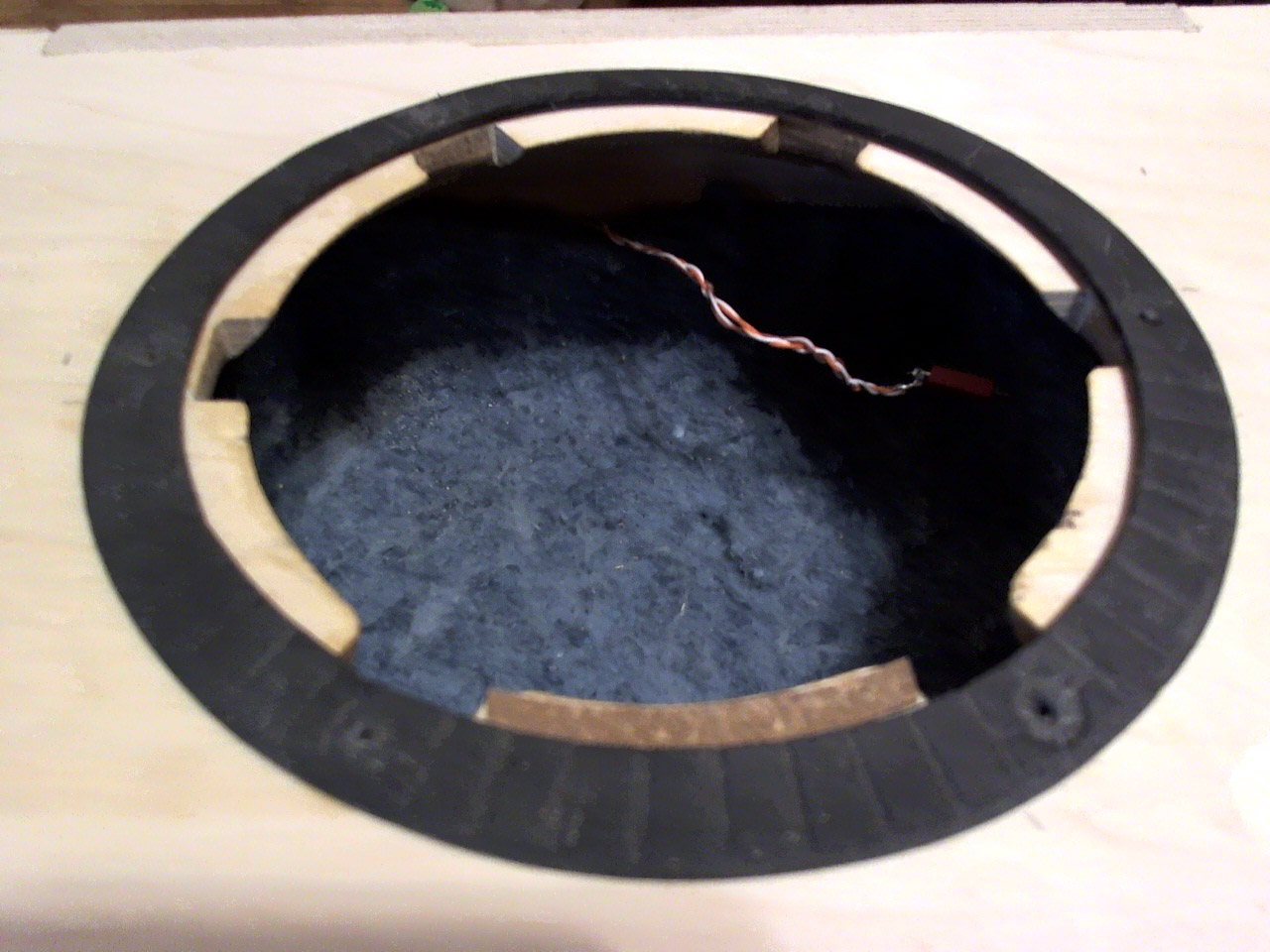

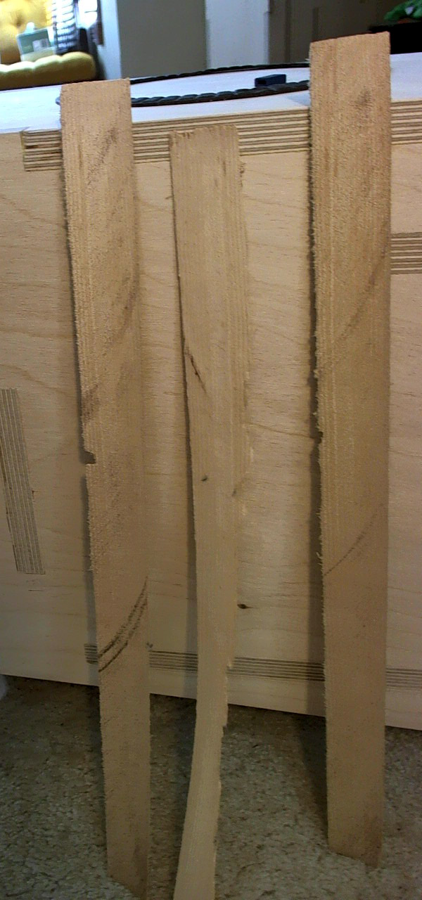

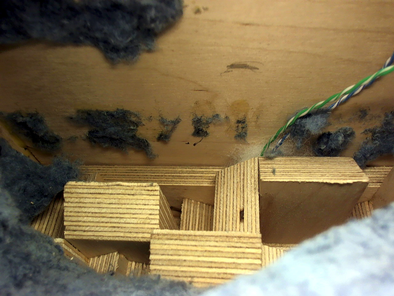

A run around, Dave, I need your help!
During all these test tone type of tests, I noticed at 100 Hz, just before clipping, the right Avebury would make a nasty vibrating sound! A physical, something is loose kind of sound. I checked the screws, they where tight. I switched channels, Amp and wires, still same cabinet. I took the speaker out, looked it over, no cracks, no sawdust, wood chips or glue. The sound come more from the right side of the driver, so a tried putting a cork pad, thinking maybe it was the wood protruding in on the driver cutout. See photo #1...
Nope is was not that!
Next I cut all the driver cutout frame notches, thinking maybe the frame was rubbing agaist them, being such a good fit.
Nope not that either! What could it be? It sounds like it is coming form the speaker itself, but when it is unmounted, it does not did it!
Next I removed the denim stuffing behind the driver, and sure enough I found a 1/32" gap between the side wall and diffusion blocks. See photo 2. So I cut some fillers. Photo #3. After about 1 solid hour of cusing, I got what I could in. One side was 1/32, tapering down to nothing on the other side. And the pieces that went in only went down an inch at most. Wow, could this really cause this? I put the denim back in, and left the cabinet to dry.
Off to church I want, I needed it after all of that! Then night job...
I got home, put the speaker in, and sure enough, it still did it! :headbash:
Aaaaagggghhhh!
I set the cabinet on the ground, and it stopped! huh, I turned the cabinet top to bottom, it come back! I put the cabinet on its side, still there, but it disappears when Alpair is laying flat. I took it out, and that is when I heard a tiny plastic click... Oh no! It did not crack! Thankfully not. But that is when I noticed that this driver has a bezel cover, apparently, it has come partically loose.
So, Dave, how do I take the rest of it off without braking it? What kind of tool would you use to do that? What kind of glue do you use to reglue it? how do you clamp it? Am I even qualified to do this? Plastics are not my thing, but I will give it a go if it is not too plasticy breakable!
Believe me, it was far easier for me to believe that it was my very mindfully built cabinet, then a flaw with Alpair 12! It was quite a mind trip downer, that is for sure. I am relieved it was not the cabinet I built.
The one cool thing I got out of all of this was feeling the significant breeze at the horn mouths playing these low test tones. I have a few air leaks to fill around some of the tenions that where on the loose side.
That is something I can do, I have the pieces cut already!
Your prayers at this point will be greatly appreciated!
It is likely it was always like that. And difficult to detect.
I discard the bezel covers when i can, but all the 12s i got came with them attached.
It is very unlikely that the bezel can be removed without destroying the driver.
I'm going to take a stab, but i'm also going to ping Mark for his advice, so hang tite till he chimes in.
Ideally you figure out how to inject some 2 part epoxy in between the frame and the bezel where it is loose. Then simply pressing the 2 parts together and letting cure should do the job.
If that won't work ... maybe some super glue?

Toe in impresions
Yes, I have. It sounds more jumbled up on the listening couch, but one thing I liked about this set-up is that it did make the whole couch the sweet spot. Infact I liked the sound better in the off axis positions better then the middle with this set-up.
I could do that on the right wall, but the left wall and back wall are outside walls. If I had the $$$$, I would put footings in and build this room and the room next to it out thru the back wall and extend the bay window area thru the side wall. Half of this addition would be a passive solar green house.

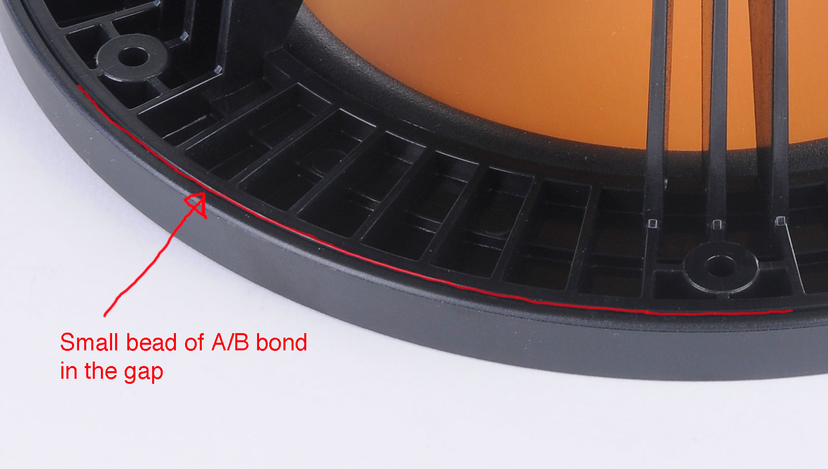

Hi Allen,
Dave has pointed me to your posts. From what I've read so far, there's an easy fix.
Assuming most of the cover is still firm, run a small beed of glue into the frame - cover gap. You won't need much glue.
Mix a small amount of glue on some paper. Dip the tip of a cocktail stick or similar into the mix then push the glue inside the frame- cover gap. Gradually work you way around the driver, mix fresh glue as you go, immediately wiping any excess off . You could gently partly insert a small pin (or similar) to open the gap slightly between frame and cover. Don't force the pin far in, just enough to aid the process.
Make the beed a minimum of 2 screws holes (see pic).
Here's the recommend thread for glues: http://www.diyaudio.com/forums/markaudio/197071-glueing-alpair-front-trim-rings.html
Make sure the front baffle is flat, no bumps in the wood. Use a straight edge steel ruler and eye-ball the mounting area around the baffle. Don't over-tighten the mounting screws. A gentle nip-up is all that's required
If you need more advice and want me to further check the remedy with you before gluing, feel free to email me: support@markaudio.com
Cheers
Mark.
