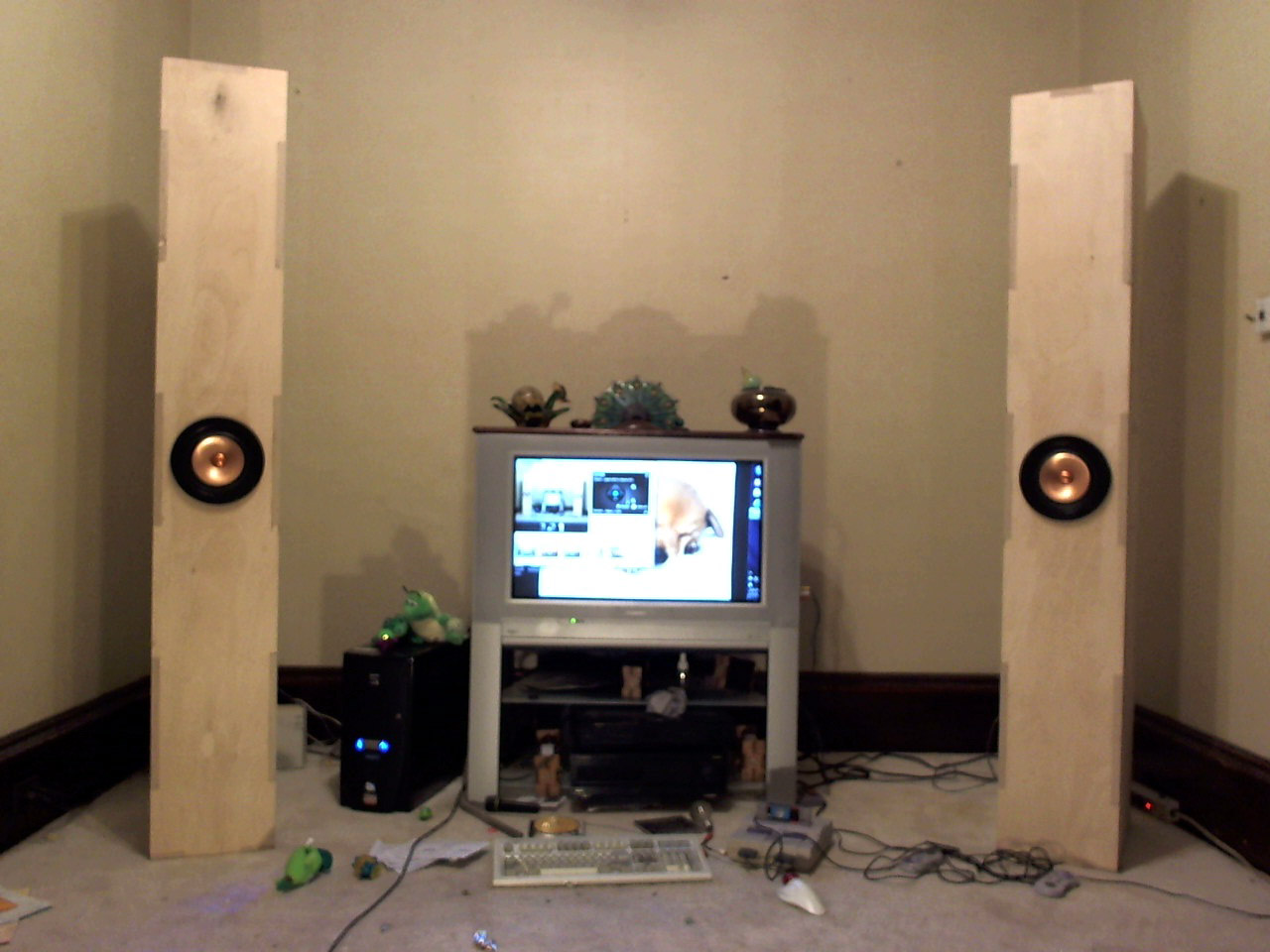

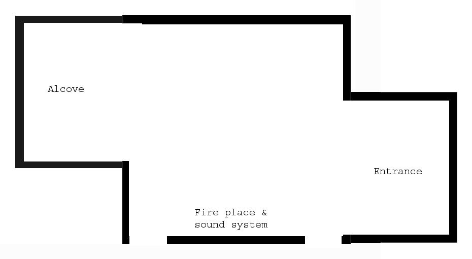

Does your living room look like this?

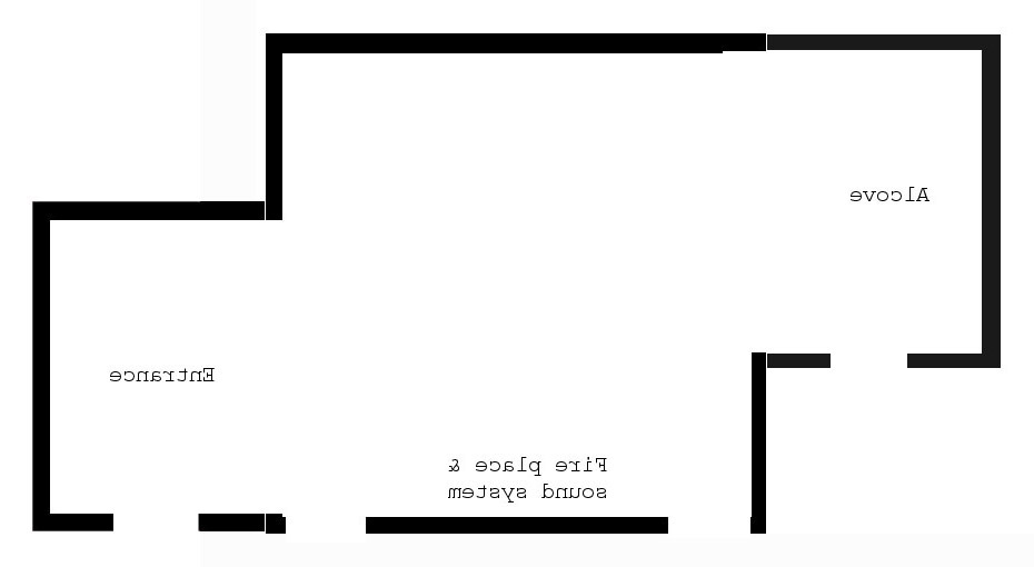

The drawing is pretty close, just flip the whole thing left to right. Both the entrance and the alcove open to rooms back of the line for the fireplace, but that detail really only effects me an my family. The audio/video stuff is against the back of the fireplace, which opens up to the dining room on the other side.
