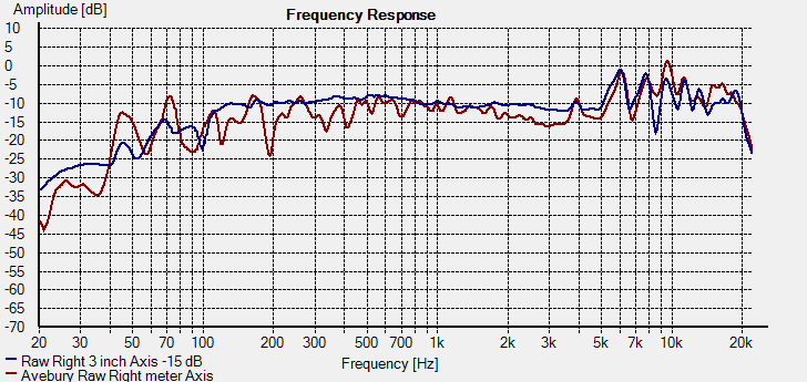

Anyway, here are the measurements.
First graph shows the comparison between a 3 inch and 3 feet distance from the driver. As You can see, a lot of "damage" already done. I would like to do a one foot measurement later to see how much of this is the cabinet baffle.

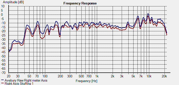

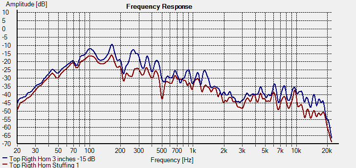

The second graph shows the output of the top horn (wanted less floor and room interaction), taken 3 inches from the back panel. The stuffing did indeed lower some of the mid-bass. It appears to have lowered the overall output also, but I do not know for sure, as the mic and cabinet might not have been in the exact positions as they where before I took the Alpairs out.
The third graph show the 3 feet axis comparisons with and without stuffing - not too different really. Again, not sure if the output drop was the set-up transition or not, but I am having a feeling it is the stuffing causing this...

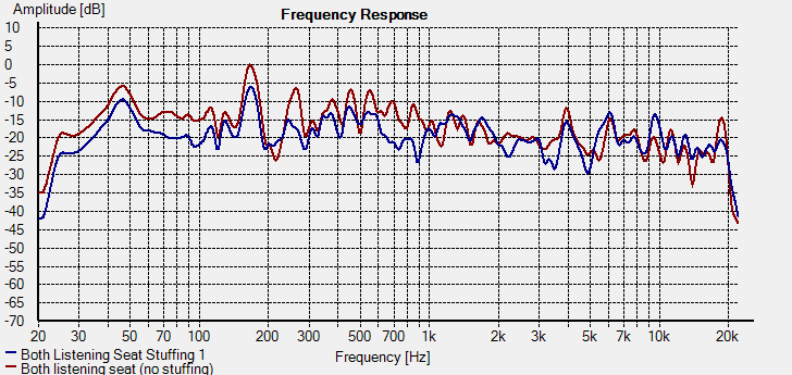

The last graph shows how the speakers interact with each other. I forgot to take a listening seat measurement before stuffing the throats. Either way, You can see the 180 peak that is bothering me. The 45 Hz peak does not concern me, as I tame that with the high pass in JRiver.
But now the real question, should I be stuffing these horns at all?
It did make a difference. I do hear less room, but I am thinking I lost a little of that Alpair 12 magic too. You know how these things go.
I am thinking I need to take the stuffing out and put some absorption panels behind the horns. That would tame the mid-bass, but not the low bass, which is fine, because we want the low bass. :D
Thoughts anyone?

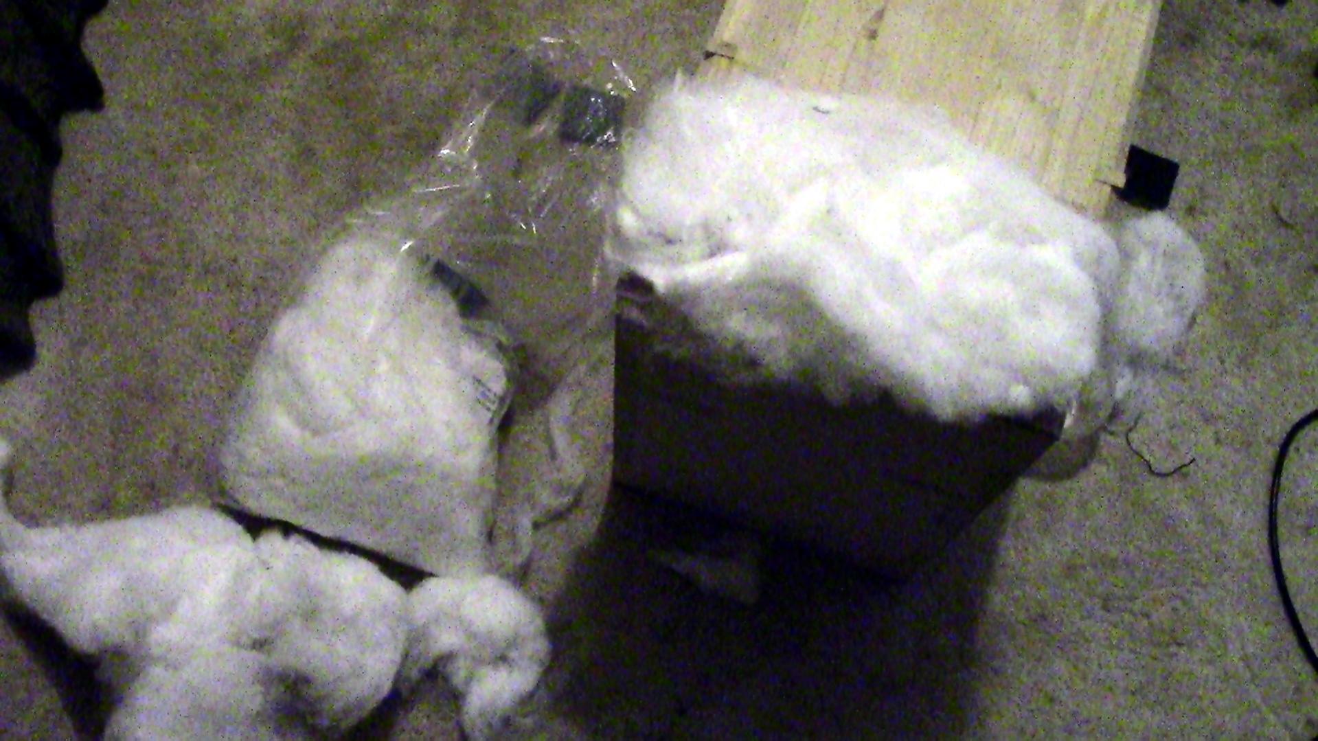

Stuffing Photo
Here is the photo of the stuffing I added to the horn throats. I used AcoustiStuff. The piece laying on the speaker shows the size and density I used. There is not much science involved here. The main thing, is I did not want the piece to fall down the horn in case I did not like or was not supposed to do this! If I was to continue this experiment, I would stuff another piece this big down each horn throat.
but I am thinking I should be taking these out and fixing the issues with room absorption.

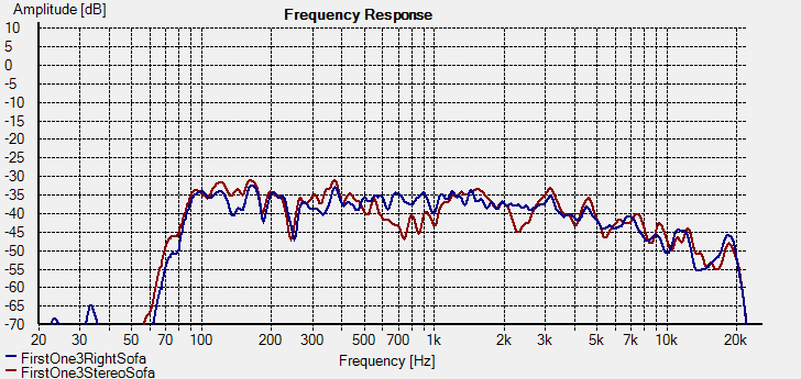

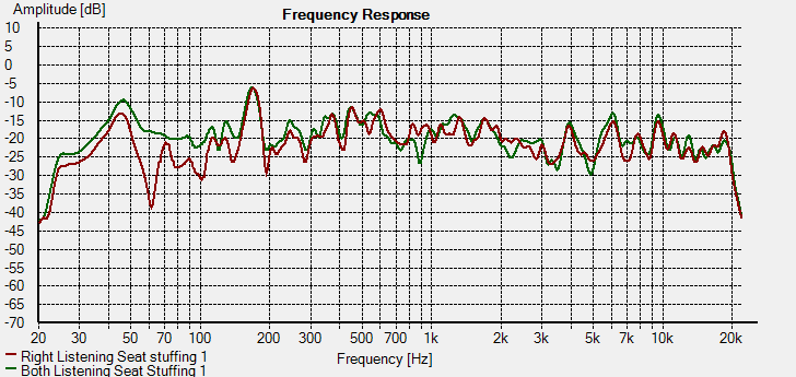

Opps, wrong graph in post 463
The last graph is post 463 shows the my array response at the listening seat. In the case of that system, I have a mid-range loss when both speakers are playing.

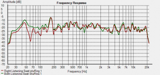

Here is the graph of the Avebury. Now You can see the peaks I was referring. to.

Another look at teh measurements...
Looks to be related to a dimension of ~4’ or a multiple.
You are correct, Dave, all my side walls are about 4" long, and the ceiling is a couple inches over 8 feet... So we are on the right track there.

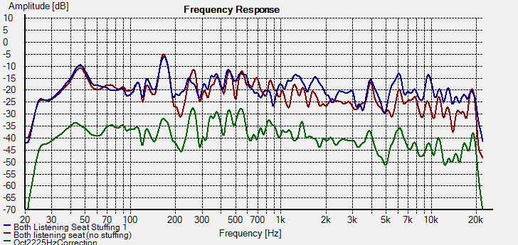

But here is the part that has got me. I took another look at my horn mouth measurements. I did the top horn and I measured it with the horn facing in the room, away from the walls. I took the measurement 3" away from the mouth... Based on this measurement, the 165 Hz peak has already started and my room is just helping it along more (second graph).
I removed the stuffing and re-measured the system at the listening seat (first graph). As can be seen, the stuffing does not appear to help the problem (Blue and Red lines). As these measurements where indeed taken on different days with a different set-up, I am guessing that accounts for the difference in the higher ranges. The third measurement, off-set so you can see it, is the EQed version (Green). -9 dB at 165 Hz with a Q of 6, -5dB at 44 Hz with a Q of 5, and a 48dB/octave Low-pass at 25 Hz. I then correct the Low-pass phase shift with rePhase. It sounds pretty good. I would like to play around with some of the other peaks later on. At the moment, I find the sound a tad "cold", but there are a lot of other issues here also.
I would really like to get rid of the 165 Hz peak at the source, from the horn. The Alpair sounds better without the -9 dB attenuation, but without it, the room gain at 165 Hz is over whelming. Is there a way to address this peak at the source? Is there something I can do with the cabinet itself? More stuffing in the back chamber, for example? On one hand, my room might be too small for this design, but on the other hand, the fact that 25Hz is in the usable range is pretty exciting. I have not tried movies yet with this set-up, so I will get back to You later on that. :D
I am going to be experimenting with room treatments soon. I need to decide if I am getting Owens Corning 703 or Roxul 60. Shipping seems a little high on this stuff, as I am sure as many of You has found out, most hardware stores do not carry this stuff.

Another look...
I was reviewing my post above, and looked at the first graph. The mids and highs are much more rolled off, so I off-set the measurement to make them more even. Did the stuffing attenuate the horn that much? It did not change the frequency response, but it did attenuate, maybe. Might be time to get the making tape out.
Thoughts anyone?
