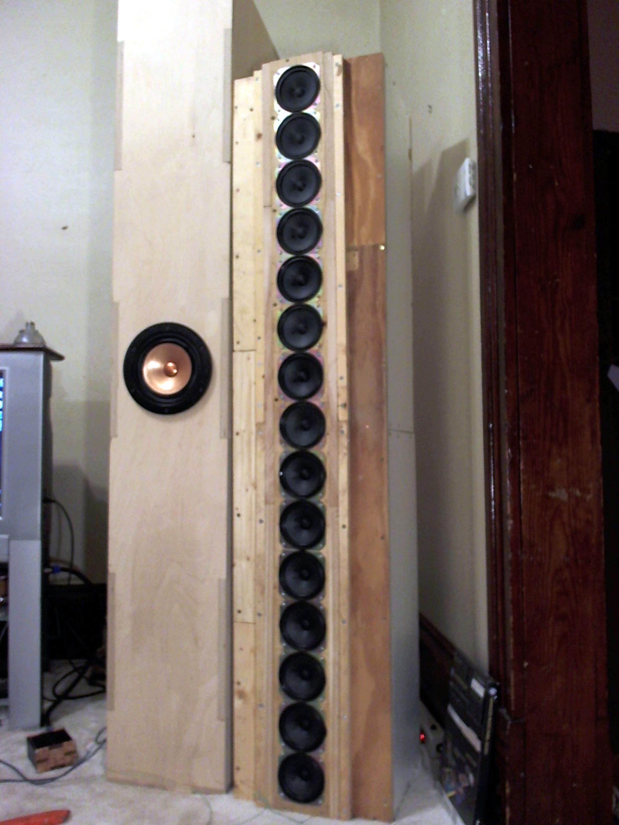

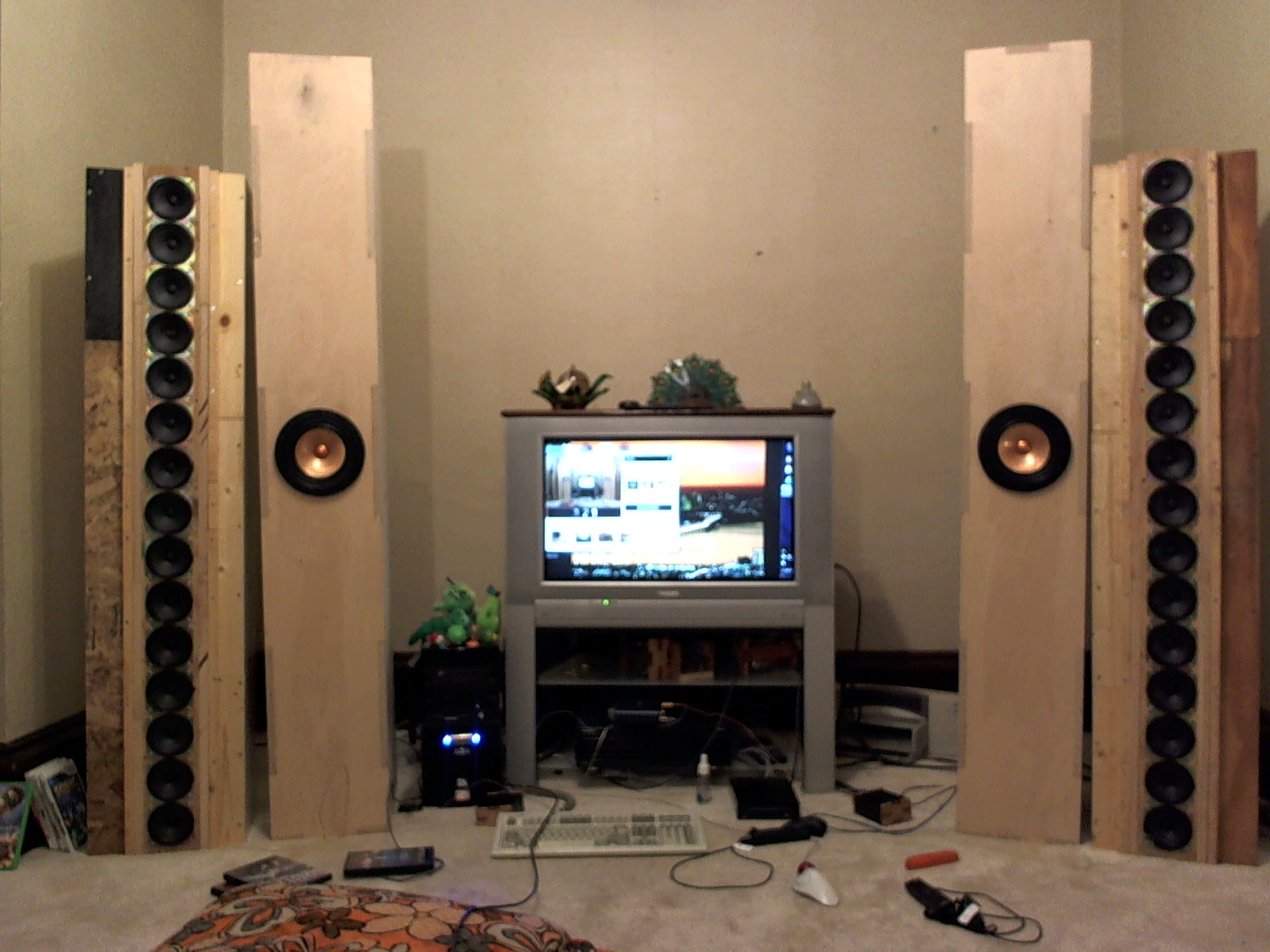

..So getting to the bottom of the pile of stuff, I found a box full of 30 - 4" pioneer NSF drivers. I have been always courious about line arrays, but never got around to building one. And after having some nice drivers, like the Fostex FF-225 and now the Alpair 12, I never really thought it would be worth the time building an array for these cheap pioneer drivers... Then you got comb filtering and EQ to worry about. But I could not let it go, I had to try it, as I did not want to always wonder if I should have tried it. So my version of the "stupid cheap line array" was born:
http://www.diyaudio.com/forums/multi-way/193015-stupid-cheap-line-array-30.html

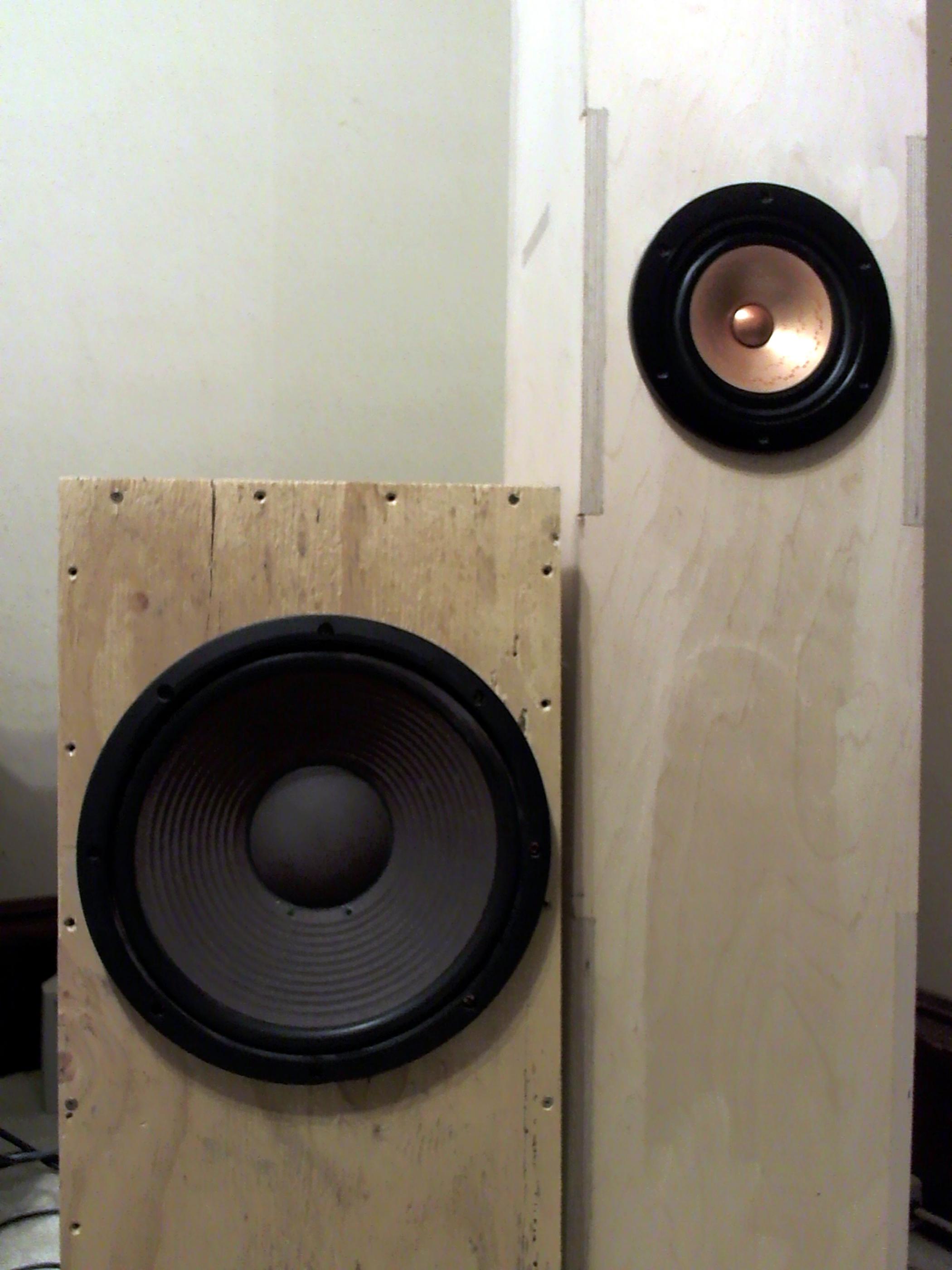

The cabinet is a total hack job compared to the Avebury build: regualer plywood, some particale board, very little chip board, not enough bracing, fibre glass insulation stuffing... This was a send no money, cheap, hill-billy build. Infact, the cabinet, at the moment is not even glued, in case I did not like the cabinet, I could use the wood for other stuff! Avebury was a proven design, I went all out, this array is a proto type. I call it, my Cheap and Cheerful project. 🙂
Avebury -Vs- Cheap and Cheerful
This was and still is a lot of fun! Quite honestly, I was not expecting much from the Array. But even without EQ, I have to say, I really like the sound scape these throw out. With EQ (in Foobar), these sound better then they perhaps deserve to! Not as refined as Avebury, esp in the high. And this array does not even touch the bass capacity of Avebury. It can't even do 40Hz, although, that may have more to do with the leaky cabinet then anything else.
BUT, the array does something that I have always wanted a sound system to do - emcompass me in sound! These have that cool live scale sound like my 777 system did, with the 3D sound feild of Avebury! A win win!
Now that is not to say Avebury sounds small in comparison, becuase it throws out a big sound scape also. The main diference as I perceive it is:
With Avebury, you are enjoying the show closer to the back of the auditorium - a more of "the music is over there" feeling.
With Cheap and Cheerful, you are in the show! - a "music is here" turning my living room into what ever venue the band is playing.
I have not had a chance to enjoy the EQ'ed version of the Array for movies, as Media Player disables the EQ for movie play back BOOO 😕 They tend to be shouty without EQ.
But, given even the negative of comb filtering, which is really no big deal, the array has a huge sweet spot, and sounds even thru out the room. Sure, you can hear the treble "swish" with vertical movements, but Avebury completely changes, every where!
So at this point, I maybe giving Avebury a rest, and persueing a better array. Even Cheap and Cheerful is worthy of a glued cabinet, with more bracing, better stuffing, and cabinet design. I will post those developements on the "stupid cheap line array" thread
Avebury, as far as Bandwidth, Downward Dynamic Range, and driver design is still the bar to beat. Is it possible to have those traits in an array? I am thinking of the smaller Mark Audio drivers, it is a shame they have those big surrounds! Hint Hint...

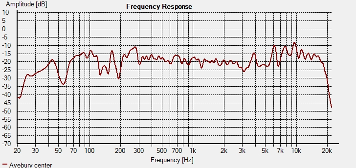

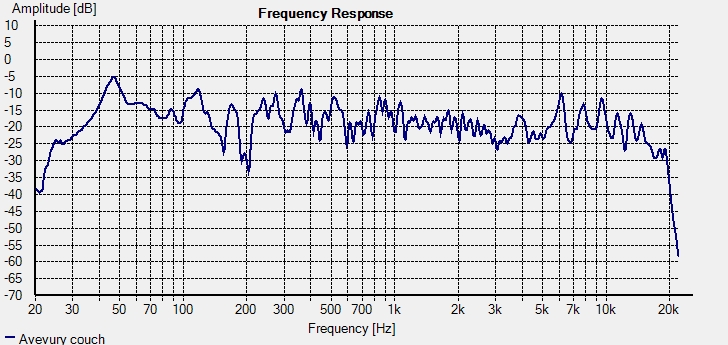

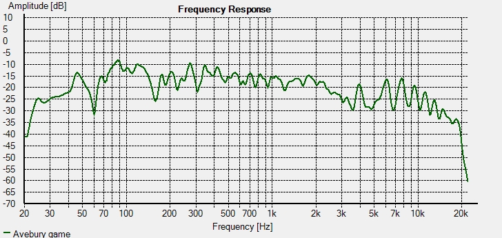

Avebury Measurements

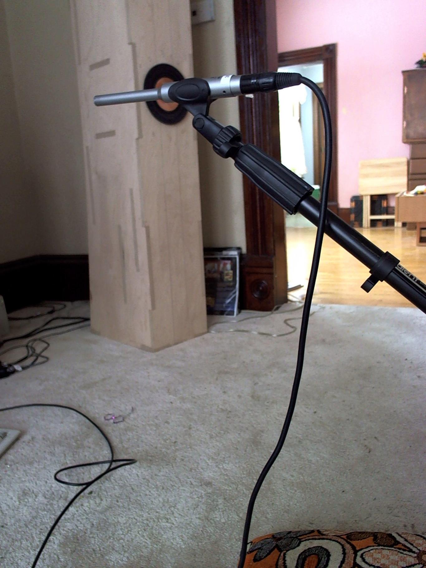

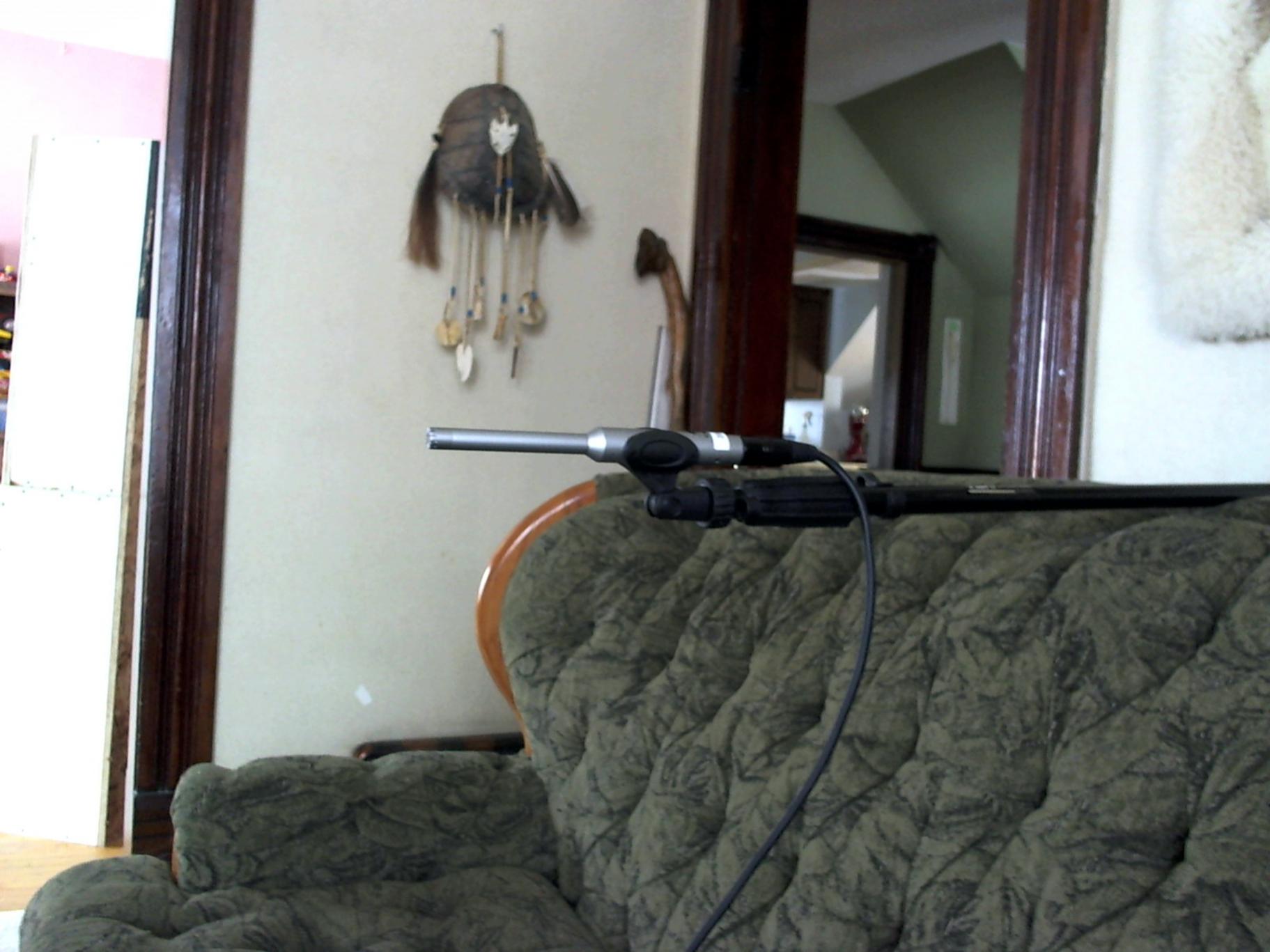

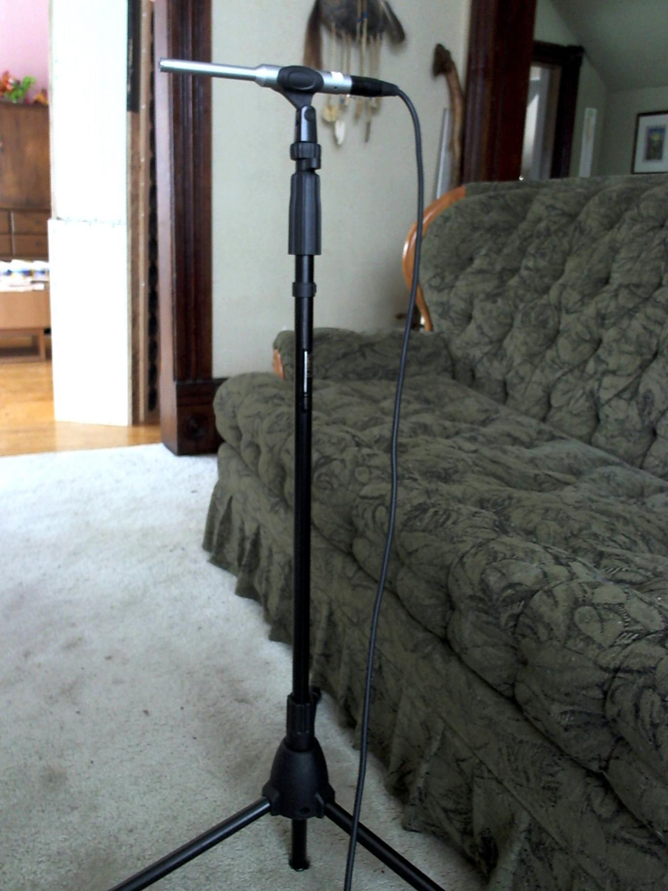

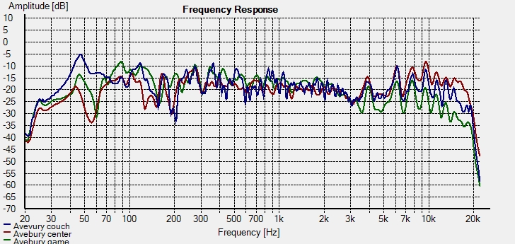

I finally took the plunge, and bought myself a measurement mic and TrueRTA. I have not set-up true RTA yet, as the main reason I got that is to help me with the array project. The measurements here are from Holm Inpulse, which seems like a really good program, esp for the price (freeware). You can callibrate your DAC to get a more acturite reading, which I have not done yet. All in due time.
But for the fun of it, here are my initial measurements of Avebury in my room.
Keep in mind, this is not an acoustic chamber I am taking these in, nor are they at 1 meter. These measurements here are taken at my actual listening positions in my 10 X 14 foot room with 9 foot ceilings. My floor is carpeted. The blue line shows the response when listening on my couch. The red is just in front of the couch and the green is in front of the computer. I smoothed the response at 1/24 octave. If you remember, I liked the midrange infront of the couch, (note the smoothness) but as you can see, the most average even overall response is indeed the couch! I definately have some bass issues to deal with.
All and all, I think Avebury measures well, and achieves what I believe Scott intented, which is a good overall power response. It is safe to say that manufactures smooth their response out alot, however, some of the jaggedness is indeed room interaction too - as seen by the smoother mid-range of the central position (red). But I think our brain does a lot of smoothing also, as when I play test tones myself, it sounds pretty even 🙂

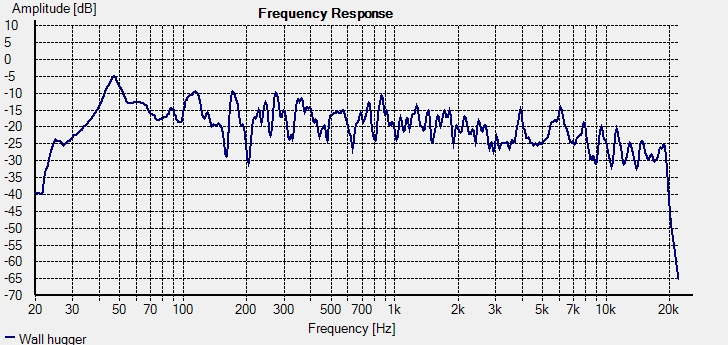

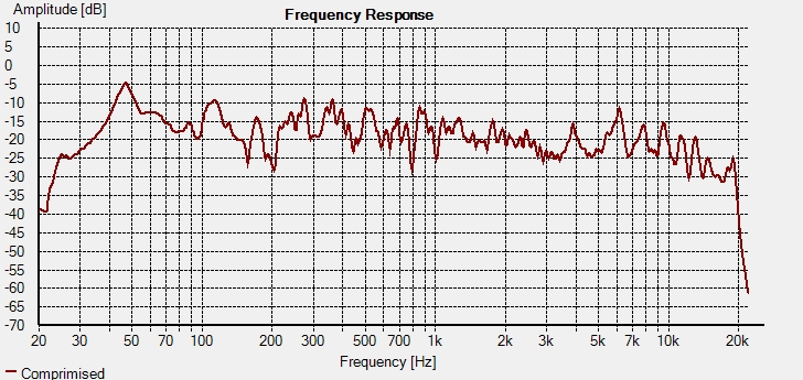

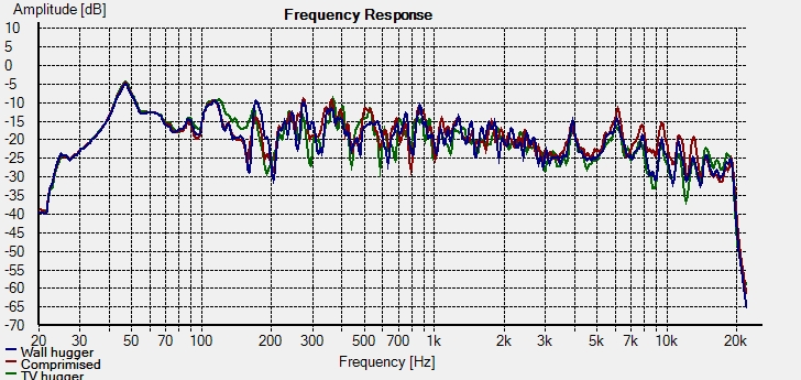

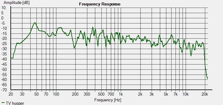

Avebury positions
If you remember, I tried Avebury in diferent positions, so I measured them to see if indeed the difference in sound stage and livelyness can indeed be measured. The blue shows the Avebury right next to the side walls, about 2 1/2 feet from the back wall. In this position, I hear the biggest surrounding soundstage with a slightly weak centre stage. If you remember also, I heard a bass cancellation going on at 200 Hz. The red line shows my "normal" positions, about one foot from the side walls and 2 1/2 feet from the back wall. This gives the best overall soundstage: as in a slight sacrifice of surrounding stage and a better centre stage. Still a cancellation at 200Hz. The green line shows the cabinets about four feet apart, by the TV, two feet from the side walls and two feet from the back wall. There was no soundstage width or 3D at all in this position, I found the sound overall to be dead and lifeless. I did not "hear" the 200 Hz bass cancellation as much here, but none the less it is still there. But I am keeping in mind that these measurements are only reflecting the use of one channel, I should try them again running both channels in mono - see how the two channels interact with each other, esp the bass. This might be a better job for RealRTA. The surprising thing, is the bass below 100 Hz was the same no matter where Avebury was placed. This is more listening position influeneced. But the good news about that, if one was to go with a FAST system, they could place the main system where it soundstages the best and put the sub-woofer where it works the best.
Really, there is not that much difference between the measurements, but the difference I hear in sound stage is huge, so sound stage is very position dependent. It seems my normal position has more high, which may give me an overall sense of liveliness.

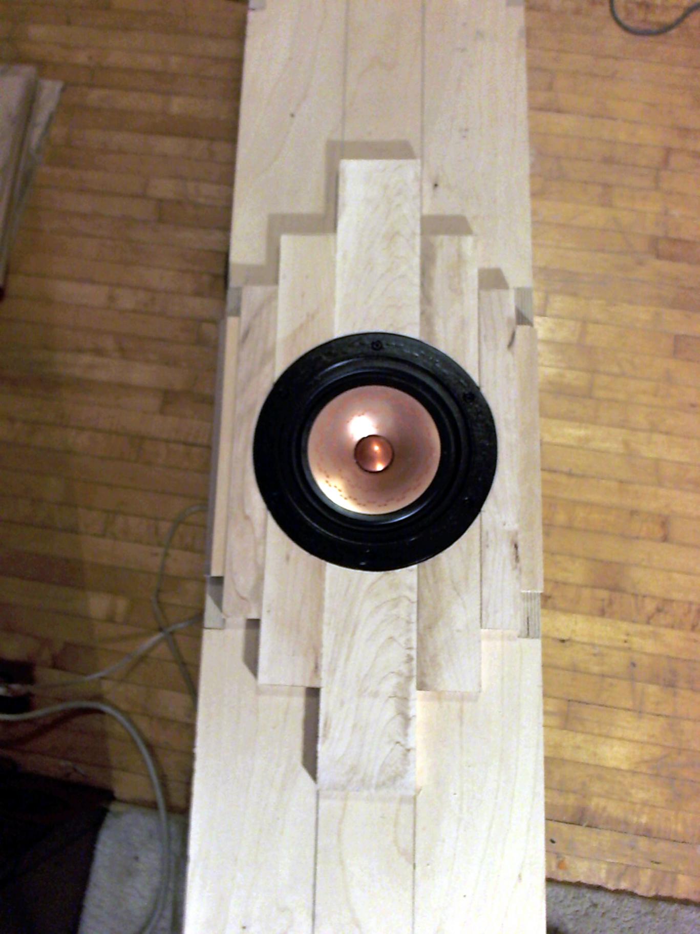

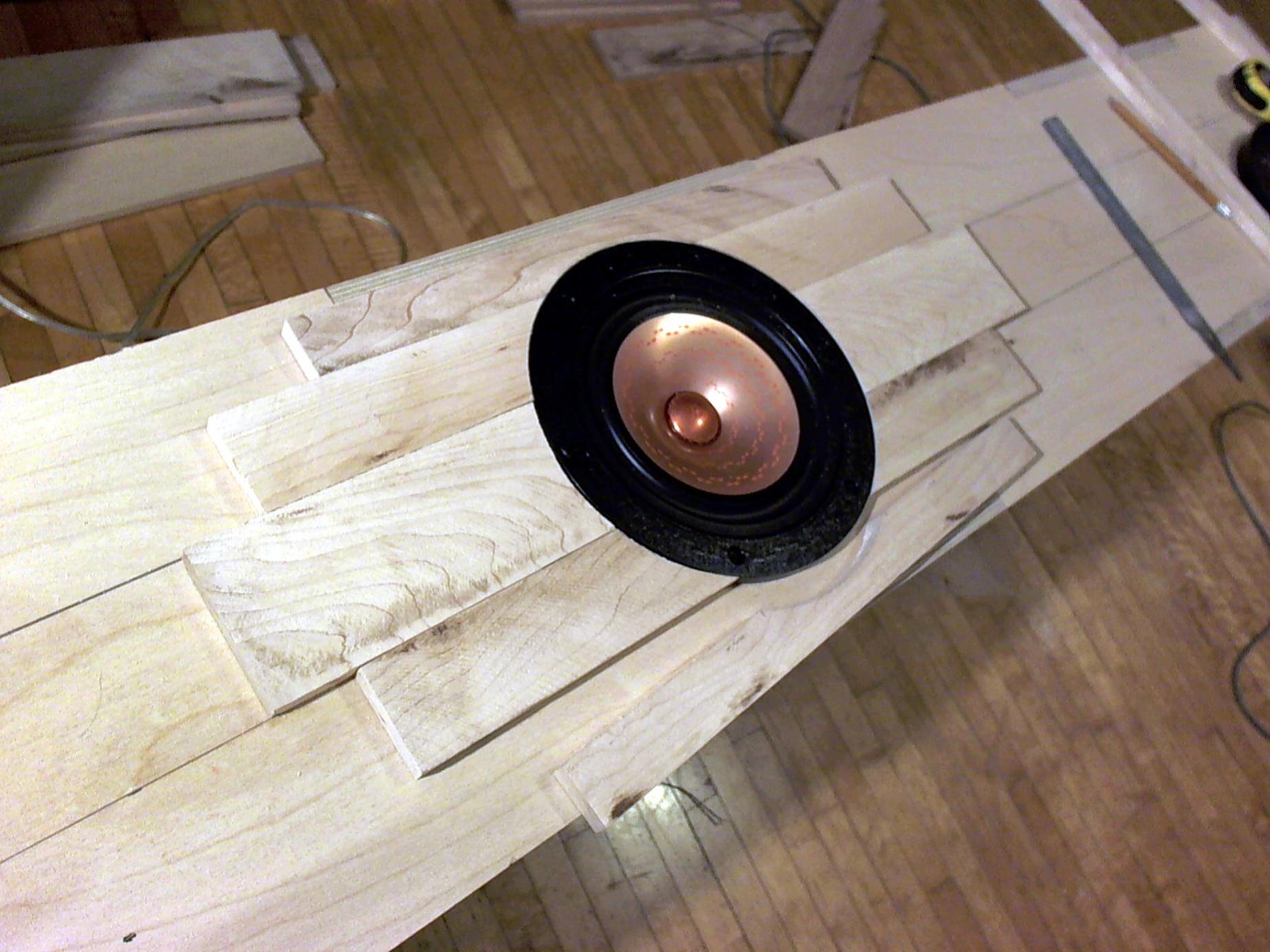

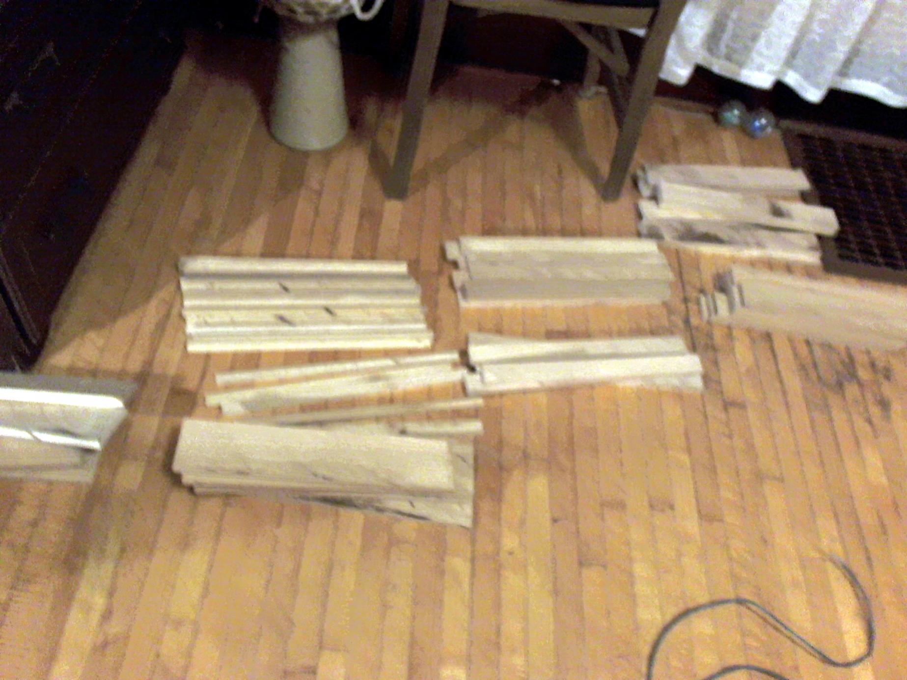

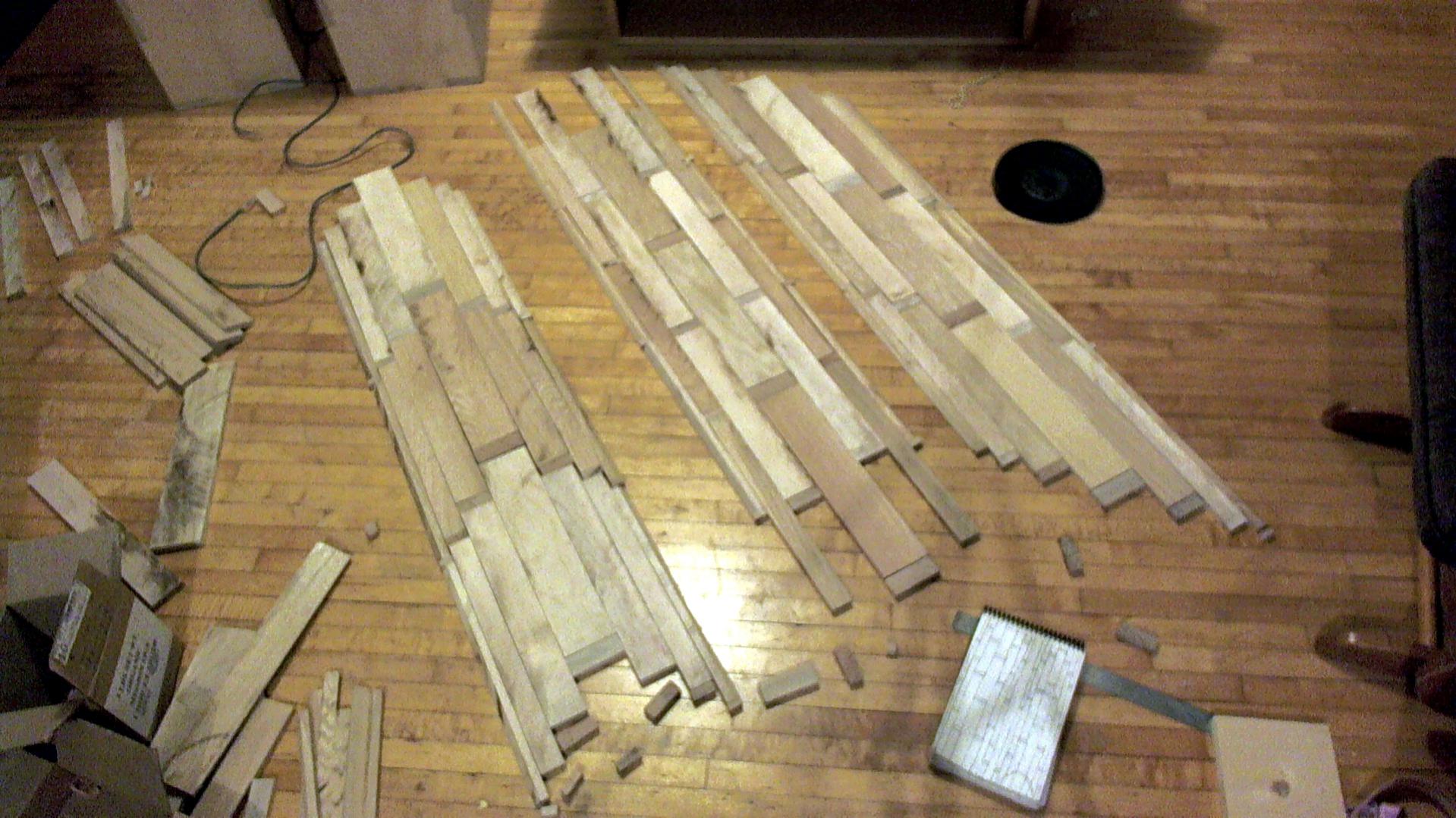

Baffle build-up
I am sure some of you have noticed that I have my Avebury on the swap meets, as I really like what the Cheap and Cheerful array does, so I would like to persue a better build of an array with better drivers...
However, my Avebury cabinets do have some issues to address, mainly the driver not being rebated and some minor air leaks. As it appears that no one wants to deal with these issues, and I do not blame them, I have decided to finish these cabinets to my original vision.
Here are some photos of the solid maple and oak mosaic I am adding to the front to rebate the driver and give the final finish some depth. I have considered staining the sides as they are to show the joinery, but I do not think it will look good with the fronts. I have considered veneering them or painting them to look like Avebury stone! Someone even recommended a straight black, which would off set the front very nicely, but may be too dark for something this big. All suggestions are welcome. It will take some time to glue up the fronts so...
But I am glad I measured these, as it will be interesting also, to see if the front baffle and driver rebateing has an influence on the measured response.

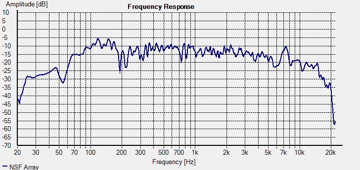

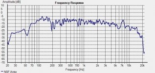

200 Hz Dip
Here is a measurement of my Cheap and Cheerful array. The reason I am including it here, is becuase there is also a 200 Hz cancellation in this system too. This is indeed a room and listening position problem, not an Avebury flaw. You will note that it is less of an issue when I listen to Avebury at my computer. So...
