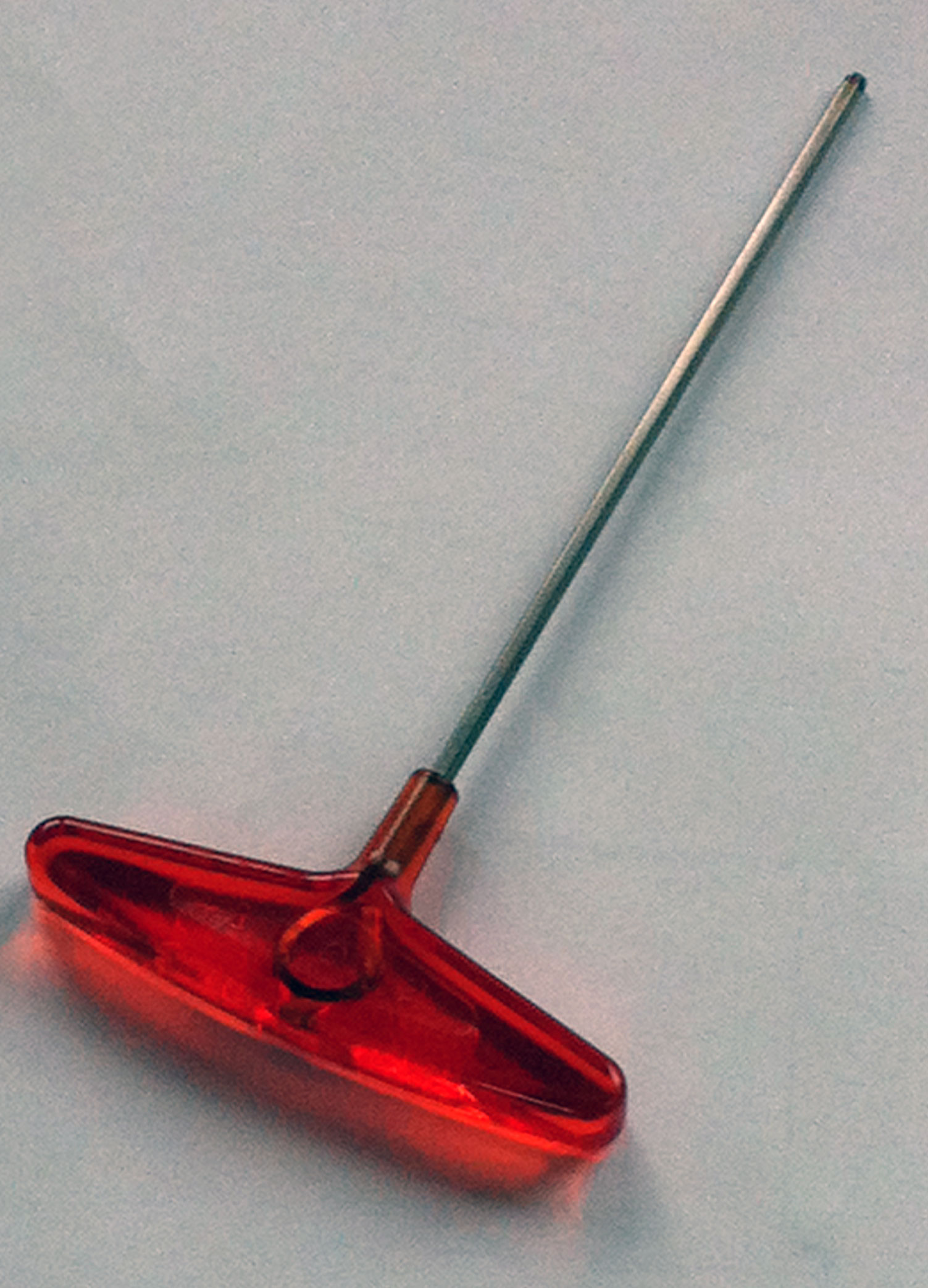

Take a look at the attached pic. This is the tool I use to tighten screws. Once pilot holes are made, its an ideal tool to "feel" the modest tightness needed to secure Markaudio drivers (and many others) onto/into baffles. Together with a steel straight edge ruler, Its easy to adjust the level of the frame with this tool. Also handy for maintenance tightening over the months/years of system use.

Thanks Mark, that is the tool I have been looking for. It is not availible in my rural area in the Metric size I need, however, maybe I can have one ordered or order one online.

Yes, this tool (or similar) is easy to use. Given your sight limitations, this tool should be much easier to use, as you can easily guide the tool and screw to frame.
