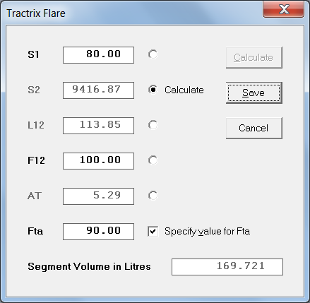

So, I think I've found an explanation as to why my Tractrix horn doesn't really look like one. After playing with the program on John Inlow's page, I read some of the descriptive text that had been written by the author.
This may seem overly obvious, but I thought I'd share this observation if it helped anyone else. The low frequency cut-off determines the flared end of the horn (the mouth), and this appears to be the same size regardless of the driver.
What this means is that the driver's throat is the same size as the driver itself...so what you do is to sever the Tractrix shape where the diameter matches your driver - a bit like cutting the end off an icing pipe to ice the cake.
I might have been taking the wrong approach with HornResp, but it looks like it was calculating the length of the horn from the throat end, rather than from the mouth end!
I plugged a 150Hz Tractrix horn into the program, and, well, the flare is 6 feet in diameter! On Phil Melhuish's site, he mentions that using a half or quarter wavelength version of the horn might 'do', though I might need a bit of convincing on that!
Still, this has been enlightening for me 😉

Hi unaHm,
The mouth area of a fully-formed tractrix horn (mouth flare tangent angle = 90 degrees) is given by:
S2 = c ^ 2 / (4 * Pi * fc ^ 2)
Where:
S2 = mouth area
c = velocity of sound in air
fc = tractrix horn flare cutoff frequency
This can be done directly using the Horn Segment Wizard in Hornresp. Simply specify the desired throat area, horn cutoff frequency and mouth flare tangent angle, as shown in the attached screenprint.
Correct. Hornresp treats the tractrix horn the same as any other horn in this respect. L12 is the axial length of the horn (the distance between the throat and the mouth).
Kind regards,
David
All the units in hornresp are metric, so you might want to check again. My understanding has been that the cutoff frequency of a tractrix horn is the frequency where one wavelength is equal to the circumference of the mouth of a circular horn. I get about 28" diameter for a 150 hz horn or about 72cm.
I did. I apologise...I'd been looking at the same numbers for too long.
I get the same as you for the horn now. Thanks David again for your brief HornResp tutorial here!
