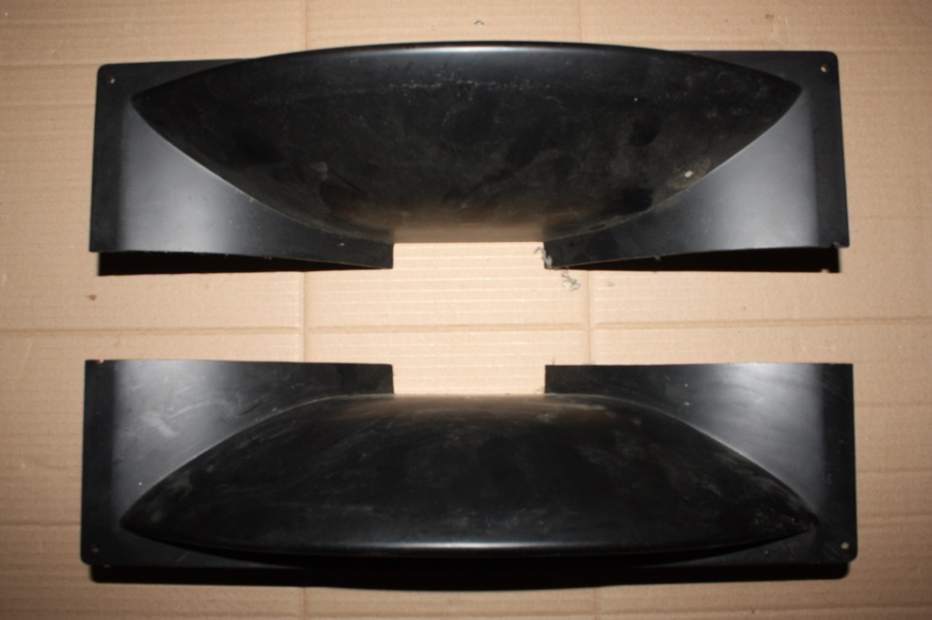

something very cheap plastic with poorly alligned screw mount
bought some a few years ago
I'm thinking it might be a mid/tweet for a 3way with 12" in vented BR
crossed around 500hz
but not sure about it
though it seems like it might fit nicely into a monitor box
and look like a cheating 2way 😛
one problem, a woofer cost money 😀

Very cool! Which horn is that?
hey, I'm reminded, you probably don't know this, but the shown 'tweeter' is actually a very small TB fullrange, and the all time famous and favourite mid driver for Synergy horn 🙄
I'm just teasing showing as a tweeter instead 😀
That horn above is a Pyle PH714, amazon recently had them on sale for $9 each. I bought two to play with.

The wide/flat sides look like they would work well for mounting the mids, with a little bit of hacking with a Dremel or something!

Yes, it is quite easy to slap together devices and get a frequency response +/- 12 dB (a 24 dB variation) in a narrow range with response that varies by 20 dB over the width of a couch at average listening distances.The wide/flat sides look like they would work well for mounting the mids, with a little bit of hacking with a Dremel or something!
So is it really that easy?
If you want smooth, wide band frequency response and uniform dispersion, more attention to detail is required 🙂.

imo ... I think you should just put the Alpha-8 in a conical horn, like maybe a small Altec A7 style
tweeter horn goes on top of it, and ought to be perfectly fine
The Altec A7 route is certainly a good one, and I think I'll try them out at some point!
I'm going to stick with the Synergy design for now. I'll start drawing out the pieces on the bits of MDF that I need to 'butcher', and re-do the ports so that they look more like Bill Waslo's CoSyne ports (the 'rounded rectangle' shape). I had to look at it a number of times before the penny dropped about really tucking the ports into the corners.
