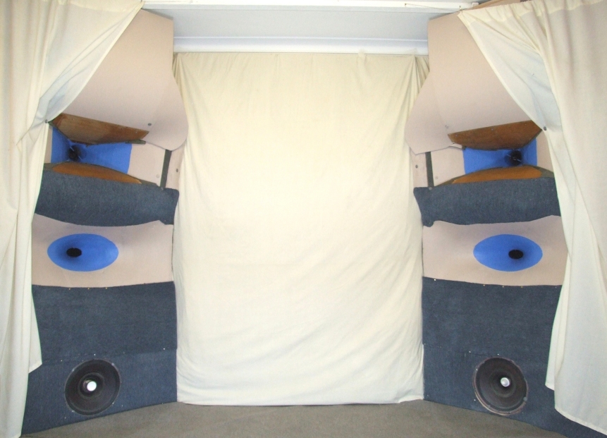

Just for interests sake I moved on from the corner mounted design which I last posted about (although changes are getting more subtle). Late last year I built a better elliptical midrange horn. Then I changed to a round OS tweeter horn. Currently I'm building a new midbass and midrange (non elliptical) set of horns integrated across the floor and later I'll need to build another tweeter to match them.
Here's how it was last year. I'll see if I can post some updates tonight.a photo ?
Thanks AllenB - that looks like an interesting project! I look forward to seeing the updates!

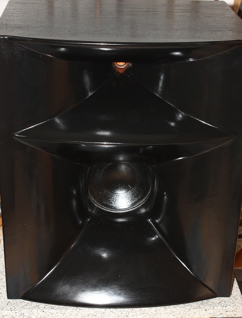

Well, I've finally found 15 minutes to cut the hole and mount the Alpha 8. This is all I have so far:
I've got to make a mounting 'plate' for the compression driver to attach to the horn...which will probably take a while considering this last step! 🙂
Fortunately I have a metric ruler, so it made a bit more sense in centimetres 🙂
Off the cuff response is that hole for the mid is waaaaay too big and in the wrong spot for a Synergy/Unity horn.
I thought so too, but I didn't really know what I needed to do correctly (I was working solely from the upper cutoff frequency), so I thought I'd start by getting it wrong 😉
Fortunately I still have the piece I'd cut out, so that can be edited, and replaced.
Edit: Doh! I suddenly remembered that HornResp can be used to model the horn:
So that's what the hole needs to be. I'll fix it tomorrow 🙂

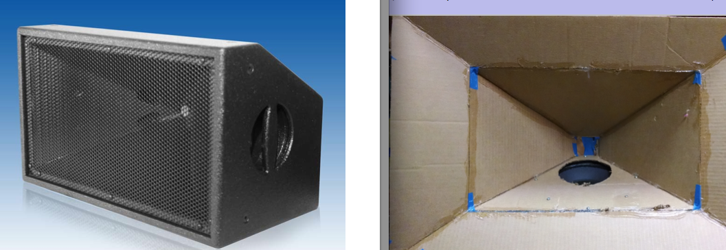

I tried the cardboard approach in my Hobohorn, and it worked on mids above 600Hz, although wood turned out better. For the midbass horn (130-600Hz) the difference between paper and wood was too large. The paper midbass horn told me nothing of what the wooden version eventually sounded like.
I would strengthen the cardboard with paint or plaster to have a more solid midbass horn.
Synergy holes are fairly close to the source which makes them potentially a problem. You can make them small with the right driver. Hiding them in the corners of a square horn can help (although the throat won't be matched to a round driver) . You could also consider Tom Danleys suggested port shape.
The goal would be to put the ports far enough from the compression driver that the waves within its band can at least begin to launch before reaching the ports. The mids would want to be such a distance from the tweeter throat that it creates a null a little above the crossover.

Yes you did!I thought so too, but I didn't really know what I needed to do correctly (I was working solely from the upper cutoff frequency), so I thought I'd start by getting it wrong 😉
I'll re-post the correct way to do it again (hint- it is the one on the left) 🙂.
To get a sense of the size of the holes for the 8", note that there are two visible mounting screws on the mouth side just before the second part off the horn.
Note that the two frankfurter shaped exit holes are in a low pressure part of the horn, where they will have the least effect on the HF response.
